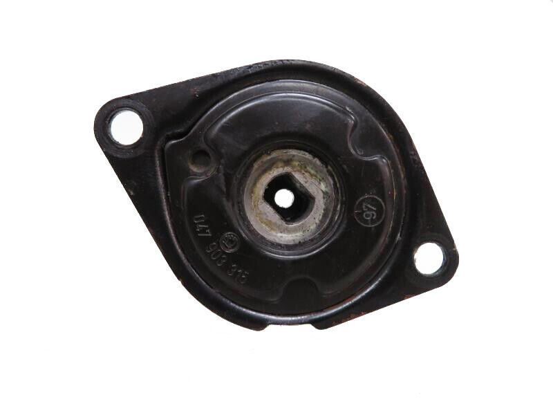

Should I be changing the mounting bolts ???

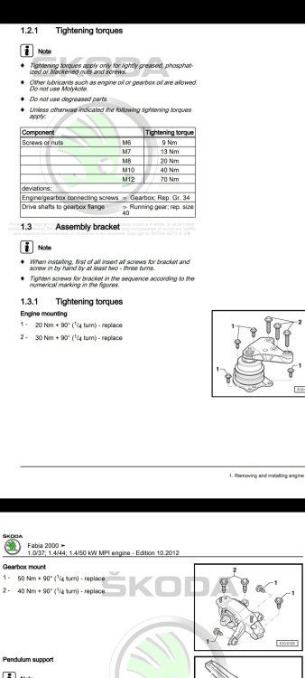

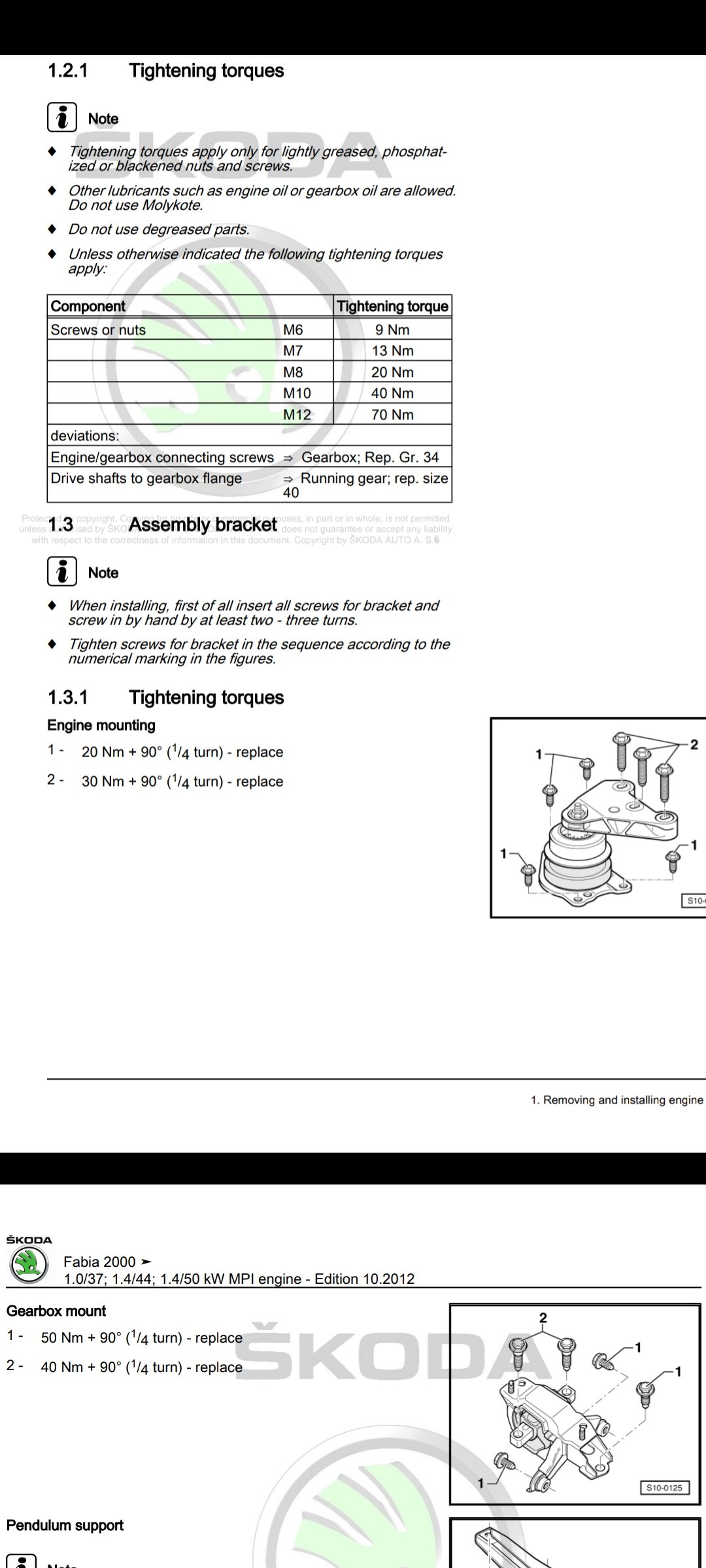

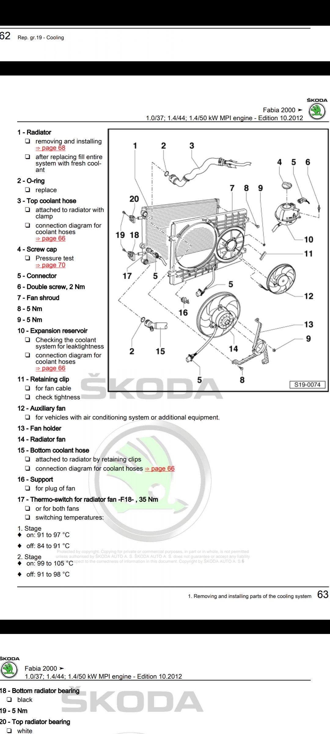

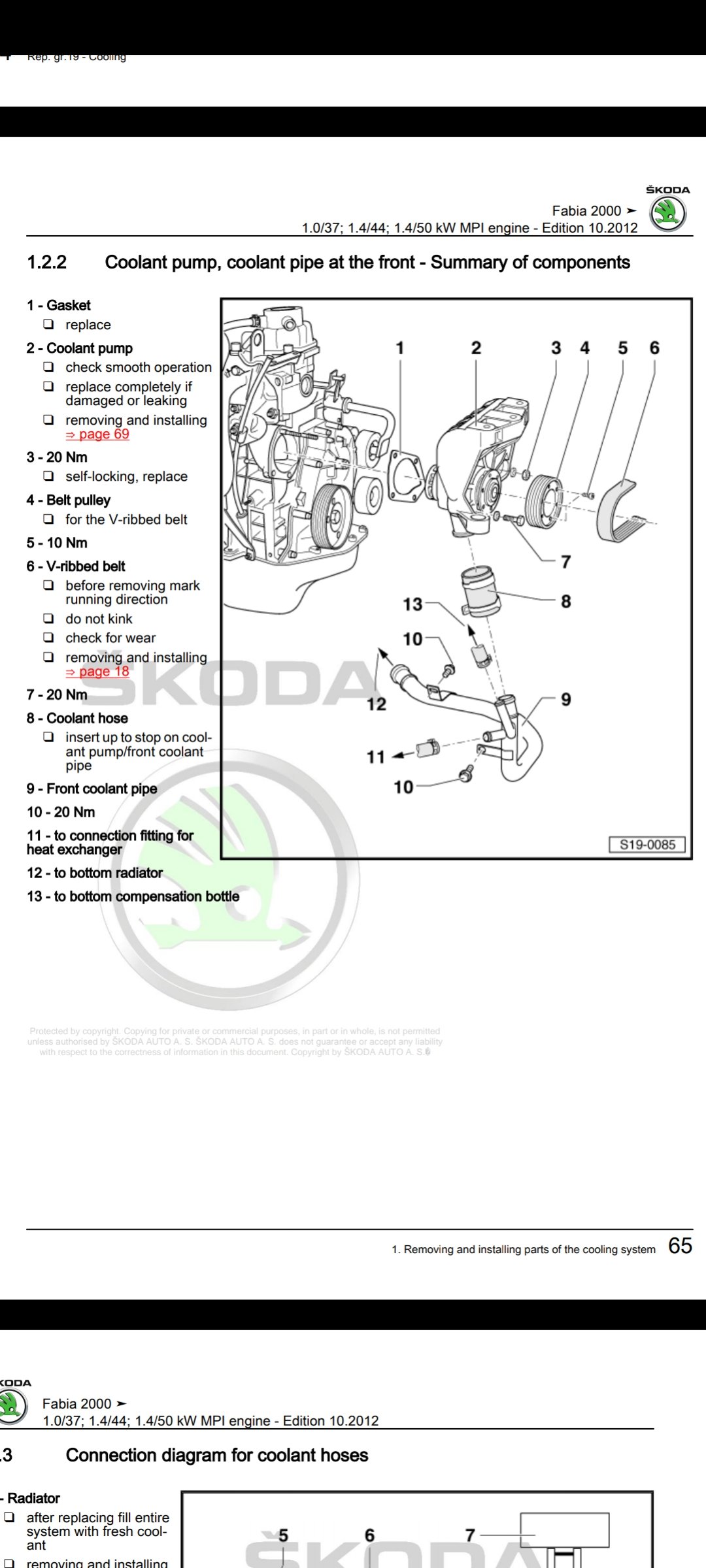

Last question I promise lol can someone please tell me the bolt torques please I can't get that page loading.

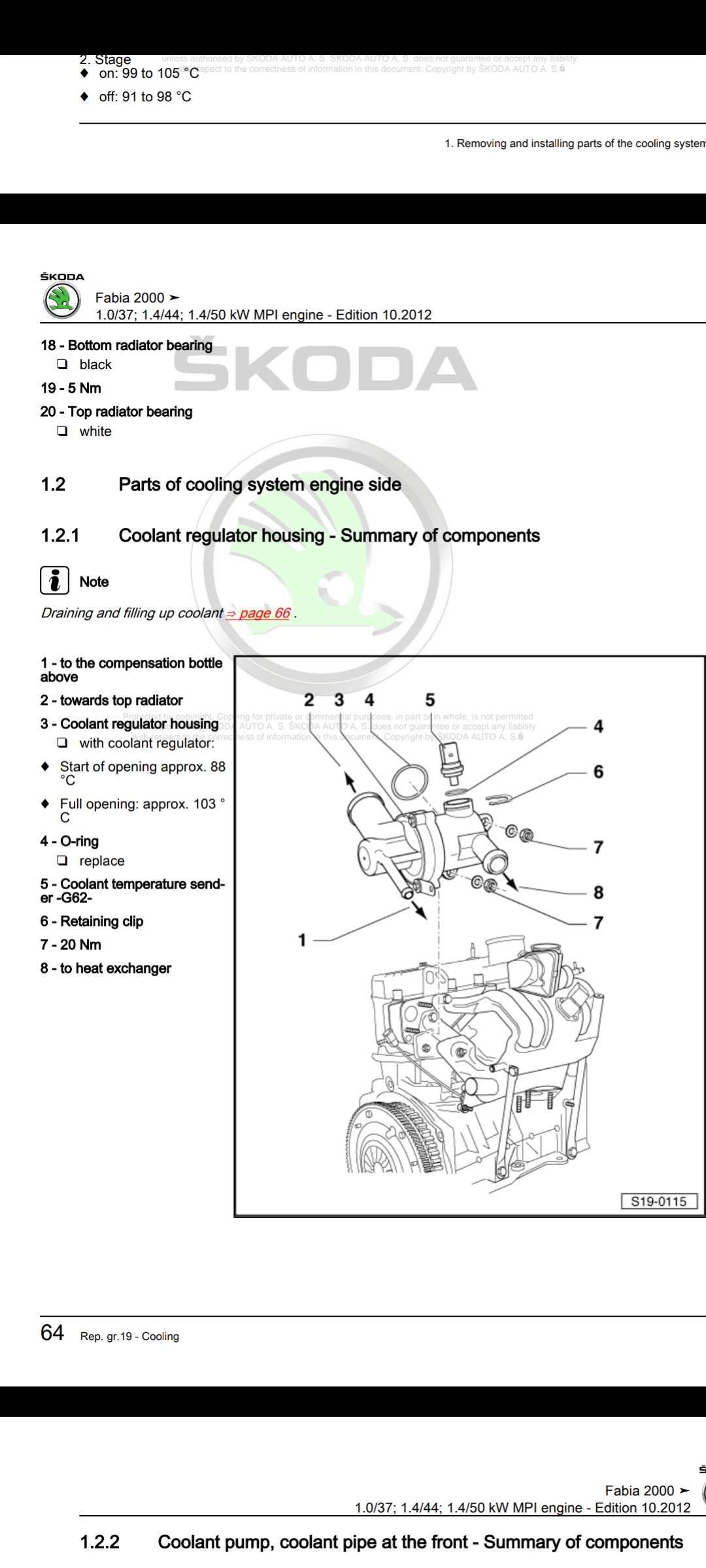

Hopefully these are what you need
AQW engine
Screenshot_2022-12-01-21-06-01-557_com.google.android_apps.pdfviewer.thumb.jpg.f20cb1981900d579f1f537de106bc776.jpg
Screenshot_2022-12-01-21-06-11-760_com.google.android_apps.pdfviewer.thumb.jpg.03d55019dd0d063d92bf822ed7077ff1.jpg
Screenshot_2022-12-01-21-06-23-706_com.google.android_apps.pdfviewer.thumb.jpg.6266f7713d5ebc8170f8325f86a688cf.jpg
Engine mounting bolts? Yeah, you're supposed to but I just reused mine and the engine hasn't fallen out yet 😁
Engine/Gearbox mounts
Screenshot_2022-12-01-22-38-52-045_com.google.android_apps.pdfviewer.thumb.jpg.eb971a50be70e78852731739196c0708.jpg

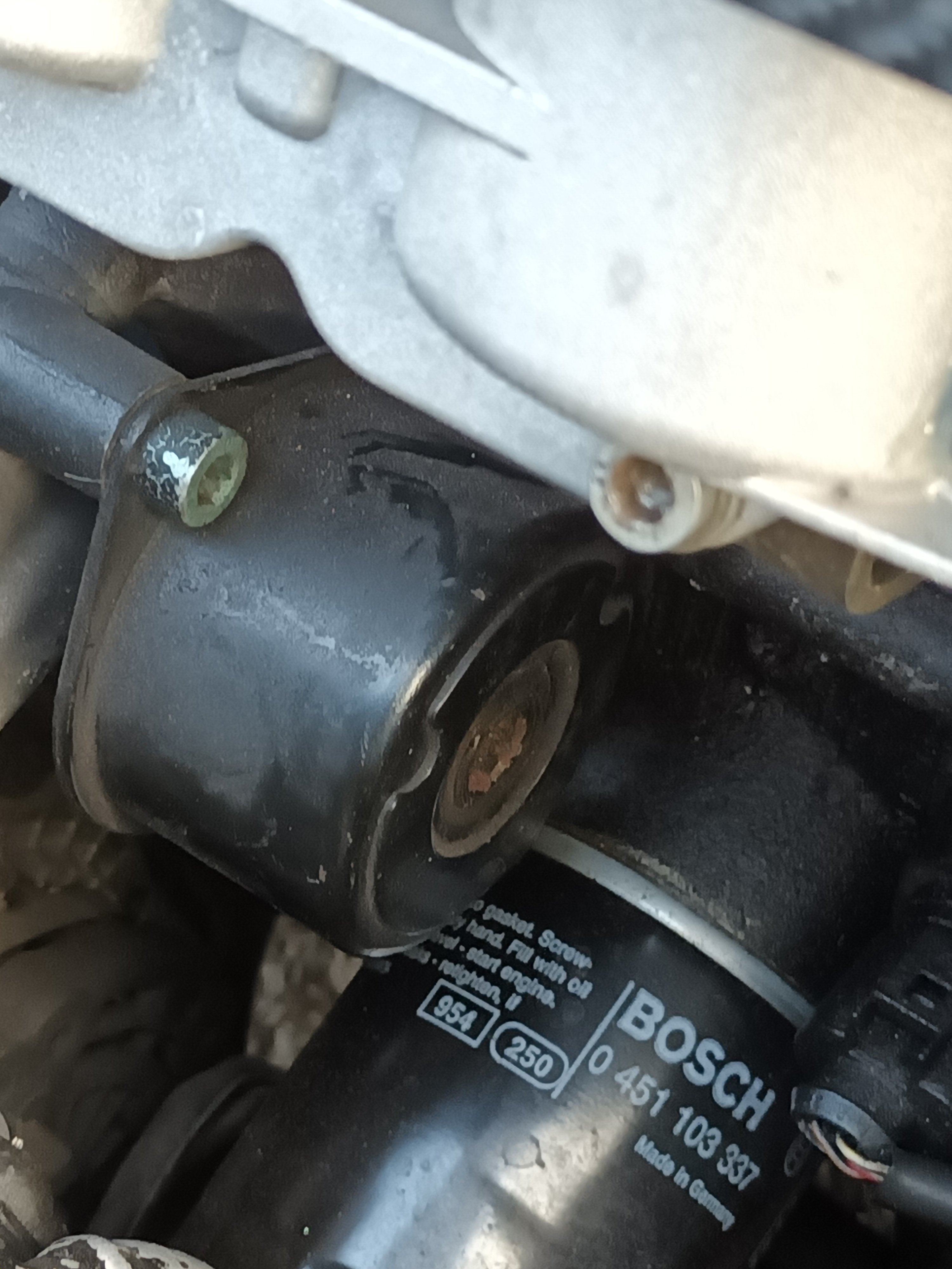

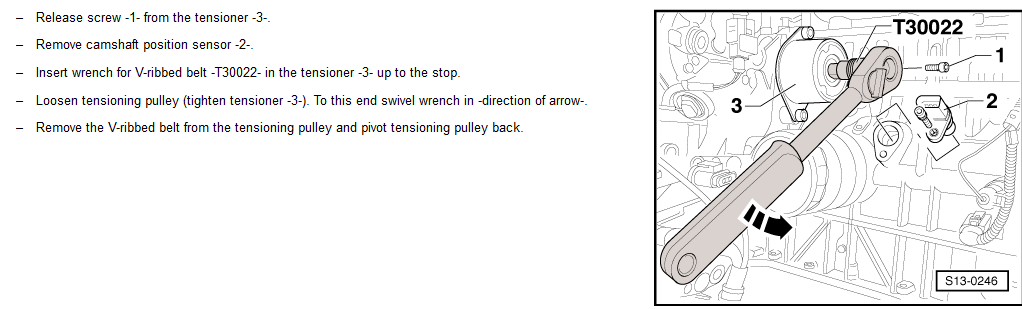

put on hold yesterday was way to cold lol so weekend now so can anyone explain how I use this to release the v belt tension please ???
superfluous post
Edited by TMB
There should be an oblong hole so that you can insert a ratchet or whatever suitable tool to be able to turn it to release the spring tension on the belt.
There is a screw (6mm Allen head) to remove inside the hole before doing this (see my next post).
Edited by TMB
Ah got you I had found the Allen head bolt but you've clarified it for me now surprised would have thought logically levering upwards not downwards would have loosened glad you put me straight thanks tmb 😀
