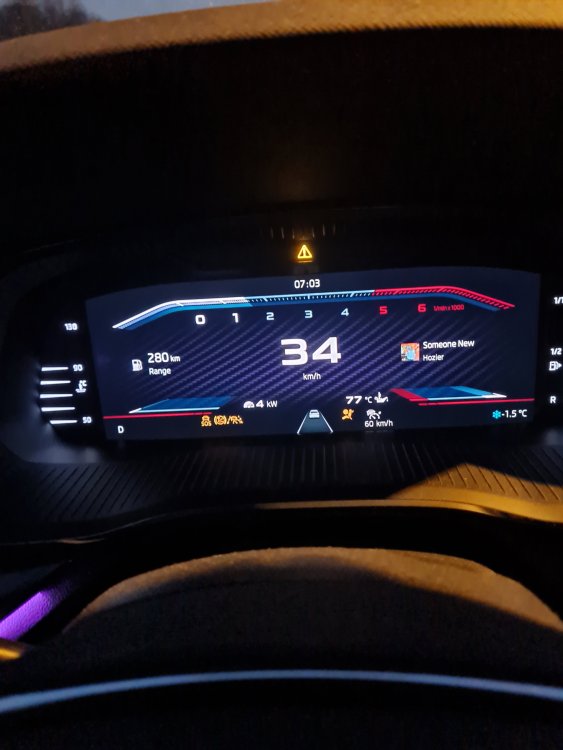

On a serious note - so I get it, when the car is covered in snow and the sensors are covered or dirty or frozen?? they could not work and the errors are normal. But when this is not the case and the only thing is that the temperature is below zero degrees, is it normal for assistance systems to not work? Talking about front assist, ACC, side assist....and all others (don't even know which turned on as it was impossible to read during driving)? See the attached picture to see more (disregard the air bag light - this is a bug and I'm waiting for some new part to arrive).

Did you by any chance turn off or reduce the steering wheel heater just before those popped up? Emergency assist and front assist (the two lights to the left) usually pop up together when doing that.
ACC and lane assist could get disabled if either the windscreen camera or the front radar gets fogged up or otherwise contaminated.

Yes I did. I turned the wheel heating on and adjusted it a couple of times. You're right.. The lights turned on after that. That's not normal is it?
Definitely not normal, but it seems to be a fairly common bug. I'm not sure if there's a fix for it yet.
Next time it happens, try quickly pressing the heater button again, cycling through all the levels. Sometimes I can get the error to disappear before the second ding by doing that.

Will try that - thanks
I have the same, cold here just below freezing, so not bad, but twice in the last week its done that, I had the steering heating on but not changing it so mine is not connected to that. Seems to only happen first thing in the morning for me and when its cold, but not always!! Sadly I ignore it now as it resets when I turn the car off and on again.
