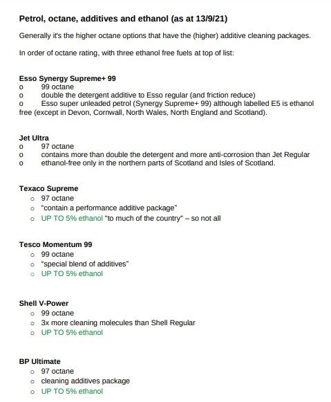

All 95 is E10 now regardless of Super Market or brand non supermarket.
Not all will have 10% bio.
Shell fuel saver 95 ron is just that, nothing special.
The octane matters, we should not need to clean the engine, the oil also has detergents.
More issues will be from bore wash than anything else over time.
We are on Winter Spec Petrol now, Mid October til April. Less hygroscopic over winter.  Probably less ethanol,  nobody is say that.  Well i am.
It is Super Unleaded that can have up to 5% Ethanol.
Swerve the Shell v-Power Nitro / Nitro + pinches of salt, as that is what detergents are.
 Tesco Momentum 99.
 Lovely stuff for us and you in the North of England.  Detergents as well, but more likely 99 +
It might well be 100 Ron or 100+ European Import.
Shell & Greenergy import together,  Greenergy produce / import Tesco fuel as Tesco Partly own, and for us the ESSO.
So do not bother about Shell's extra detergents, we want that 5% ethanol if it is there, it might not be.
The whole of the UK is not the same.
645716307_Screenshot2021-12-1408_58_22.jpg.2ff9271fb94c47fcc7d2afaaf0c7ed90.jpg.e41165ba41d2fcf9d2b02f821d5d6da6.jpg

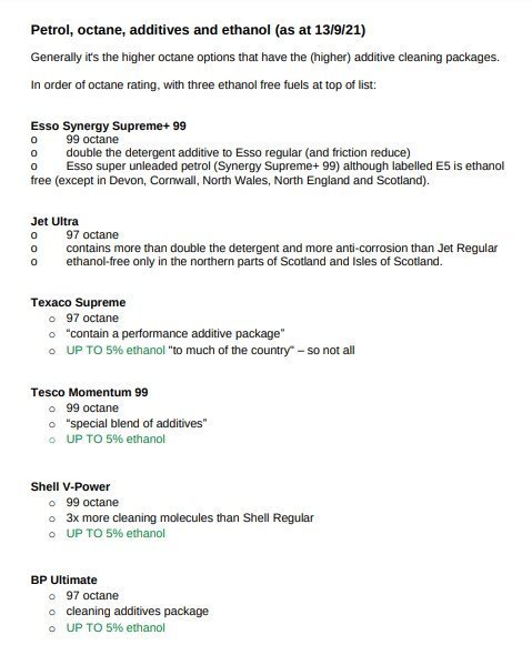

 Tesco Momentum 99.

1 hour ago, toot said:
I always use Super Unleaded petrol in a TSI.  In Fabia Twinchargers it was essential as standard or mapped if you wanted them to behave.
It was £2.25 a tank more expensive than Tesco 95 unleaded and cheaper than other Branded 95 ron.)
I also use in any petrol car that benefits from it and that can be just normal city cars with small engines.
Like my Citroen Saxo i had for 11 years Kia Picanto for 7 years, or my Suzuki SX4 that is 11 years old.
Suzuki Jimny's i had over 18 years did not care what petrol was used.
(If buying a petrol car i drop the oil and get rid of Long Life oil, put in new plugs and get in Tesco Momentum 99,
i even use Momentum or Sainsburry Super unleaded in a loan or hire car.)
E10 was only introduced in September 2021 as standard for 95 ron in the UK and last winter might not have been so cold, and it was and is up to 10% bio so some might not have that, or did not last winter.
It is what the more additives does that matters really.
I doubt the petrol has anything to do with how your car is behaving as the Kangerooing is a well documented issue, and not for all the earlier or later 1.5 TSI ACT,s.
Personally i would be getting the 4 spark plugs out and inspected and the gap checked and since out put in new ones and know all is well with that.
First off is as well to get in 99 ron minimum super unleaded since you need to run on petrol anyway.
If there is an invoice showing the 4 spark plugs part number maybe post what it is they fitted.
