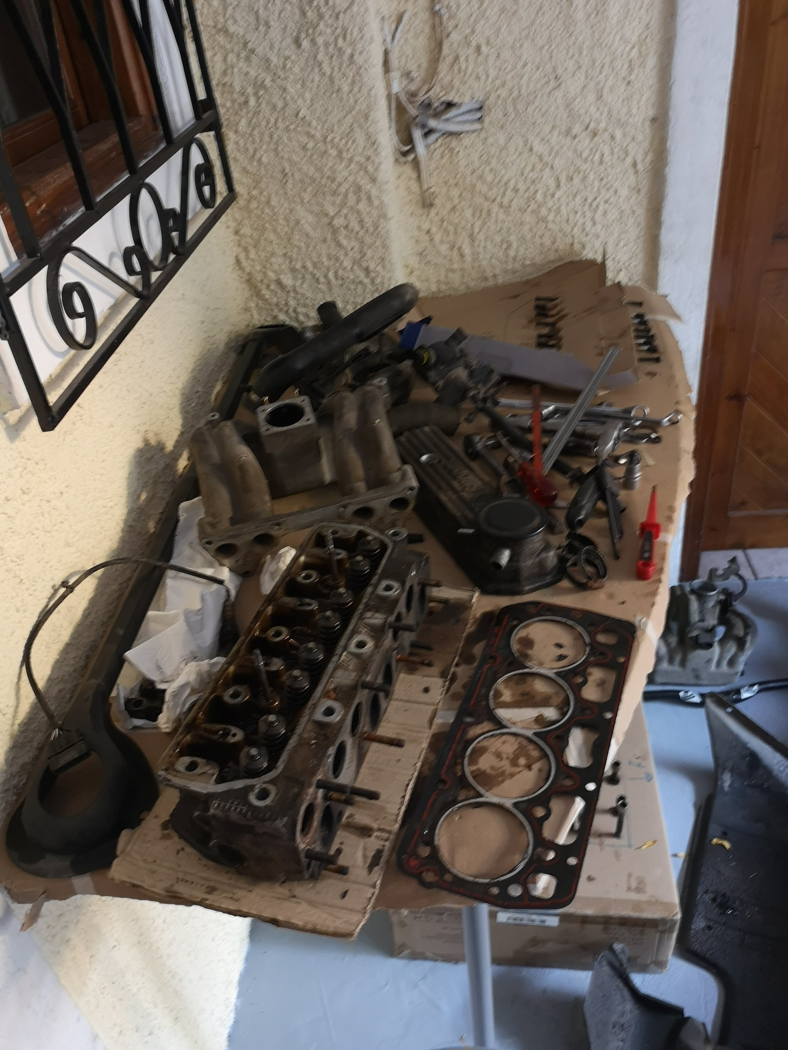

Felicia head gasket nightmare
So yeah I decided to bite the bullet.
Borderline failing  head gasket.
With this post I hereby announce the official start of my felicia restoration project.
The car is going to be restored to a factory condition and I am going to apply for a fiva youngtimer certification.
More photos will follow soon,
As well as a comprehensive list of the things done.

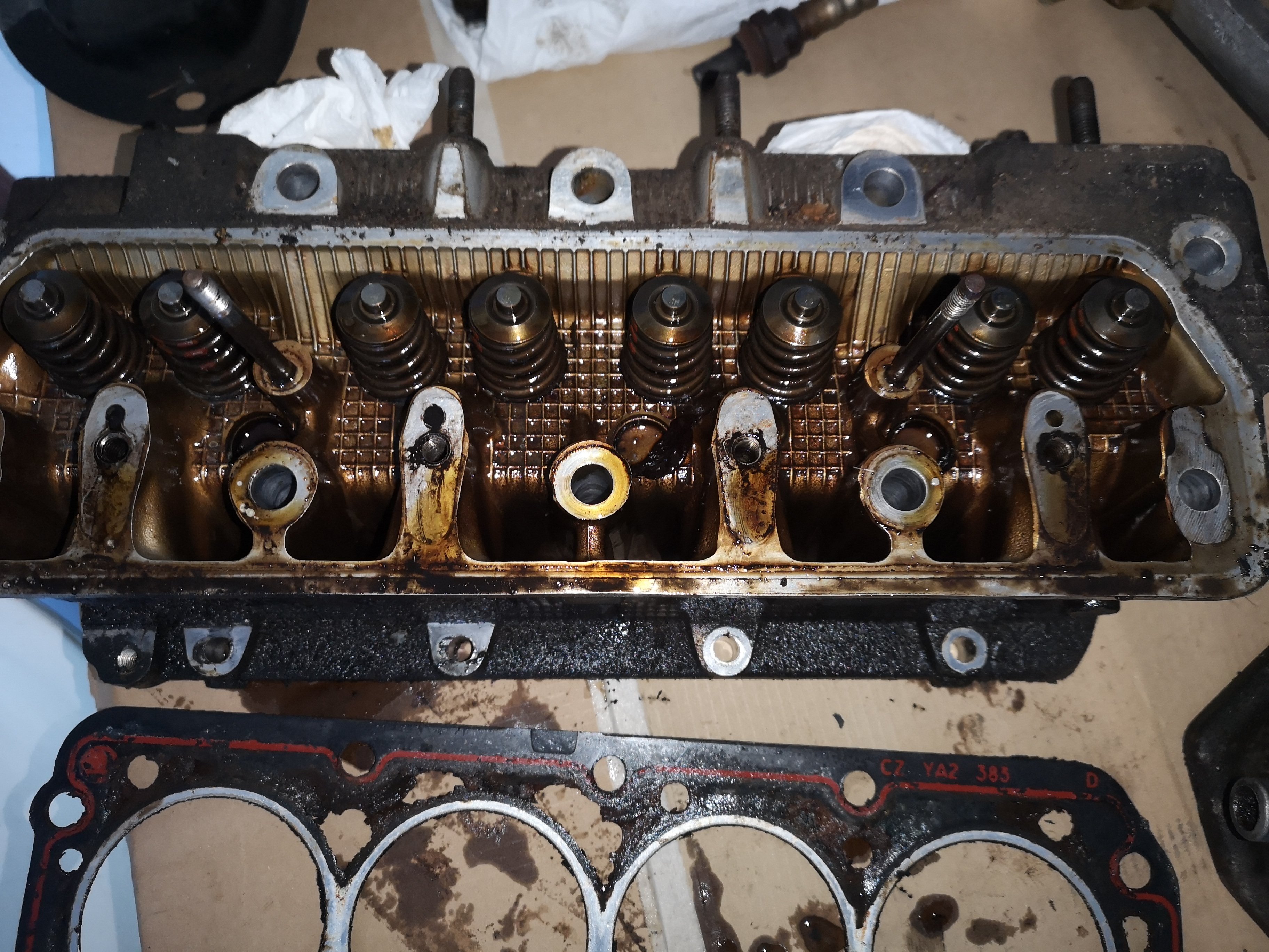

Valves are sealing perfectly, no wear on the liners and pushrods.

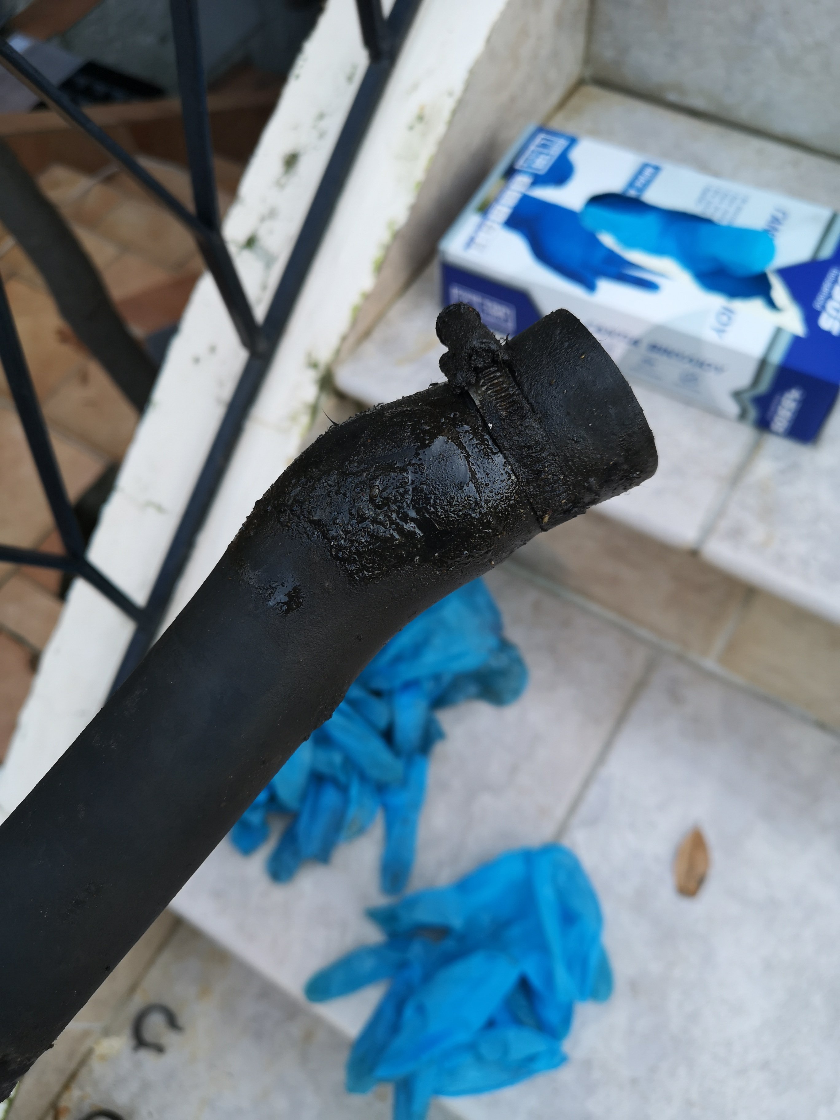

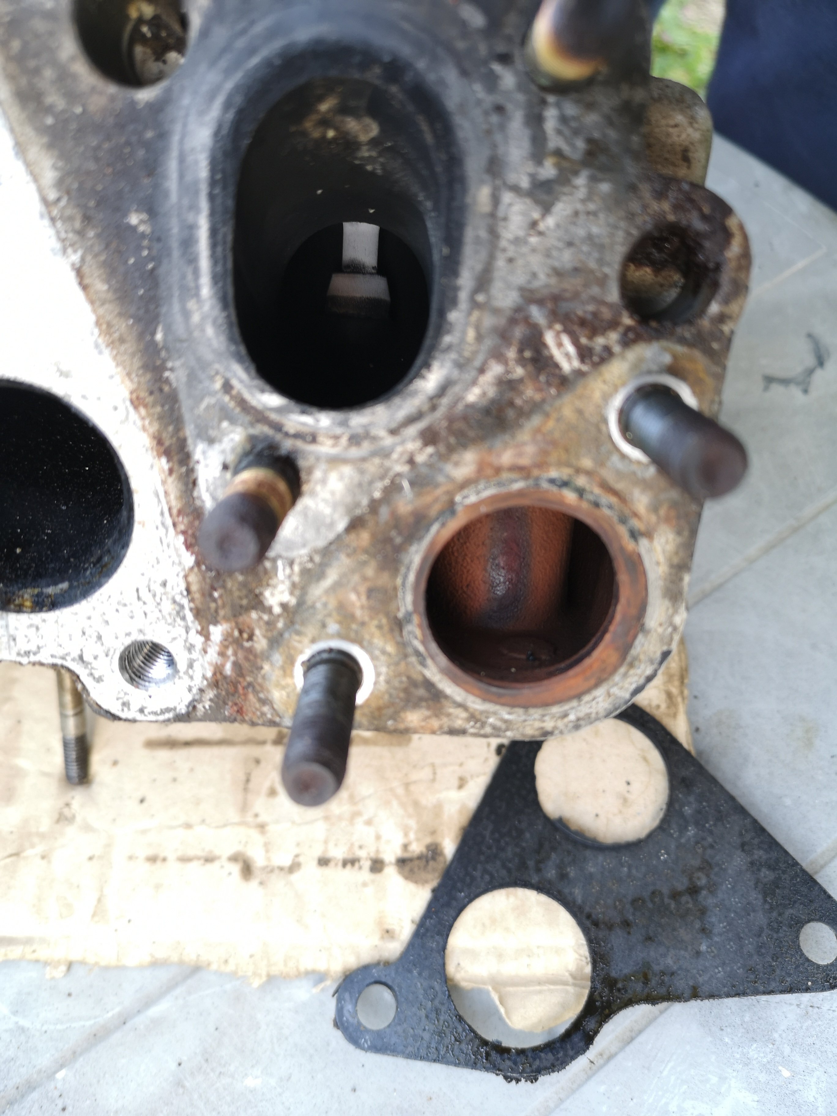

Lower coolant hose on the verge of blowing
Please note - I am not a mechanic or expert in anything.
Let the 'fun' begin, sooner you than me but I am sure you will enjoy it (for the most part).  Be interesting to see which new parts are better than factory and which are not as good.  The hose was a lucky find.  If you can get a silicone set with proper s/s clips all the better.  Good time to thoroughly clean out and service the whole 'water' cooling/heating system too.

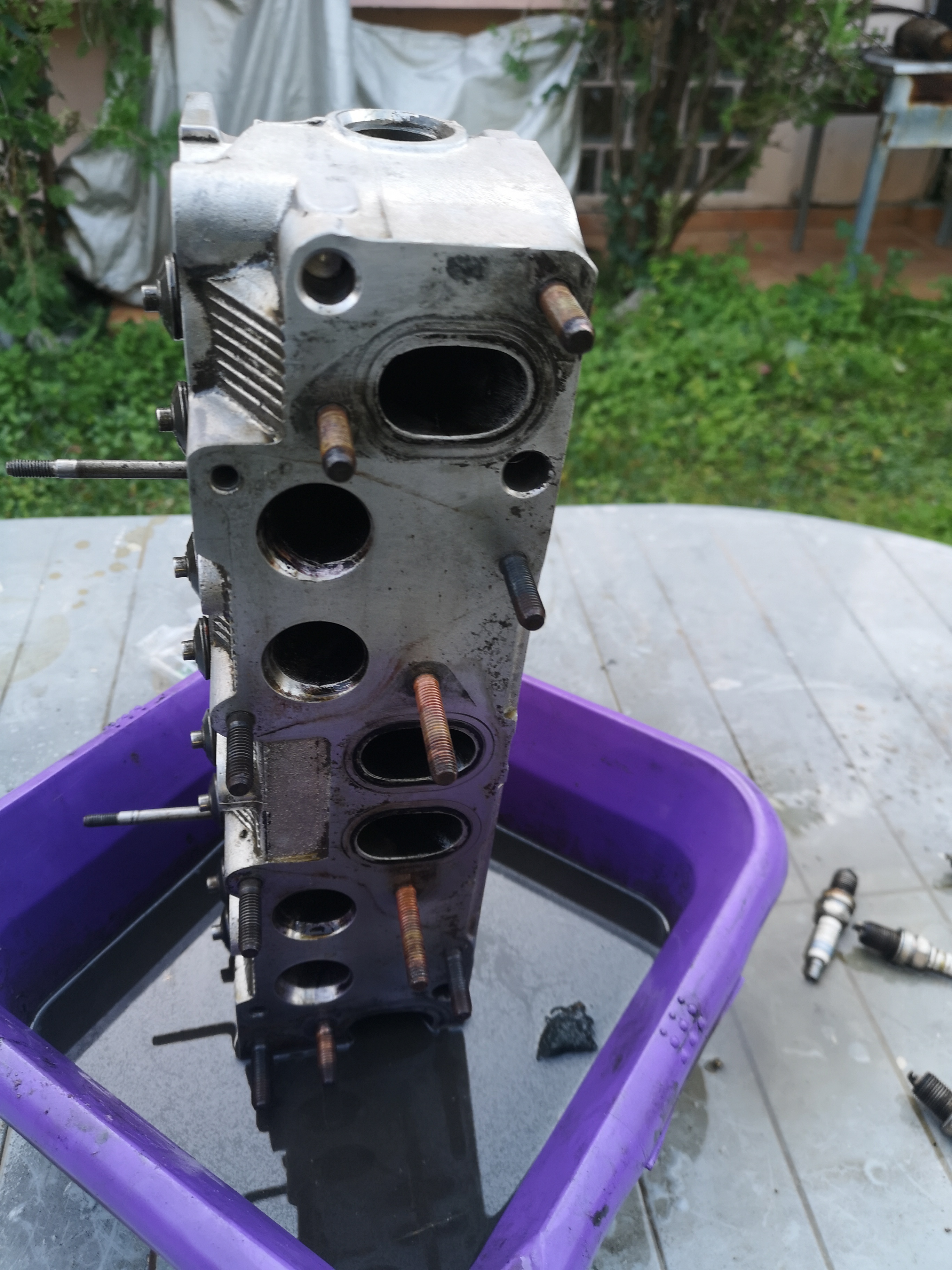

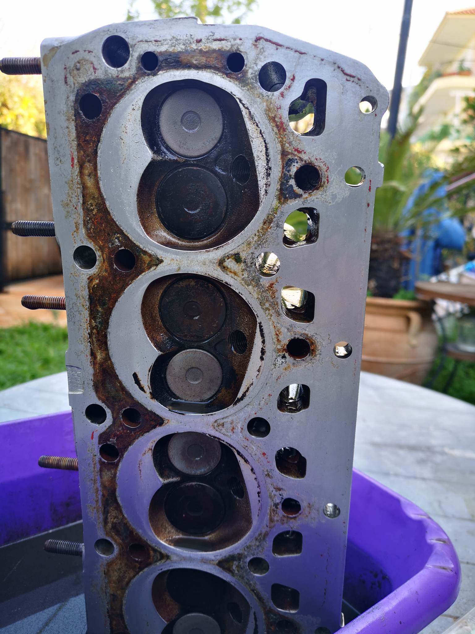

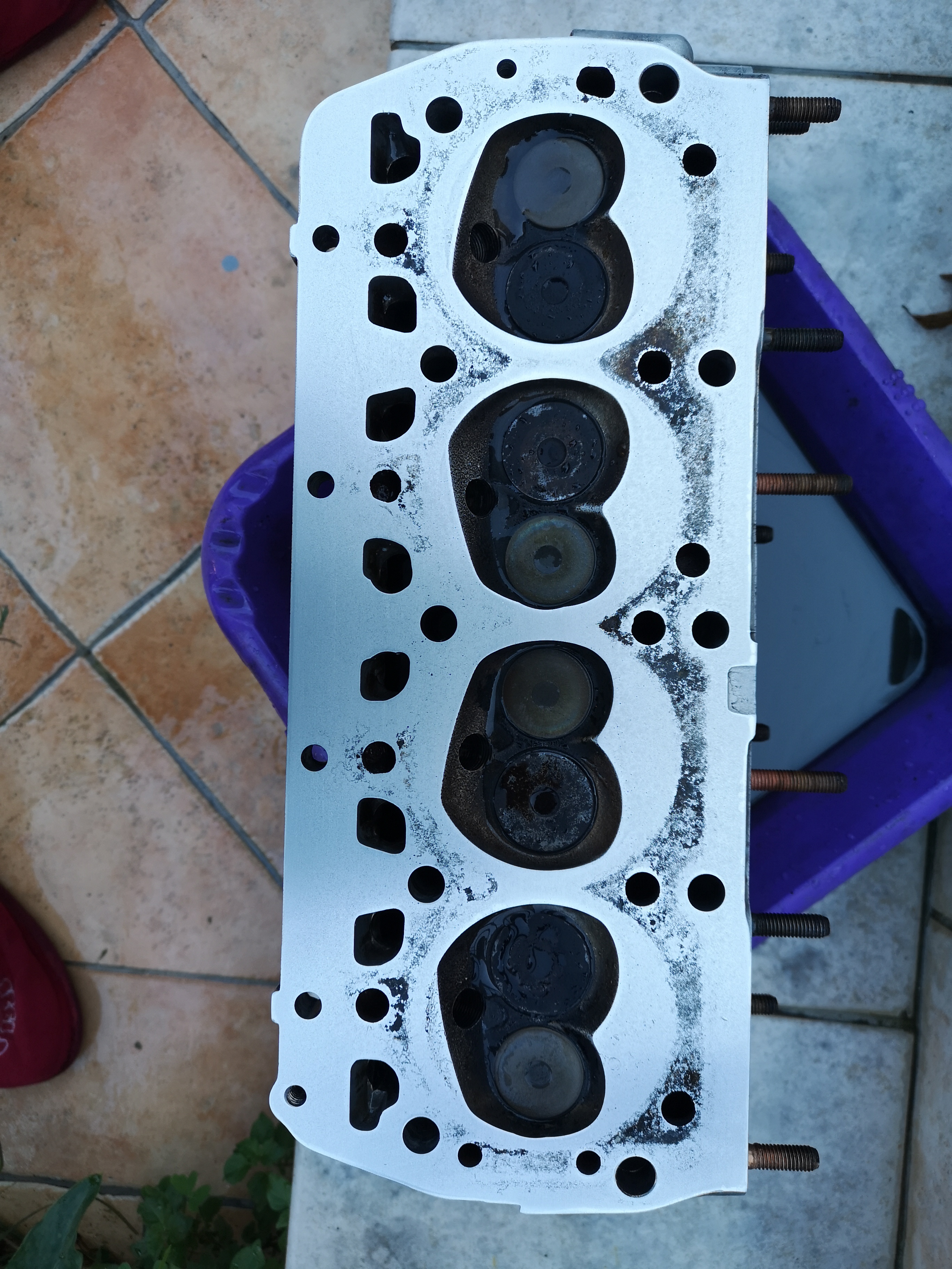

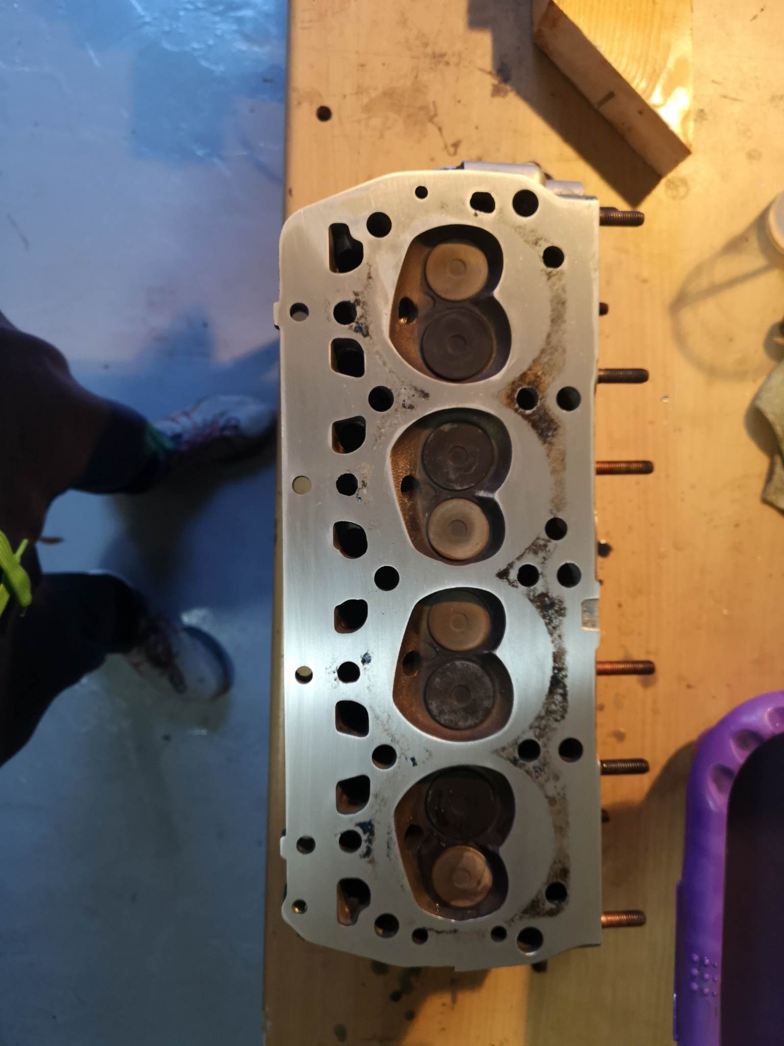

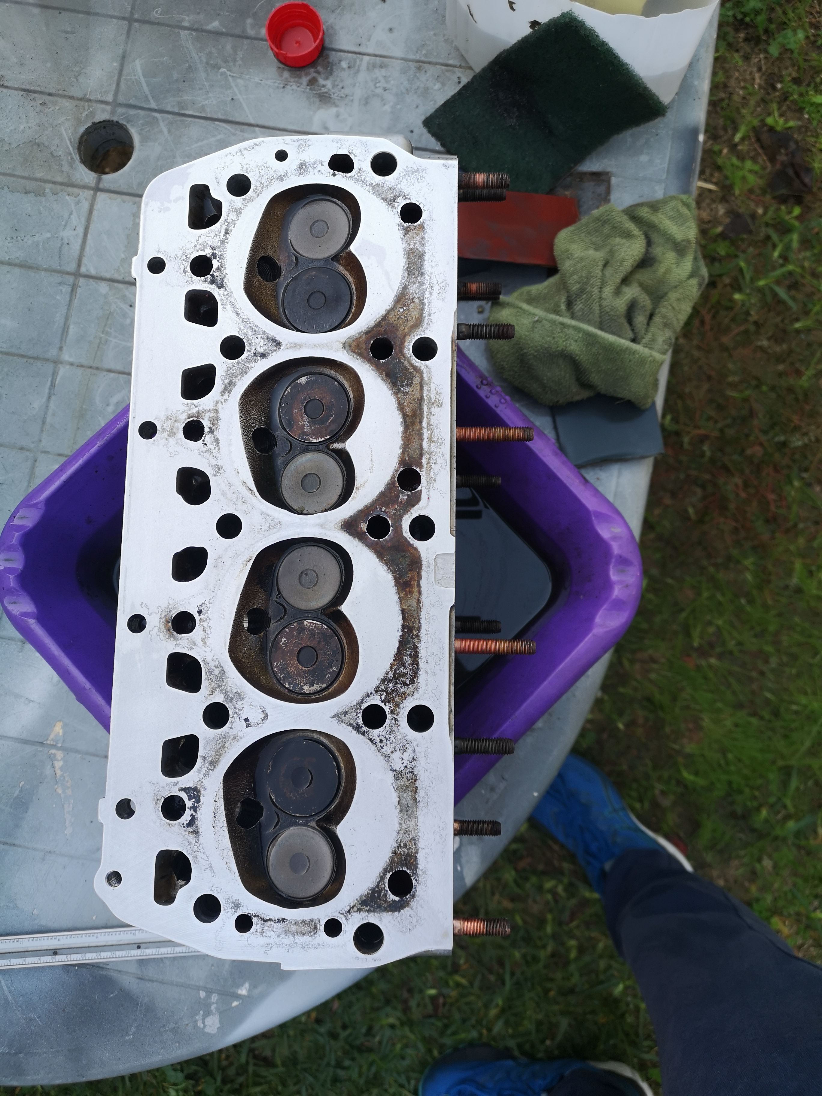

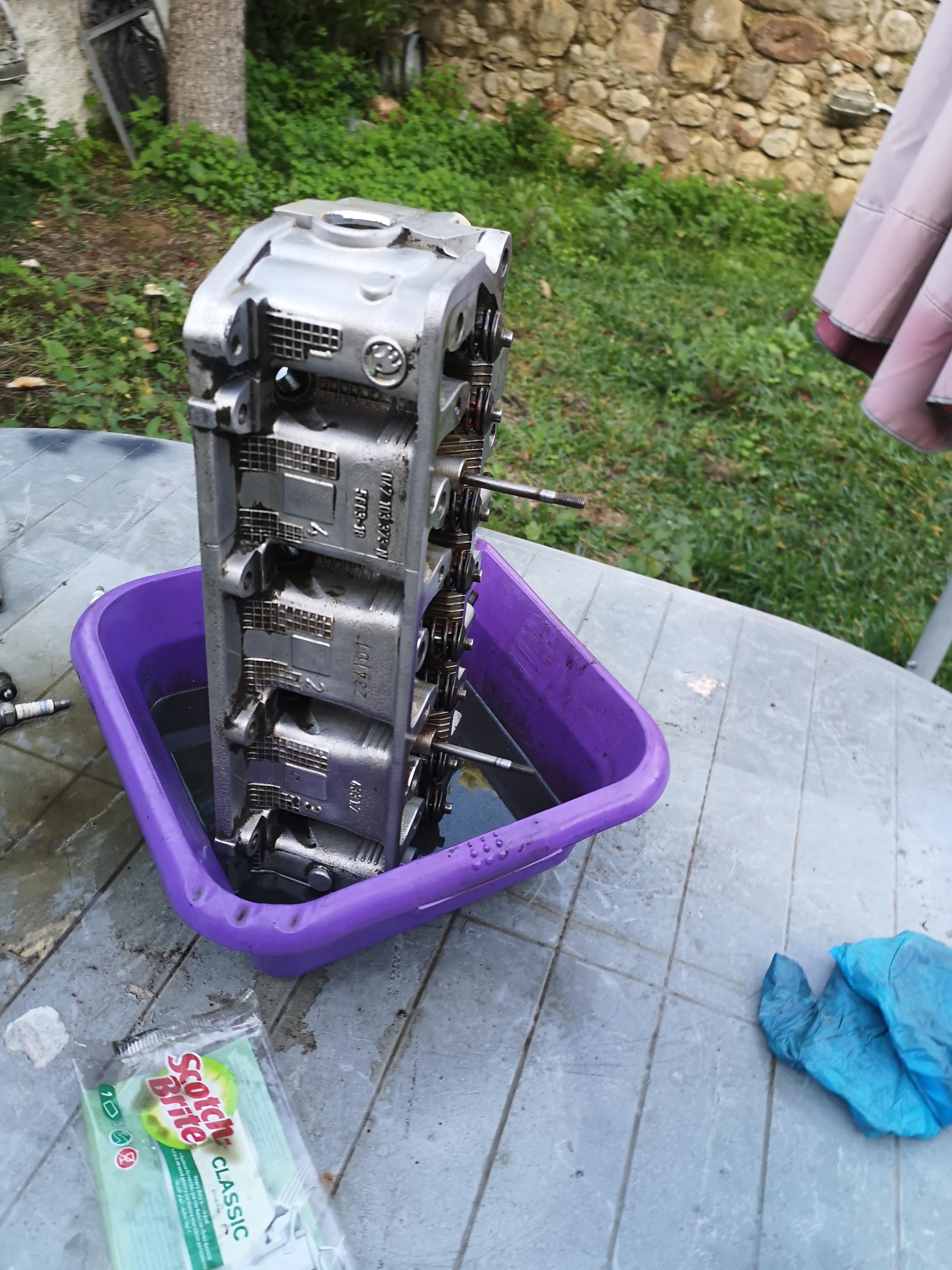

Head is getting cleaned up and ready.
Very little warpage.
Less than 0.05mm
Will continue sanding tomorrow.
Just some finishing passes

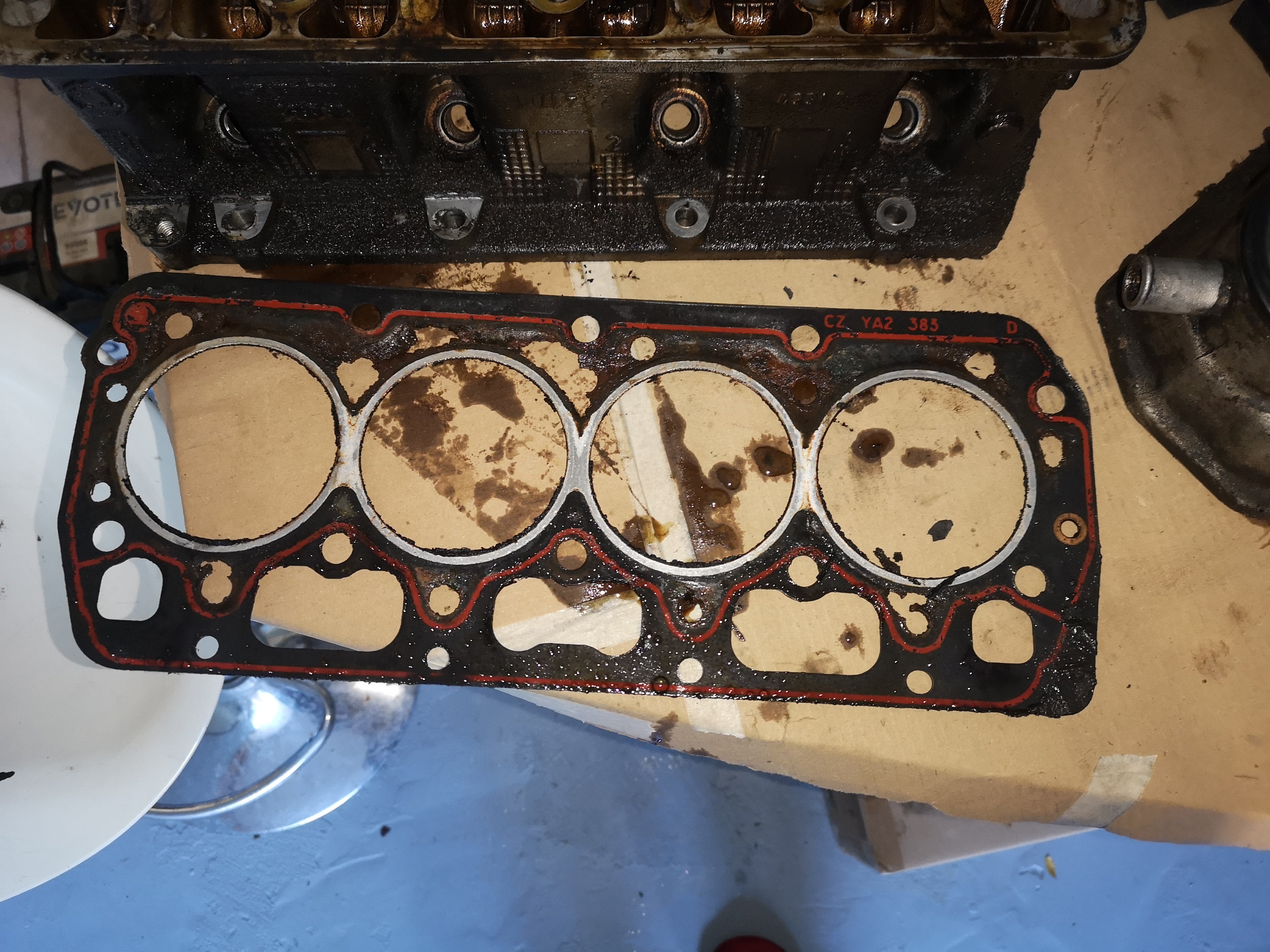

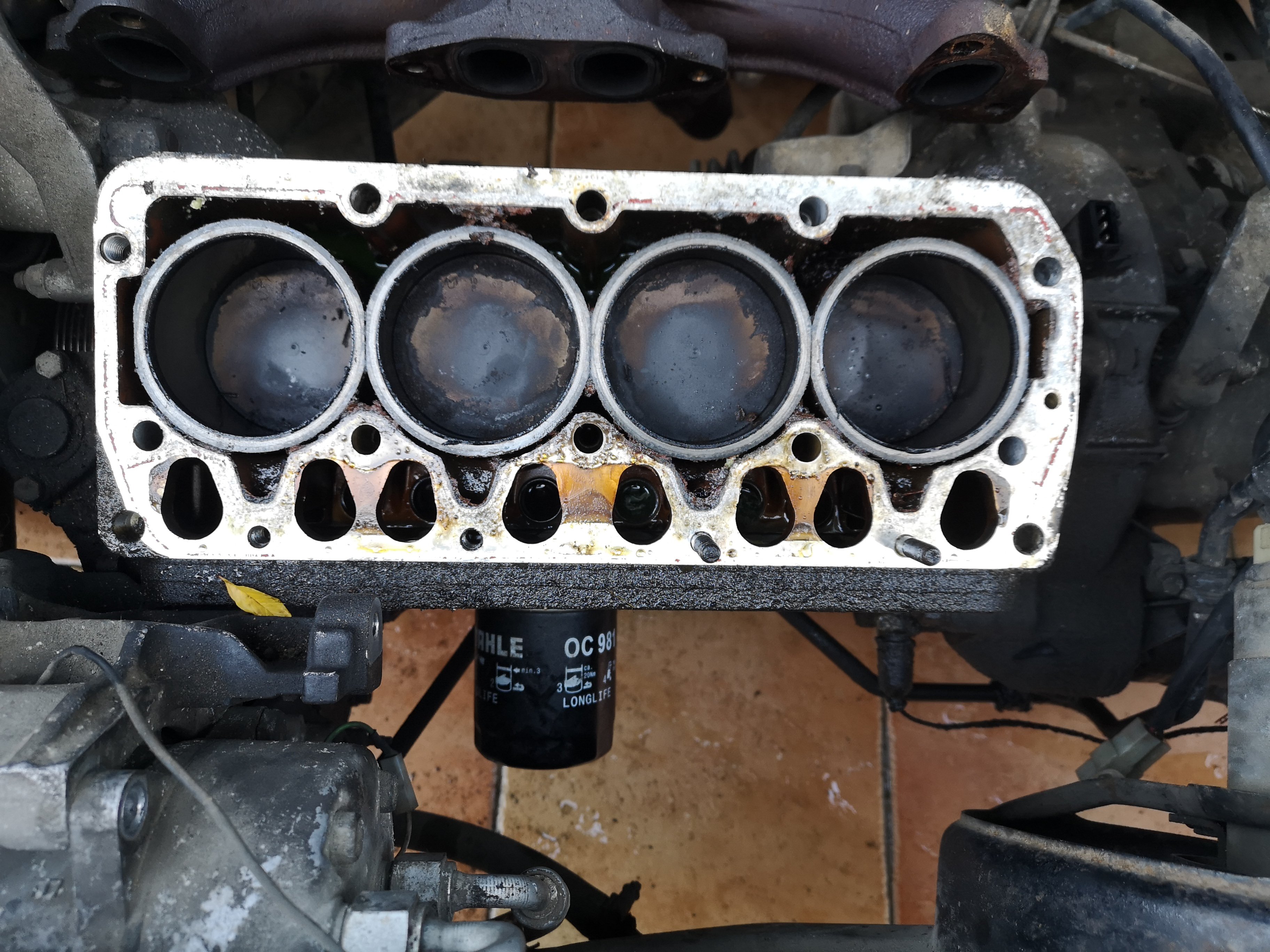

I hope your work is going well.
Here are some questions for the record.
- Your old head gasket seems Škoda made. Is that the original one from factory? Is this the first head gasket replacement job for this engine?
- If not, do you know the mileage since the last head gasket change? Since you are using LPG too, I want to check, if LPG affects head gasket life or not. The are some myths about it. (Myth busting while repairs is fun too)

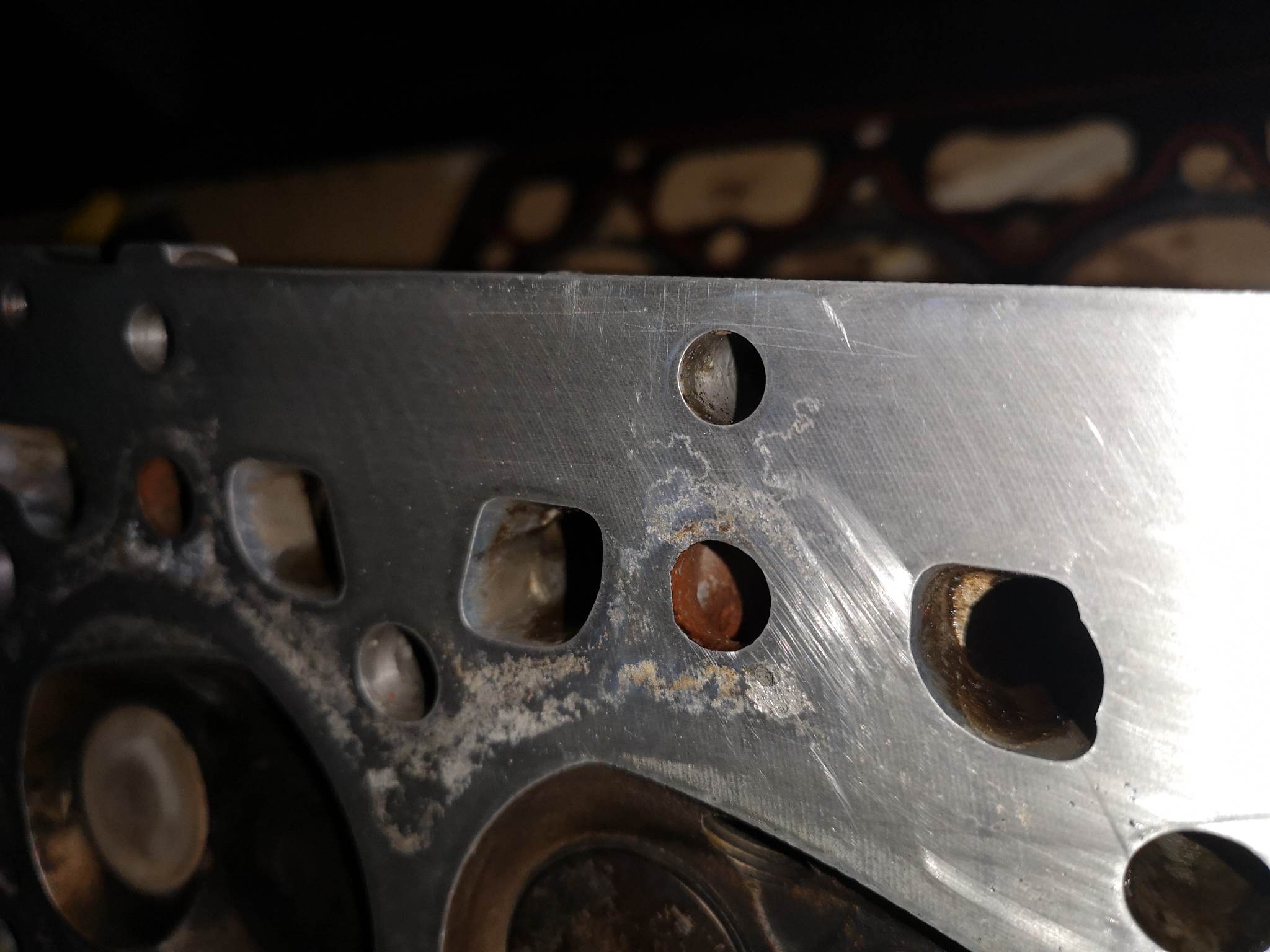

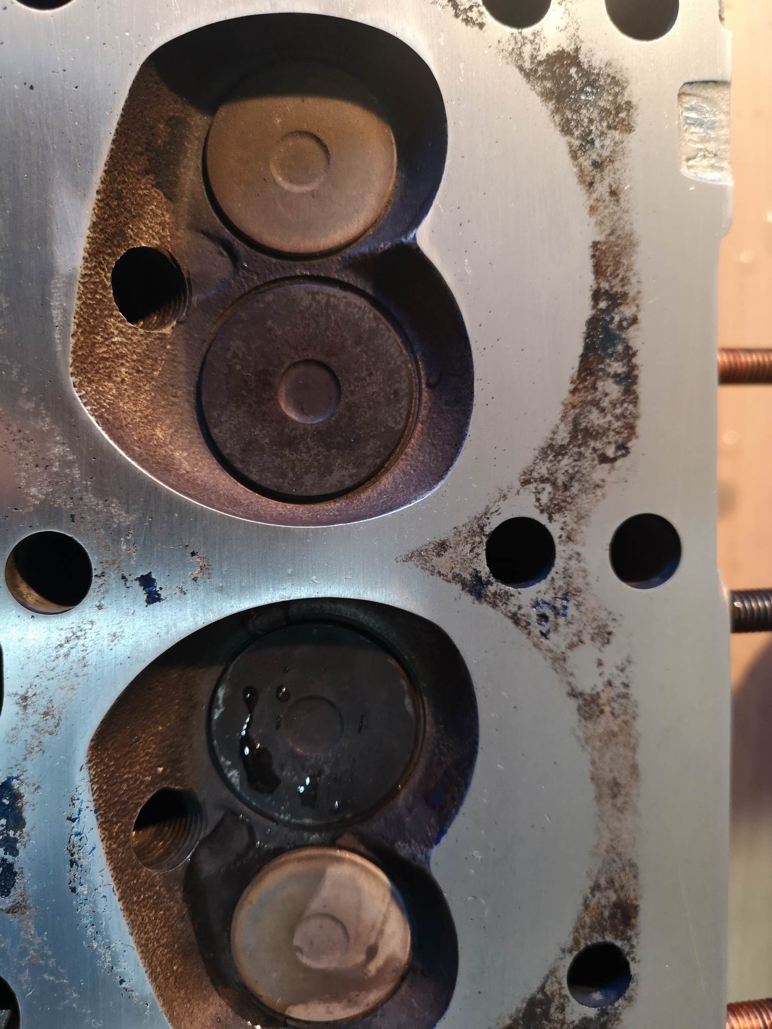

Do you think while the engine head is out, is it a good time to replace freeze plugs? Two of my freeze plugs started to leak after the HGF job and made me regret I didn't change them while the head was out. (There are also freeze plugs near the valve springs.).

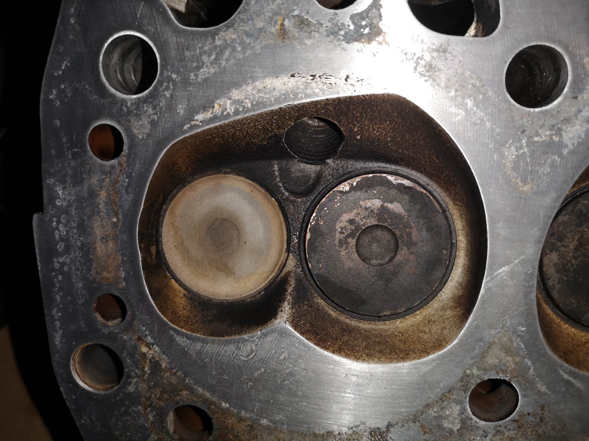

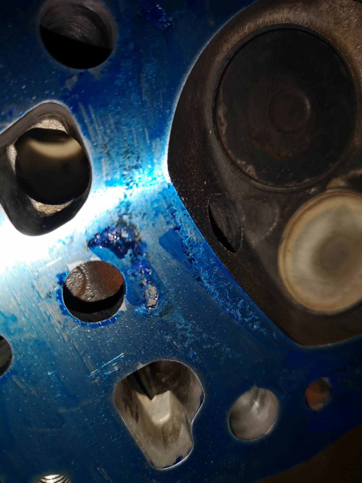

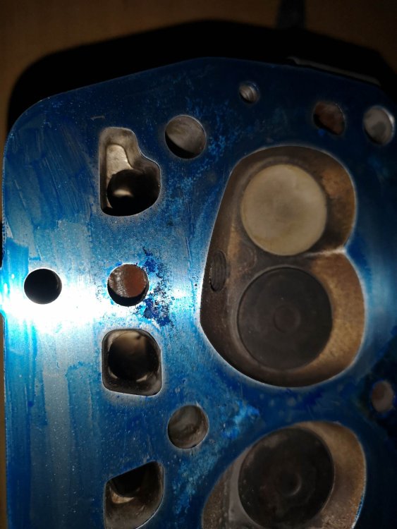

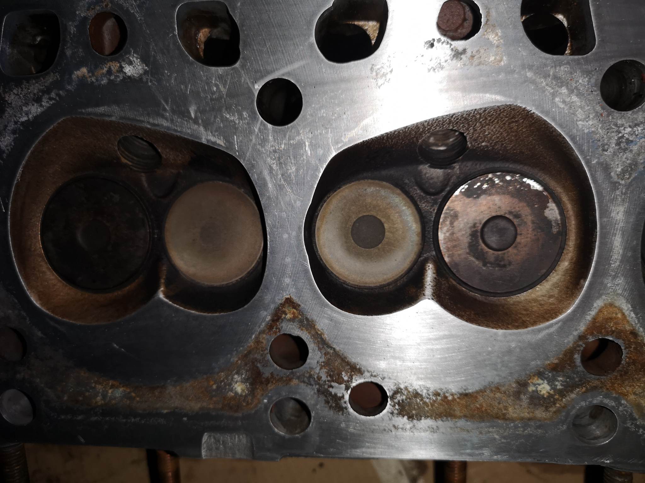

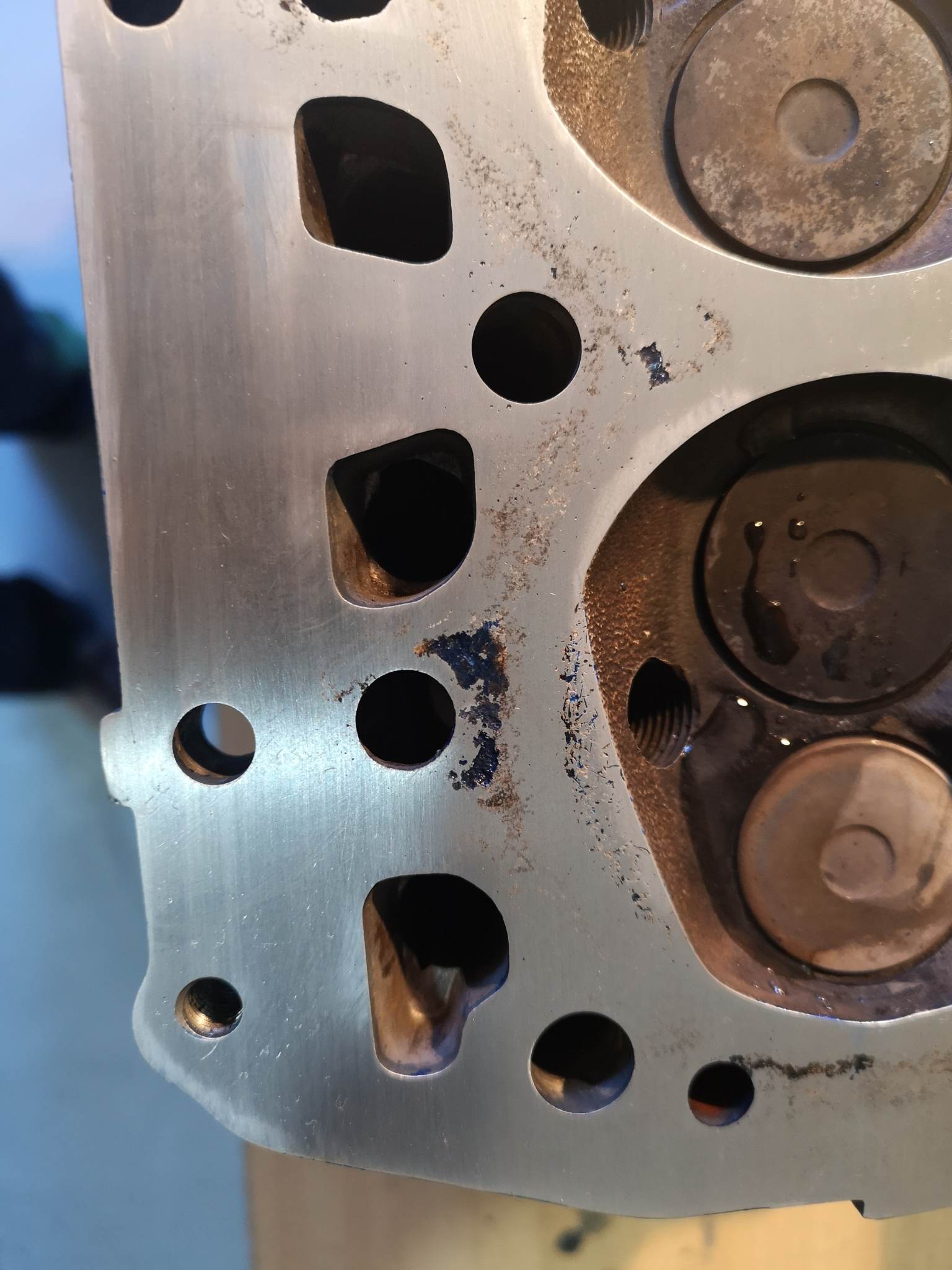

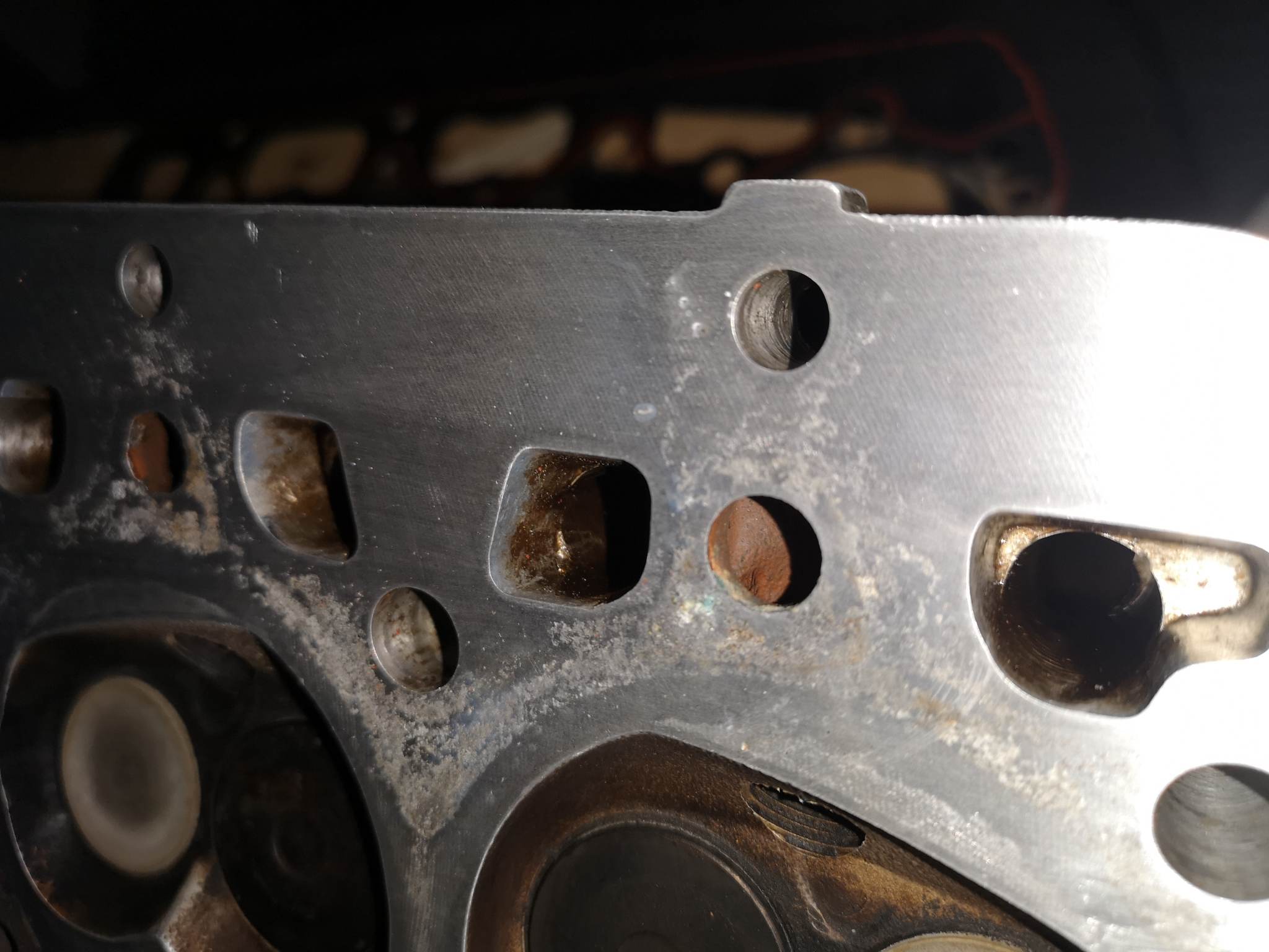

Looks like the head was eaten by the coolant a bit. What coolant were you using? Are you going to get it skimmed?

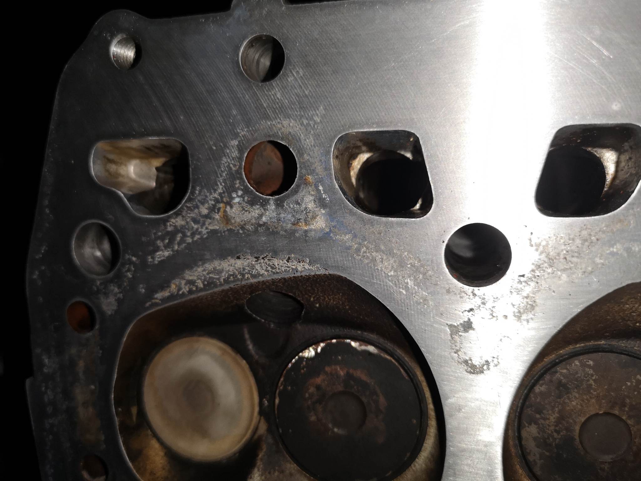

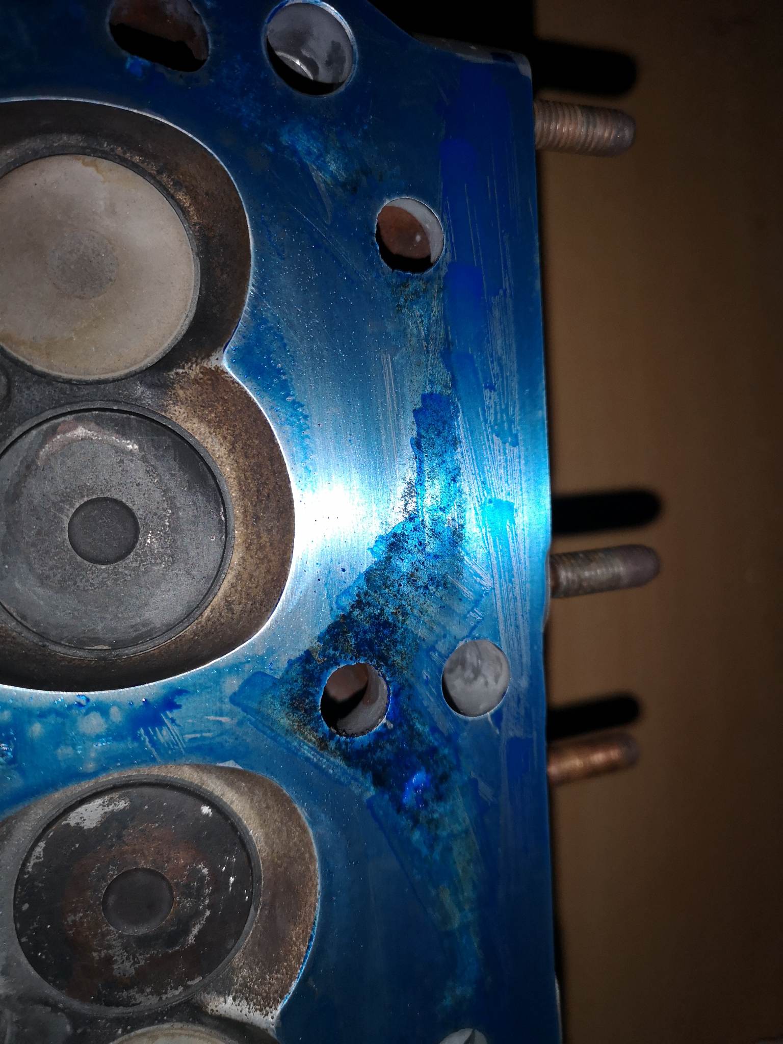

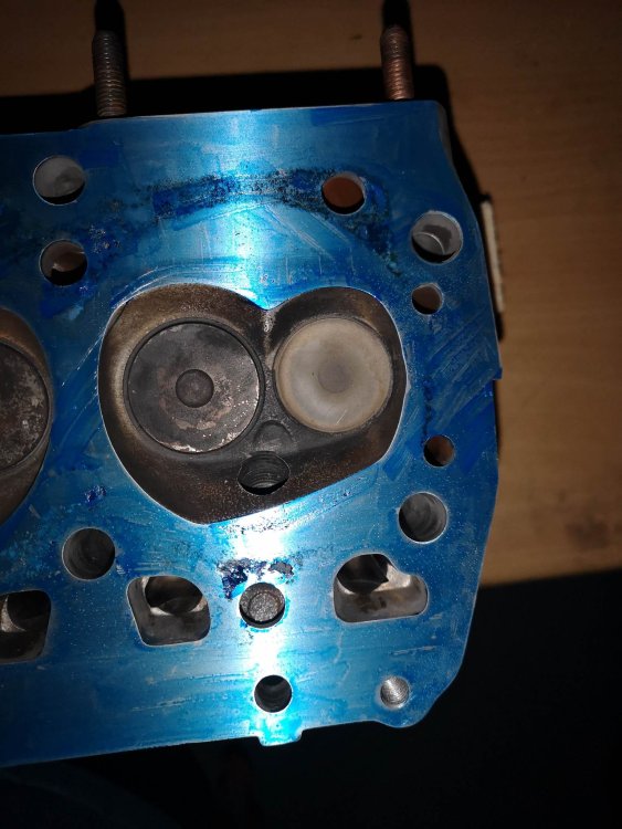

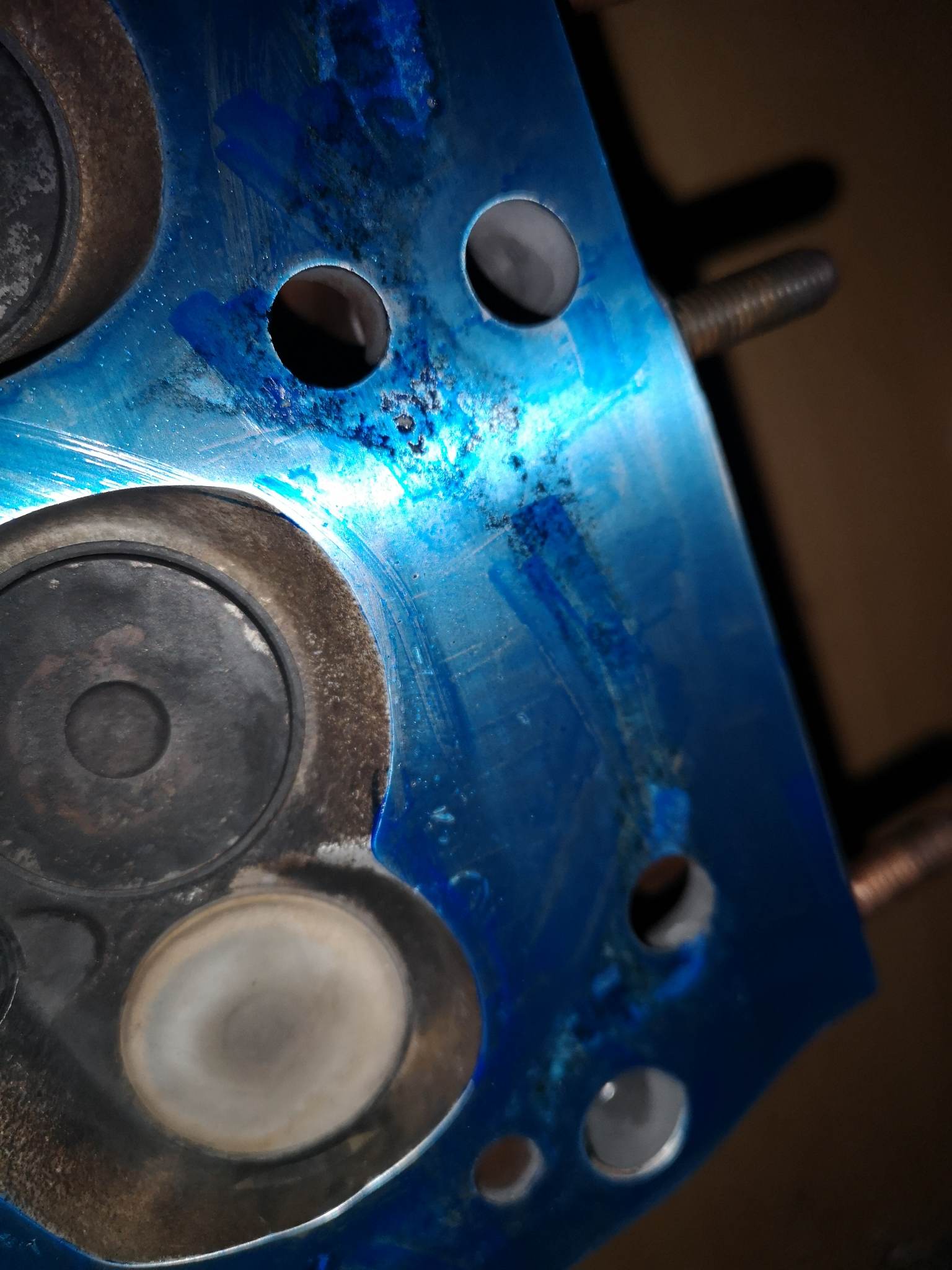

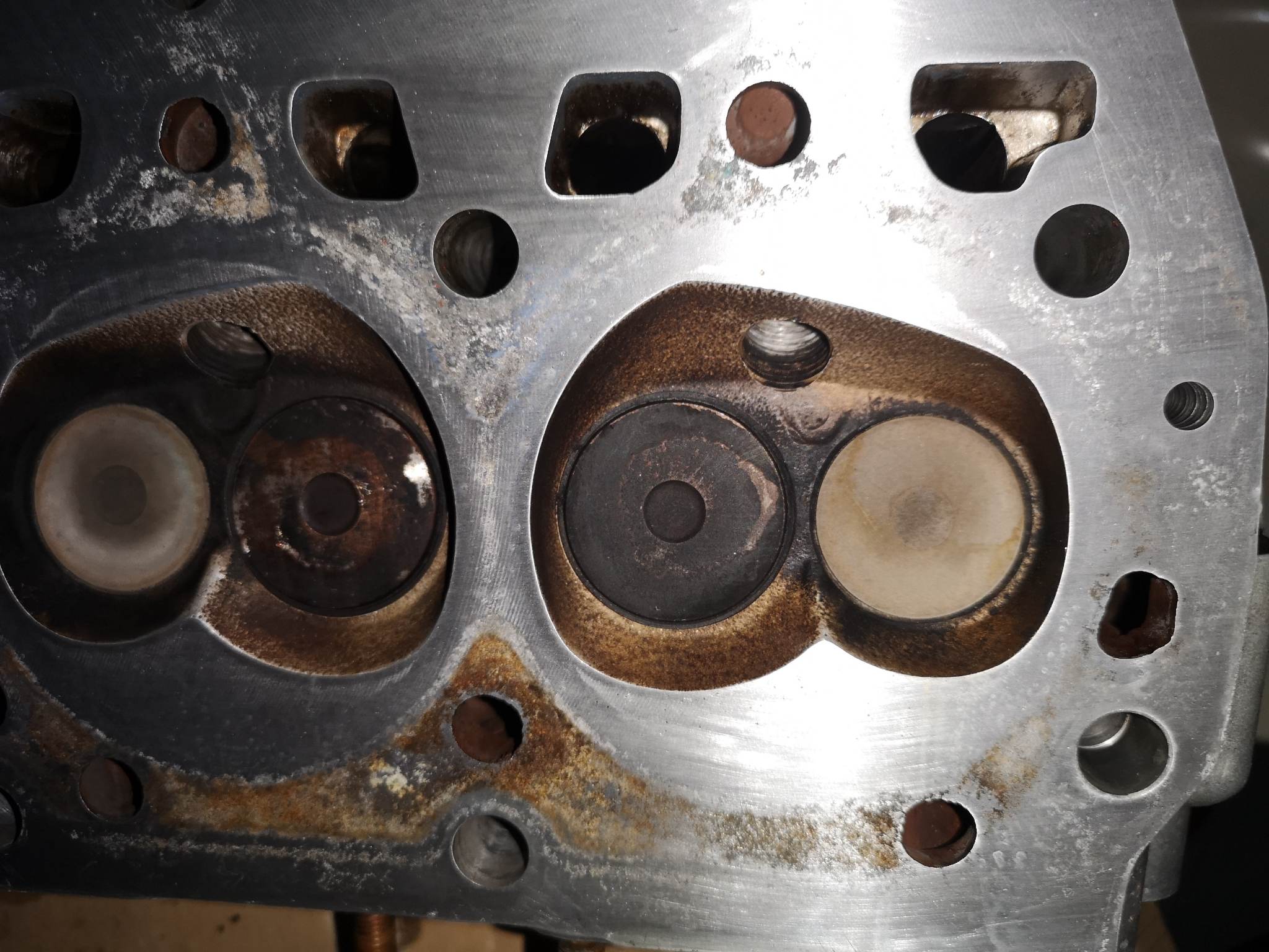

Right now I was checking the surface.
If I remember correctly from other topics, for the longevity of the new head gasket job, the most important damage to check is around coolant passages. Is that right?

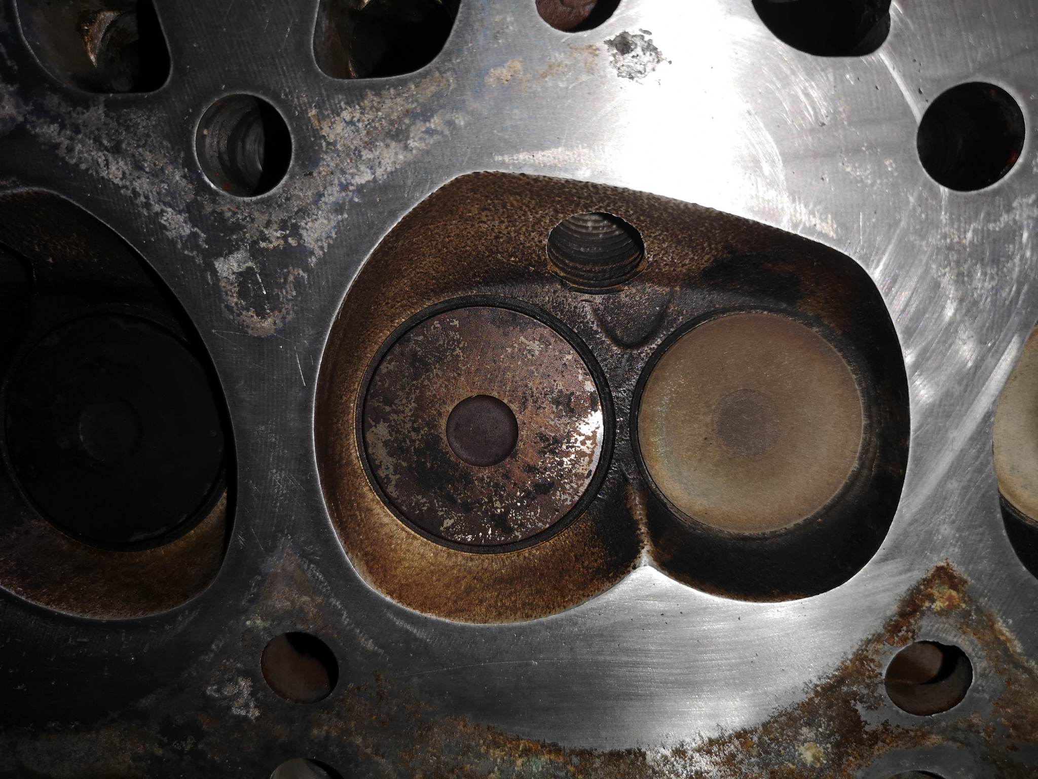

Do you think @Thefeliciahacker should get rid of the deep pits around coolant holes? I marked them with red.
Also there seems to be a little bit of damage on one of the valves. I marked it with orange arrow. How serious is it?
image.jpeg.1f76a5862997cd5866b023915d104314.thumb.jpg.43a0dad5a6ff3bb2d7f55477b7abcfb2.jpg
It has 140.000kms and 24 years hahah.
As long as it is in my possesion i was using ethelyne glycol based stuff.
I will find the protection standarts but they were bs:: something something.
Skimming, well skoda allows for a maximum 0.8mm skimming depth, the deepest pits are more than 0.8 even if i go down to the skim marker they are still going to be present.
Since the head is not really warped I think im just gonna clean it really well with sandpaper on a glass.
0.01mm is the amount I am aiming for and I will see after that.
It indeed is I am going to report back with conclusive findings!!!
Good catch I am going to check right now
Valves are perfect must have been debries, plus checked for leakage and they seal perfectly.
Now the coolant passages althought corroded I dont think would cause any sealing issue since its far away from either the pushrod galleries and the fire rings...
But I want your opinion now and after I removed 10μ then I will post photos with the straight edge and a 0.04mm feeler that even now is a no go
Edited by Thefeliciahacker

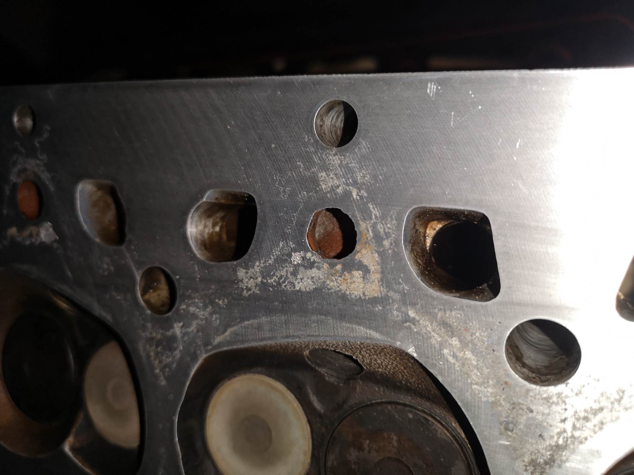

Obviously will know more when I remove just that little bit more, for now the head has been hand cleaned with 600 grit paper.
So really no material was removed, you can see the original milling marks
Indeed it is original, yes FIRST head gasket change and hopefully last.

Compared with areed's head even after being skimmed yours is a lot better for corrosion.
I agree.
For now, I'd take it for a skim.
Are they over 1mm?

7 minutes ago, R_Blue said:
Are they over 1mm
The deepest ones yes

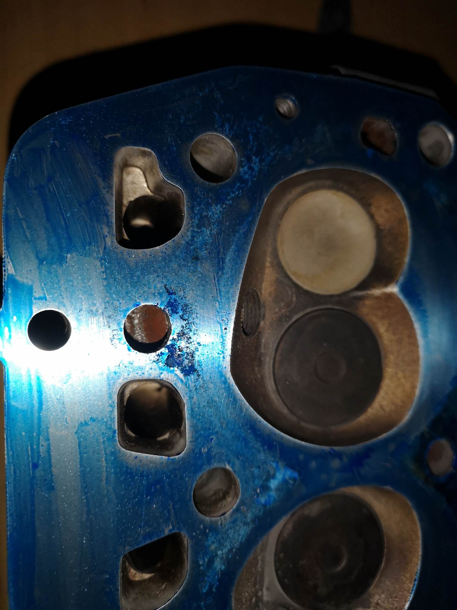

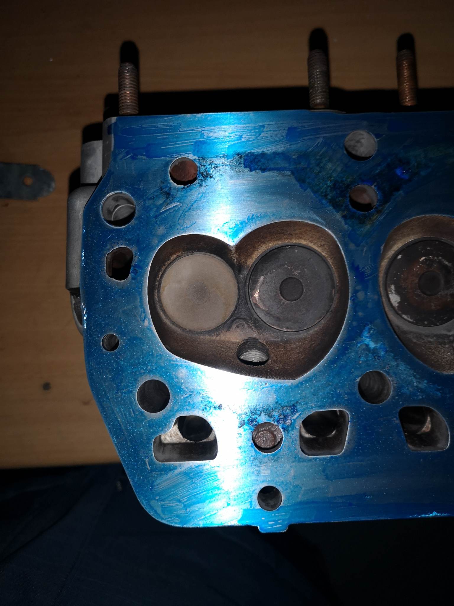

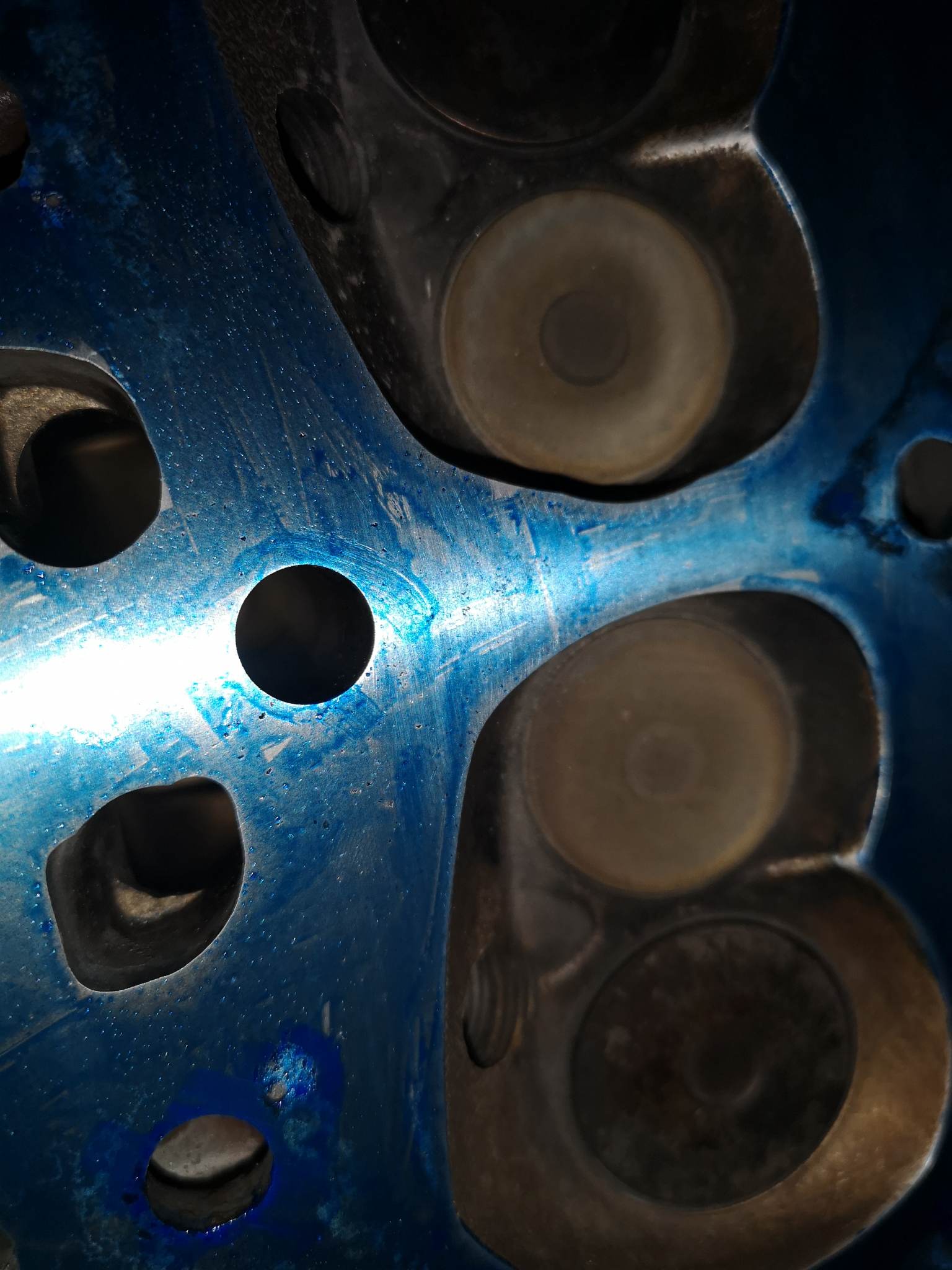

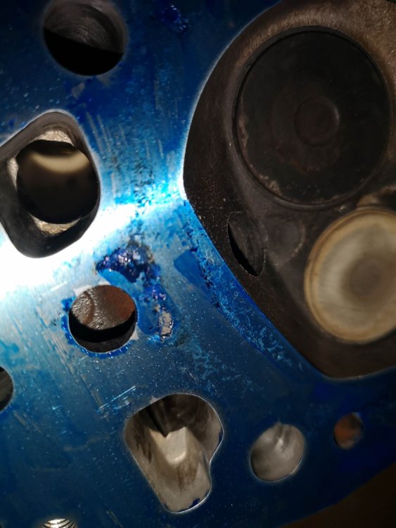

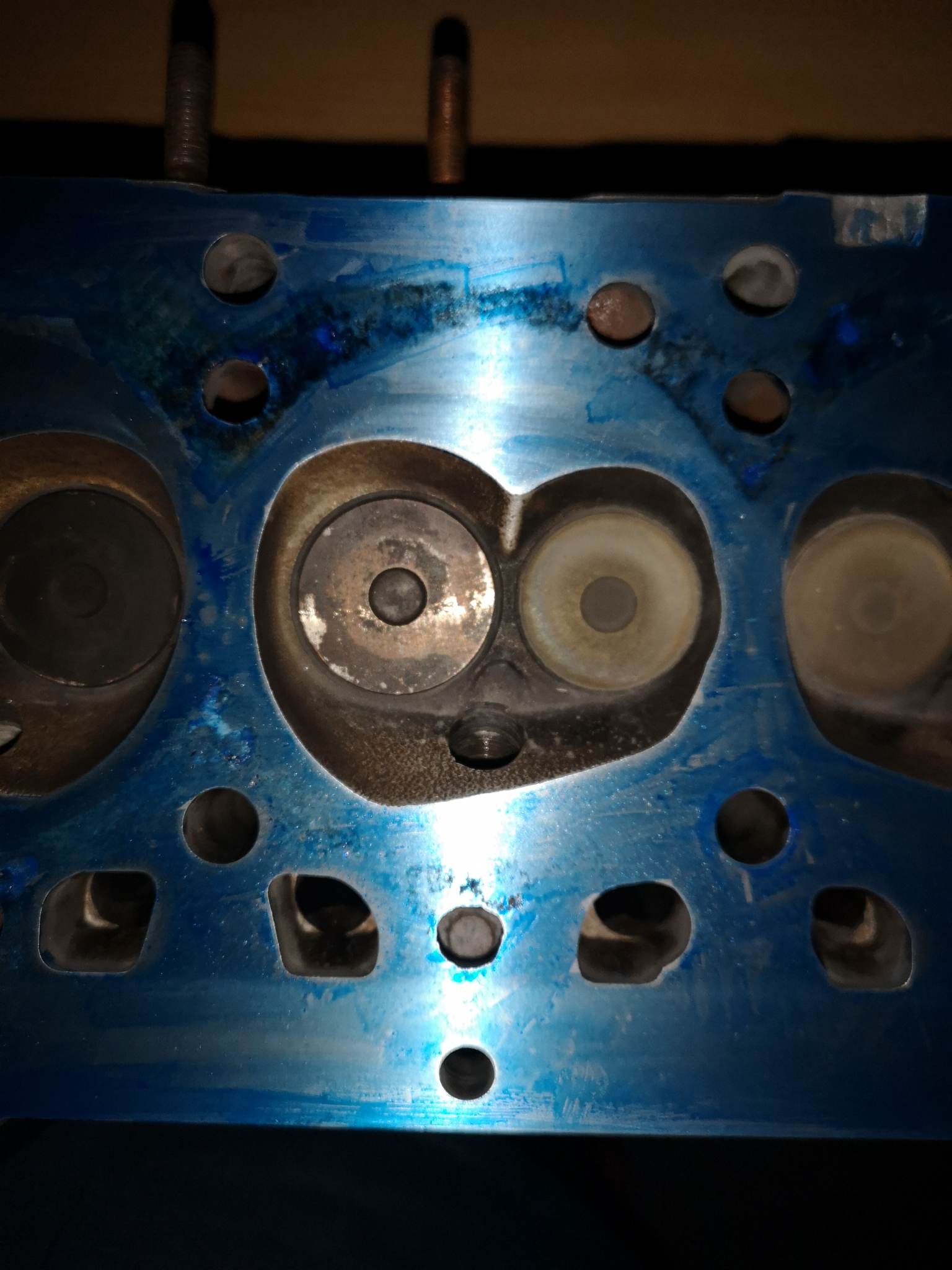

Now after continuing sanding with 1000grit
Still wapred though

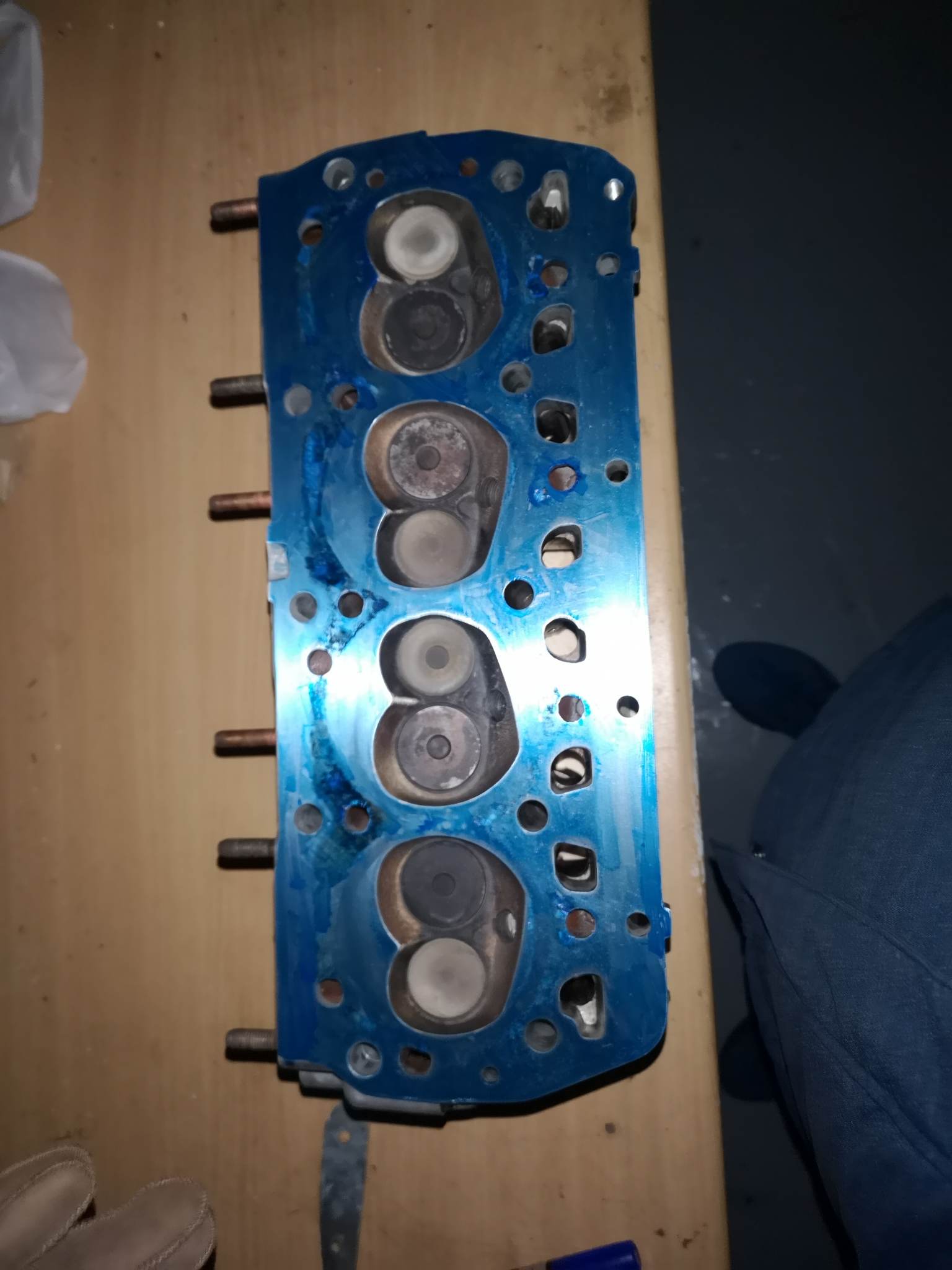

Tomorrow we are going to know for sure if the head is warped.
My gut feeling is that the head IS SUPER FLAT,

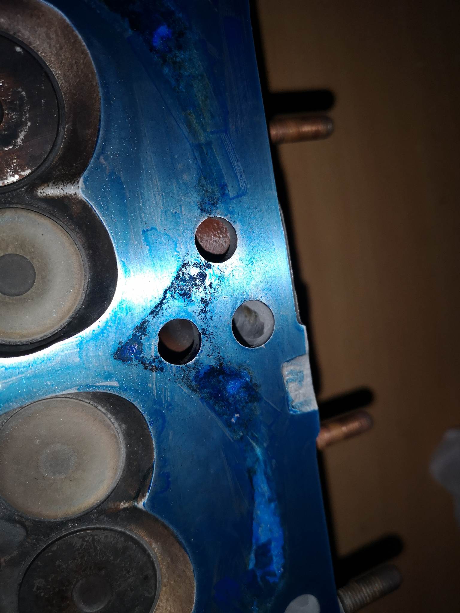

today I went home with the 400 grit
Definitely, as long as you have a suitable plane surface to rub the blue off against.

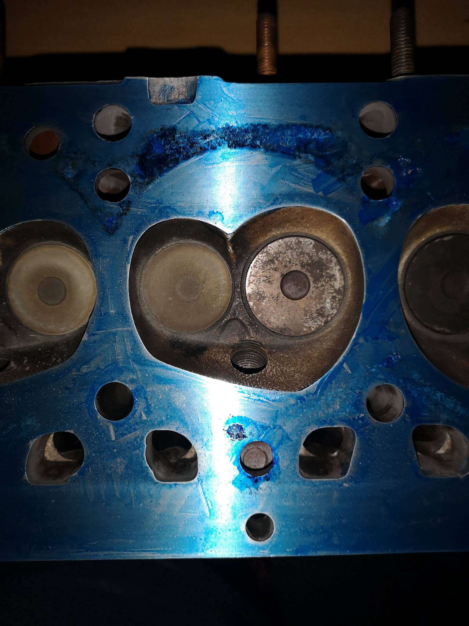

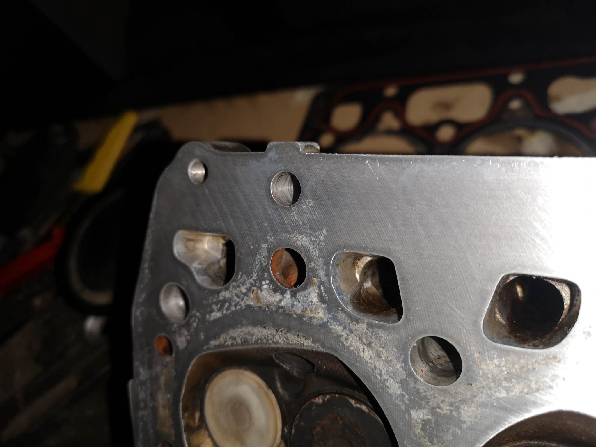

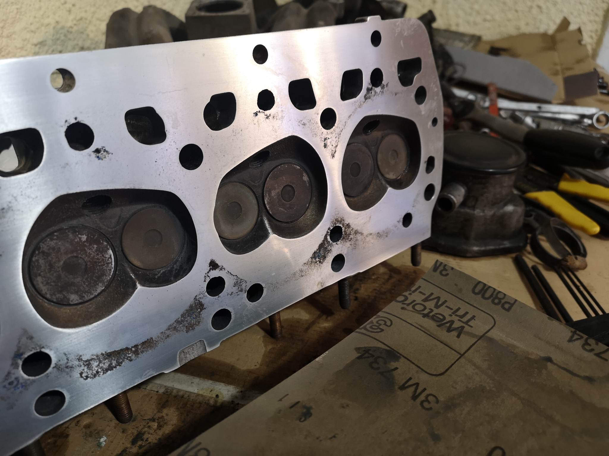

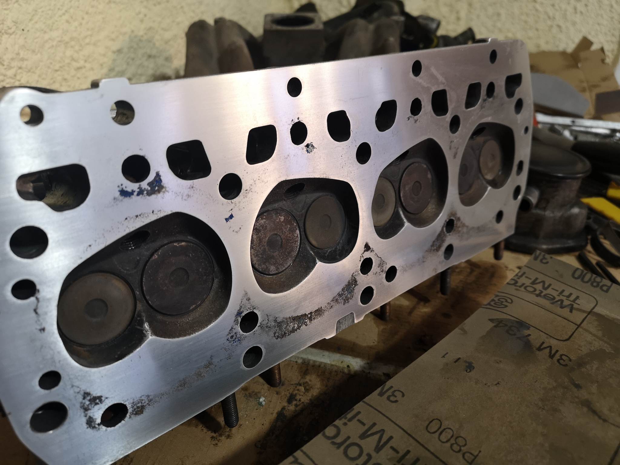

Head is ready very very flat the top down photo shows the overall flatness after just 4 passes to scrub the marker down
Good work!
Grinding limit indicator notch shows that, you can still go for more if you want it.
How do you know how much is enough? Just the flatness?
Flatness and surface finish, I will try to get some better lighting photos tomorrow.
I dont think there in any reason to go deeper, the head is going to seal perfectly
