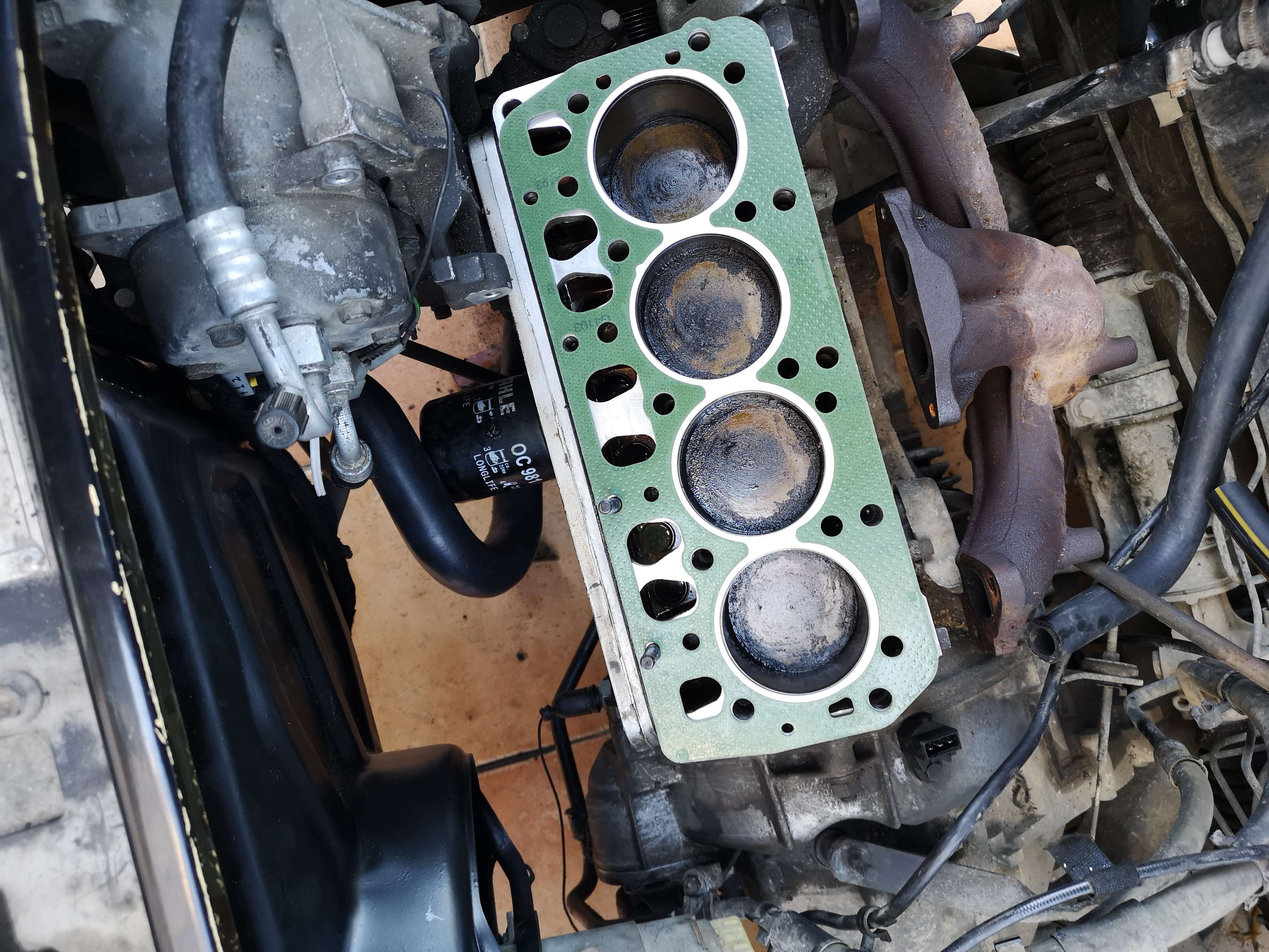

Head is on valves adjusted.
Although I lubed up the bolts some of them felt marginal so I didn't get the full 180deg more like 170ish.
But I guess that is much better than snapping one.
20nm (since my torque wrench is torsion type it may have been around 25 but skoda gives 20+-3)
90deg
90deg
Edited by Thefeliciahacker

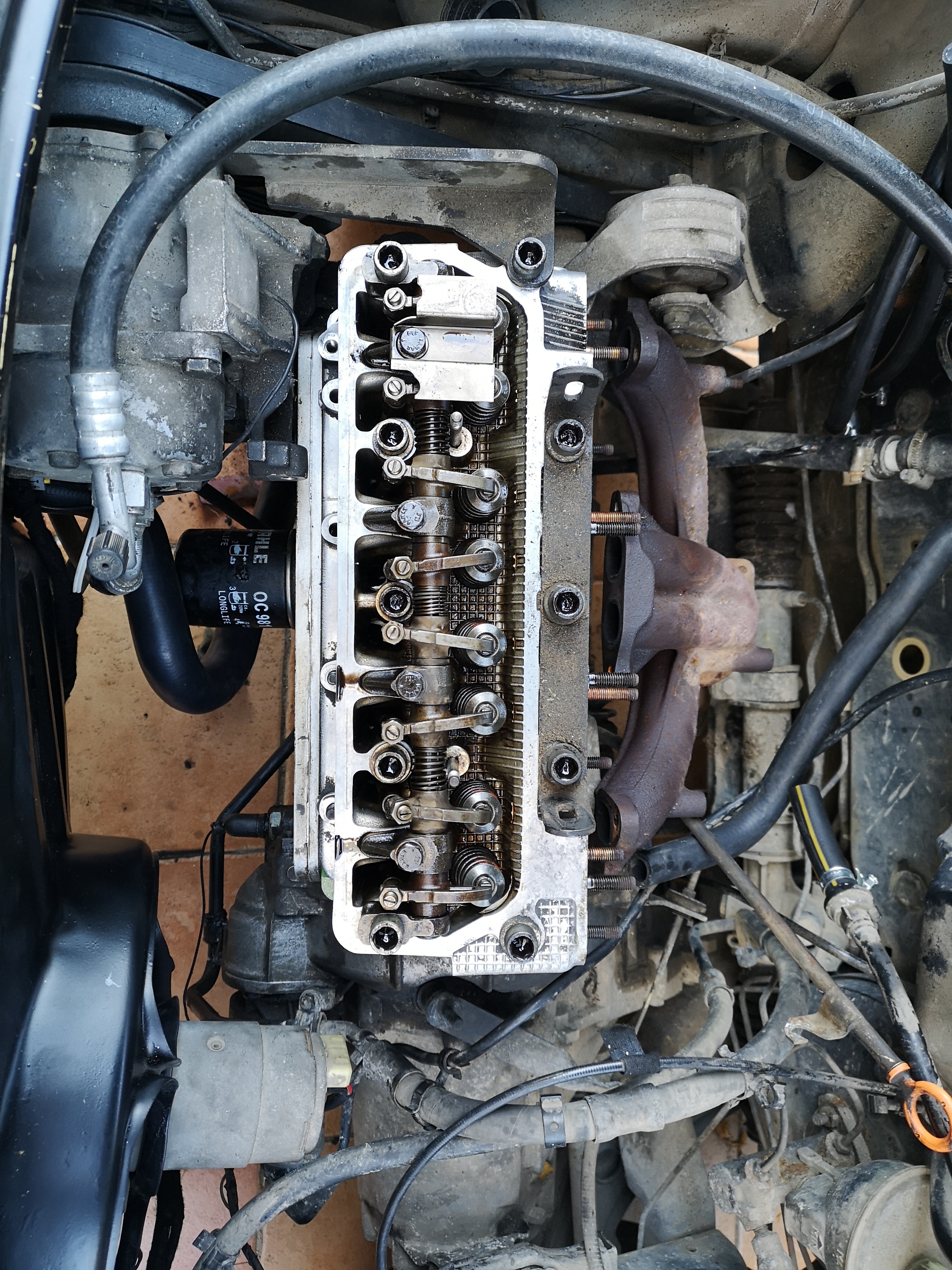

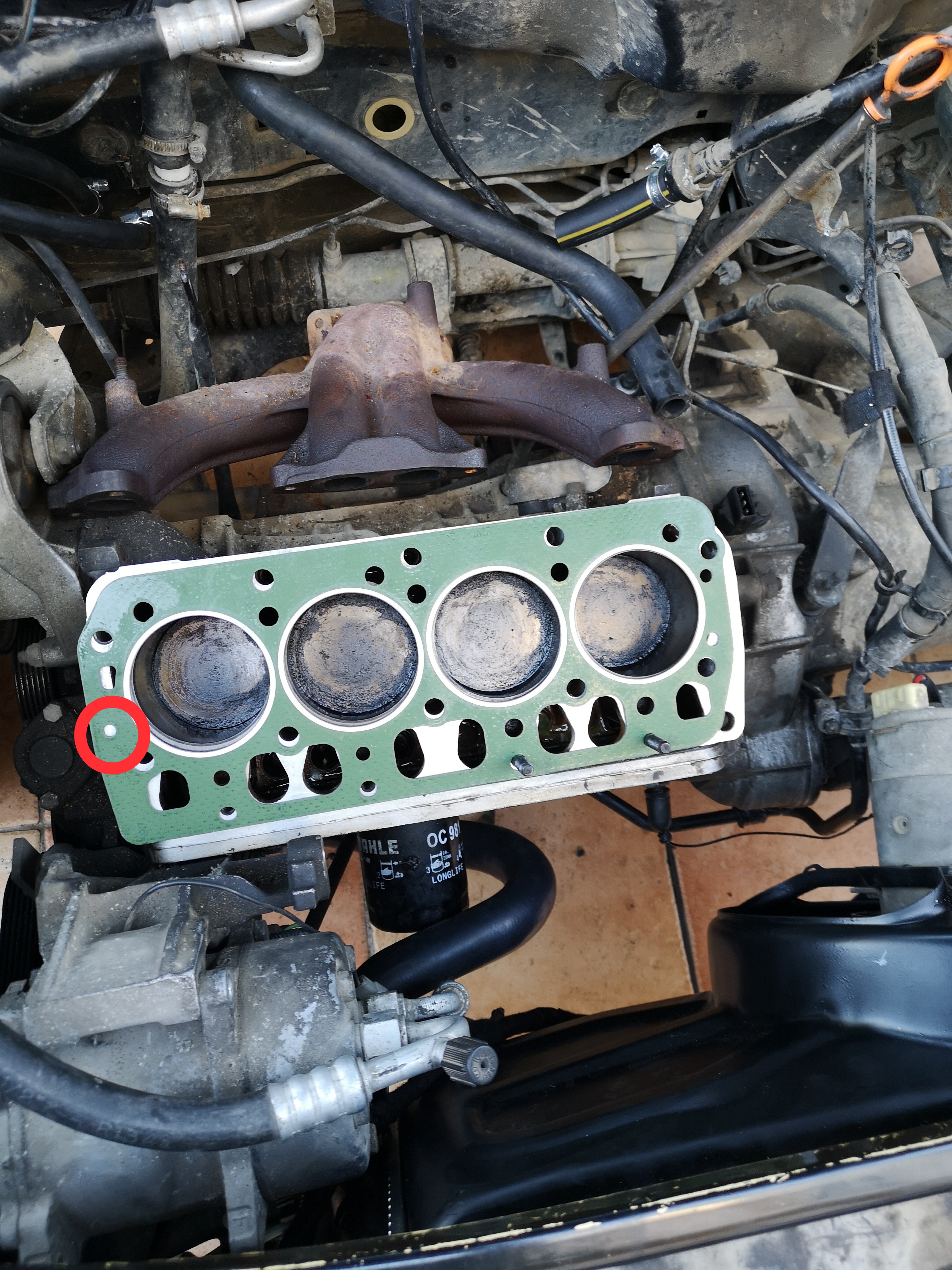

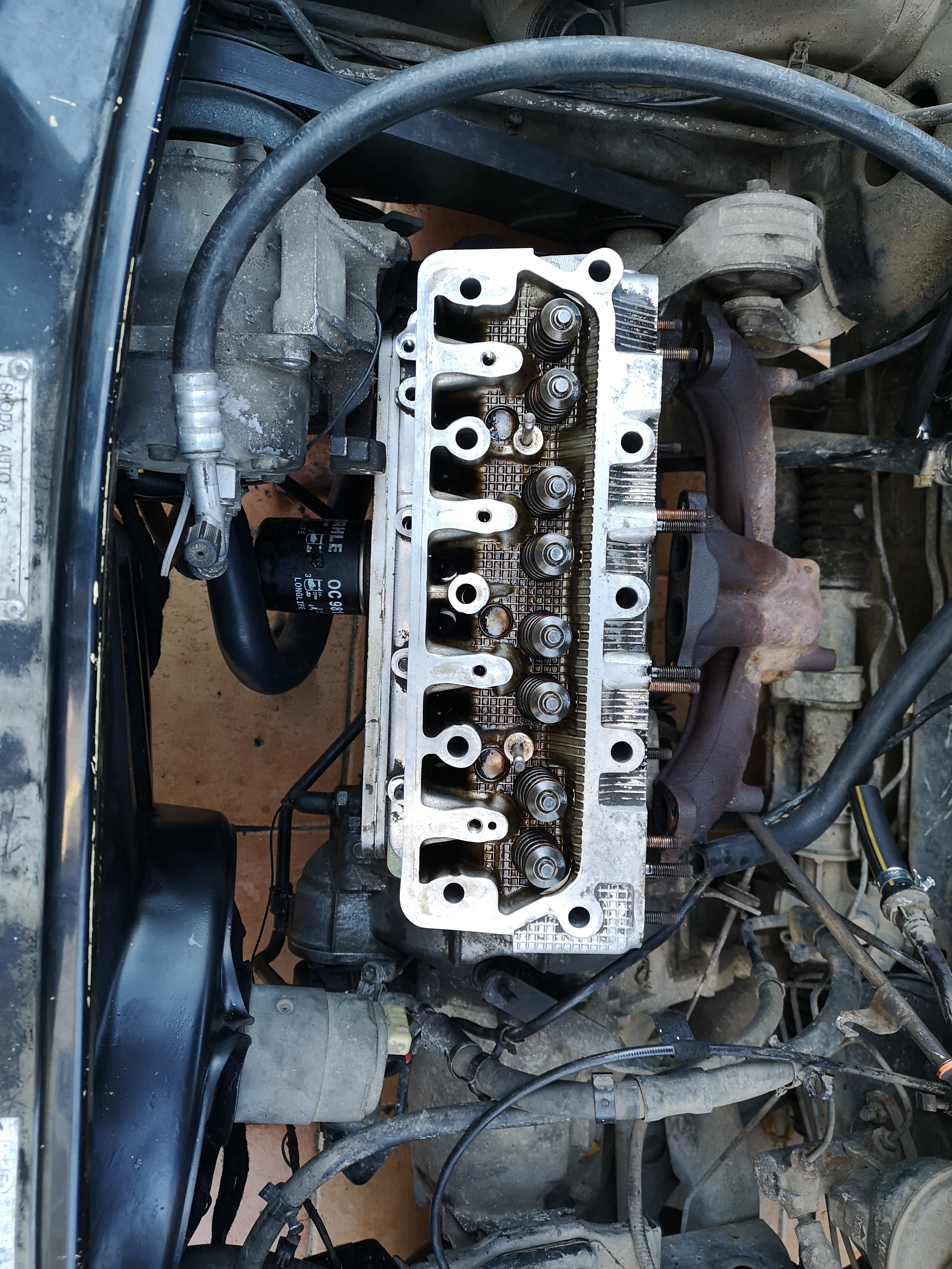

/cdn-cgi/mirage/b2a6ebb5516a62a813ba256bbceb36dd8e83d541906d5a304225e76358d80b2b/1280/https://www.briskoda.net/forums/uploads/monthly_2023_01/IMG_20230107_132456.thumb.jpg.ce9c4c0217a6ee1790999e846ca9f48b.jpg

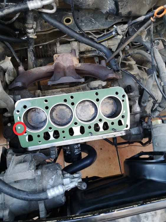

Did you doublecheck the position? It looks like the oil channel hole is on the oposite side..

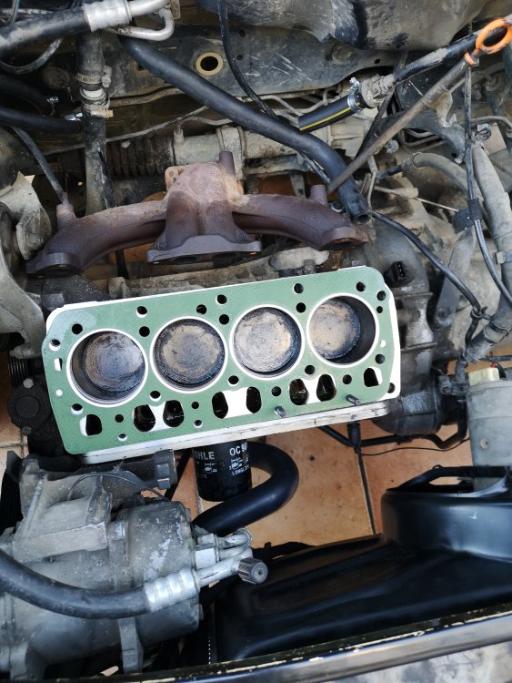

Haha my friend you are VERY attentive, that photo was a set up, to see if someone would catch it!!!
Here is the real deal!
Ofc, everything was done to as close as I could by the book

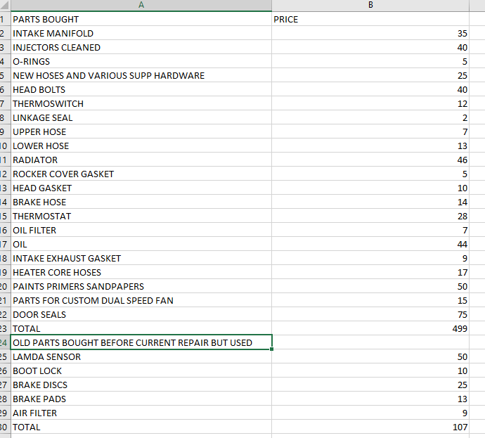

Just bought a set of head bolts!
Last one on Autodoc.
Mislabeled so it didnt appear that it fit my car!
I would have ordered it sooner so not to pay the 13 euros more.
God damn it Autodoc
Will see how long this HG will hold.
It is a PTFE coated payen so simply the best on the market!
Anyhow, will have a detailed breakdown of all the parts and the cost involved.
But I dont think it is more than 500euros

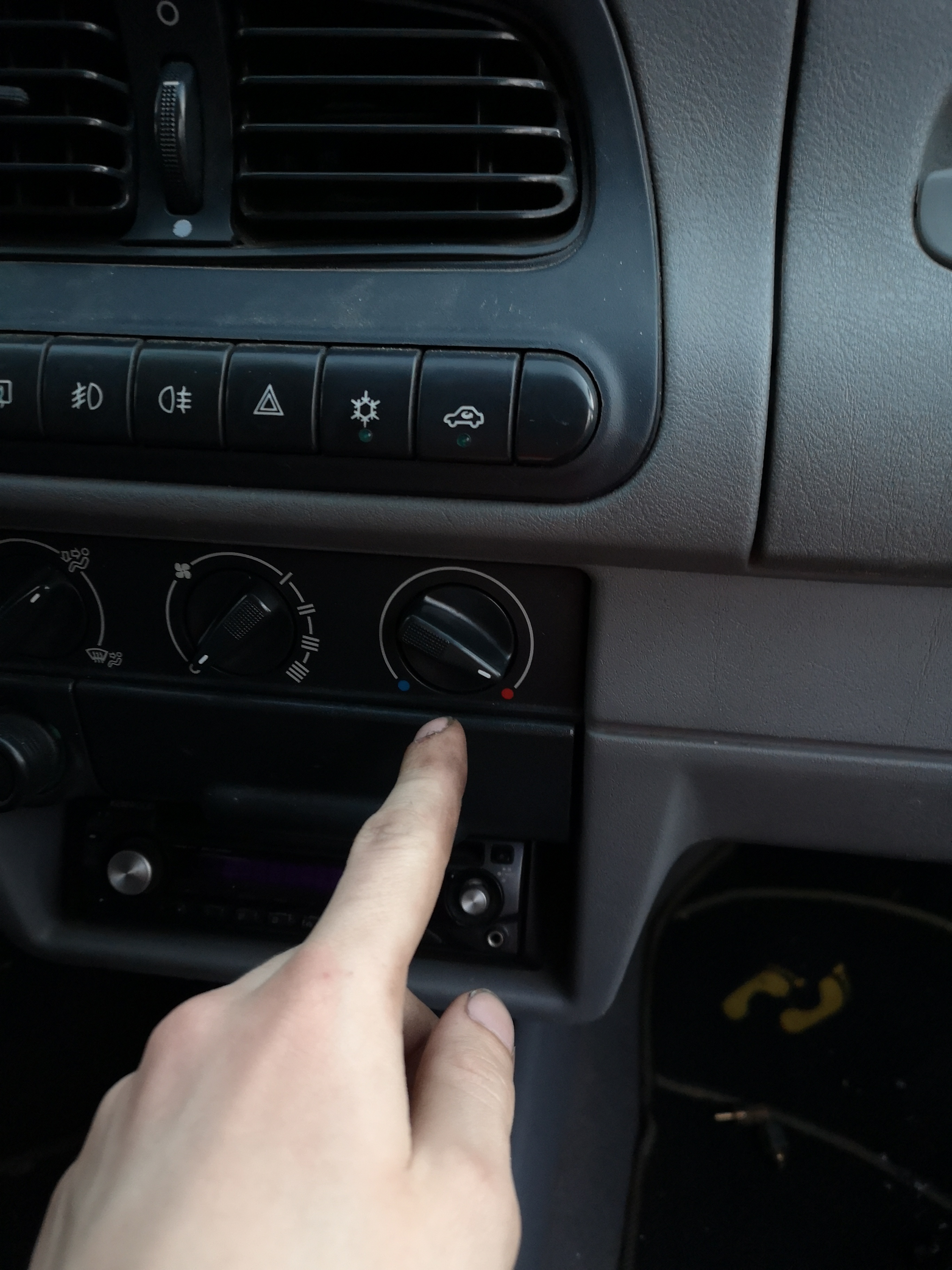

This knob appears very stiff when turning does anyone know how to free it up!

You can pull it out and use some silicone spray.
Or GT85 as it's more versatile for other uses on car and home. - https://gt85.co.uk/gt85-original/

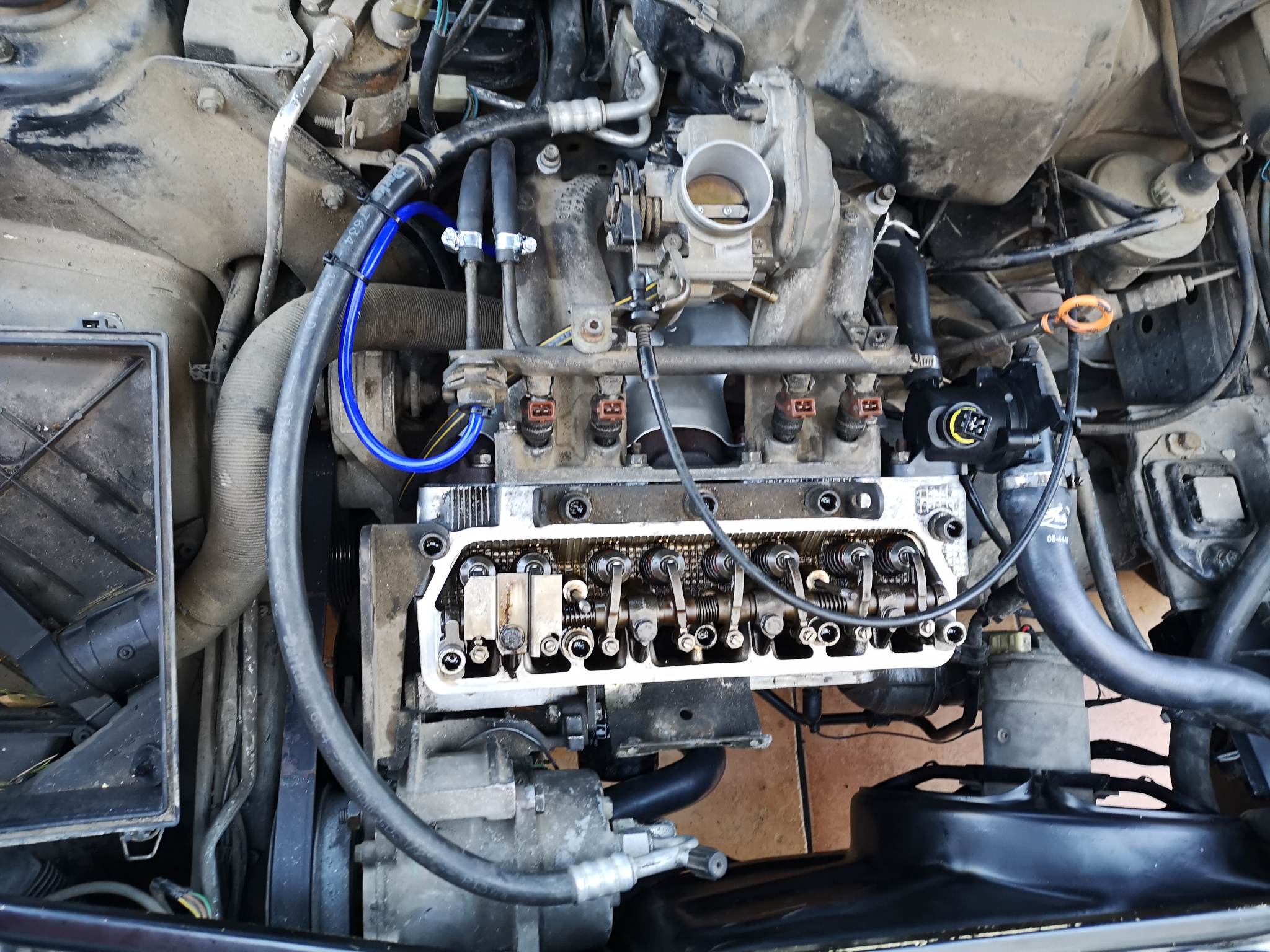

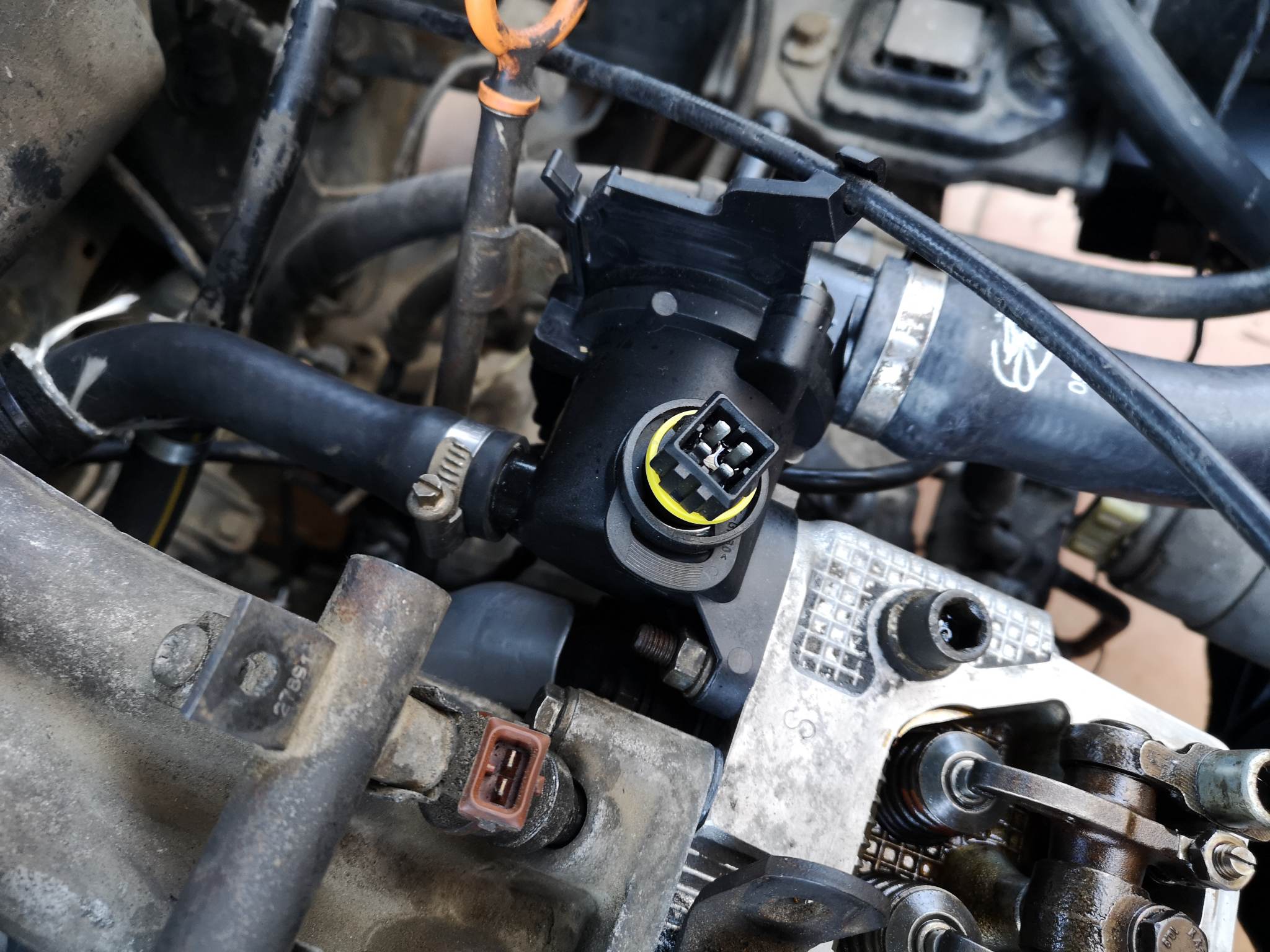

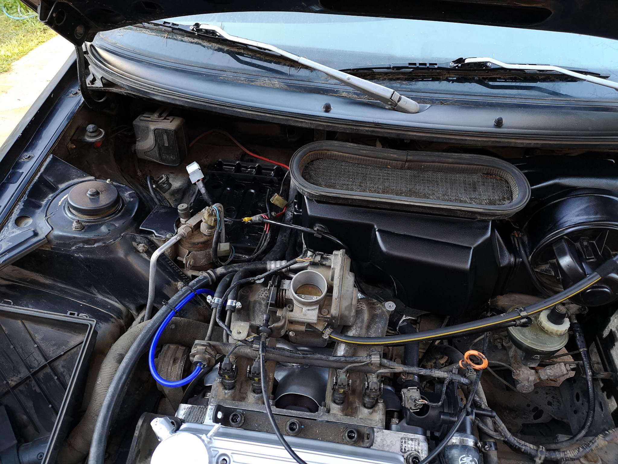

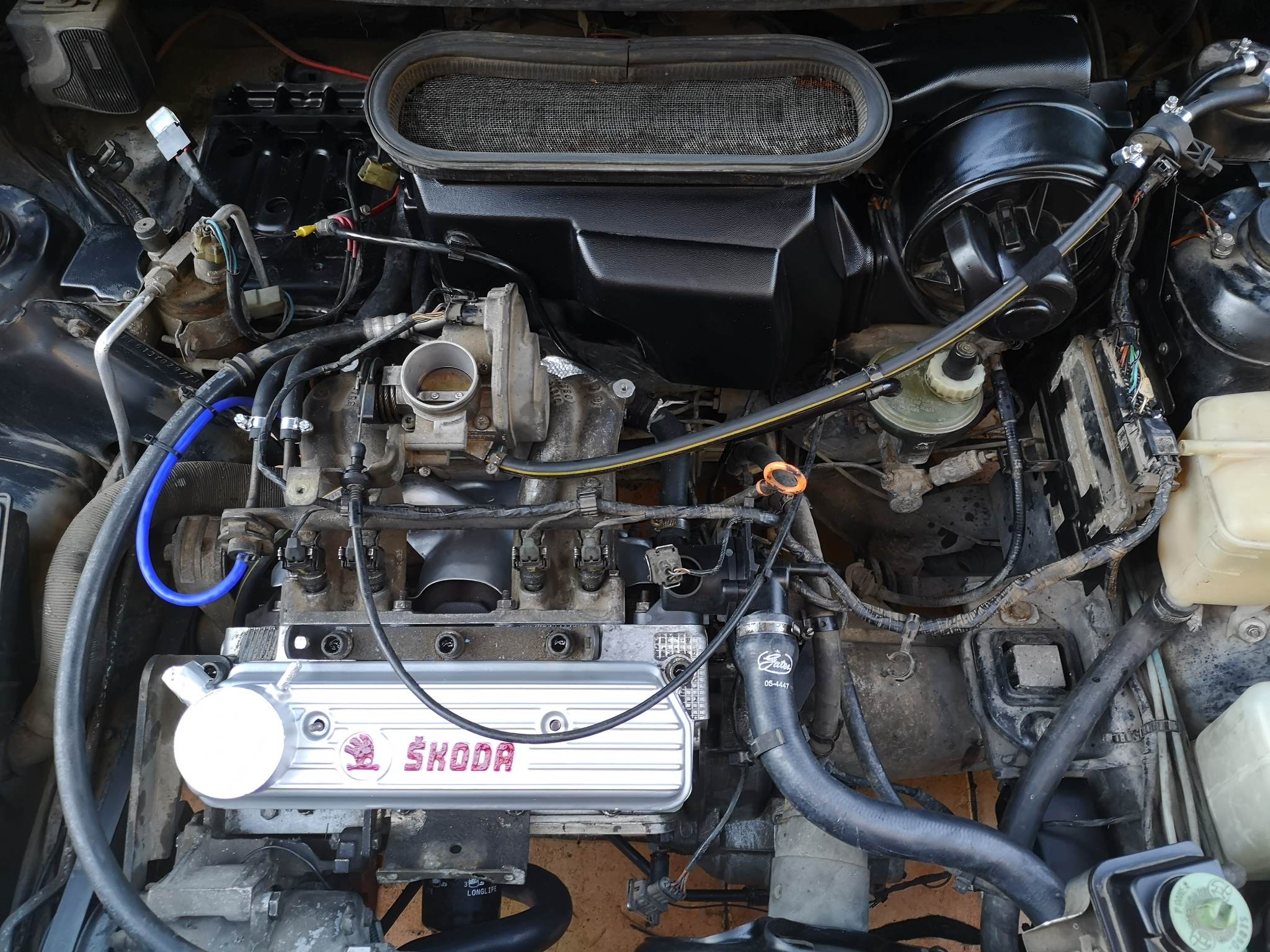

Some photos, lets hope I can make it work properly!!
Startup video will be viewable when its done uploading.

14 hours ago, Thefeliciahacker said:
where should I use it?
Where you would use the silicone spray and instead of WD-40 - sorry I've no idea what mechanism is used behind the heater control knob but you can spray GT85 to lubricate plastic against plastic or on cables (for electrics), etc..  Obviously you must first find out what is causing the knob to be difficult to operate otherwise just lubricating things may cause something to slip, jam or break.
Do you not have a parts catalogue diagram and/or list of heater / heater control parts to give you some idea?
Edited by nta16

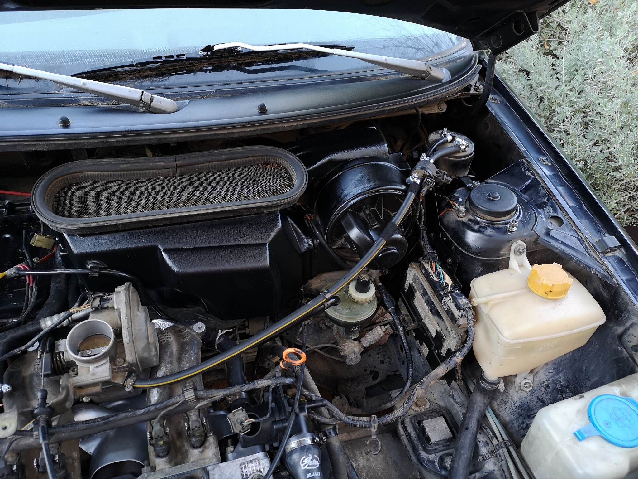

15 hours ago, Thefeliciahacker said:
Do I see the cables behind it?

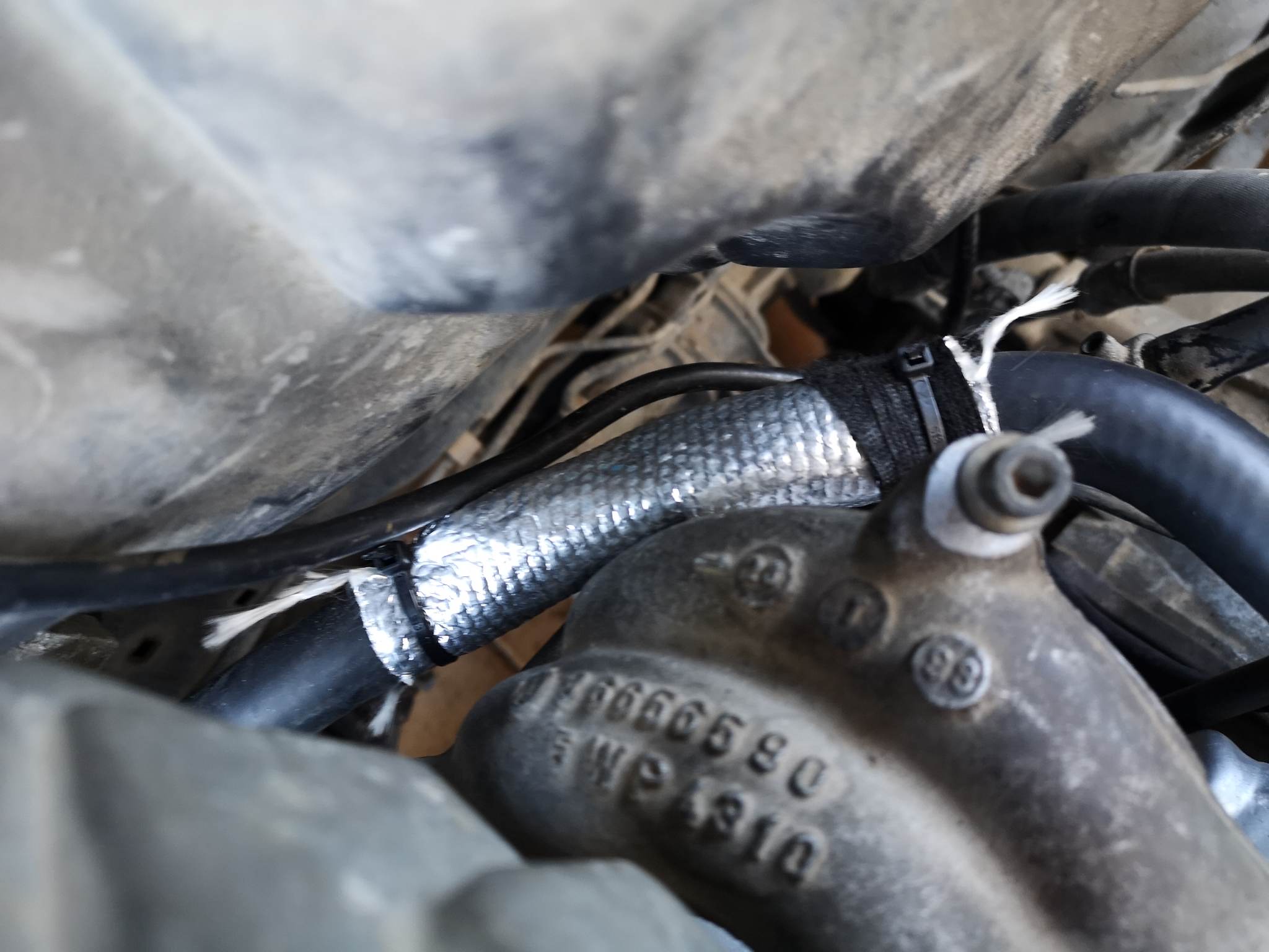

I find this photo.
I don't agree with the plastic tie-wraps and the fabric tape close to the manifold.
You can use metal tie-wraps of aluminium high temperature adhesive tape.
In the past i had problem with odour because a plastic part which was around the cable of Lambda was getting overheated and every day i had a bad smell inside the cabin.
https://imgur.com/t0X2FmX
PS: the slippers on both of you was characteristic. 😉
That's the intake manifold
The cables should be acessible if you remove the black portion of the dashboard.
Of course is but in the summer period here in GR gets hot, it gets too much temperature from the exhaust manifold especially in long distance trips.
