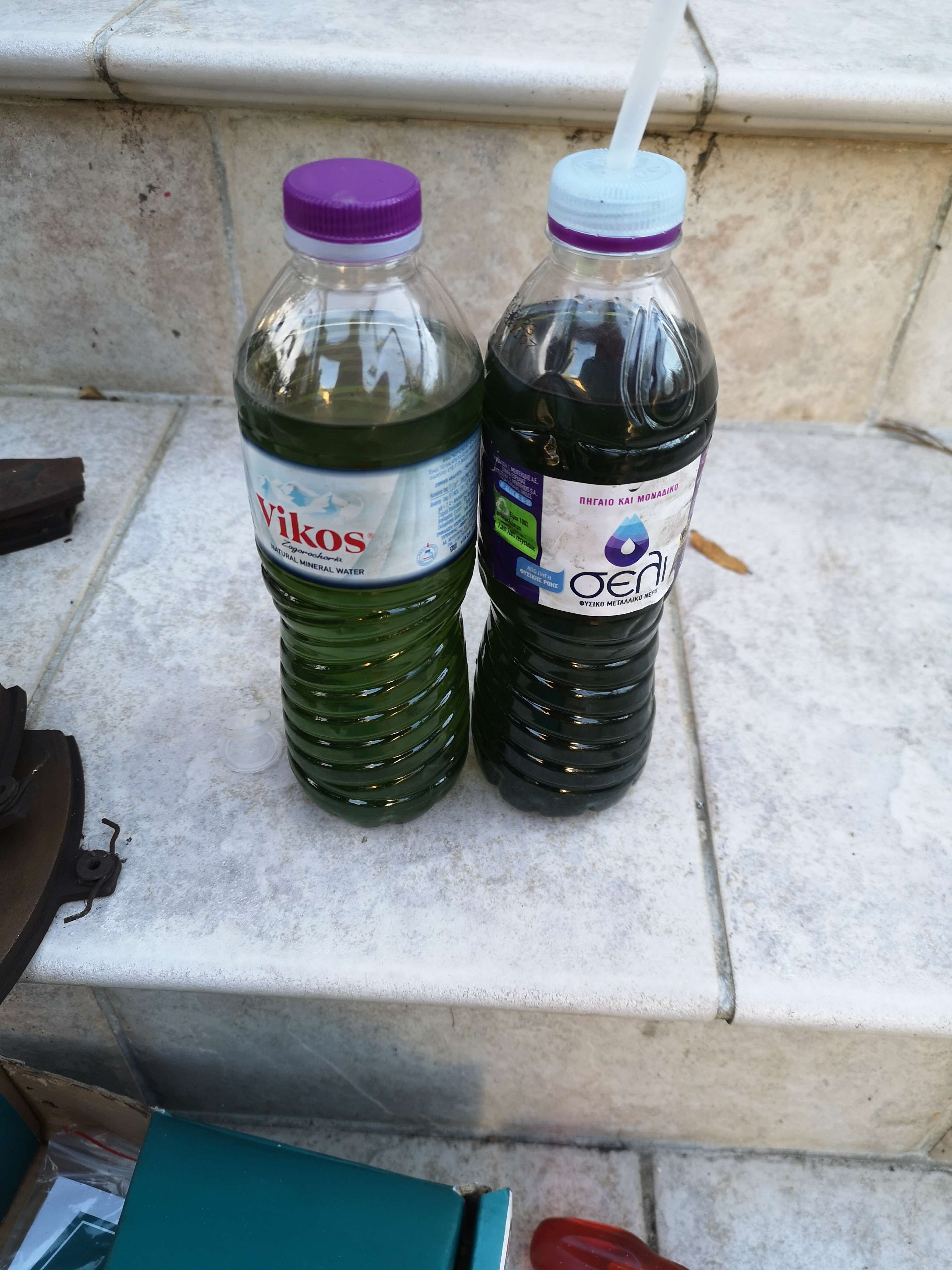

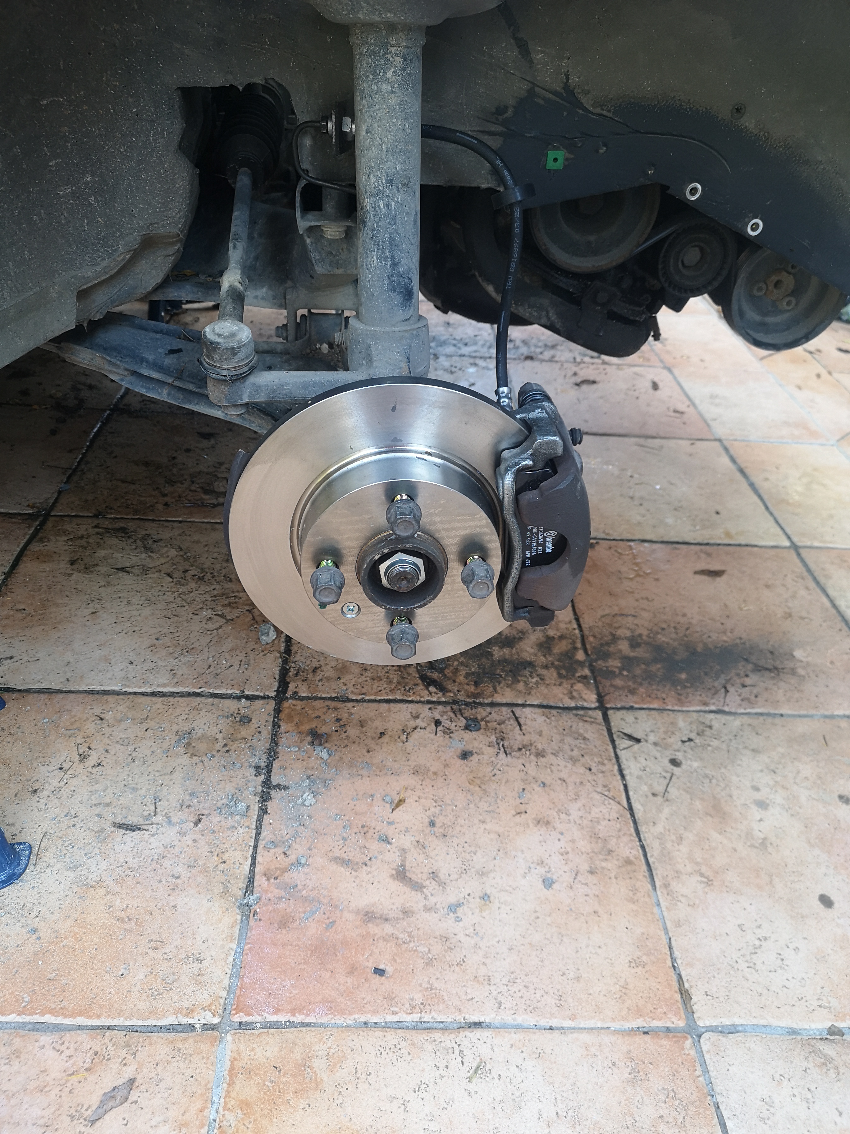

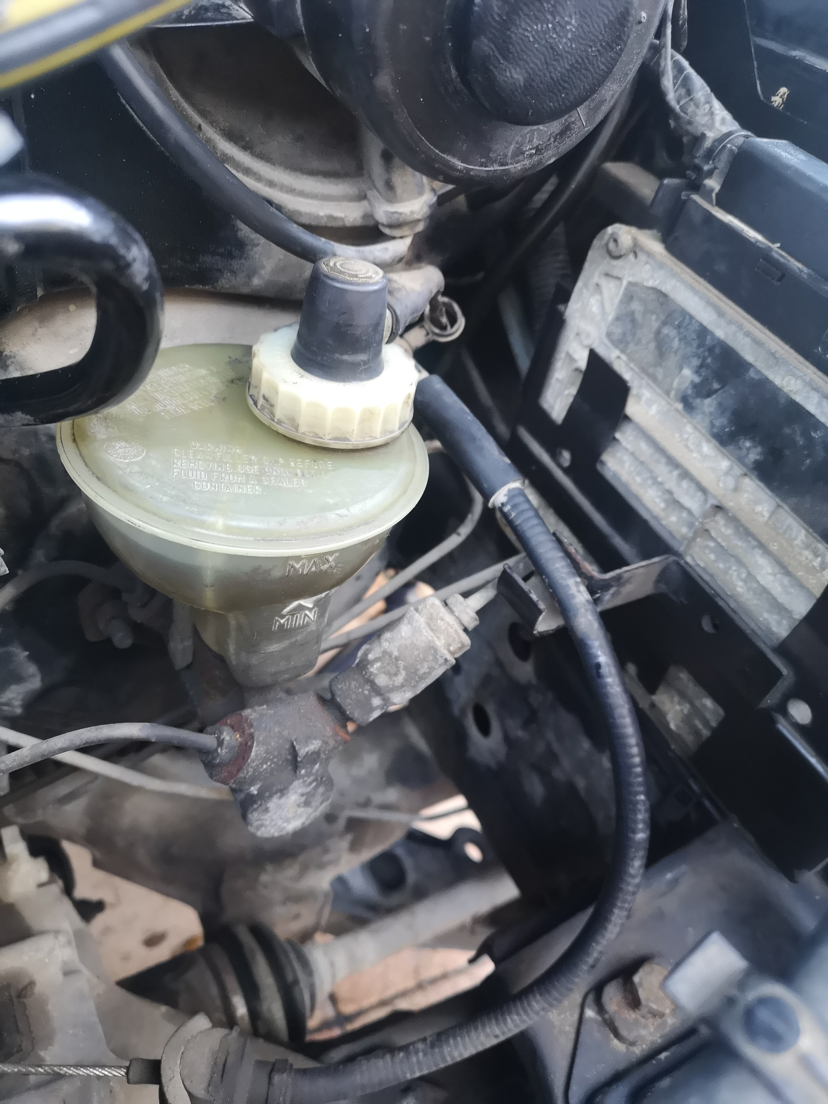

Brakes done.
That was the old brake fluid that came out...
Nasty stuff.

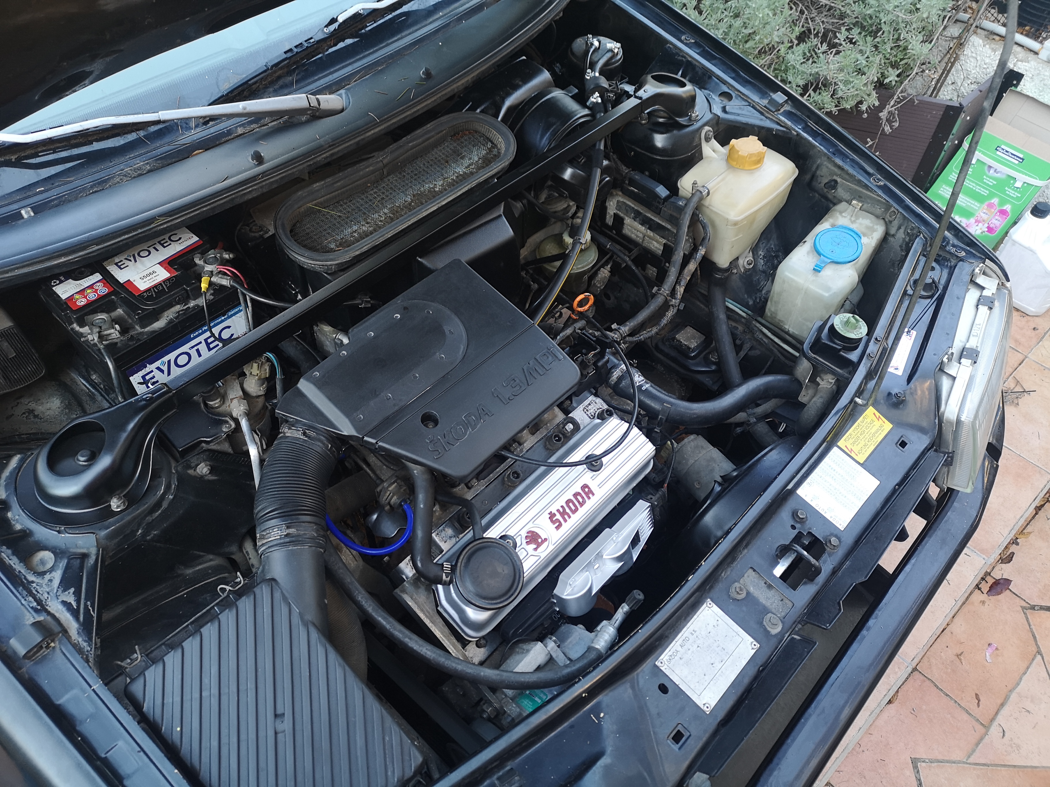

The valve cover it's Chromium? Plated or painted?
The red letters-logo are Smalto or high temperature paint?
Painted with high temperature paint!
Red nail polish

Congratulations!
I wish, you enjoy your Felly in your most happy days and may it serve you well in your hard times, because you served well for it now. :thumbup:
I like how you work on the car. You don't rush your work. You work clean and orderly. I'd trust you to make repairs on my car.
Also your paint work on valve cover looking so very cool. Just loved it.
That was a good idea to record the startup video too. It will be a good memory to remember in the future.
Good work!

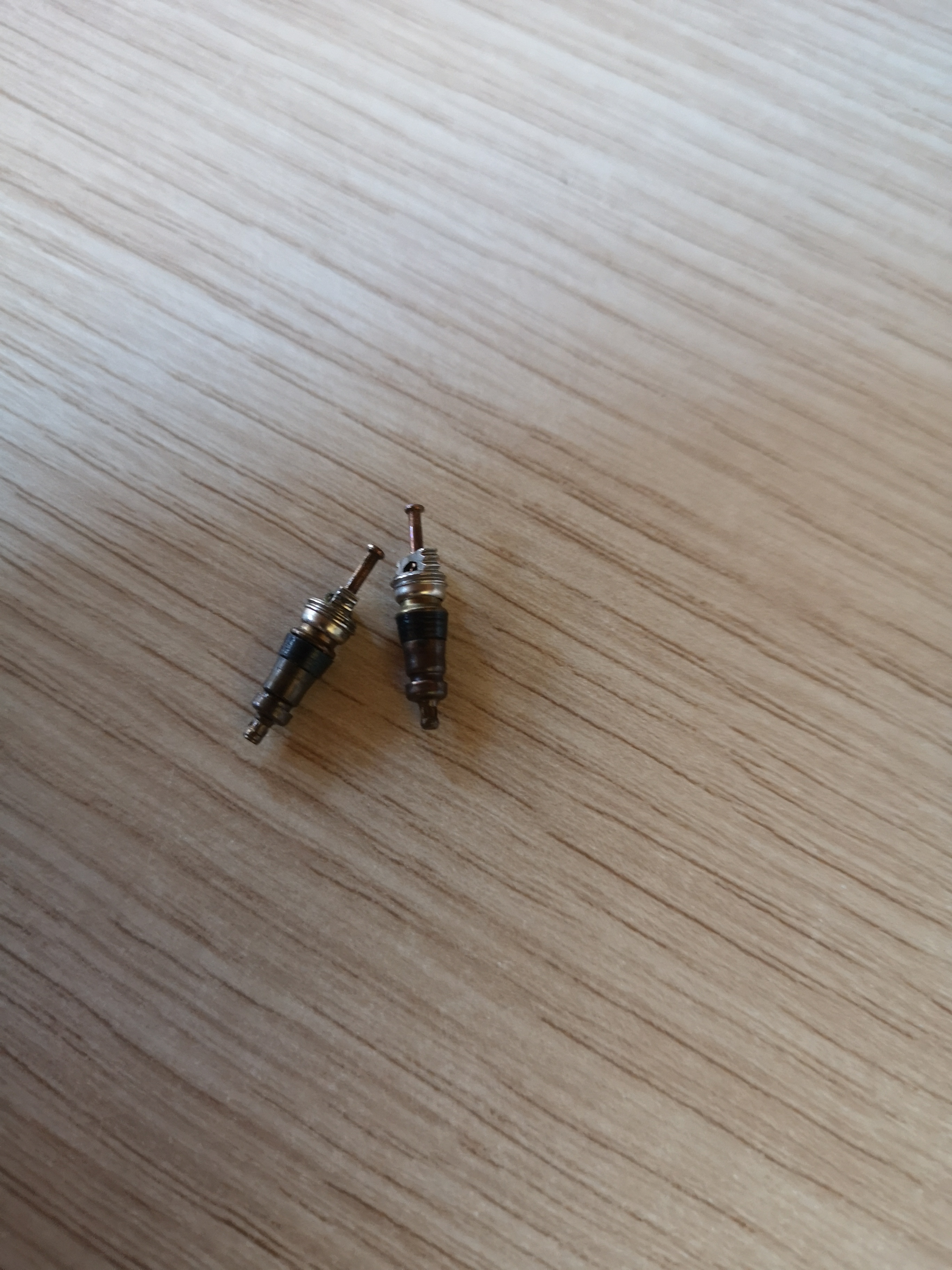

New ac valves installed!
Valve type
CH-9520C
