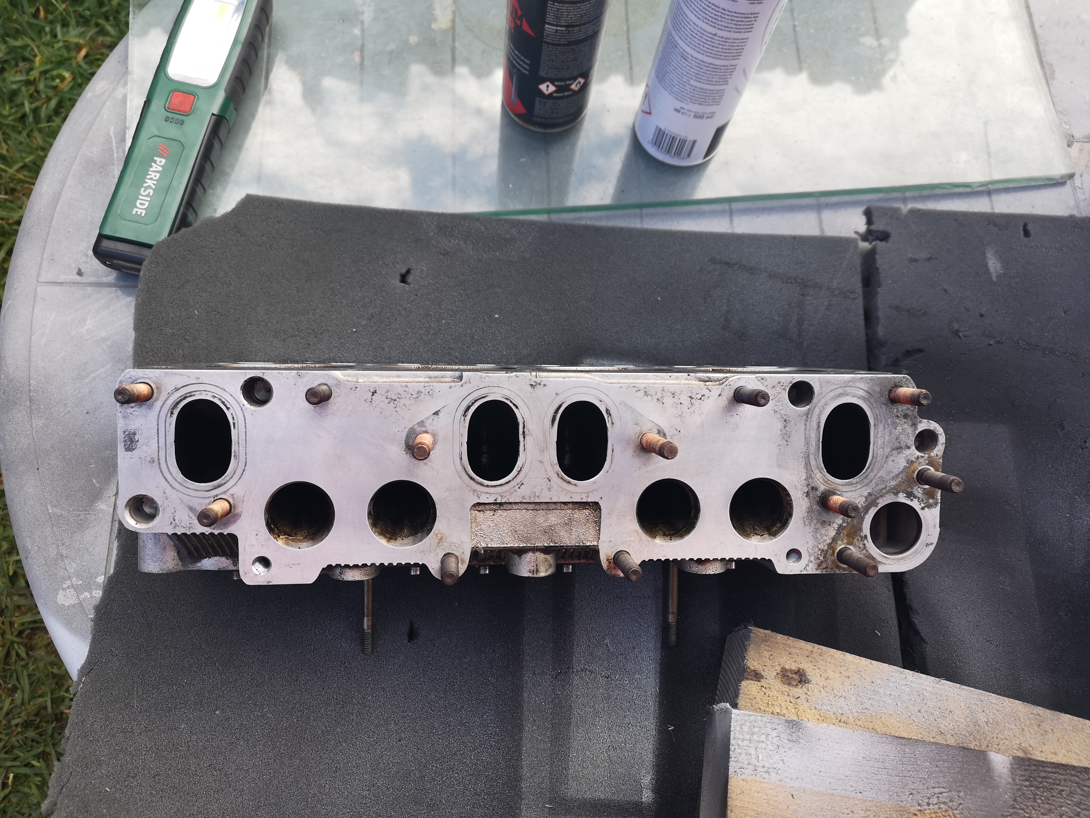

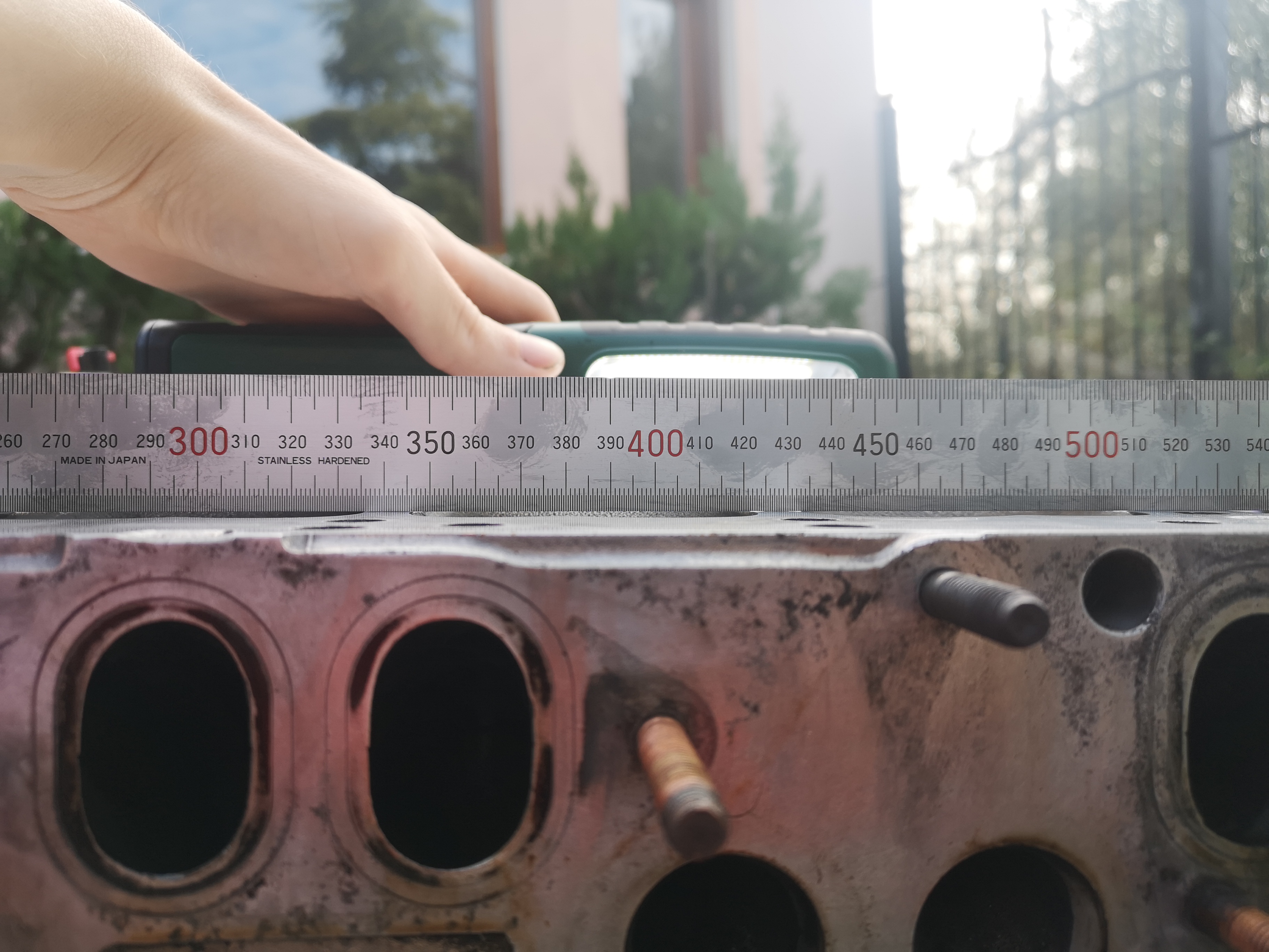

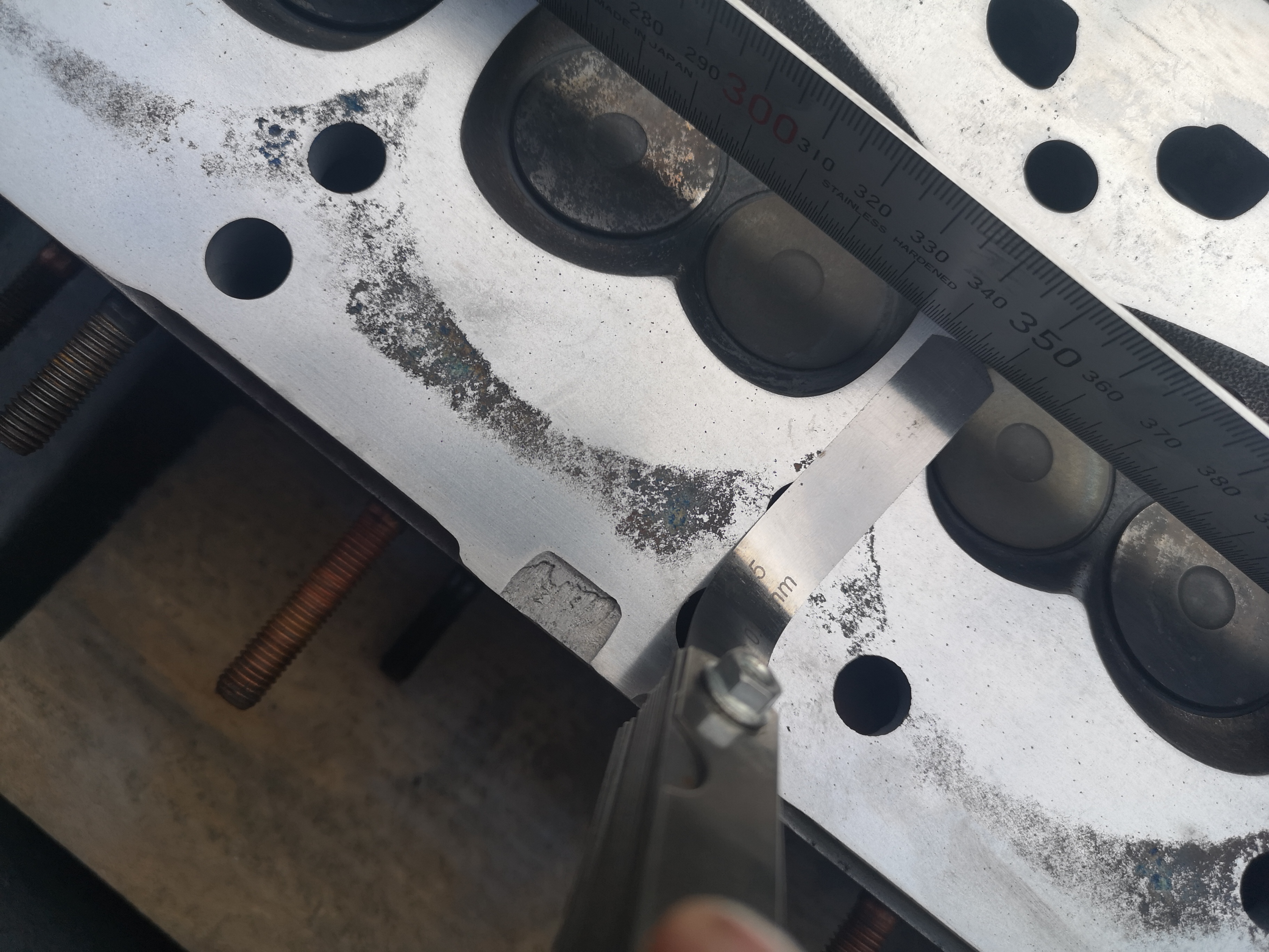

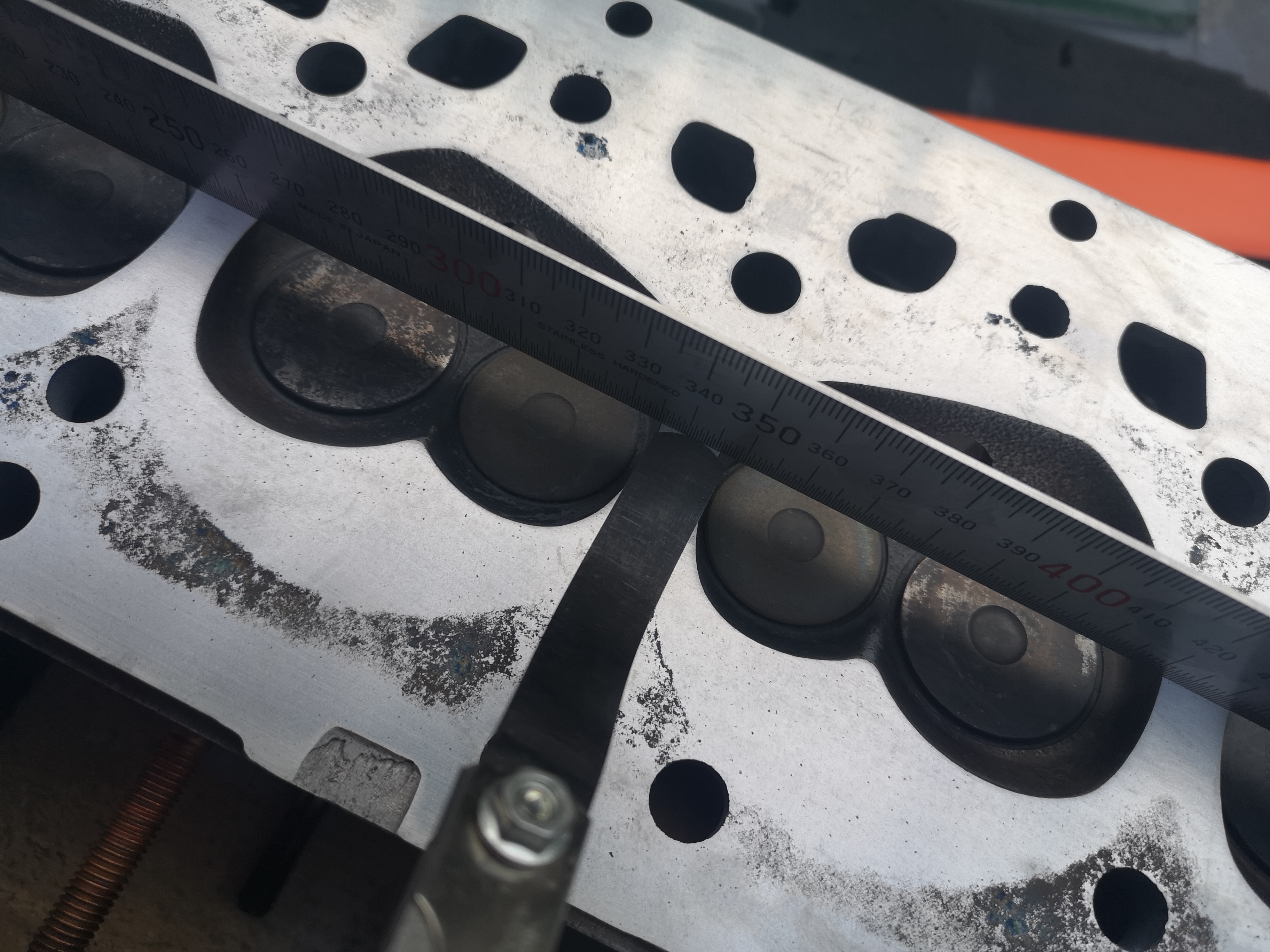

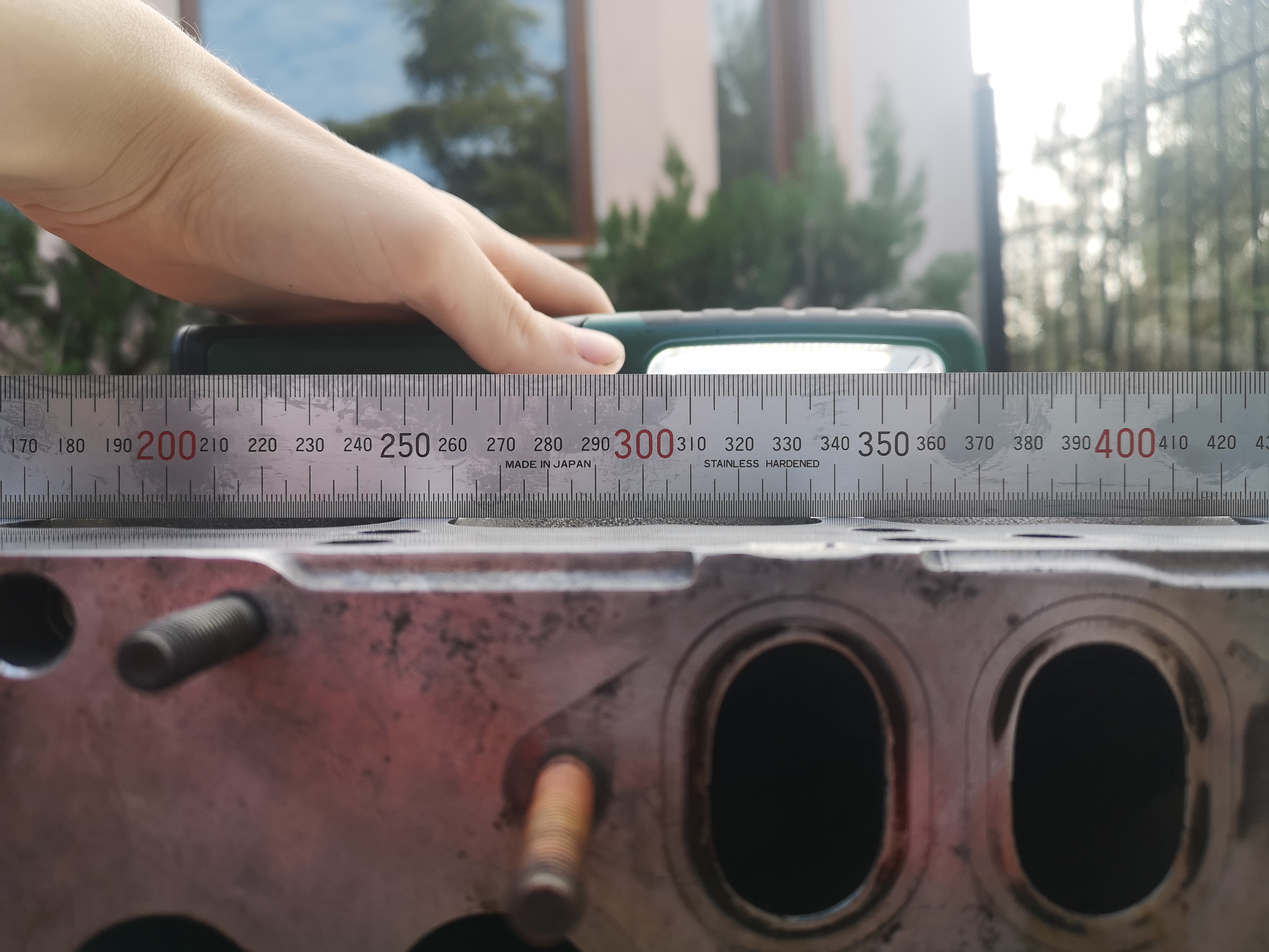

Have you been hand sanding this with a block?
How are you deducing whether it is flat or warped?
Was the blue finish Engineers Blue or marking blue? What did you apply it for and what was your next step?
Forgive my questions but you have either missed out some important information or might be doing harm rather than good.
Yes a thick piece of glass, 400 600 800 1000 grit wet papers
Machinist straight edge + feelers
Just a blue marker haha, applied to check for low spots. No next step head is perfectly flat withing less than 0.04mm (my thinest feeler) and all sealing surface are perfectly clean. Next step clean the intake and exhaust  ports and start reassembly
Glass is not really flat enough but better than the hand sanding block I thought you were using.
Feeler guages will not show up warping but if you have two long machinists straight edges then you can sight along them, the process in carpentry uses "winding sticks"
Good idea with the blue marker pen, my bottle of marking blue has dried right up and the residue does not thin with white spirit.
Thanks for responding, I'm sure you will be fine with the flatness!
I first checked it with the staight edge, it was as fine as I could measure
if they slide under you got an issue, this is how i checked it
the cheapest and fastest way to get an idea

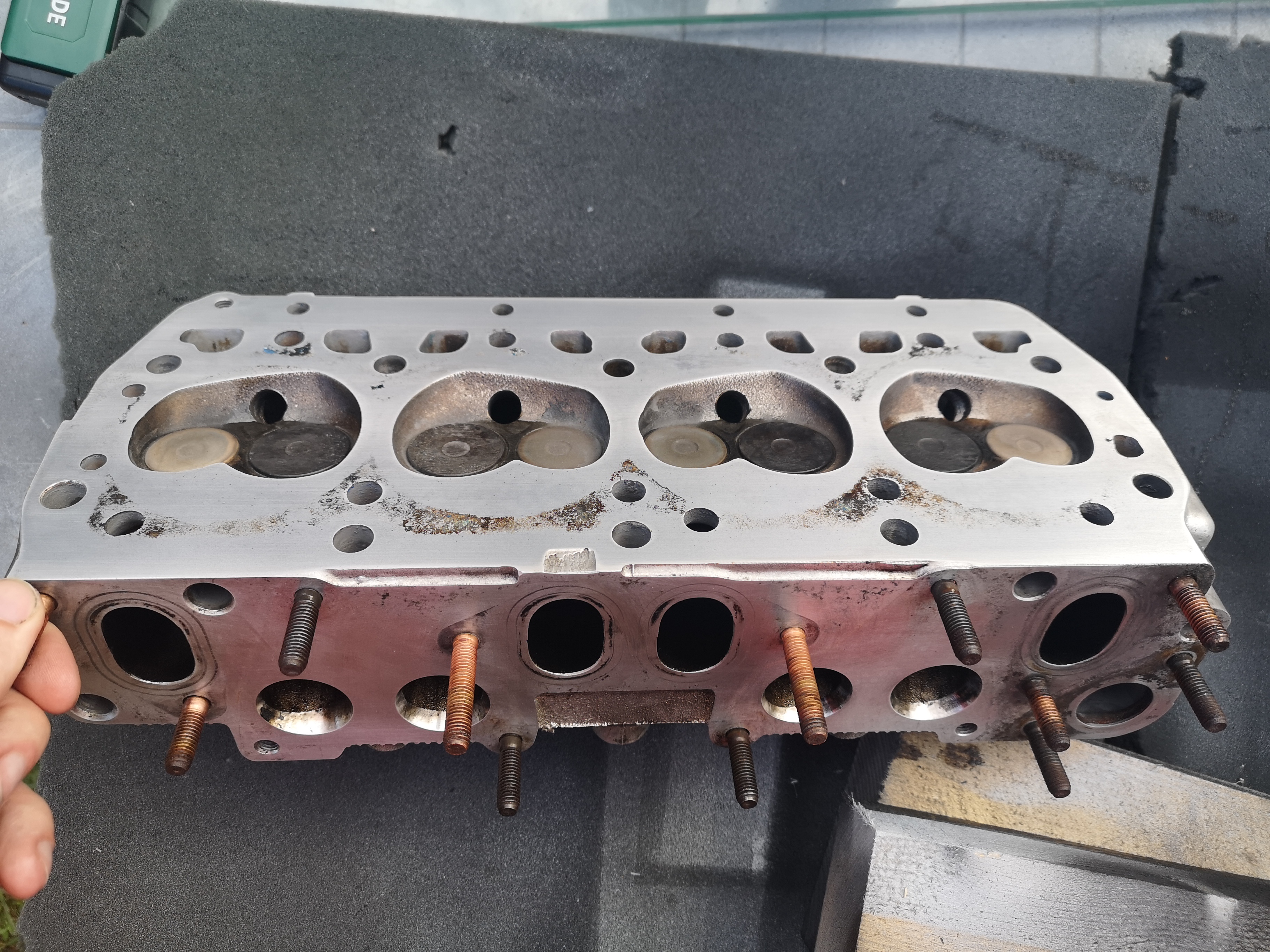

On 24/12/2022 at 15:07, Thefeliciahacker said:
Head is ready very very flat the top down photo shows the overall flatness after just 4 passes to scrub the marker down
Nice, looks that all sealing surfaces (especially around fire rings) are intact. That should hopefully work

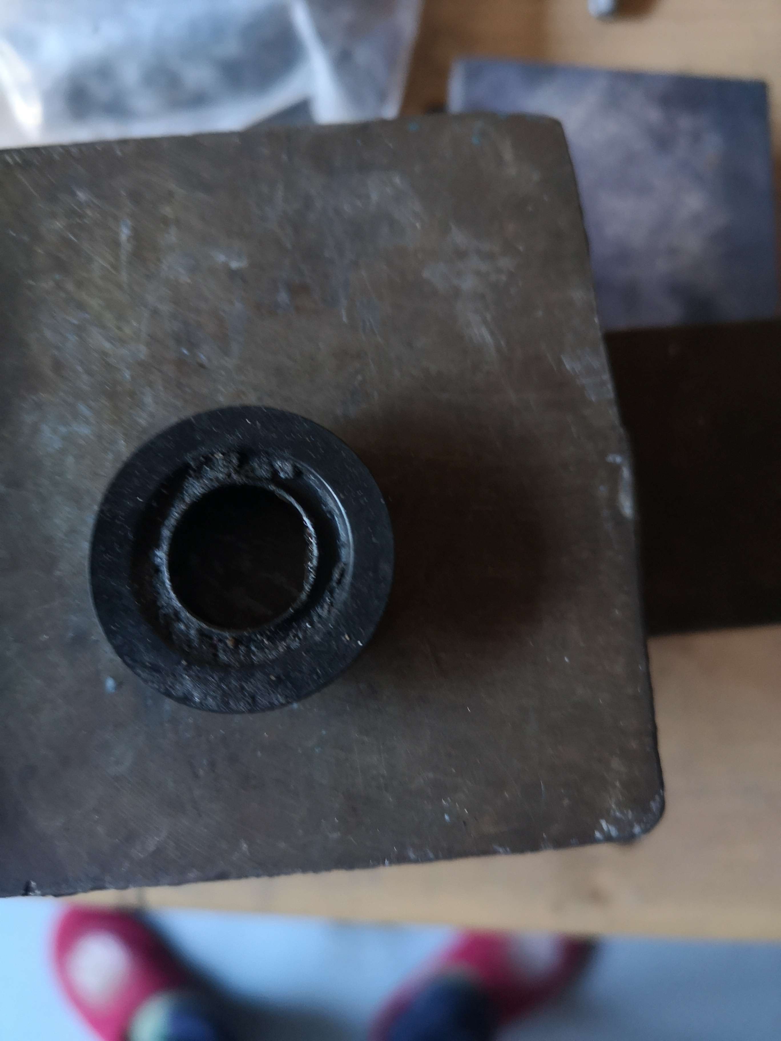

Do you have any ways to measure the liner protrusion?
I did but sadly they appear at 0.06mm just below the lower limit.
Especially the outer ones
But I will remeasure them

What's the difference between neighbouring inserts? IIRC, there was a limit, too and it is more critical than absolute value. Edges of adjacent liners should be perfectly in level.
I will check that.
And for those who doubted!
Head is flat!
The worst spot is in the middle when measured diagonally and its still less than 0.04mm
Head is ready
I cleaned the valves and the gasket face.

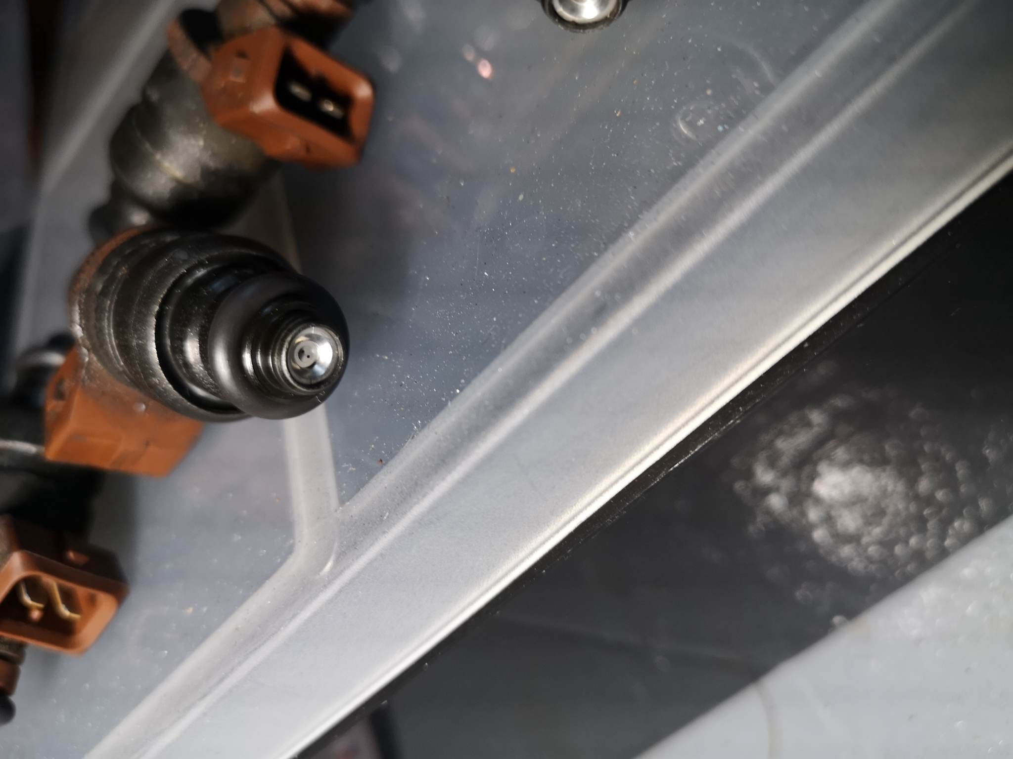

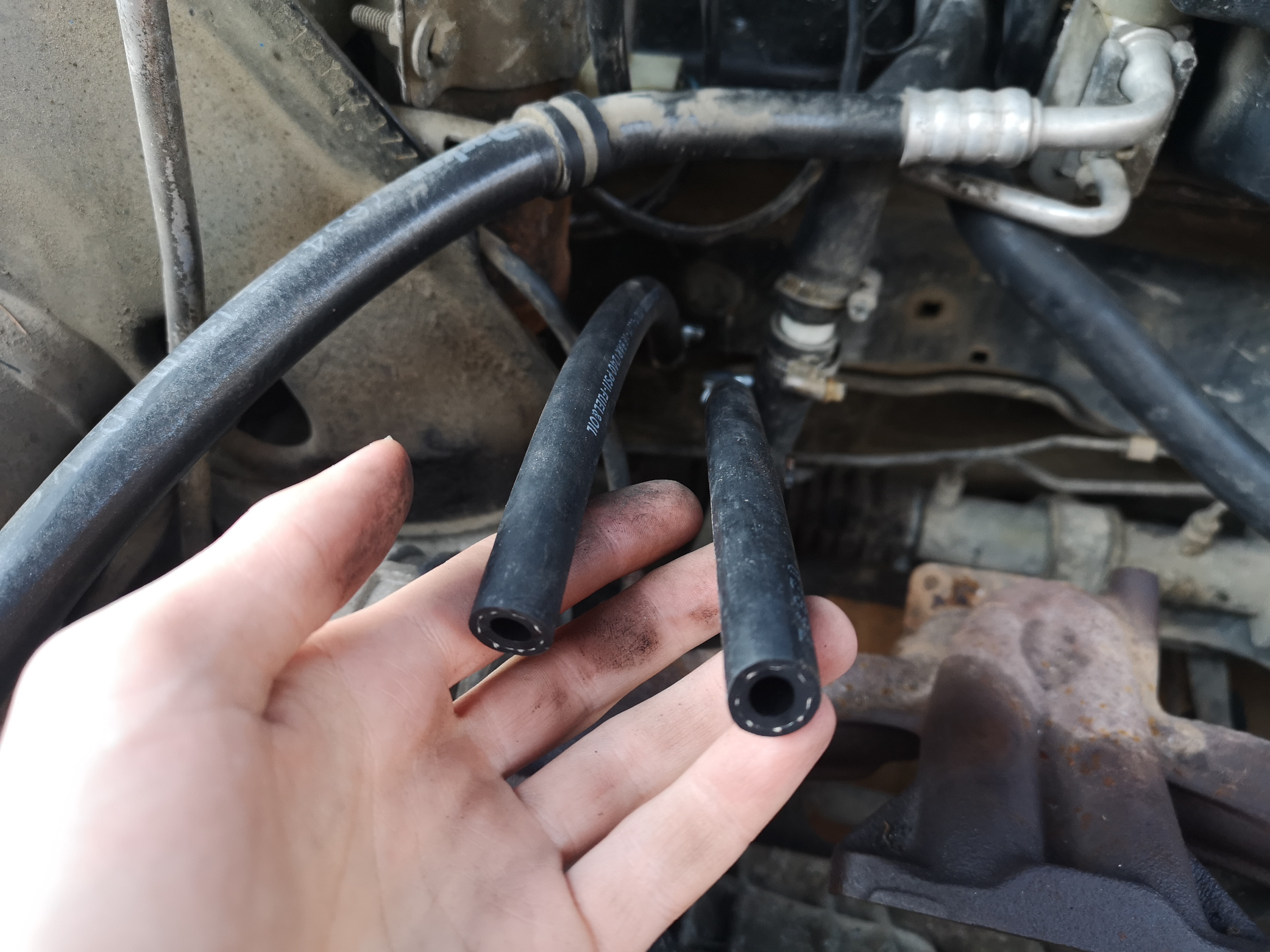

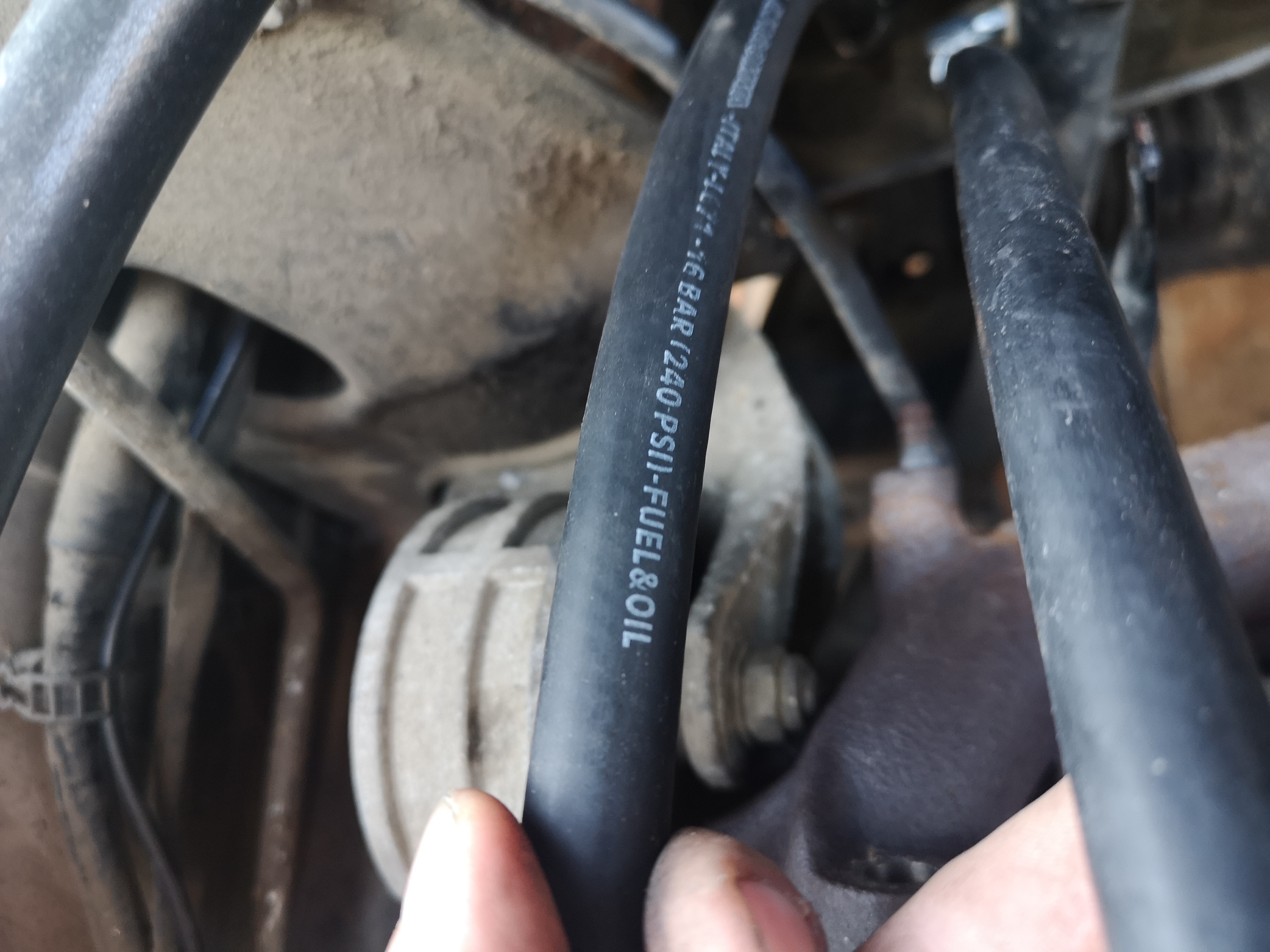

All hoses replaced!
Fuel send and return
Servo
Charcoal canister.
Pcv system
Fuel regulator one.

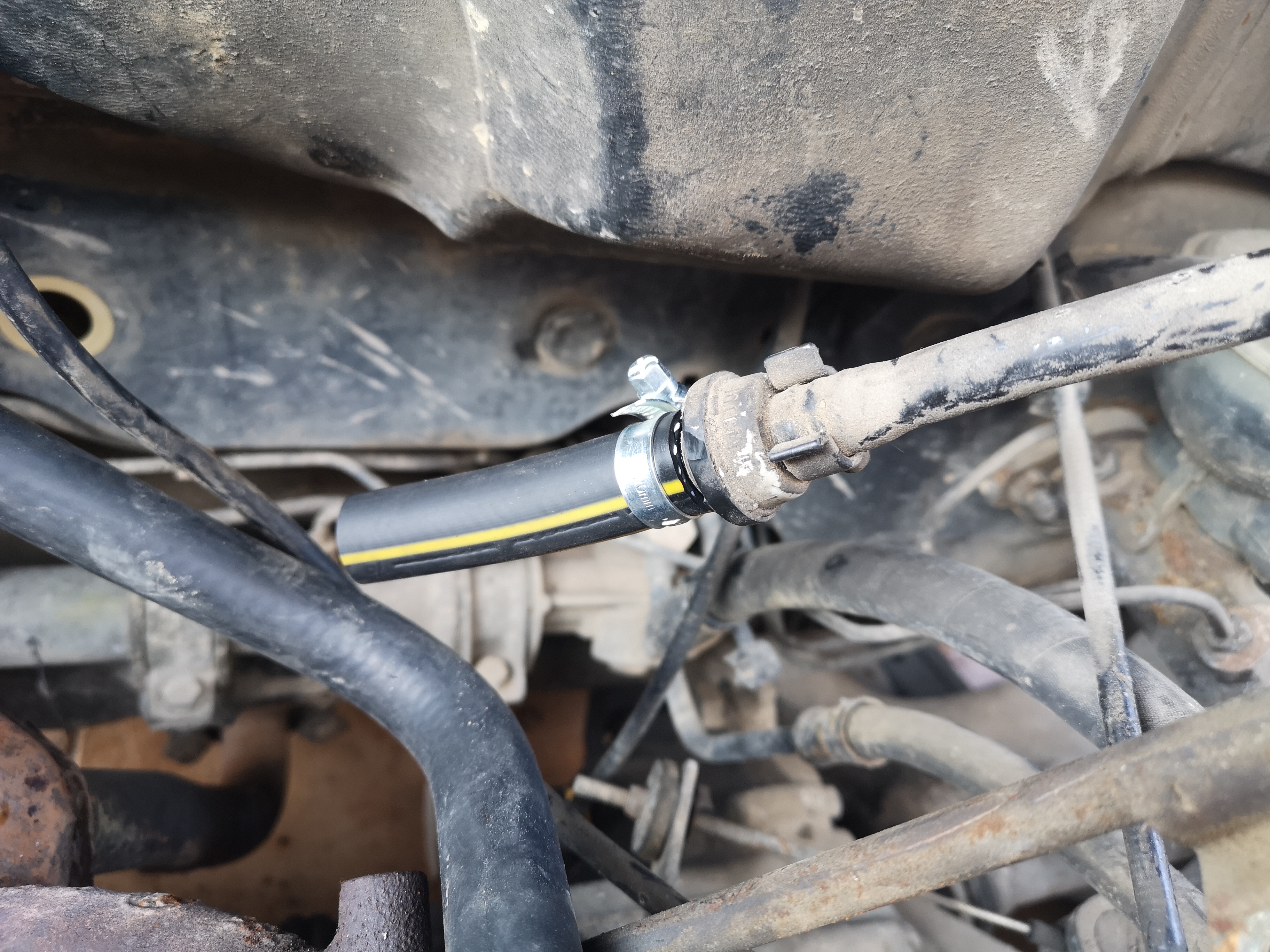

As for the hoses for coolant:
few years ago when i had a problem with a T connector i used commercial hoses from local market, although i asked for hoses to have resistance in hot water i didn't pay attention to the details when i installed them, were till 102 'C only.
I didn't had instant problem but after the second test became soft and i was afraid that soon or latter the ''boom'' will come so i search deeper and bought others which can stand at least till 120 'C ,of course the whole system won't reach this number but i feel assured.
Coolant hoses are the ones that could not be kept universal, the had to be moulded to the appropriate curves and stuff so they are ok!.
Vaccum, pcv, fuel and evap hoses are universal, but (very) high quality.
Italian made ALFAGOMMA!

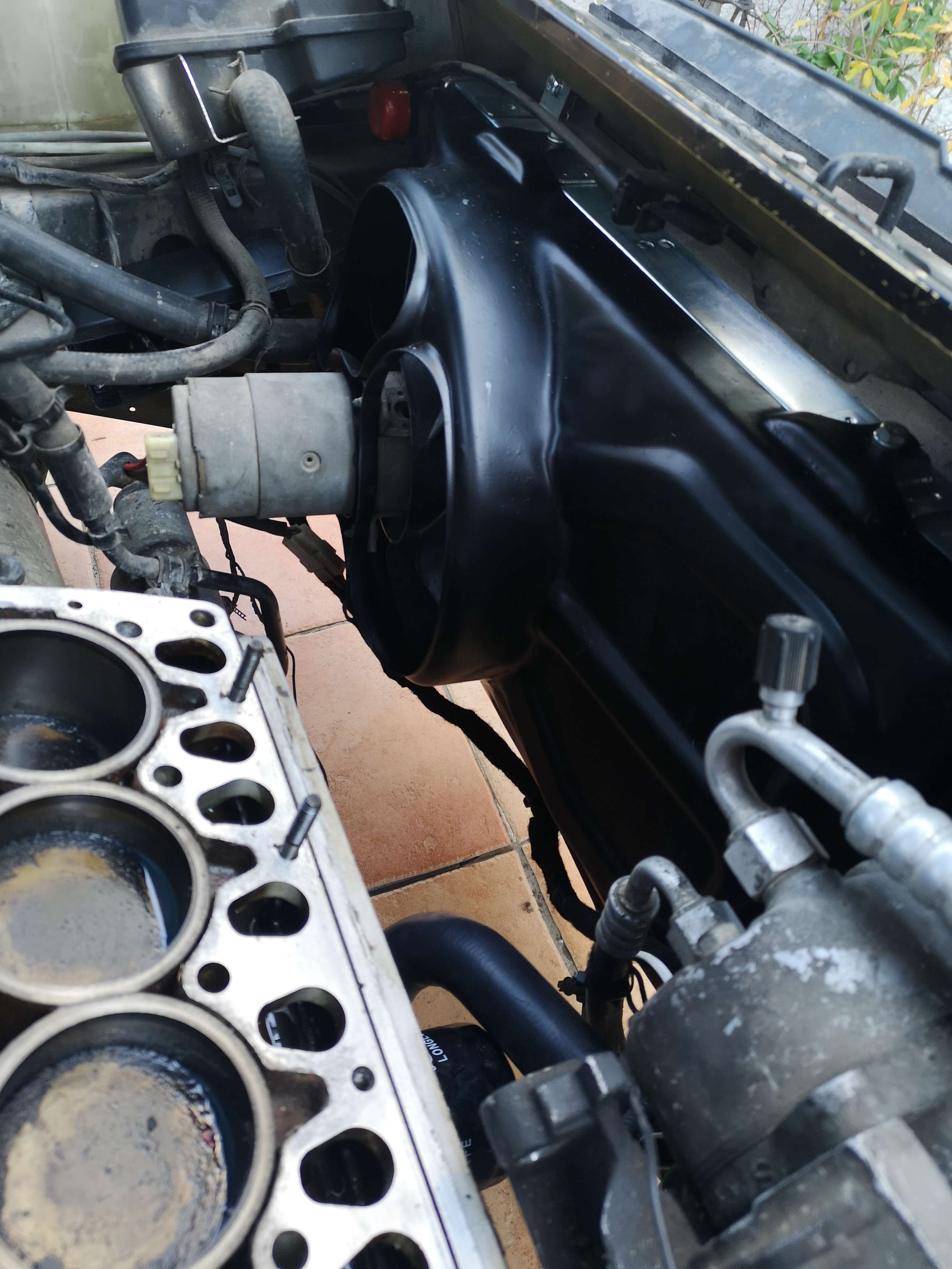

Work is progressing,
Changed selector linkage seal, adjust linkage for minimum slop, installed new radiator,new lower hose,tested my system.
All work flawlessly

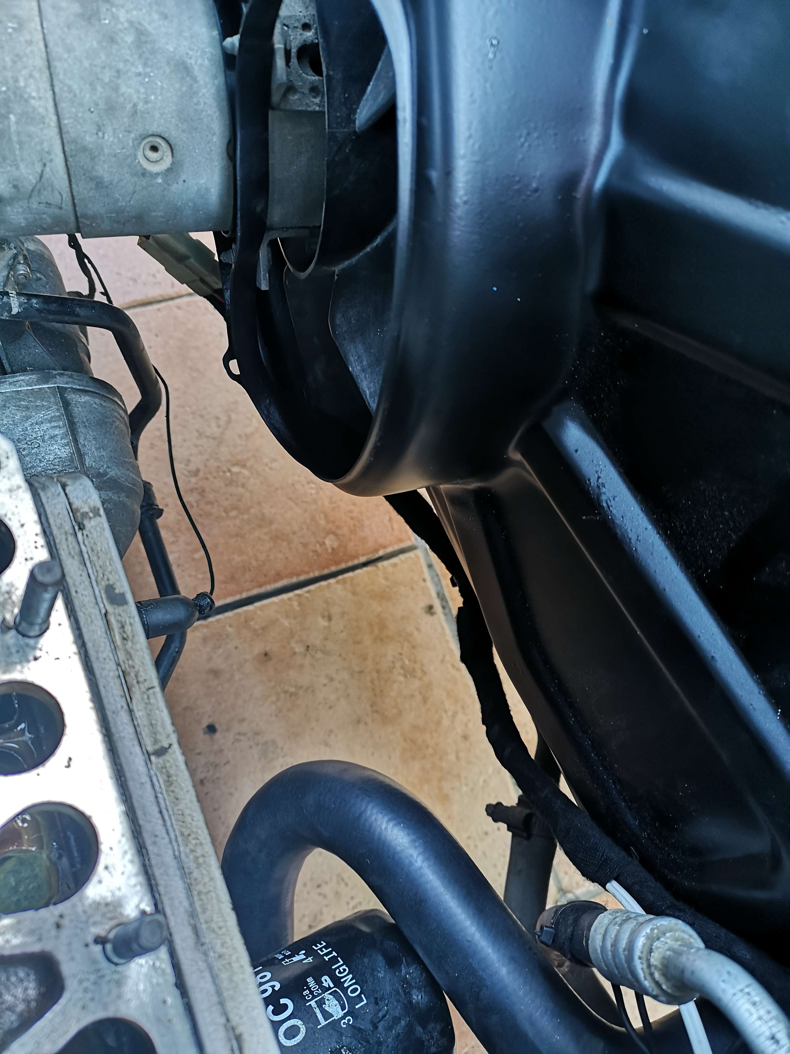

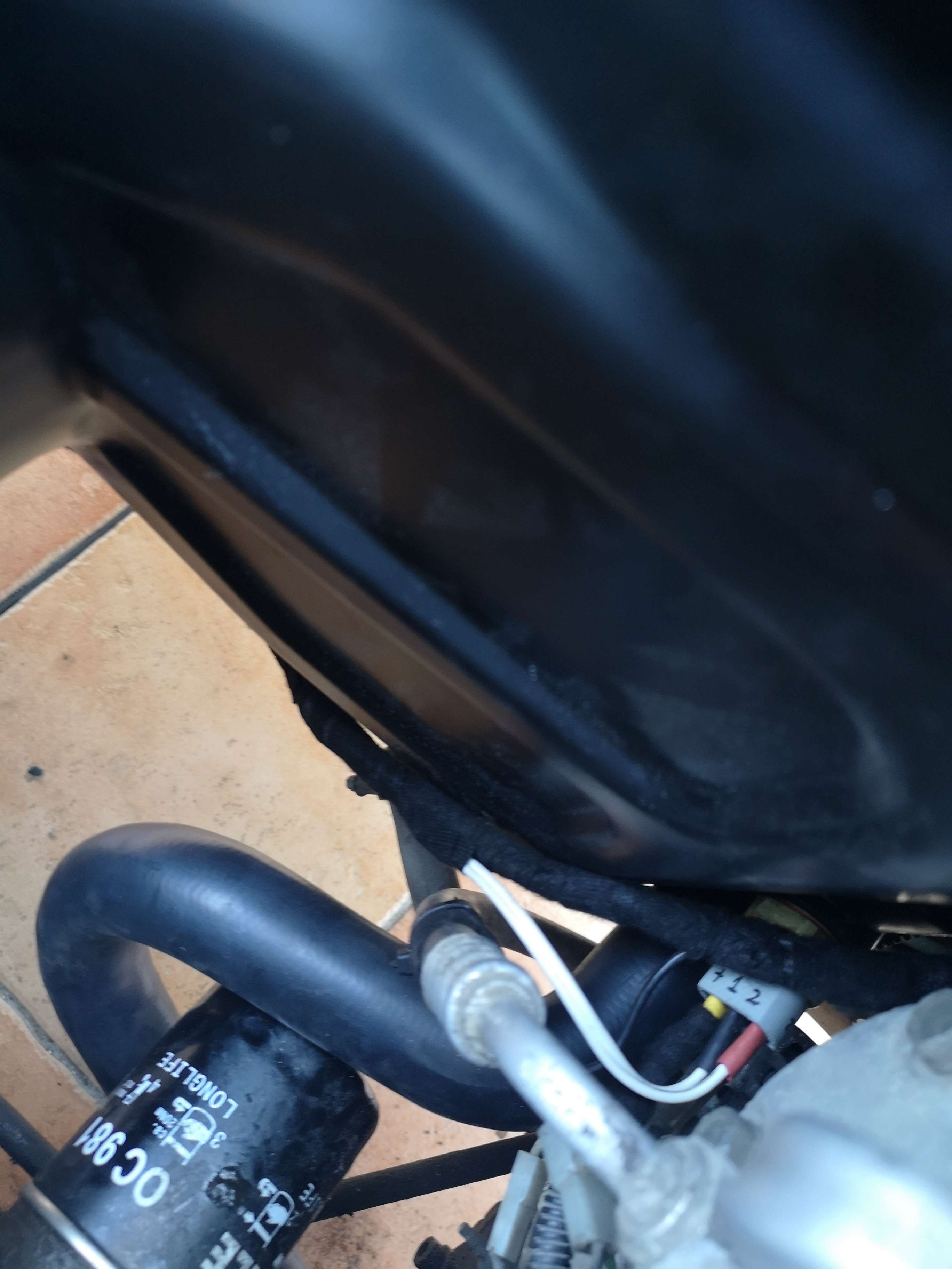

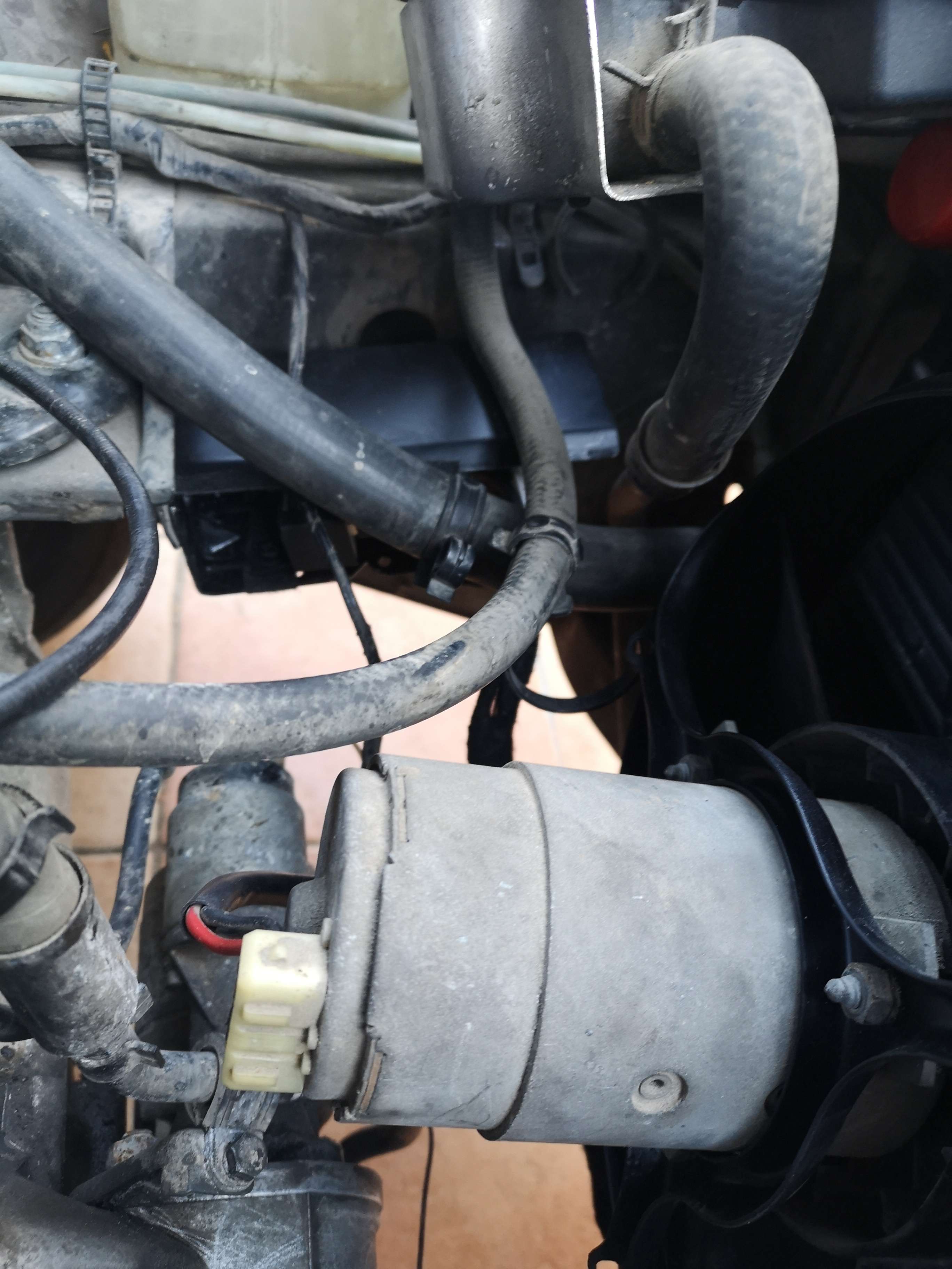

/cdn-cgi/mirage/b2a6ebb5516a62a813ba256bbceb36dd8e83d541906d5a304225e76358d80b2b/1280/https://www.briskoda.net/forums/uploads/monthly_2023_01/IMG_20230106_135156.thumb.jpg.61aa9aa848e35f60f02baca26234c801.jpg
that radiator hose is pretty cramped there... I always wondered, why they just didn't use 1.6 rad with outlet on the left side?
