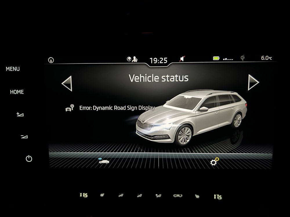

Error: Dynamic Road Sign Display error
Hello, every time i start my car, i have this error , if i clean the errors with obd11 lane assist and traffic sign work .
The errors i have to clean is in A5 camera malfunction , and a databus error value received, on 13 ACC i have databus error value received.
Did anyone have this problem ?

Well the German solution did not work for me, I have tried to clean the windshield and the camera lens but it did not work either. My camera was retrofited 2  year ago by me , it has been working flawlessly until two weeks ago.
The error appears when e turn the key  the thing is the camera is working,  because if deleted the errors  and do not turn of the car the camera works.
Have you changed anything recently or updated the maps?
Could you post a full and complete scan of the faults you have so we can see exactly what they are, might help direct us in the right direction.
Ok here is my obd11 scan , some parts are in portuguese sorry . The errors are in 13 and A5 , the 19 error is for component protection for the tv tuner i have installed ( i have to find a dealer i can trust)
