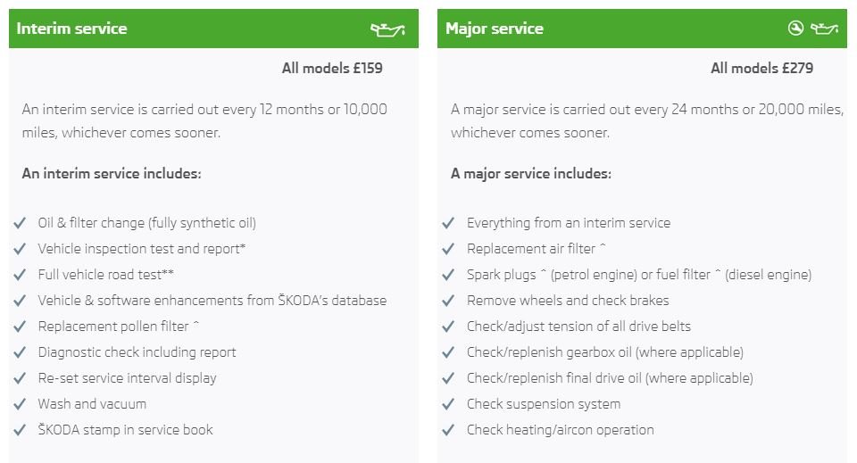

If you look harder like at the Pinned thread on 1.8 & 2.0 TSI,s in the Octavia Mk2 section and maybe the Yeti 1.8 TSI's in this section with issues you will not take part in the lottery of a 1.8TSI unless you can rebuild engines.
Overblown on the internet as people say, well not with Euro 5 1.8TSI's as fitted by Skoda.
What service history is there with the car?
When was the Haldex last serviced or how often since 2010.
What about the spark plugs last replaced.
Brake Fluid changed etc.
