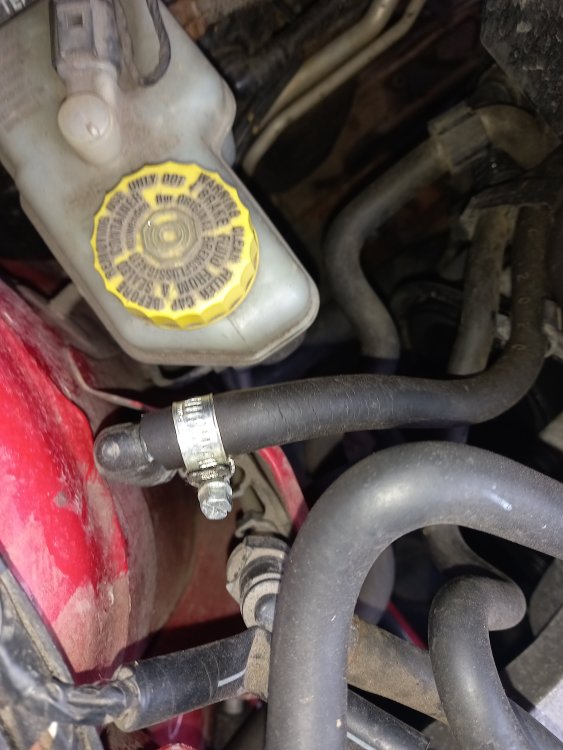

I have had a very young fuel hose look very old and dodgy, though on a petrol car.  It was sourced at a local motor factors under two years ago during an engine change, when I couldn't get the original to reseal at one end.  I spotted it looking cracked and horrible this summer, only 18 months after it was fitted.
Will nip out and get fresh piccies to compare with ones taken then.
I 'kinda' convinced myself that it was just the outer layer, and that it wasn't in any great danger of leaking.

New pic. The hose has all the expected markings, SAE? number etc. I seem to remember
A rubber hose isn't going to be made to be safe to use for 30 years, I don't think any part of a car would be, especially a flexible peice that's been bent to shape.
