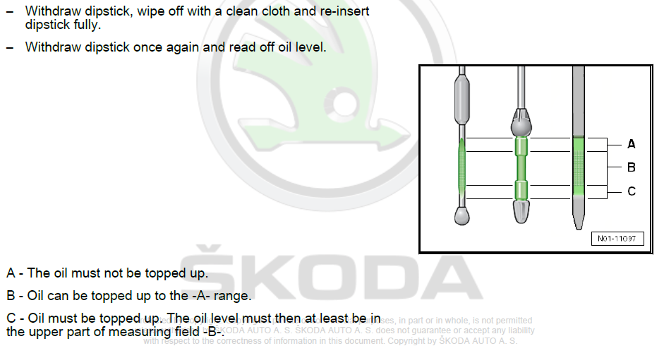

Here is a better image of the dipstick ranges than the online manual.
I would say if you are halfway through the B area, I would not top up myself.
Then check after a month (earlier if you have concerns) in the same spot, leave the engine 3 minutes before you check to allow it to drain down.
Area A does go onto the flat above the cross hatch.

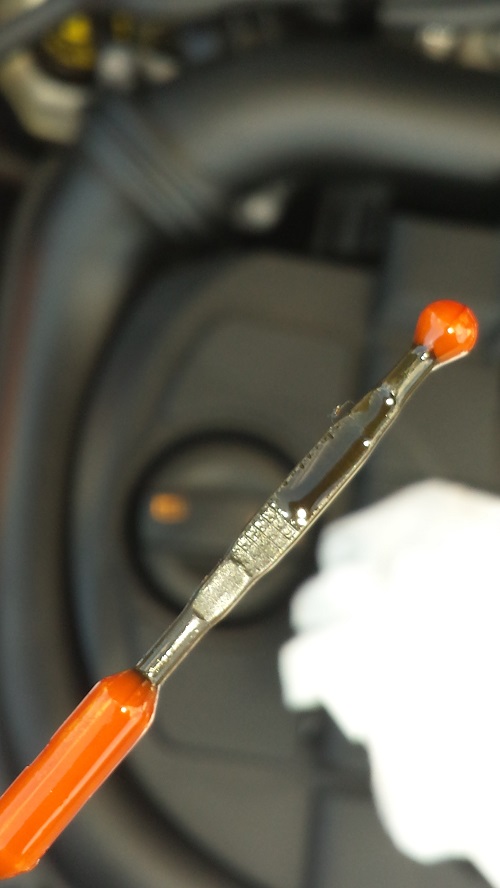

With a 1.4 TSI Twincharger with 3.6 litres capacity or a 1.2 TSI Euro 5 with 3.6 then 3.9 litre capacity the Low Oil Warning light coming on could be when the oil was more than 1 litre below capacity.    Ps.  Lower level shown in pic of as cold dip engine not started. Higher level same oil once up to an indicated 90 *oC and stopped a few minutes.
