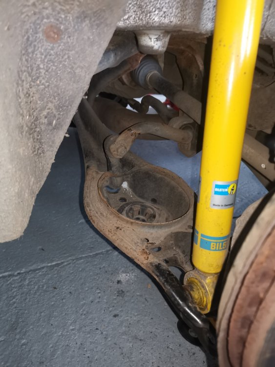

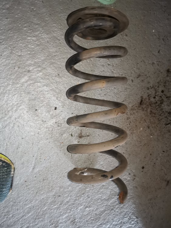

Car failed its Mot on broken spring at rear and garage couldn't replace it till next week. I have B6 non DCC dampers fitted already so decided I would fit eibach springs now. Thought I would have a go myself. Put the jack under the control arm!(?), removed the bolt and slowly released Jack. I had to help the arm down and now the hub assembly is free but the arm is not dropping to allow spring to be removed. Do I need to unbolt the bottom of the damper too?
Should be able to do it with just unbolting the bottom damper bolt. Might need to raise both sides otherwise you'll be fighting the roll bar too.
OK will try unbolting damper see if that helps. Will grab a second jack in case I need to raise the other side too.
Probably the anti roll bar drop link and the position sensor (if it is LHS) need unbolting too. I can’t quite remember if I ended up undoing the lower arm from the hub or not.
Edited by nicknorman
I thought i would get away with taking the bolt out the lower arm that goes through the knuckle into the hub and it would lower down but not the case . Will take the bottom damper bolt and try again. After that Im probably struggling without a how to guide.

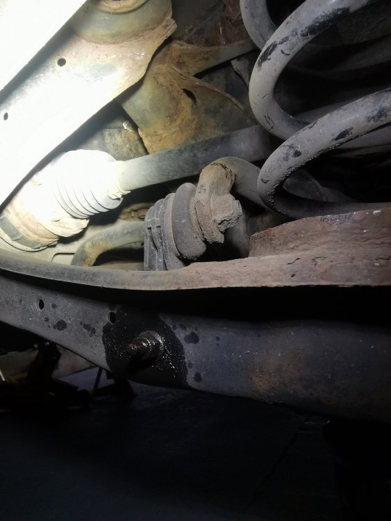

So changed the broken spring for the new eibach kit. Went to do the other side and all was going well until I tried to remove anti roll bar link bolt. Nut came off but bolt is not backing out. It's stiffnto turn and is turning the insert attached to the roll bar Link. Tried knocking it to free off but no joy. Any ideas?
I was thinking of removing the top fixing of the link to the bar but not sure if that's a good idea. It looks to be a torx screw in the middle of a nut? Then I could get spring out and arm dropped for a better look. Was going so well too...
Quoting @Macsamillion “It looks to be a torx screw in the middle of a nut?”
the torx bit you can see is just cast into the inner part of the protruding “ bolt” so that if the nut is seized and starts to spin the bolt you can put a torx key in to hold the bolt steady while you undo the nut with a spanner (or straight through socket)
with a bit penetrating oil on the nut and the fact theres not a lot of exposed dirty bolt thread, you might get away without holding it with a torx key or torx socket bit.

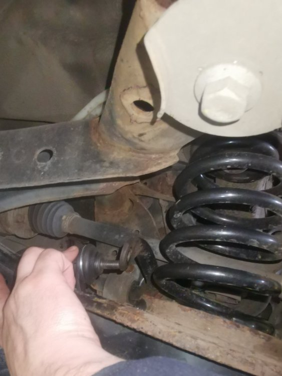

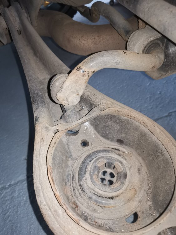

Right my rear suspension /drop links saga continue. After changing springs, drop links started creaking. Had to chop them off, not uncommon I'm told. Got new links and bolts finally but having a real issue fitting them. Everyone says the car should be on axle stands and do both sides at once so limit any strain in anti roll bar. Even so I can't fit the new drop links, tried jacking up the lower arm to align bolt holes. See picture. That's with it jacked right upI thought I should be able to fit in the relaxed position. Can the anti roll bar turn in its mounts, have I done something when doing the springs and it's rotated up?
Drop the car down and it will line up
I was just being a bit weak. Bent the roll bar down and jobs done. Was very simple in the end. Every day is a school day....
Suspension needs to b in the "loaded" position when u change the endlinks.
Not raised or extended.
That's when the endlinks and swaybars have the least tension.
