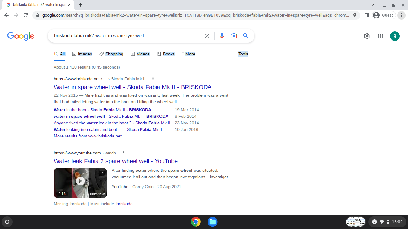

True but what are the words to use in the Search, I was looking as you posted but have given up now as I just can't think of the magic words or phrasing to get to the threads I know I've seen.  I find this with searches, sometimes I can find what I want other times not at all, even if I've posted so know it's there.  😄
Edited by nta16
ETA: Please note - I am not a mechanic or expert in anything.
'Catch phrase'   say what you see.

The first thing I did was search Water in spare wheel well and it found everything but. I have been an active member of  a Jazz forum for six years (I still am) and I know how annoying when new members keep asking the same questions innumerable times without doing a search. But thanks for the search on my behalf. Even doing the search again, a few minutes ago, it  only pulled up my question and not the 2014 answer. I should have just Googled it, as you did, instead of using the site's Search.
When I watched the first Video I realised that my car was valeted about three weeks back, probably with a pressure washer. That may well have been the problem. The hatch seal looks fine but I think I will check the tail lights as that one bolt fixing could easily be the cause.

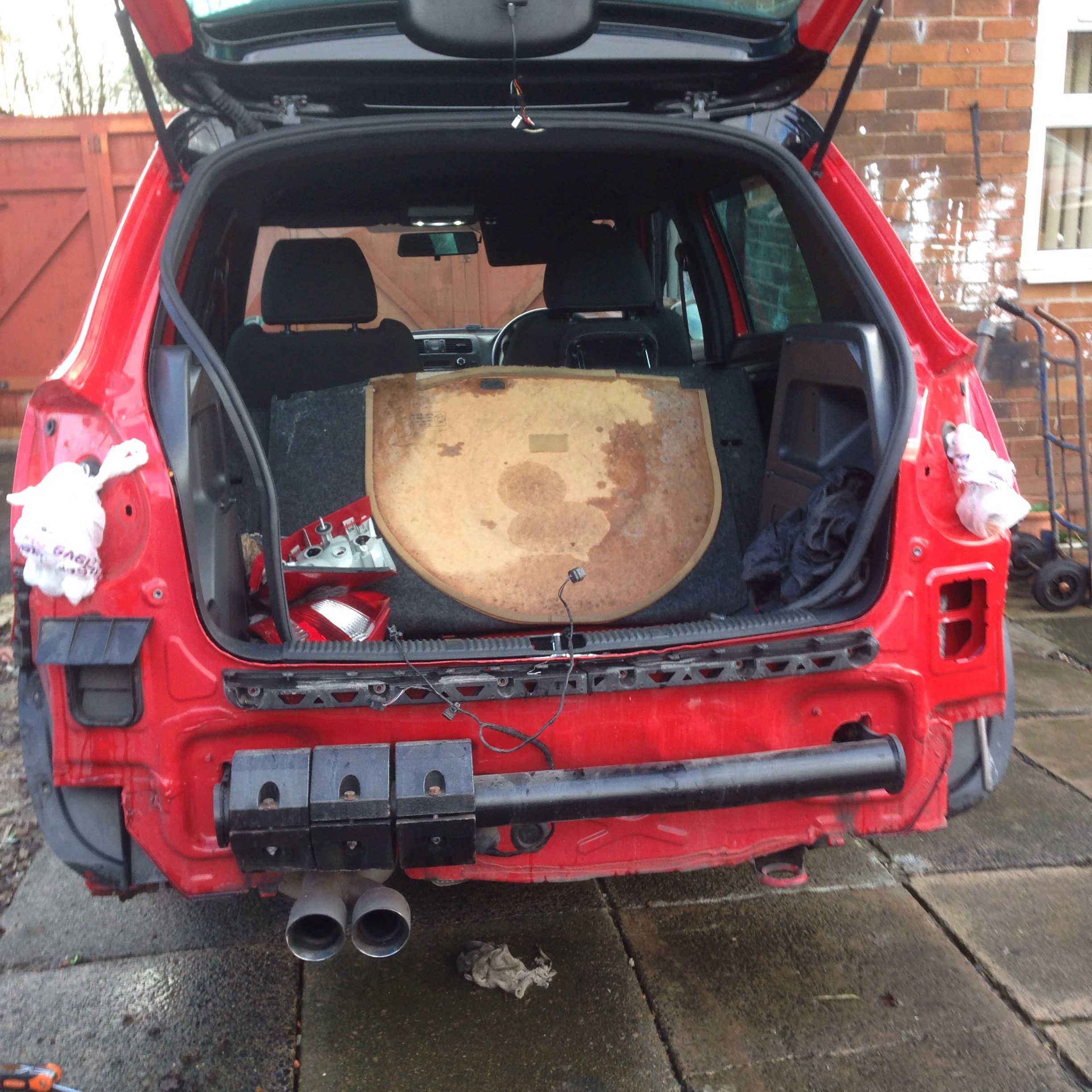

 so the flaps are below the lights and the cause of many a back end being soggy
http://briskoda.net/forums/topic/379331-water-in-spare-wheel-well

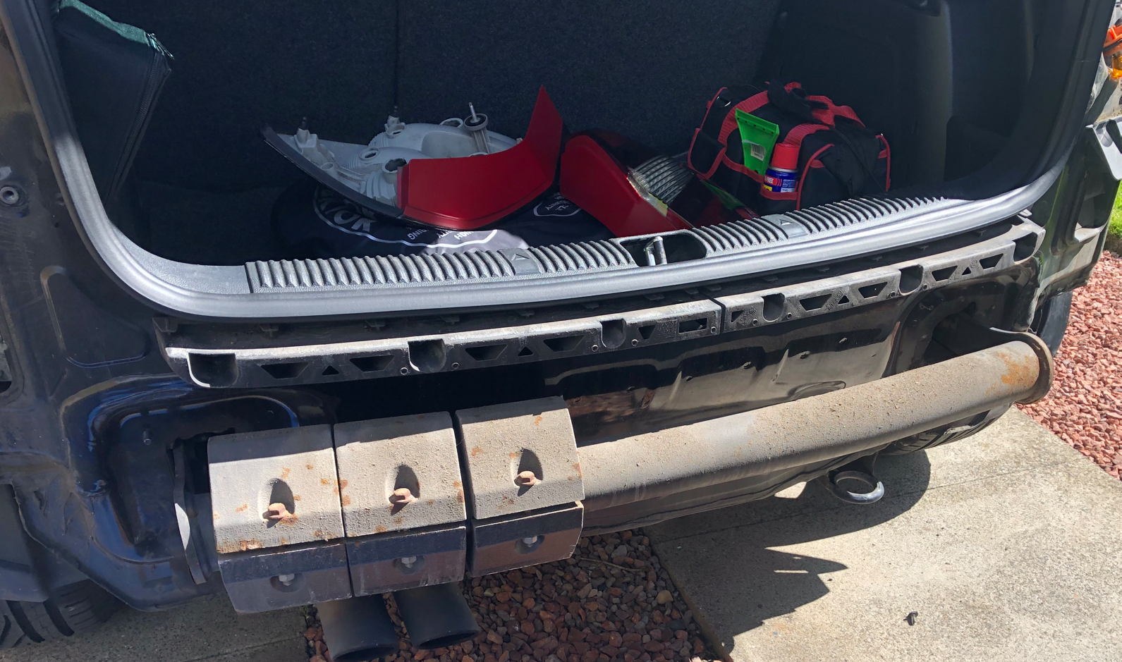

I took off my rear bumper today to remove, clean and seal the boot vent flaps as I had water in the wheel well after torrential rain
This thread helped identify the issue thanks
