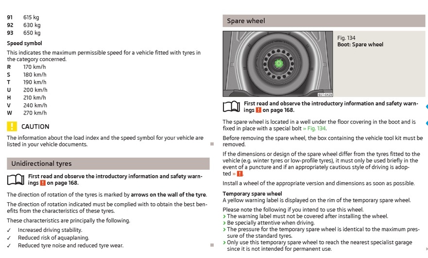

According to Skoda my spare wheel is a Space saver despite being 195/55 R15 on a steel wheel. The wheels on the car are 205/45 R16 on alloys. There is nothing on the pressure chart on the filler cap about spare tyre pressure but according to the Haynes manual the pressure for a Space saver spare should be 4.2 bar, 61 psi. Is this figure correct?

No  total Rubbish.  You do not have a Space Saver.
What you have as a spare is what some Fabia come with as a standard size on the car, or are the size suited to using if you need snow chains on the car.
You have a Full Size spare a different size from the cars tyres.  A  spare to save space.  Put the spare at no more than 40 psi and if you need when on the car let it down a few psi.   ? Do you have the TPMS on your car. When you put the spare on it needed then reset it.    PS. Skoda / VW,s first language is not English.  So remember much is lost in translation and just them calling things what they are not.

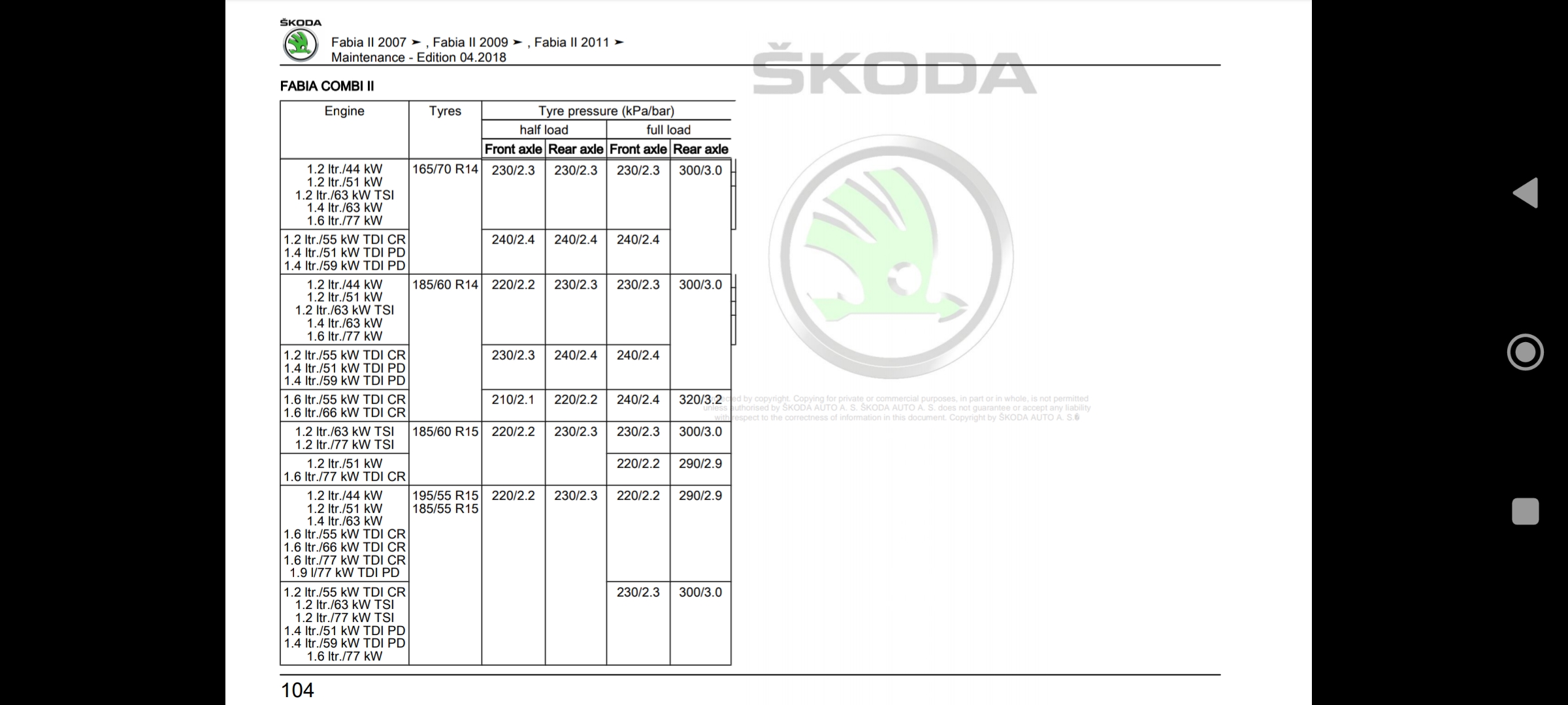

You may want to try these values seen at the bottom of this page.
Screenshot_2023-01-19-15-45-43-604_com.google.android_apps.pdfviewer.thumb.jpg.09d97ed96575c626a31c95f692b242e7.jpg
No it isn't. It is a different size though, hence the speed restriction. As for pressure, I'd set the 3 bar from page 104 in the manual; you can let it down a bit easier than you can pump 0.7 bar in.

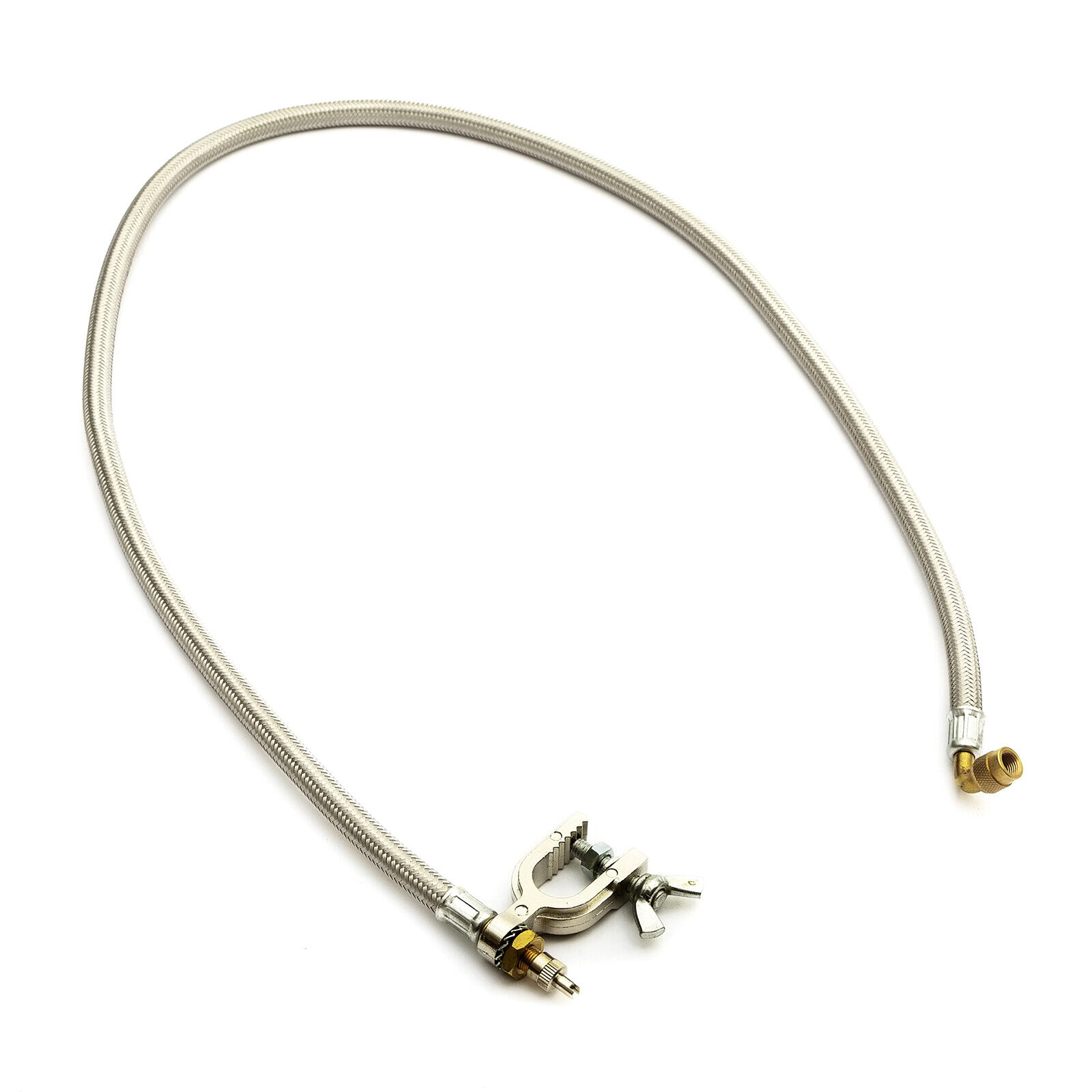

I have also purchased an extension braided pipe that will allow me to check and adjust the spare tyre pressure without having to lift the wheel and tyre out. It just threads through the wheel.

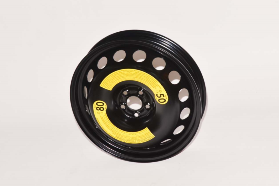

That's a 3.5Jx18 ET38 5/100 57.1 space saver from the VW Golf MK4 with OEM part number 1J0601027M.
It's also used on some other VAG cars such as the Skoda Scala and Skoda Kamiq.

5 minutes ago, Carlston said:
That's a 3.5Jx18 ET38 5/100 57.1 space saver from the VW Golf MK4 with OEM part number 1J0601027M. It's also used on some other VAG cars such as the Skoda Scala and Skoda Kamiq, but it's not suitable for the Fabia MK1/2/3 because a 125/70R18 tyre has an outside diameter similar to 195/65R15, 205/55R16, 225/45R17, etc.

Yes, but because 3.5Jx18 ET38 5/100 57.1 steel space saver rims with OEM part number 1J0601027M have been around for a long time, ie. since Golf MK4, they are common and cheap so it's possible to pick them up on ebay for around £60.
However, I'm not sure why anyone would want one if there's room for a full-size spare.

I connected up my extension braided hose so I will no longer have to lift it out to check and adjust the pressure (set it to 230kPa/33.5psi).

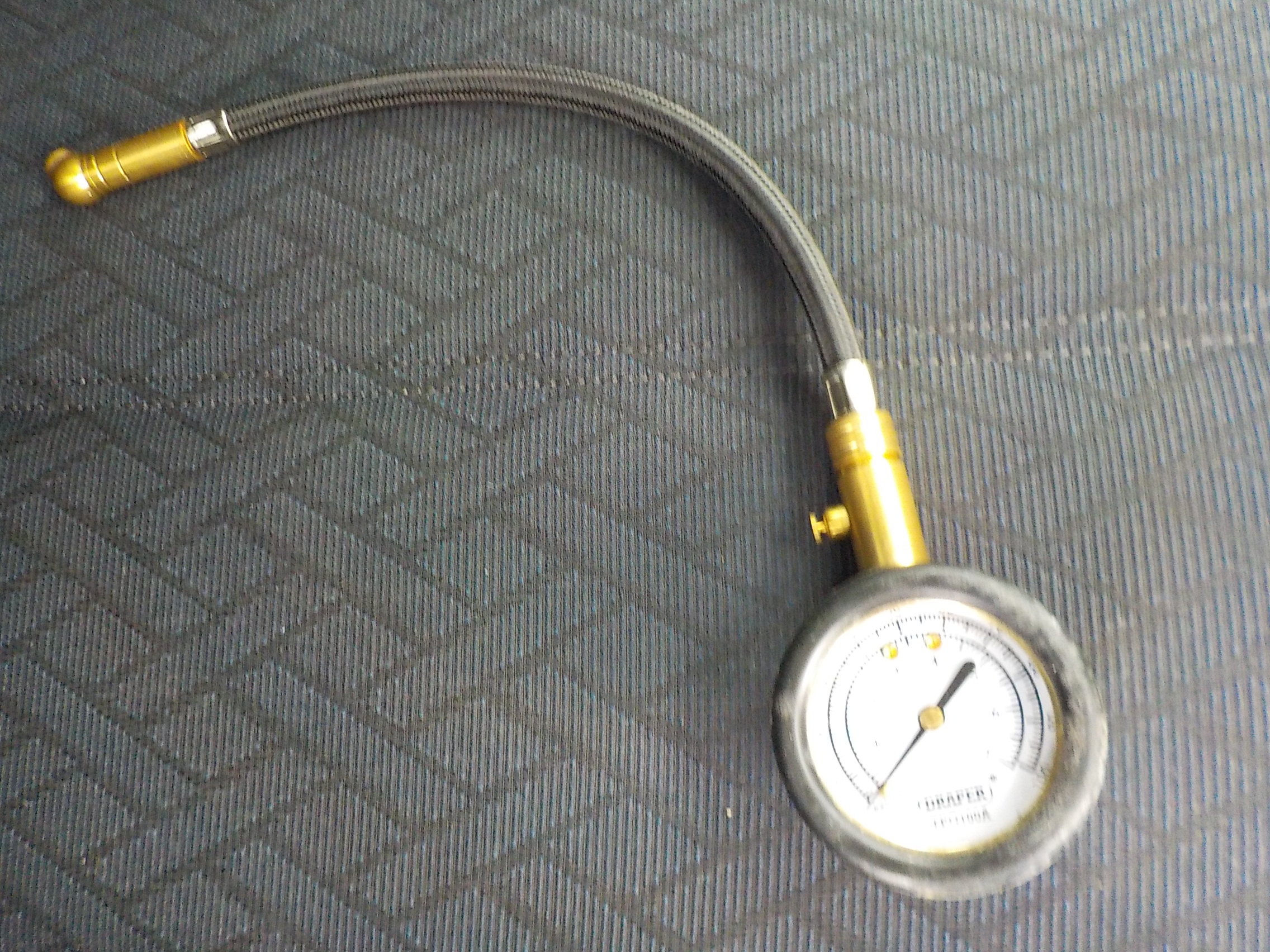

I use an electric pump but it has its own battery. I have checked the gauge against my RACE X RX0014 Tyre Pressure Gauge and the are both within 0.5psi of each other.
