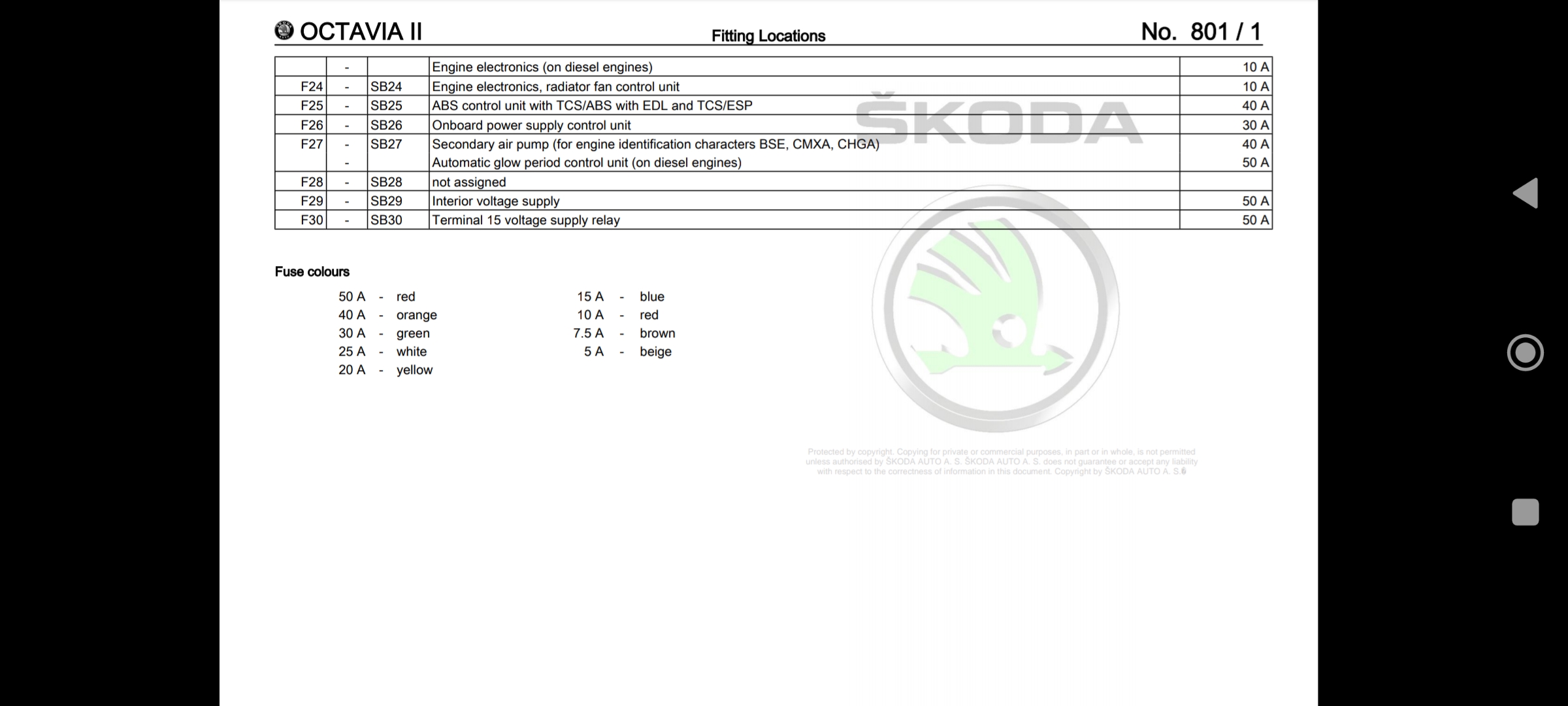

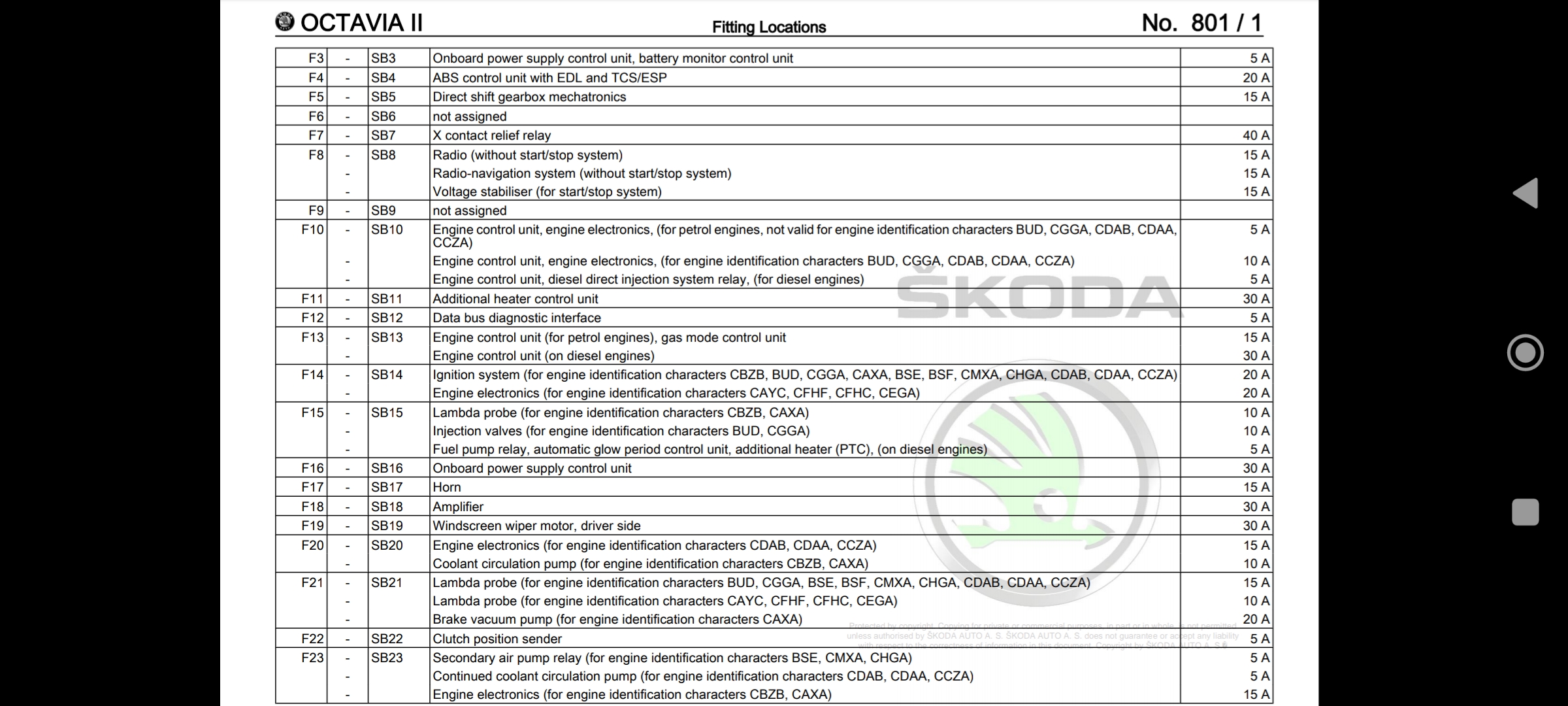

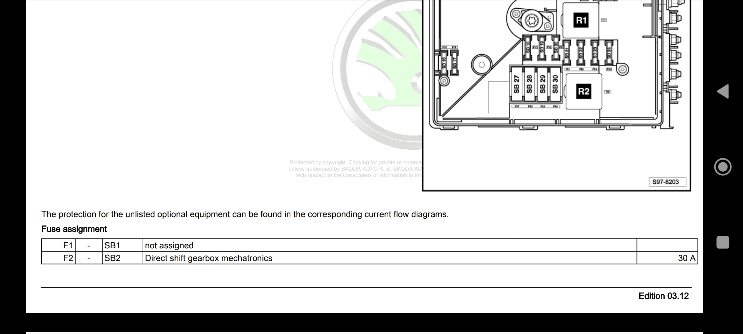

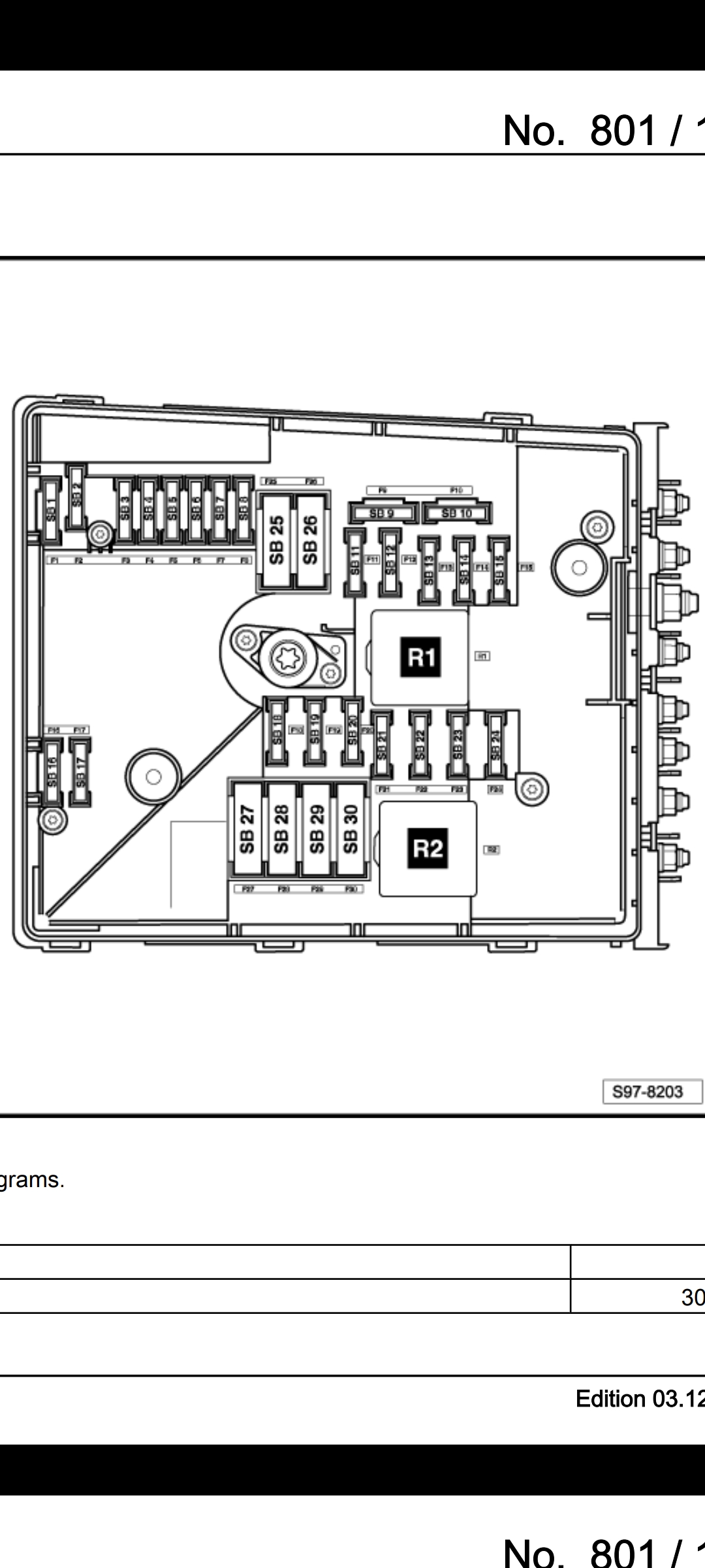

Like you say, fuse 39 and 35 are a match for the car. I'll need to look at all 3 sometime though. Do you have a list for the panel under the bonnet too, please?
Here these hopefully match...
