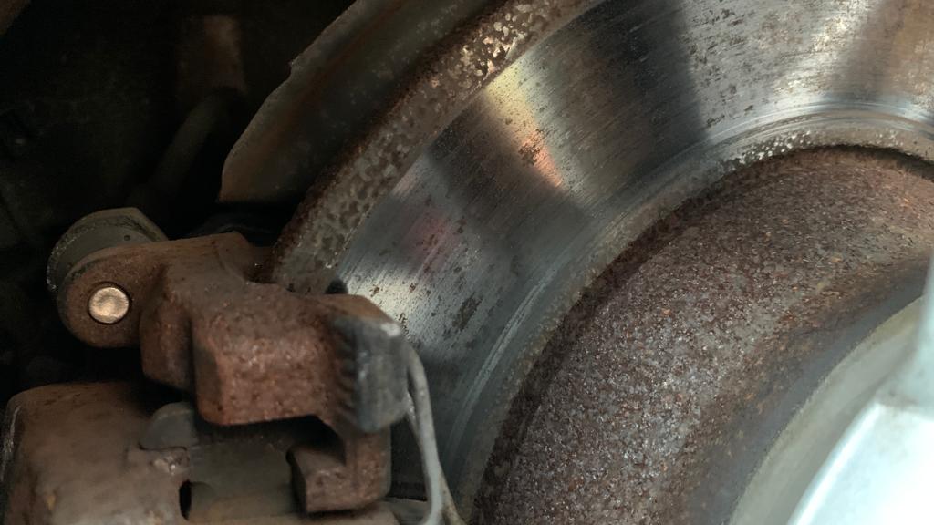

Since collection from a main dealer last September my Superb had a grinding coming from the rear brakes whenever applying them. I presume this was down to it being laid up for a small while before sale. A few aggressive braking sessions improved it but on heavy sudden braking it sounds quite loud dull sound coming from the rear of the car. The last time I heard this noise was back in the day when i had a Subaru impreza that burnt its pads down to the metal back plate!
On closer inspection I could see my rear pads are getting low (5mm on pad surface at most) and the disks have an encroaching rusty border on the outer and inner diameter of the disk surface. I have another VAG car that operates perfectly fine and looks very similar in terms of the brake disk condition albeit on my Superb it looks a bit more advanced. There's no play in the wheel bearings so I'm comfortable it's probably not that.
I was going to change the pads front and back as its fairly straight forward and see if that improves it, but but what do you think about the disks (one pictured below).
My Superb is currently on 46,000 miles.

As well to change those discs when you are stripping down and cleaning  up those calipers and servicing and doing a brake fluid change and new pads since it is you doing it.
Parts only no labour cost.
Yeah I will probably change the disks to be fair. It's an extra faff I was hoping to avoid but it seems a shape to slot some new pads in for them then to become worn down by knackered old disks hey.
If the back side of the discs are not delamainating as some do, and the pads have meat on them then go get the engine heated up and have a run and do some spirited driving and give the brakes an Italian Tune-up.
Clean off the braking surface as many a car trader does pre-sale.    If the pads are shagged and the calipers sticking and the brake fluid has too much H2o in it then that is not what you want to be doing.

The rear 300x12mm brake discs start at 12mm thick, and have a minimum thickness of 10mm.
If the rear brake discs still have over 11mm of thickness I would just fit new rear brake pads as the discs themselves look quite smooth apart from some deep rust spots.
Maybe clean them up first by using the handbrake little and often when going down hill. Don't get them red hot as there's no need for that, as little and often will get the surface polished up.
Don't do spirited Italian style driving because that wastes fuel, and using the foot brake mainly wears the front brakes, not the rear brakes. It's the handbrake you want, and only downhill to save fuel.

yes i would have tried the old handbrake method by now only for the fact they are e-brakes.
Have ordered some more pads and disks so will probably change the both.
