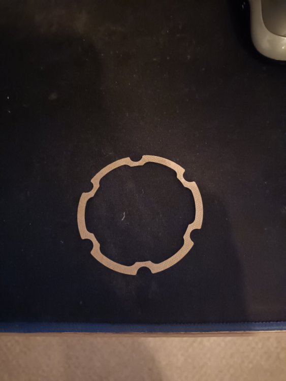

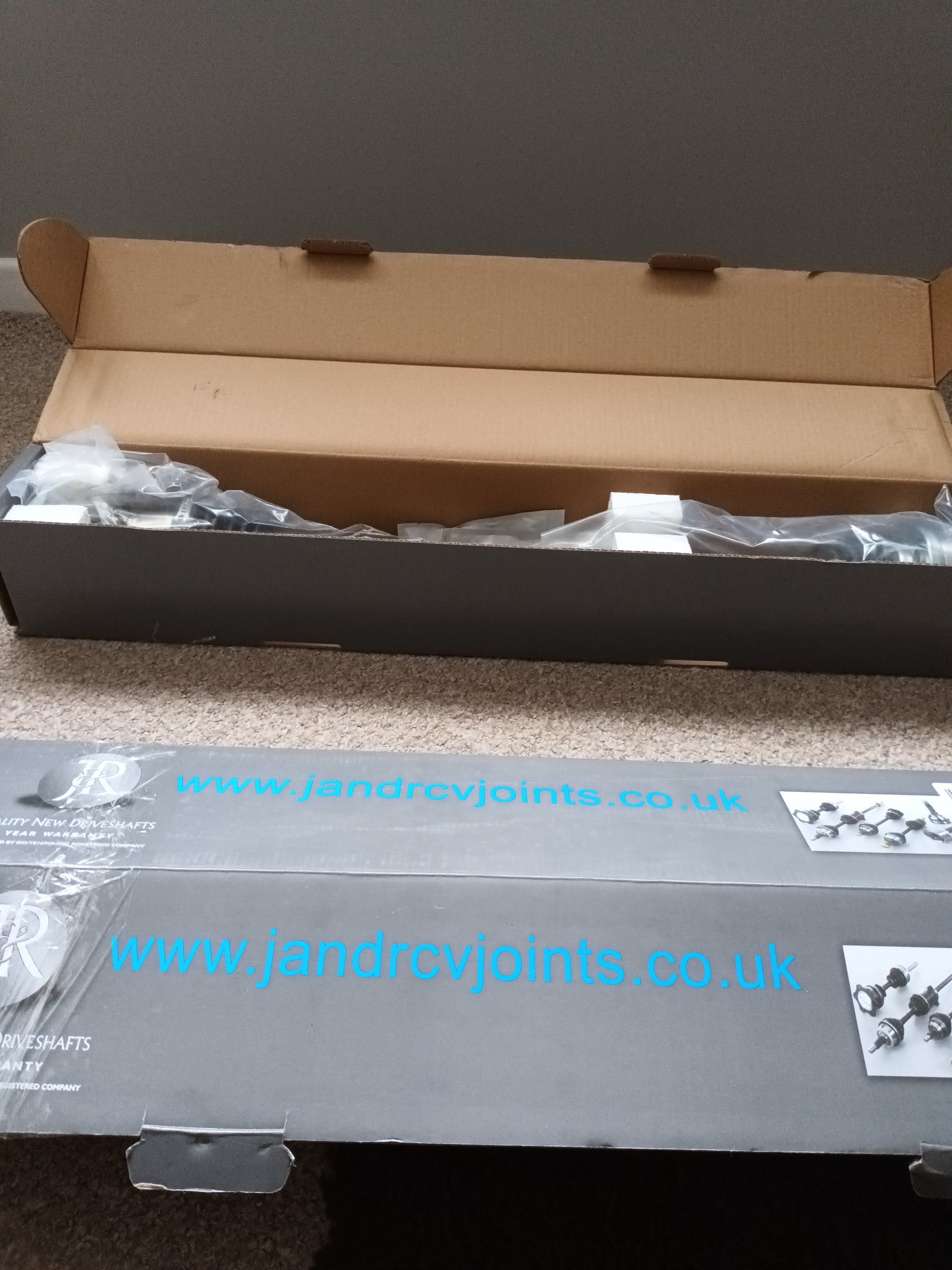

So I've decided to do a proper job and ordered complete new fully assembled driveshafts for both sides and I'm very impressed with this company and tbh works out better buying complete and makes the job a lot easier I would think if anyone else is considering it. Only issue I have is I have to find where I can buy the inner cv gaskets from like this.
This is the company I got parts from and next day delivery free all in cost me £101.
Yeah, they're terrible, sorry.
hmmmmm thats not good i ordered from here as a friend of mine had a set for his fabia and he says they were fantastic and ive driven in his car and seem great tbh 😞

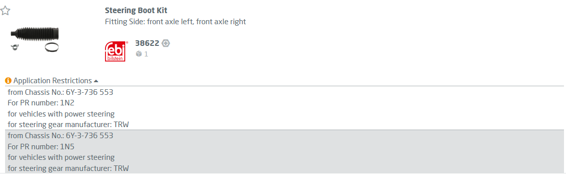

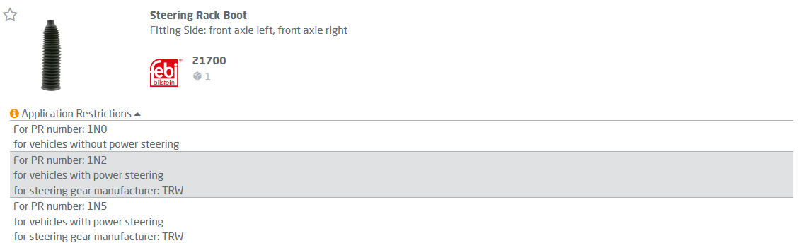

Further to our private message about Febi gaiters, there are two sizes depending on production number, which you can find on the label in the service book or under the boot carpet.
Skoda production number 1N2 = Febi 21700
Skoda production number 1N5 = Febi 38622
