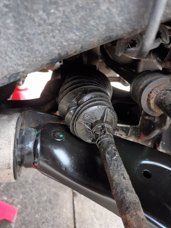

As usual you're overthinking this HORRIBLY, just replace the rack boot and keep an eye on the fluid level and everything is gonna be alright.
7 hours ago, Stewartasb said:
so is mine the in2 boots ???
Yes, your code is 1N2 so you need Febi 21700 gaiters.
I know your right boot is ordered and will fit and keep eye on fluid just a pia keep taking the battery off lol.
What I do is pull the arch liner out a bit and view the reservoir level with a torch.

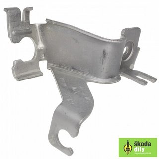

So it's all done I must say the hardest part is the ligning up and tightening the CV to flange bolts and I changed inner tie rods and doing it on Jack stands it's a pig to get the boots on and you have to use cable ties no way to crimp on the metal clips. I do have one issue though I stripped the n/s hub down and wire brushed it and treated it but I had taken off the small bracket that the brake hose clips into to hold it from flapping about but the missus thought it was scrap and put it out with the old parts and scrap man took it. I've no idea if one of these is buyable and I'm now concerned about the brake hose flapping about and if it gets damaged.
Edited by TMB
Yeah that's the bracket that's missing :crying:
Dump your missus :D
You could buy a new bracket from Skoda or buy a used hub and remove the bracket?
I dont really want to go buying another hub would rather buy the bracket but cant seem to find one mate.
dohhhhh got it on site now thanks tmb :)
£11.02 + VAT from Skoda
