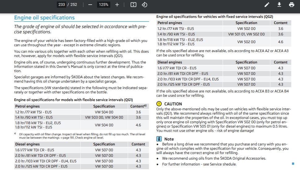

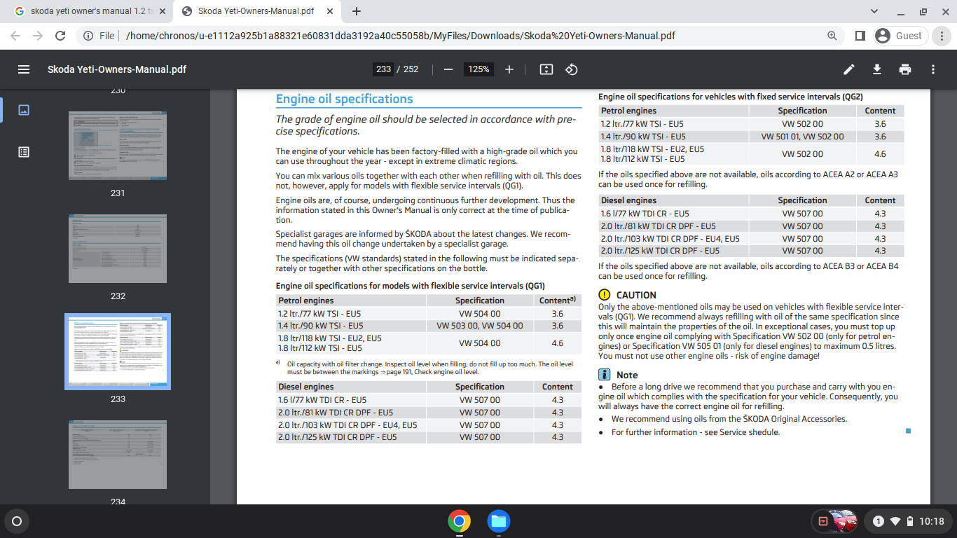

Hi and thanks to both Toot and Varooom for the above oil specs', not sure how we got there on this thread.
I note tho' none of the above images recomend what oil should be used for a petrol 1.2 TSI Yeti 2016 which is 83-85KW, 110 BHP varient,
109 bhp/ 110 ps / 81 kW
113 bhp/115 ps/ 84.6 kW
With a Keeper of a 1.2 TSI even from 2015 of what ever power i would keep doing fixed service oil and filter changes, high or low annual mileage and not use Long Life oil.
So not 5w 30 FS III, or 0w 30 FS III & not 0w 20 FS IV.
I would use to VW 502 00.
Not long life oil, but a longer living TSI.  *Just in  my opinion.*
When the engines / emissions changed to Euro 6 the TSI's, 1.2, 1.4, 1.8, 2.0 TSI's stayed the same.  (Some published stuff shows VW changed in 2015 to the new oil)
Fixed or Flexible service regimes,  VW 504 00 / 507 00.    That is 5w 30 FS III  (Long Life).
The Fixed is VW 502 00 if you want.  5w 40 FS usually.
That stayed the same until the WLTP was coming in and VW needed lower emissions during testing.
VW508 00 / 509 00
So they started using 0w 20 FS IV (Long Life)  and never mention anything other than for Variable Servicing.  & not backward compatible.
So that is really for the 1.0, 1.4 / 1.5 or 1.8, 2.0 TSI's that have a GPF.
But then Dealerships were often not servicing and using that in 2018 on and neither were owners when they became aware of the price.

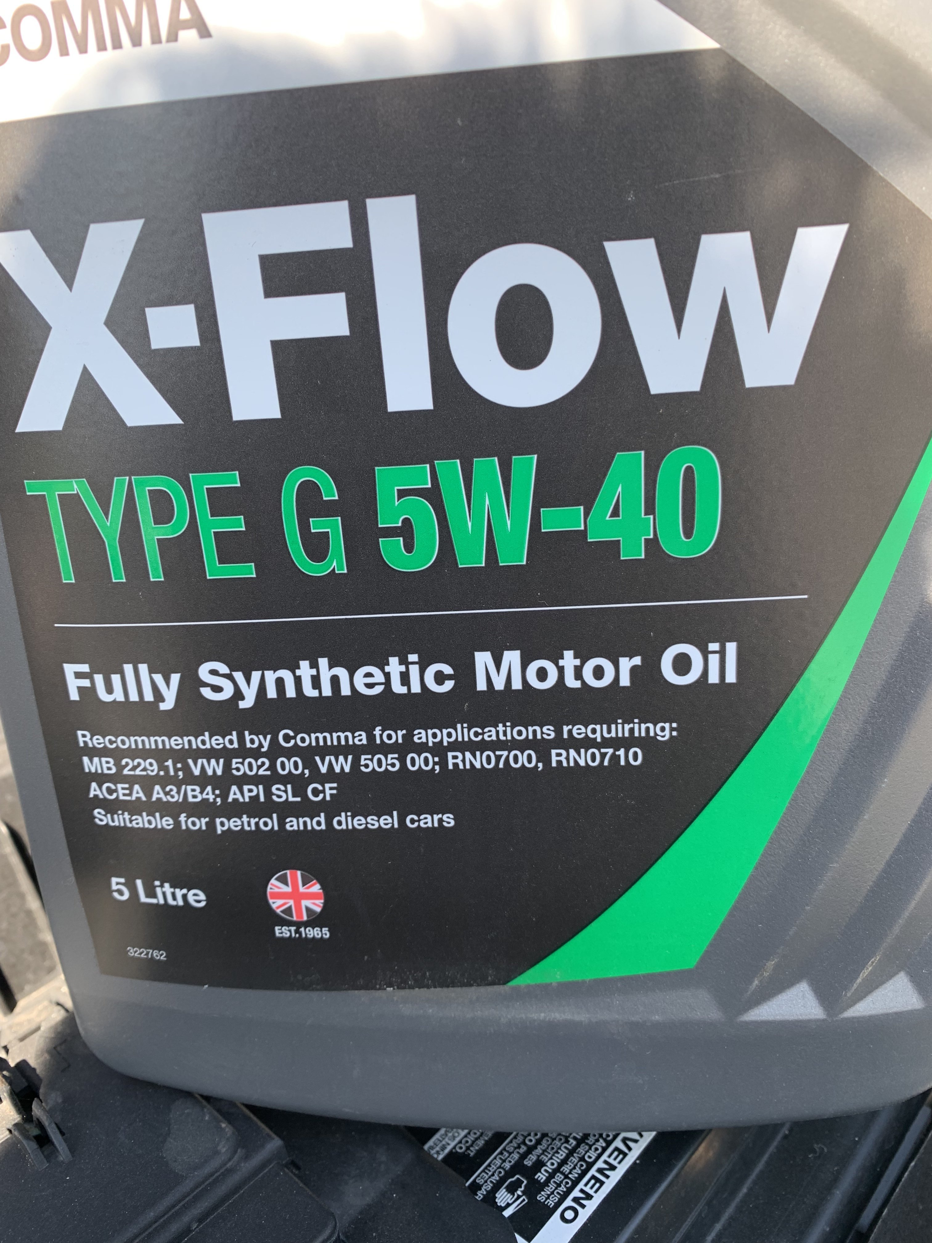

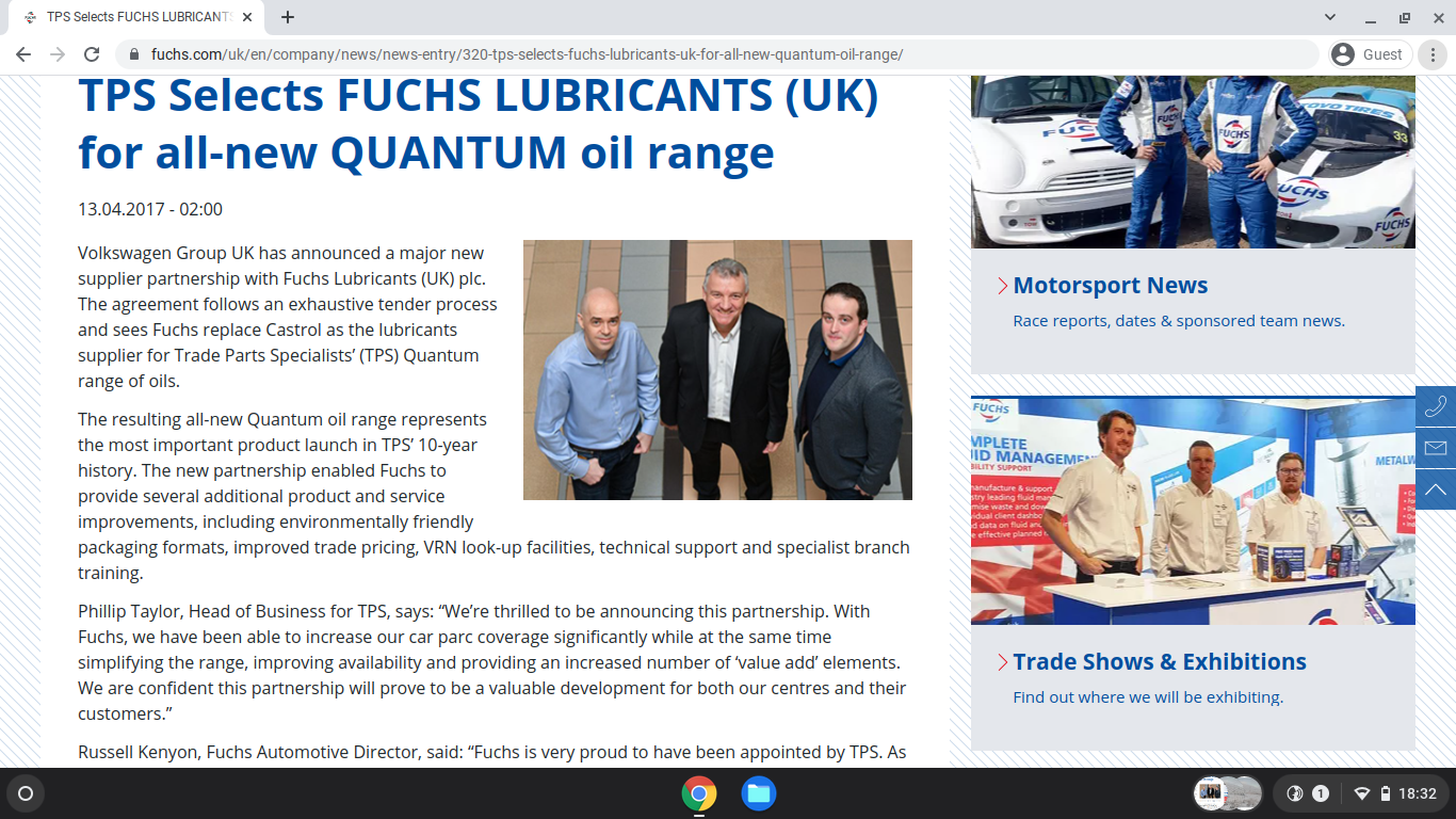

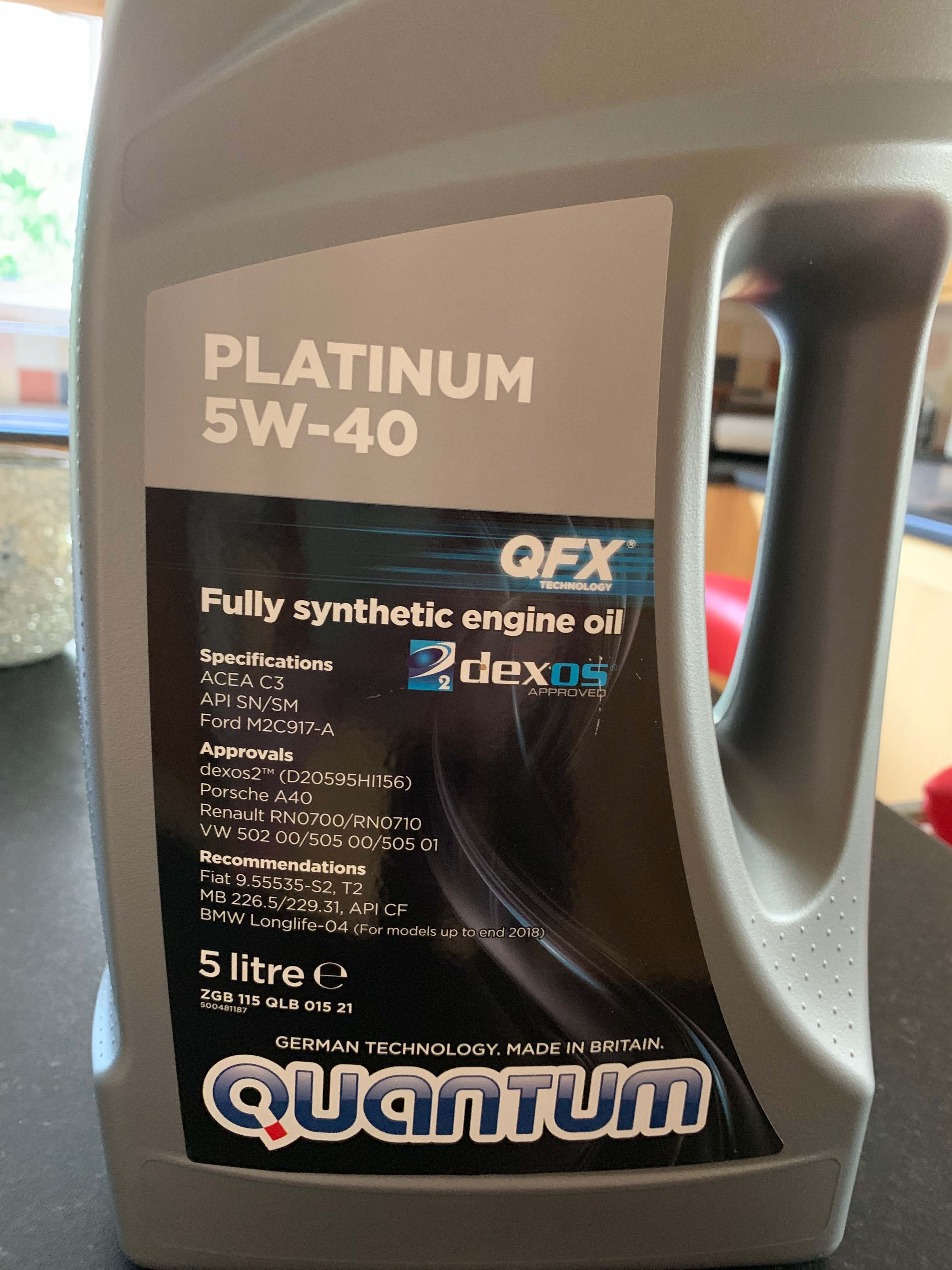

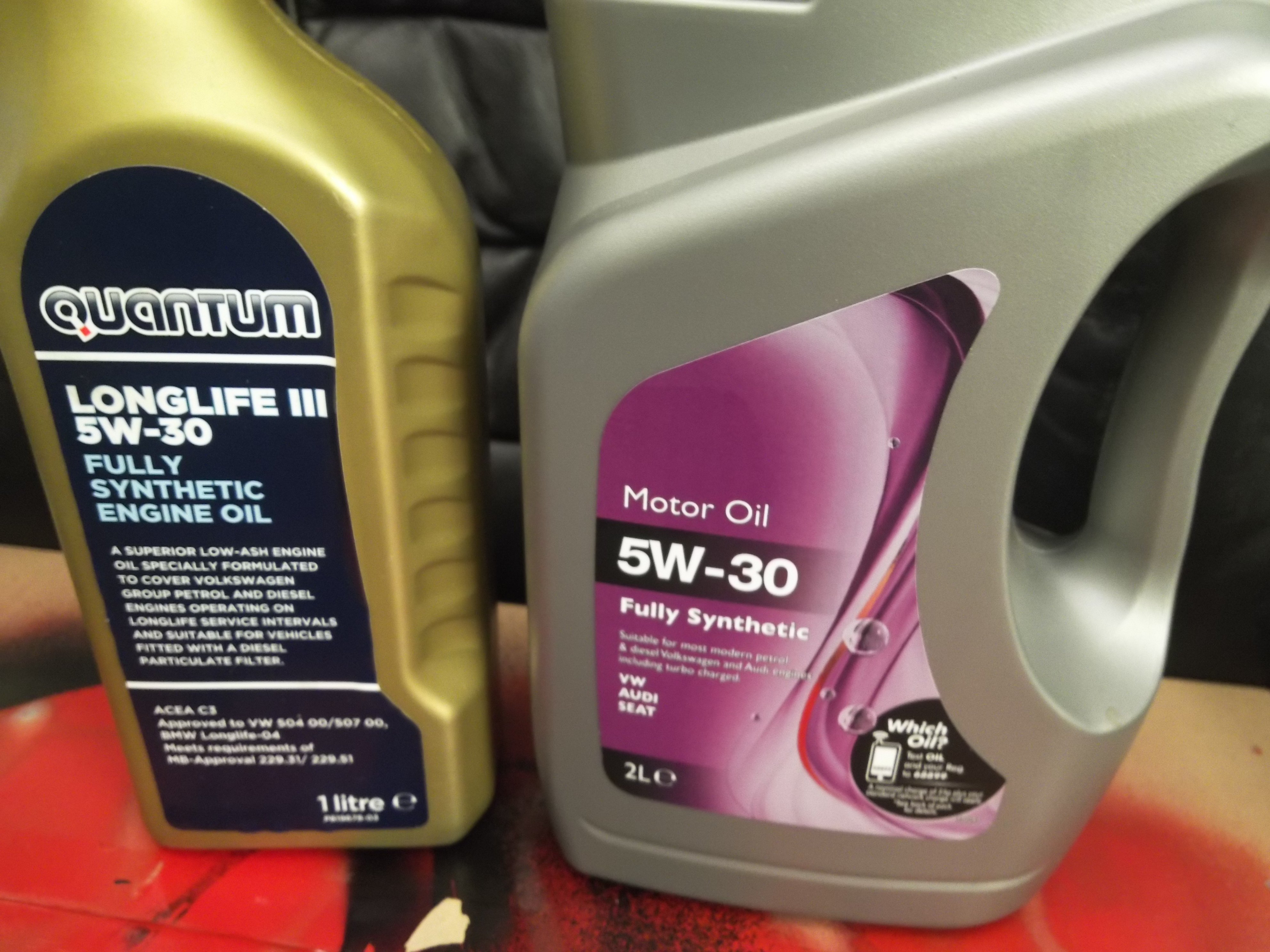

@cadoI like good oil, the correct oil,
but for a 1.2 TSI the good oil can be in a ASDA, TESCO, COMMA container or a Fuchs / Quantum or any other as long as to VW502 00 / 5 w 40 Full Synthetic.
As to VW recommendation and Castrol.  VW never did to well with many Euro 4 or Euro 5 engines and their longevity with Long Life Castrol,.
Funnily the Japanese, South Koreans, and French manufacturers recommended other oil producers than the German manufacturers.
Thanks Toots
and why 5W-40 and not 5W-30 as specified for a Yeti 1.2 TSi?
Use long life oil if you want it is for Fixed or Variable servicing, but personally i do not like it for a TSI.
I am not suggesting non Long Life to save money as the price difference is near nothing if there is any difference.
I like 5 w 40 FS for a TSI.

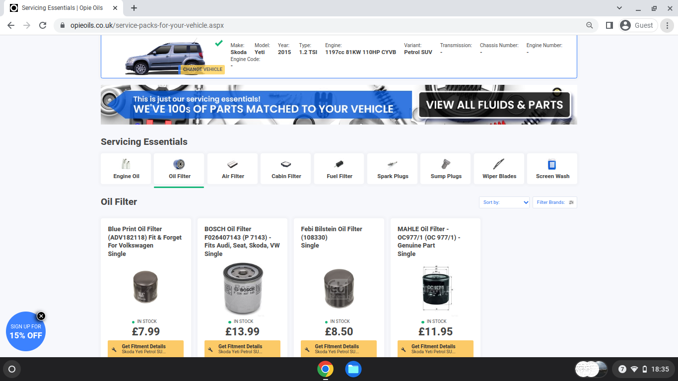

On the subject of oil filters, my Yeti being a 2016 1.2TSi manual, petrol and a diffrent layout to diesel versions, where is the oil filter on my vehicle, is it accesed from the top or bottom?
Would you know if it a canister or filter/cardridge type?
@cado what about how your Yeti will be used makes you think Long Life oil is right?
Why would you change oil and not spend around about £10 & change the oil filter?
Hello Toot
I think something has got lost in translation in one of my posts.
I don't think LL oil is right for my Yeti.
An oil filter change is usally a must with an oil change-- but as I am going to undertake oil changes much more often, 6-7 thousand miles, I was wondering if I could skip an oil filter change to every say 2nd oil change?
cado, 500, 700, 1,000 or a time are just a figures really, conditions of use and environment play into when might be best for the oil change, most people wouldn't bother, engineers will say it's a waste of time and any oil to spec will do (what spec when and how it was arrived at is a different matter).
Personally I don't but into the idea of a long life oil, a better oil will protect better for longer by its extended protection and retaining its protection over wider ranges, more consistently.
I'd change the oil at least once a year or 12k-miles.  I can't see any point in not changing the filter every time the oil is changed as you hope the filter is holding some crud so you want that out of the car for the new filter to collect the next lot.  And I prefer to use better quality oil filters, what they are for VW I've not really established yet as I've managed to avoid the hassle of doing an engine oil change on the Fabia (though I have done the "waste of time" gearbox oil change).  Just to make things clear I  l - o - a -t - h - e  doing any work on cars we own, dirty messy horrible thankless unrewarding pain in the back, neck and head way of passing time, but I'm not so anti doing small jobs on other peoples' cars .
Americans might consider 6-7k-miles a long oil change interval, but things are cheaper over there and they love oil.
I am thinking that I might do (a) 6 month engine oil and filter change on the Fabia as it's used so frequently for very, very short journeys but the plastic underheld means it needs driving on to breeze blocks for me to get my head under there to get the shield off, and I need to lug the breeze blocks there and back and be arsed to do the job that if my back's not playing me up from the "£$%^&* stupid idea of using wheel bolts instead of wheel studs, the !£"$!%^&.
IIRC on my wife's Fabia 1.2 TSI the oil filter is middleish at front  (near cooling rad) and looks easy enough to get but I've yet to discover how true that might be.
Do bear in mind the engine is not of importance compared to the brakes, steering, suspension (all three include the tyres), safety electrics (lights, wipers, blower, horn, car battery) and windows.
