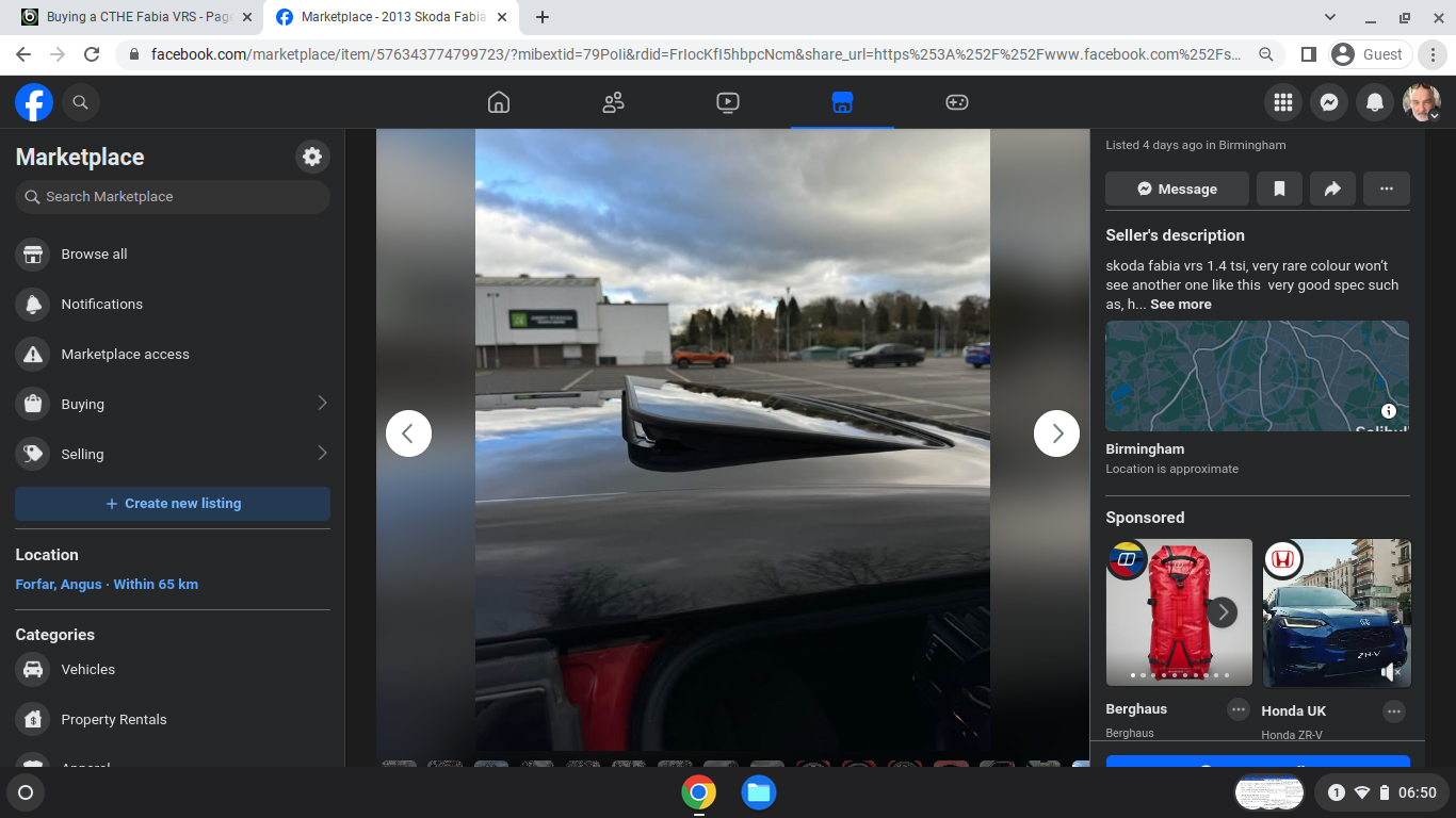

Never ever seen that colour.   Looks good.    It has not had a Full Respray has it?  *Possible car done by Skoda for a show or advert, special anyway.*

     EDIT. I see it has a sunroof.

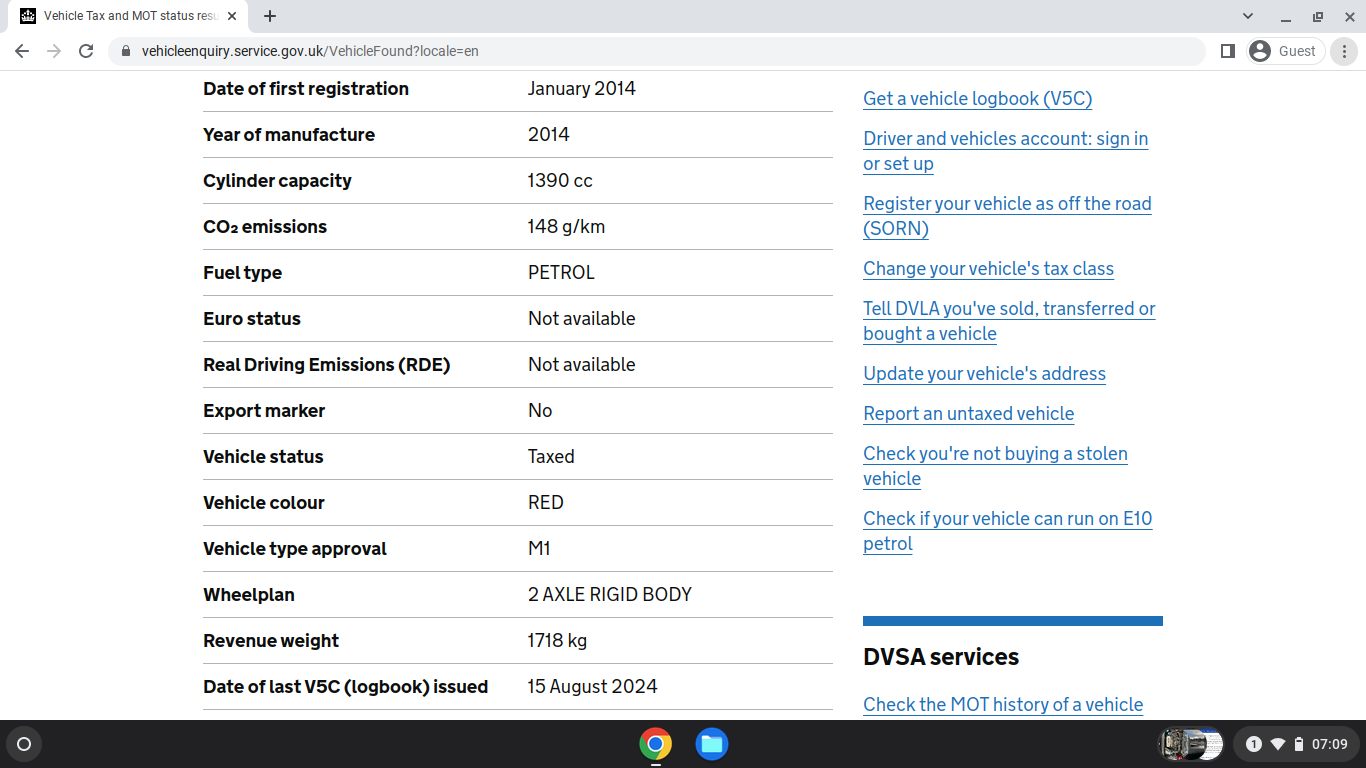

DVLA.
I See First Registered 2014 & says year of Manufacture 2014, well obviously it was manufactured before being registered the first month of 2014, so a 2013 car.

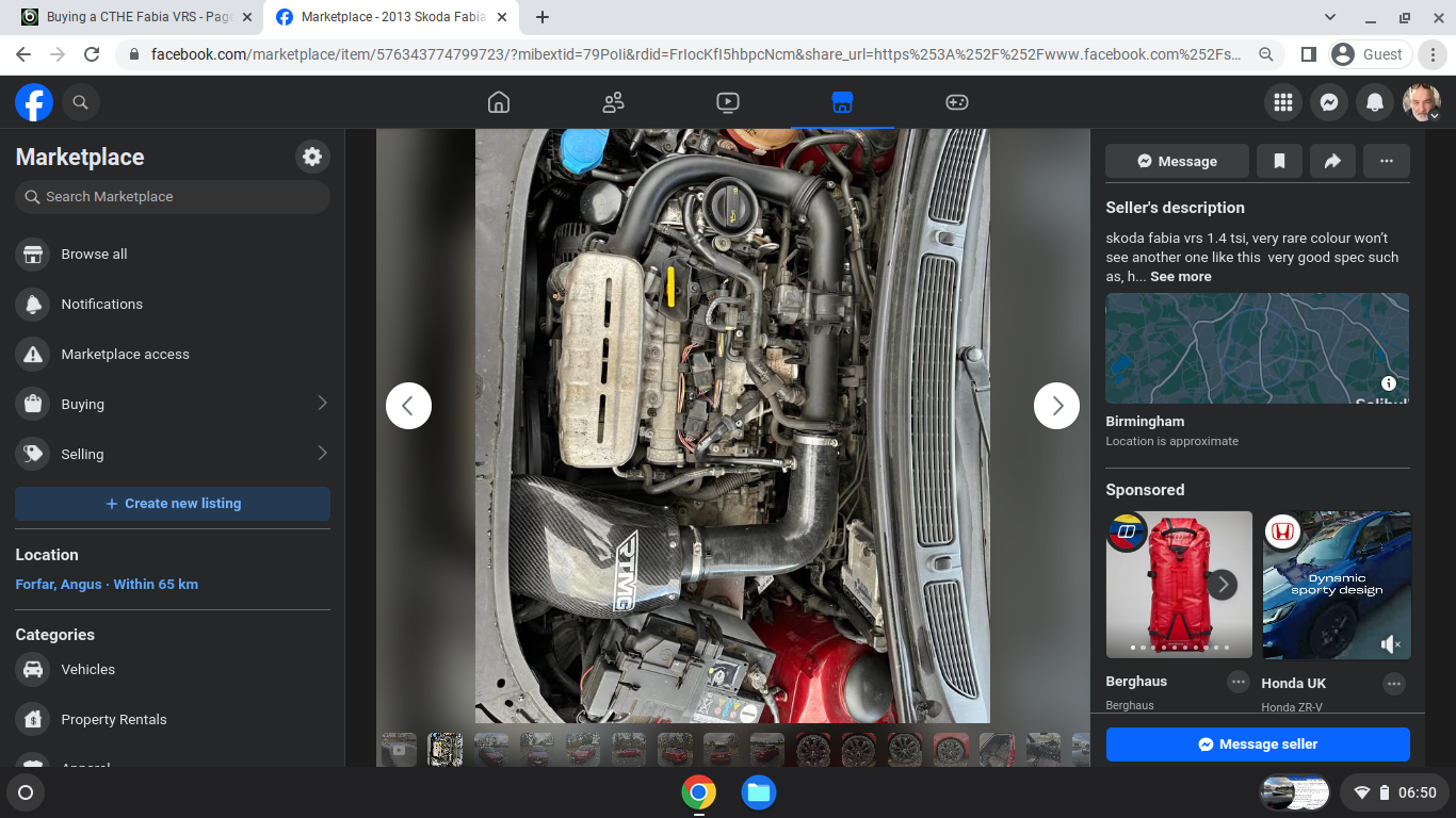

Remapped.  Which is OK if it is and runs OK.   Correct plugs, coils good etc!!!
Modified.  Remap, Exhaust, Suspension, Wheel Spacers.

FRONT WINDOWS, Is that extra tints on them, so illegal?
