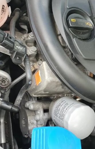

That orange sticker on the engine, drivers side,. if you are at the car take a picture of it.
Edited by toot
Yeah reg checking it shows V5C was requested in 2018 so I think that's when they got it. Unfortunately I don't have anyone I know that knows DSGs let alone twinchargers so more research will have to be done prior to viewing/test drive to know how they behave/drive.

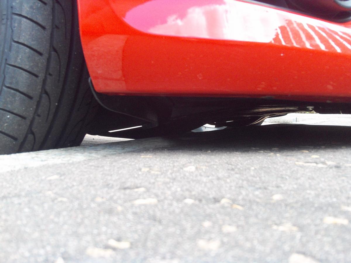

If it does not have an undertray that is because it is missing.
