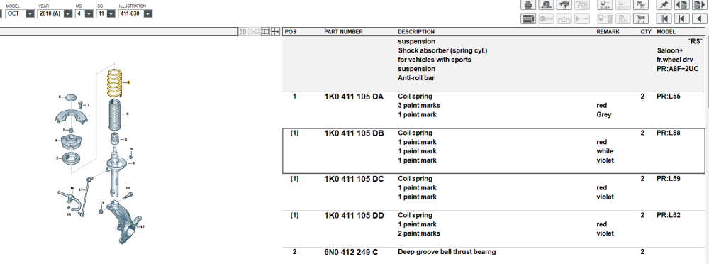

Here are the only choices for a 2010MY VRS Saloon
So it can only be 1K0 411 105 DB, with a red/white/violet mark

KYB RH3941 is sold to replace just 1K0411105DB and no other OEM part numbers, so should be an exact match.
Kilen 23117 is sold to replace 1K0411105DB, 1K0411105EB, 1K0411105EC, and 1K0411105JB, so may not be an exact match to 1K0411105DB.
KYB RH3941 is available on ebay from carpartsinmotion for £25.05 each
