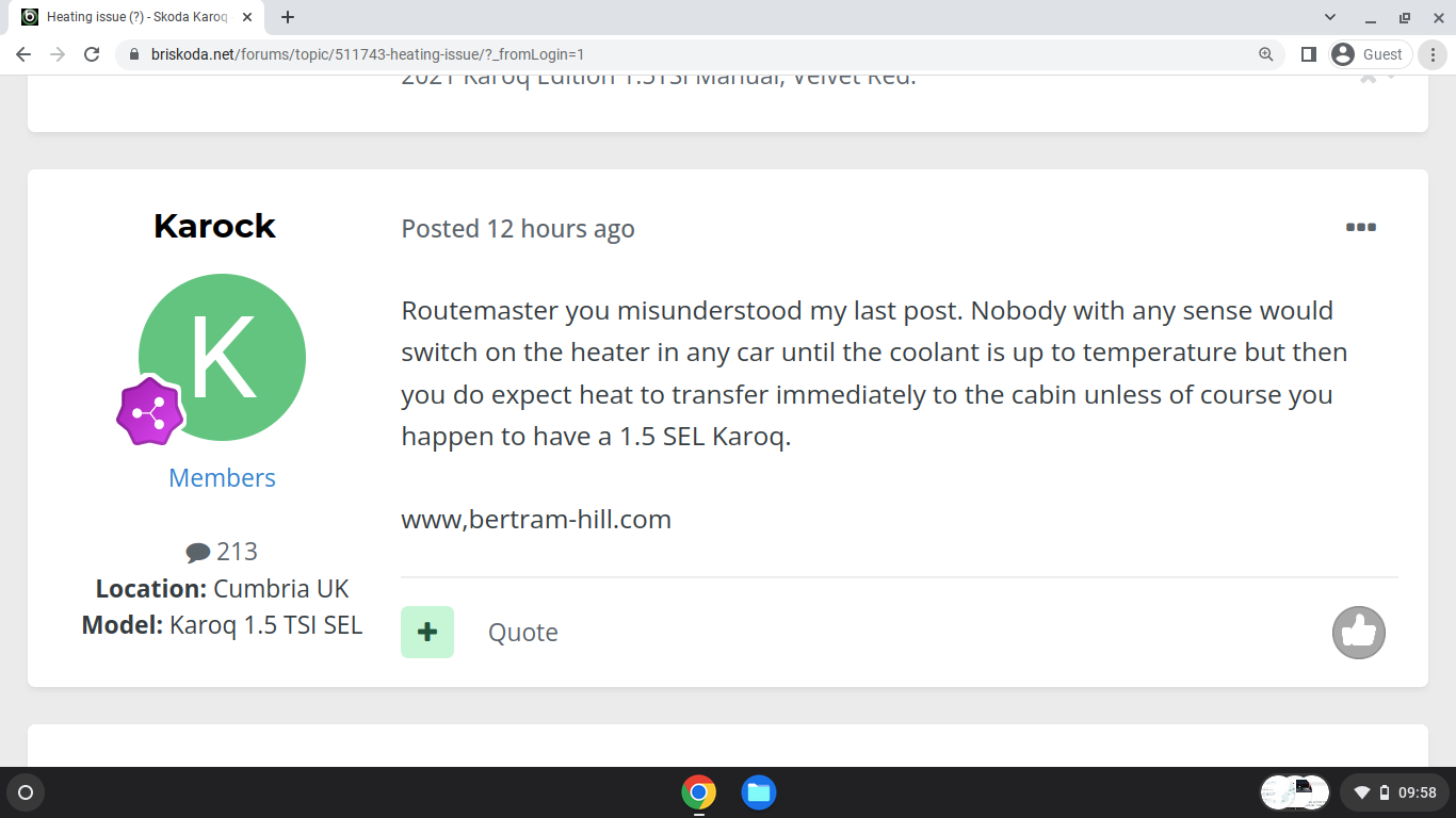

Routemaster you misunderstood my last post. Nobody with any sense would switch on the heater in any car until the coolant is up to temperature but then you do expect heat to transfer immediately to the cabin unless of course you happen to have a 1.5 SEL Karoq.
