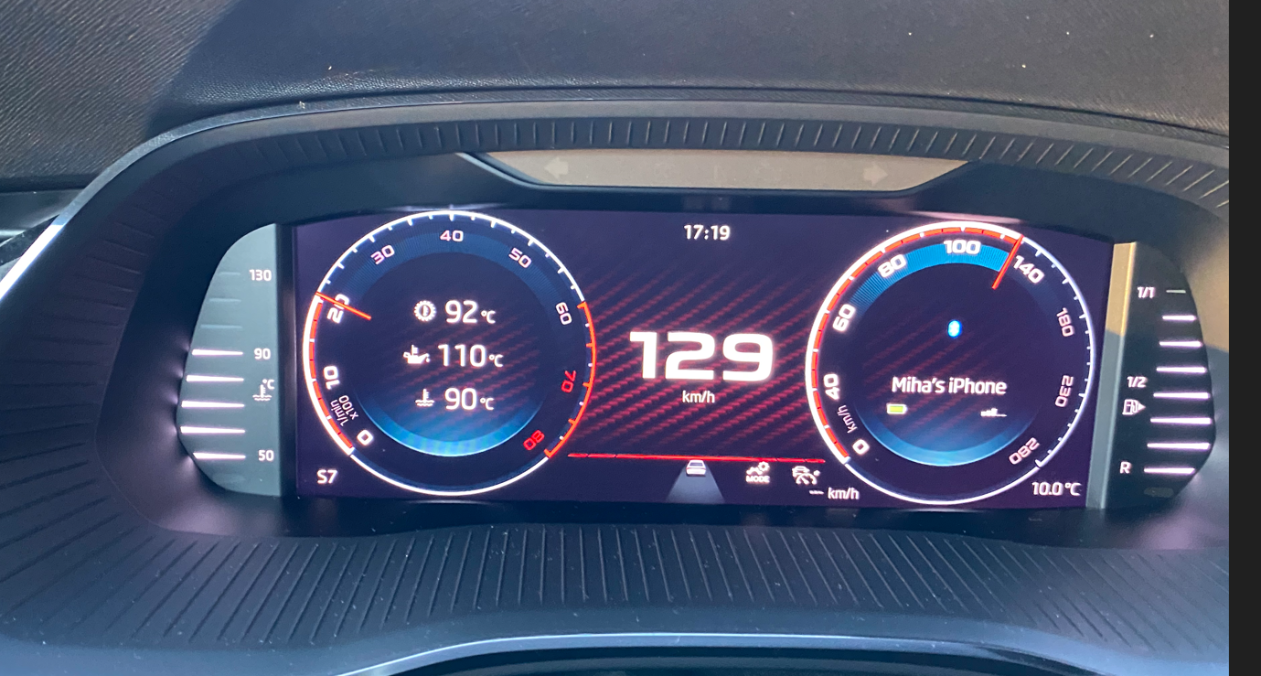

Hello. I do not remember to have configured any special settings, but in my car the incoming call is always shown in the right side of the virtual cockpit, indicating the caller name and giving the option to accept or decline the call with the scroll wheel at the right side of the steering wheel. I do not need to select previously the "phone" menu as shown in the picture from "UltraRunner"
