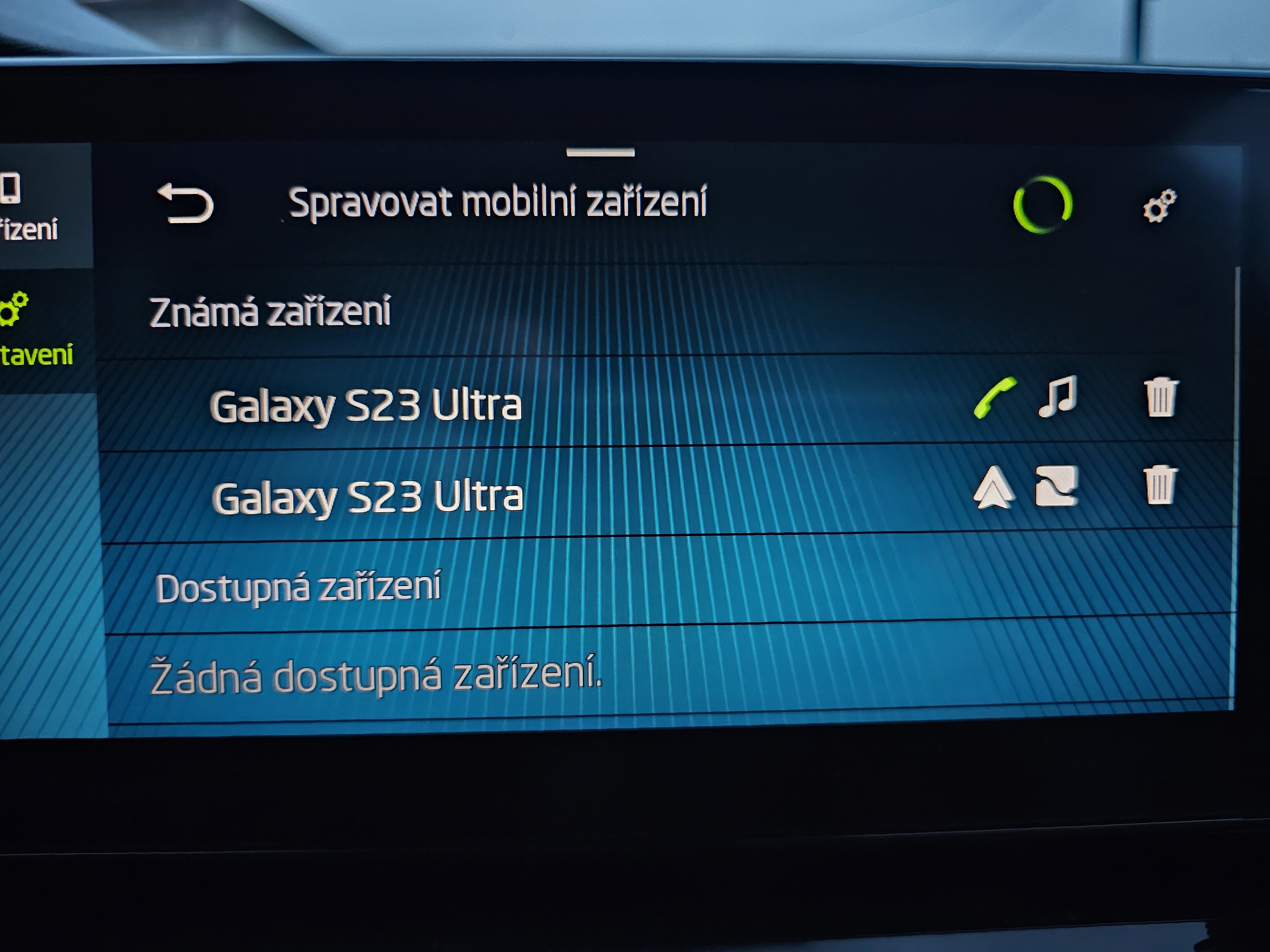

Hi guys, is there any solution to get AA working on Swing with S23 ultra? I have tried almost everything on my octavia 4 but nothing helped.
All I can get is connection failed and I can see two phones in my menu. One for Bluetooth connection and the other one for AA connection.
I have the same issue (octavia 4/swing infotainment/wired connection) with my S23 ultra as well. S10+ and S20+ connected flawlessly to my car before but it is infuriating that such issue occurs on such a high end phone.
