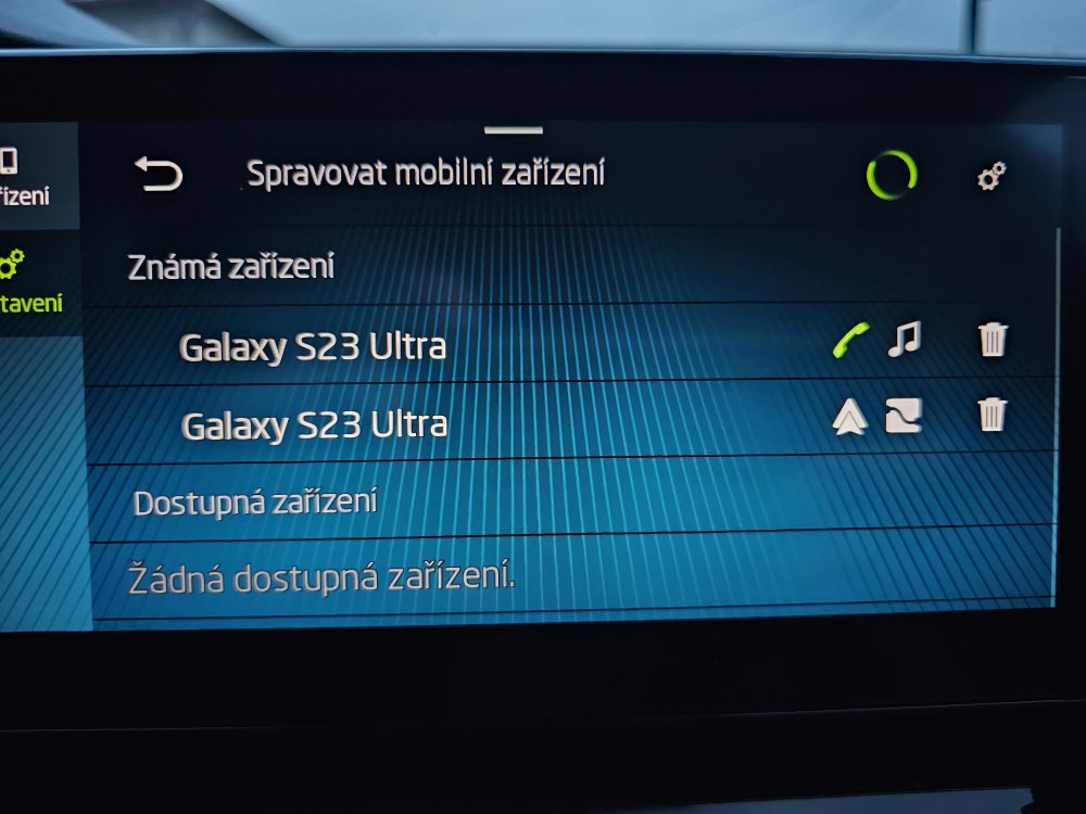

S22 Ultra works with my RS okay.
Before I swapped it (the car) my S23 Ultra worked fine with my vRS.
I have S23 Ultra and it works perfectly in my RS
yep - S23 Ultra works like a charm! :)

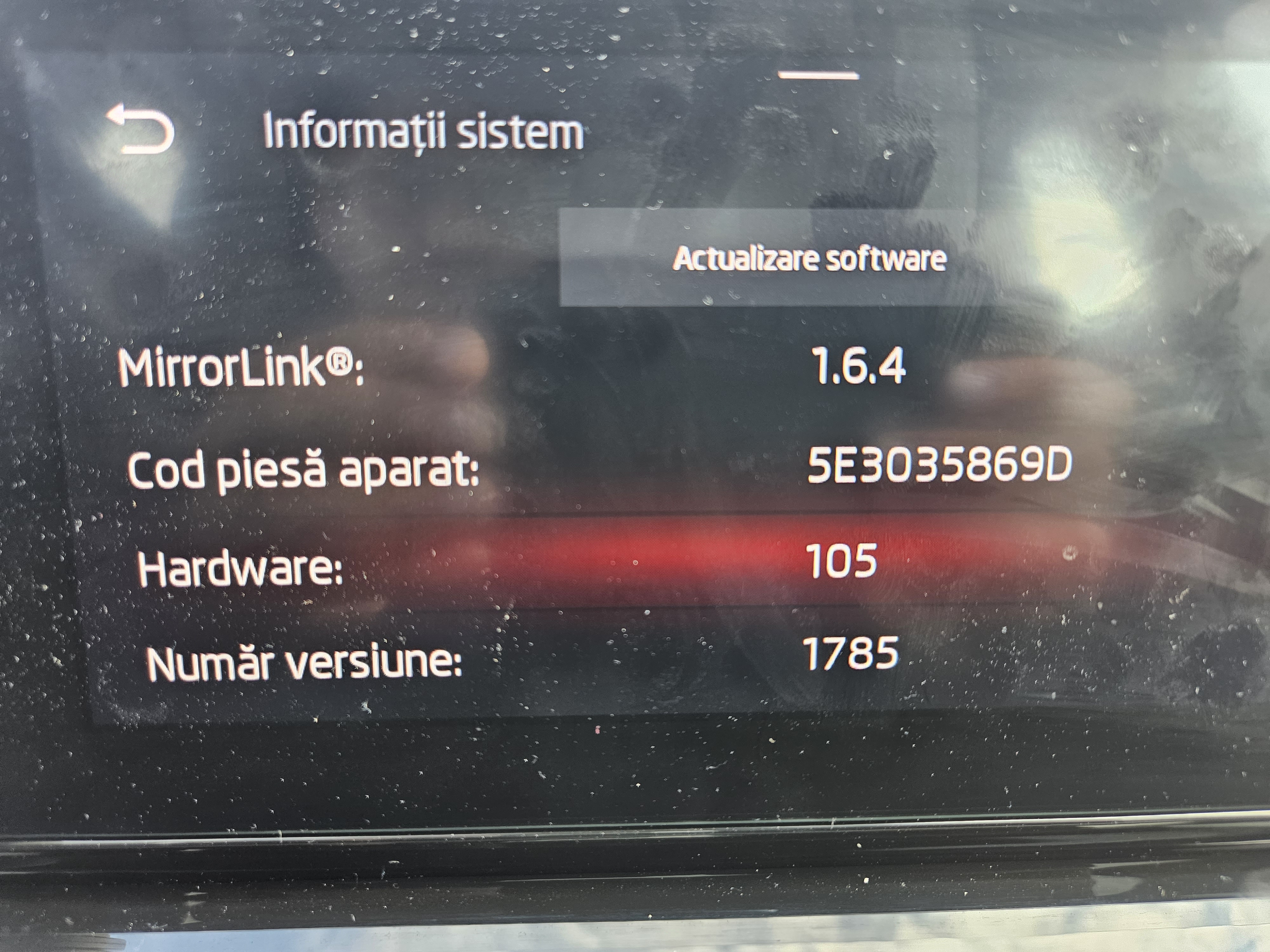

No love between my new S23+ and 2023 Octavia 4.
Any ideal?
Thats the software I got on the Octavia. Is there anything nefericire, or any other solution to this?
Thanks.
I'd try updating the infotainment system firmware to 1941, it seems to cure an awful lot of issues, I've had absolutely no more problems with restarts since I updated it.

So what's the actual problem you encounter with your phone? Does it fail to connect? Does it disconnect after a while? Both on cable and wireless?
Not working at all.
I think my car isnt specced with wireless AA, so it doesnt work at all.
When I'm connecting it wired,  I get the AA notification on the phone, but the car's HU says that it cannot connect.
That's odd!
Wired AA should work without any glitch.
Concerning the wireless AA, IIRC since MY22 or MY23 all mk4s should have it. The first 2 years only had wireless CP and wired AA. (someone correct me if I'm wrong)
Can you check all permissions are correctly set for AA on your phone? And make sure you have a good quality cable...
Odds are @TheWanderer has a good idea, your firmware is very old, and I could be wrong, but I think there are fixes for wireless AA mentioned in a TPI document.
You really should consider the upgrade.

Actually is that infotaiment Bolero/Columbus or Swing? Looks like Swing to me...
The small one, 8", I think it's the Swing.
The car's data says Apple Car Play wireless, AA wired.
I just need the wired to work, wireless would be a bonus :)
Swing has different software versions, but i don't know the numbers, so i don't know if it's old or not.
Might be, that factory messed up coding, which happens. Best way would be to report it to dealership and they should check.
Updated the Swing software to last version, published June 2023.
Updated Android Auto to 9.8.xxxx
Updated the phone to latest July software.
Changed 3 USB cables, 1 OEM, 1 original Samsung, 1 original Motorola.
Still not working...cannot connect to the S23+
Any ideas? :(
