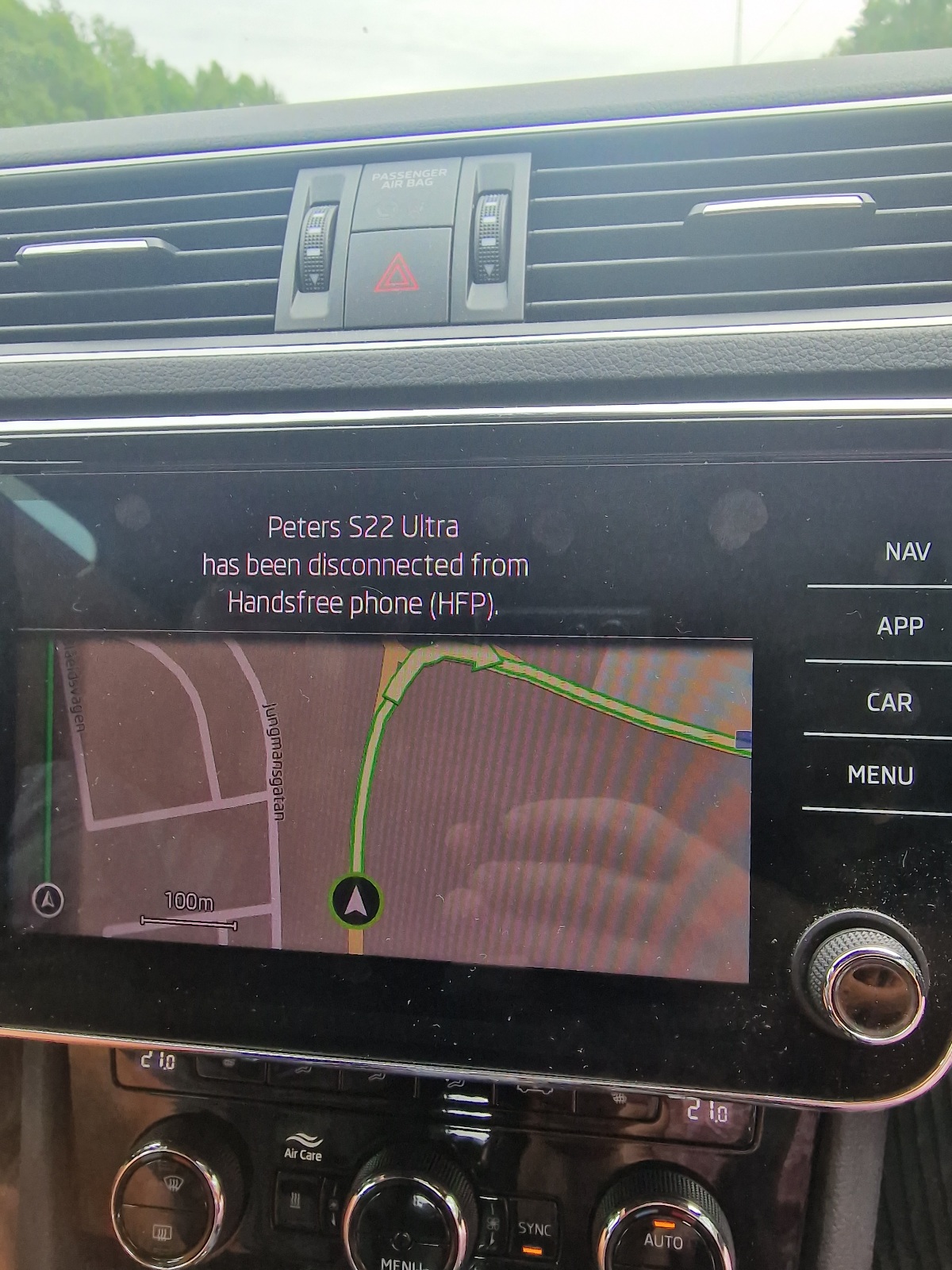

Original problem:
Android auto disconnects.
Therefore Android Auto disabled, however, I then noticed that the car indicates Hands-free tel (HFP). The connection to S22 Ultra is disconnected. During a call the bluetooth breaks down, then the bluetooth is restored, but the car does not pick up the call. The bluetooth connection with for example my smar****ch does hold.

Updated Infotainment on my Skoda Superb iV 2021, Updated Samsung Galaxy S22 Ultra.20230630_131112.thumb.jpg.0190b843525a5233d5167be4fefd0dcc.jpg

Superb 2022 model connected to Samsung S22+ here with car and phone up to date. I've had the same problem a couple of months now. Bluetooth for HFP keeps disconnecting, even in the middle of a phone call. Sometimes it's fine, others it will disconnect every 5 mins or so.
Tried DaveP70 technique, but it disconnected HFP almost immediately afterwards!
