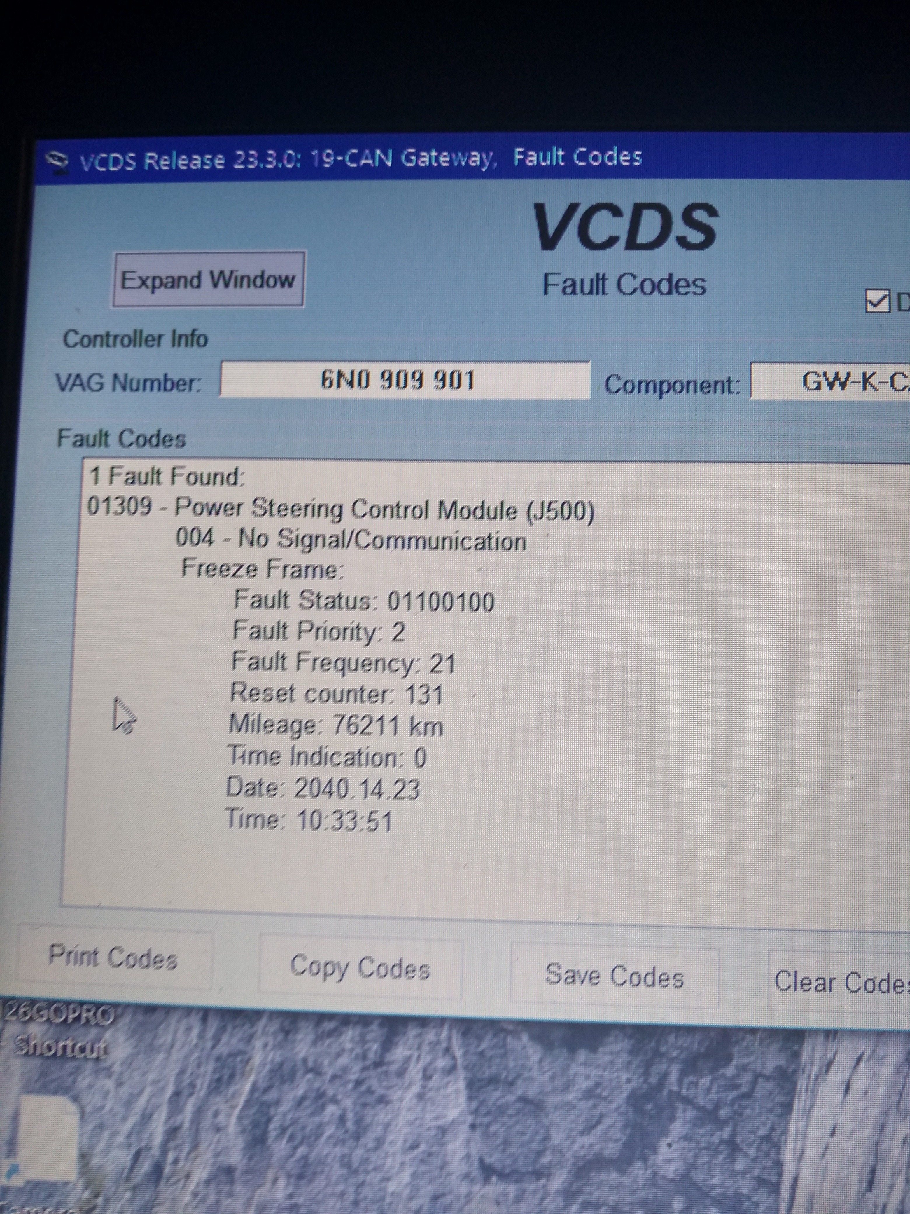

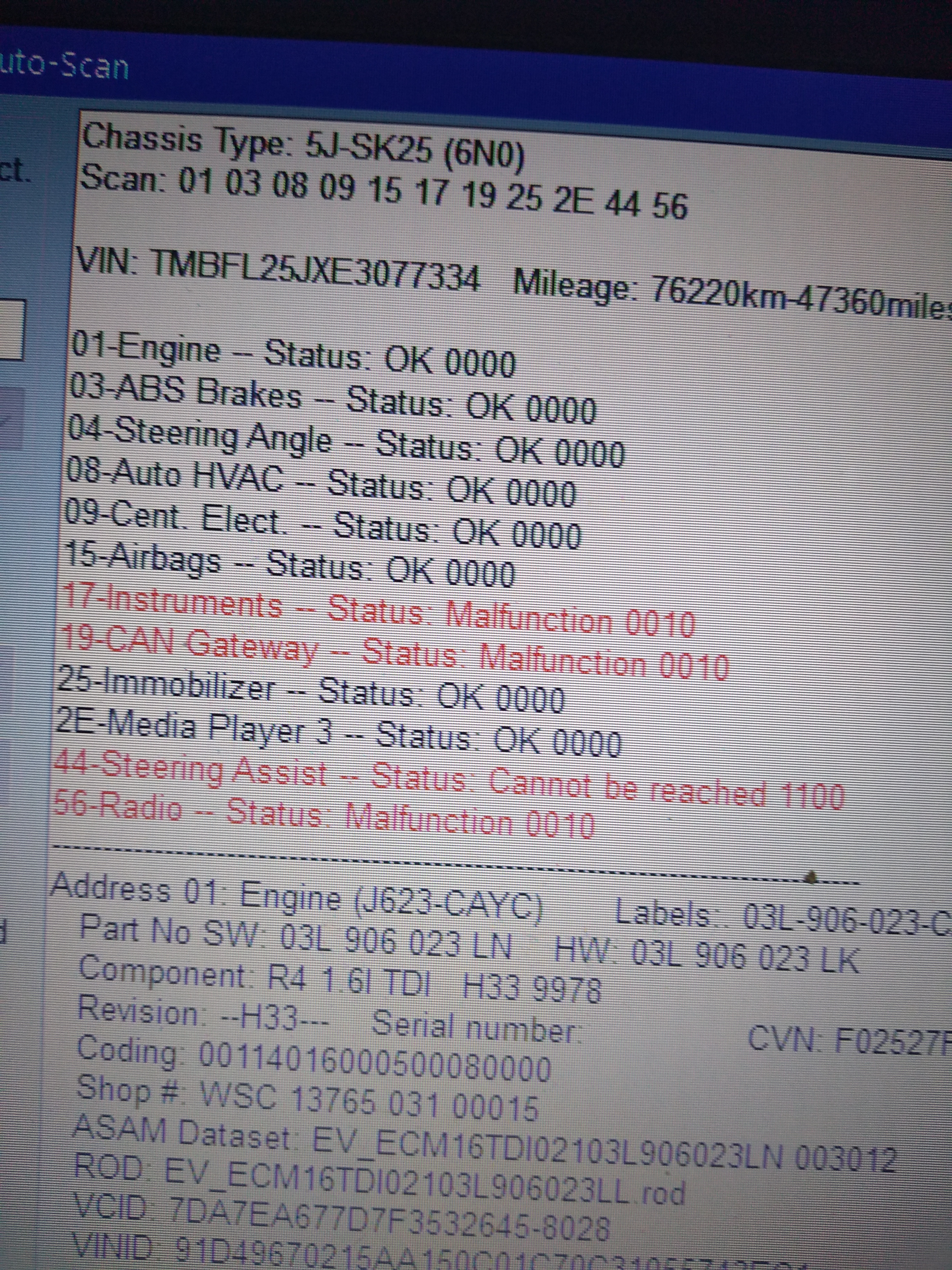

Hi bought a recommended scanner here's a readout pic any ideas why it won't connect to steering.thanks

Wiring fault is always a possibility for no comms, either the CAN pair or the ignition switched feed on the same 4-way connector (or the fuse for that feed, though often shared with other functions. I am in a car (not driving!) just now, not sure if I can look at circuits to say what fuse, but will try.
  • Sponsor
Cabin fuse 16, I think; but that is shared with a few other things that you would know were not working if it had failed.

Ok thanks is the only control module on the pump or is there one on the rack
  • Sponsor
Pump only.
Is this the original pump or a replacement?
2 minutes ago, Breezy_Pete said:
Pump only.
This is the original Iam assuming that it's the pump control module that's the problem.
  • Sponsor
Yes, if the wiring is all intact.
Hi thanks for your help will try fitting a replacement pump hopefully that will solve my problems.👍
