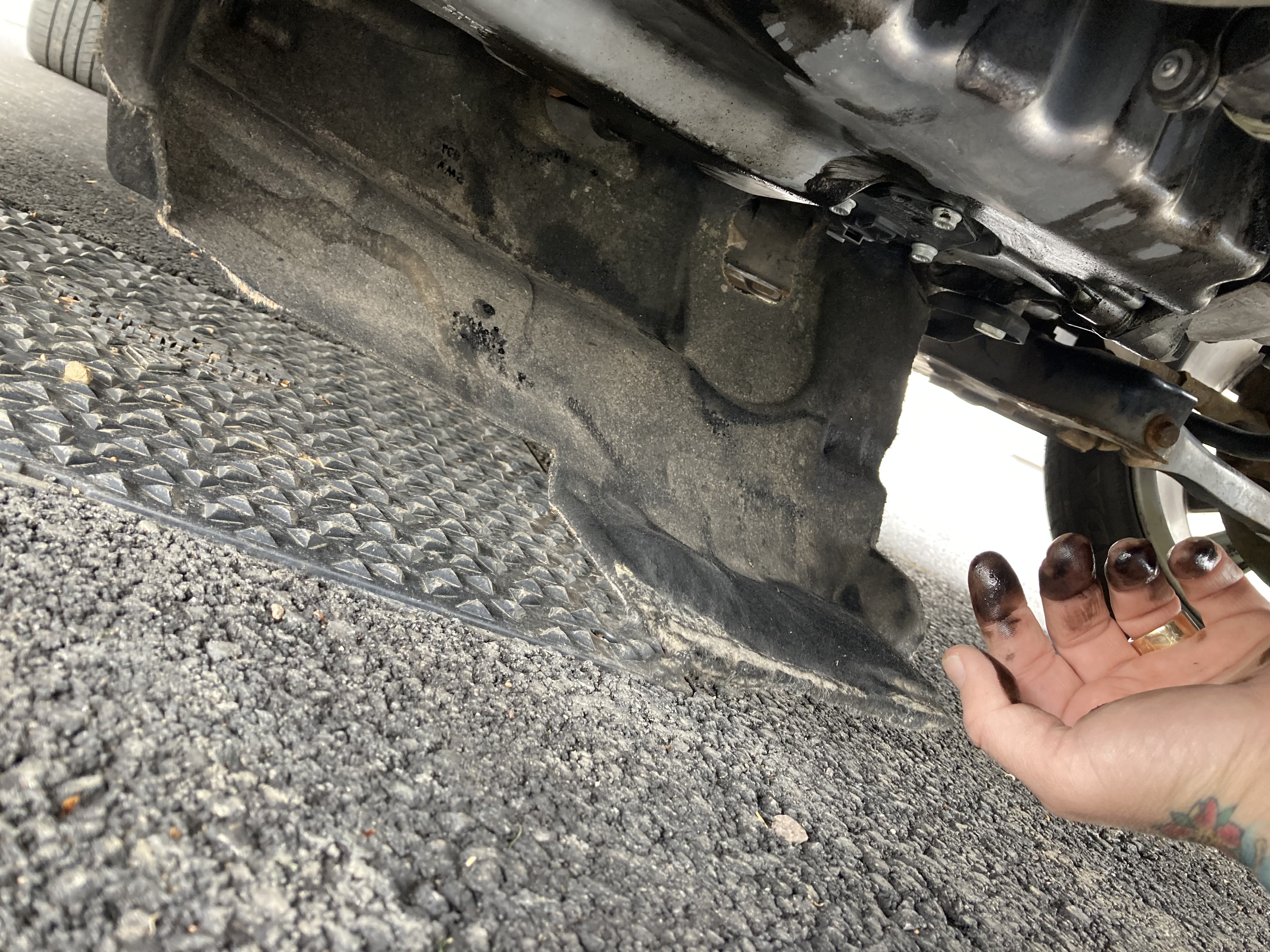

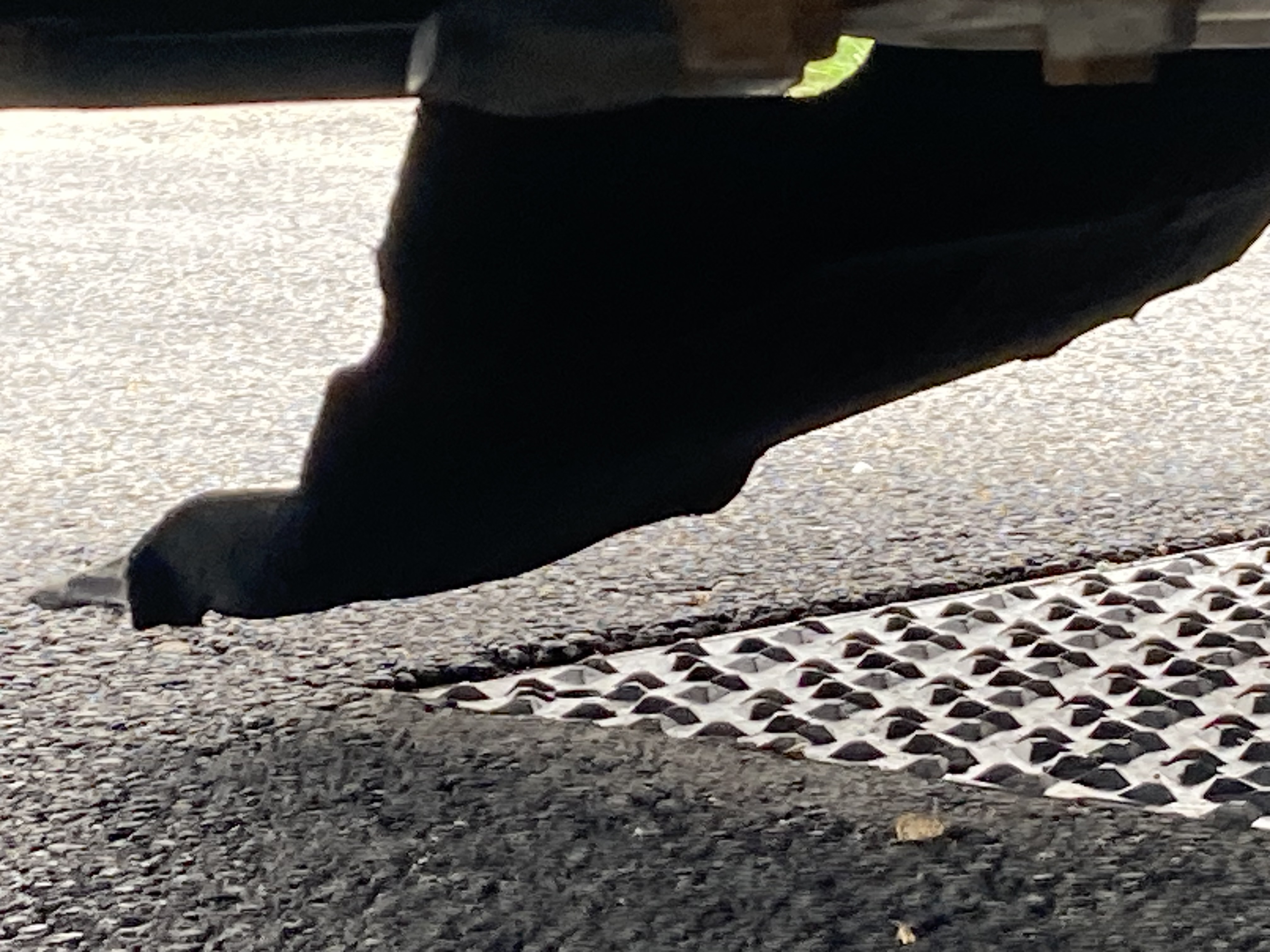

Under tray
Dadd10
Lucky enough the under tray came loose which led me to some oil leak
Most likely old oil
my question is why is my under tray made of some kind of cloth fibre and not plastic?
Hi, not sure but happy to be corrected, I believe the undertray is made from structural fabric unless you have the "rough road kit", which is a structural plastic (Tepex?) to protect vulnerable areas and brake pipes etc.
I sure someone will confirm or update my statement.
hope it helps. 🙂
Edited by TruckbusUK
additional info
My guess would be for sound damping as the complex fibre surface will dissapate sound better than a hard plastic surface.
Thanks for the reply’s guys, I need some way of securing it so I can drive it to be repaired. As it’s dragging on the road was thinking maybe a shoe lace through it to one of the water pipes, what do you think?
