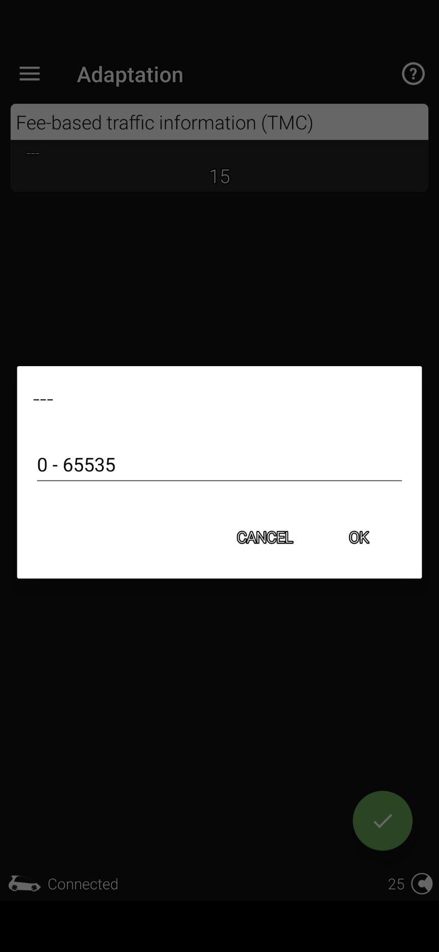

I had a look at this using my OBD11. Entered 5f found TMC. Clicked on it and it came up with 15 as per stated. However when I clicked on the 15, thinking it would allow me to change it to 14  I got a white panel with three small dashes in the top left and the number 0 - 65535, and the options to click 'Cancel or OK'. Decided not to try changing this number and cancelled. Came out of OBD and found the volume on the radio had disappeared, no sound. Tried turning it up but the sound bar didn't move. Turned it down and the soundbar went down to 0 . Turned it up and sound bar didn't move. So I gotout of the car and came on here to see what others think. TIA.

Further to my last post here is what I saScreenshot_20230622-124133.thumb.png.4a9f479f73af2da3082d77c45b14d01e.pngw
I’ve no experience with ODB11 but can’t you just type 14 into the box where it says 0-65535? The latter number of course being the maximum value a 16 bit binary number can take.
Alternatively you could try to reset the infotainment by the long 10 second press on the on/off button
Thought of putting 14 in box but I have very little experience of using OBD11 either. Didn't want to risk messing it up. Regarding the radio sound, I am leaving it off until tomorrow and see if it works then. There are a few posts on here of things malfunctioning but next time switched on is ok. If it isn't ok in the morning i'll try resetting it.
Ok, don't know much about binary, and understand even less. But checked on Google and binary for 14 is 1110. Do you think I should enter this or just the number 14. Am I liable to really screw things up? Don't normally worry to much about tfc announcments, I use WAZE, so not a great loss if I can't get them.
By the way, Radio ok this morning.
No you would enter 14. I just mentioned the binary thing to explain why the maximum number quoted was 65535.
