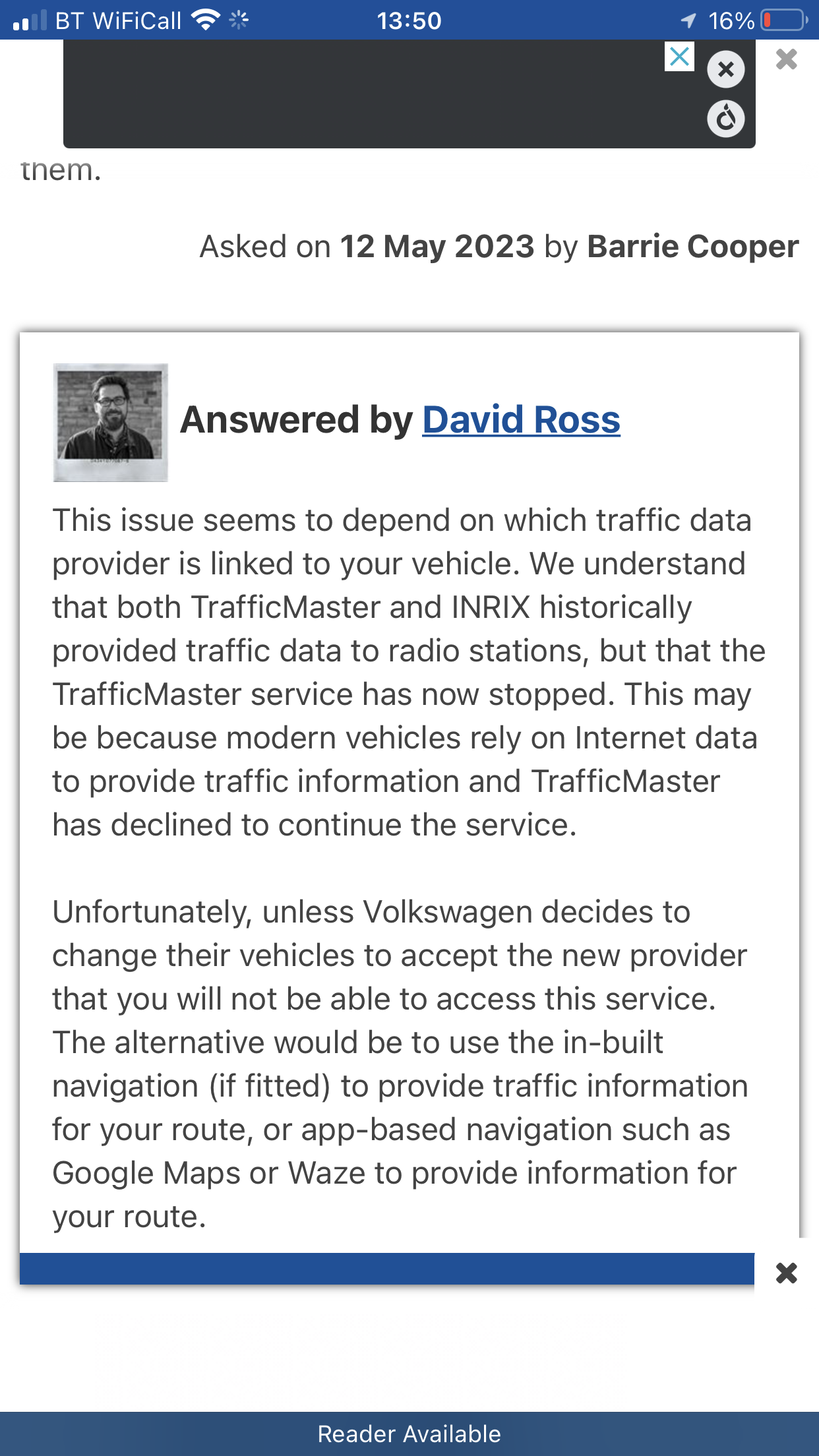

There are a couple of threads about this already :)
In short, Trafficmaster have stopped transmitting TMC over FM in the UK. It's unclear if the headunits can take TMC from an alternative source or how that can be achieved...

After having the same problem with "Traffic Announcements" and the red line across TMC in the Infotainment on my 2019 Superb 4x4 at the begining of April I checked on this sight for answers (as just about everyone else seems to have also.
I have now had it confirmed by my Skoda Dealer (Simpsons Skoda Colne Lancs) that the problem lies with the SERVICE PROVIDER having "gone down".
This is affecting all the VW house range and unfortunately, no info for a fix.

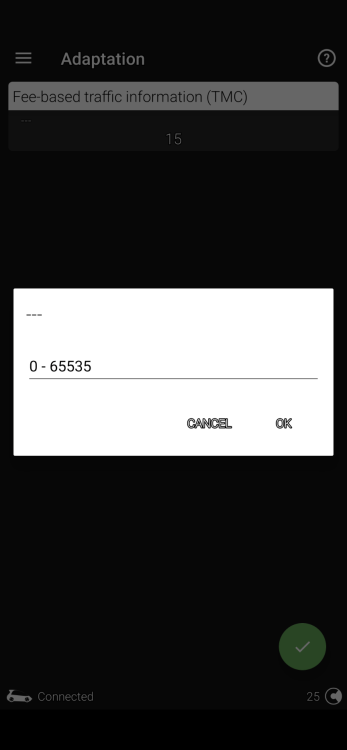

There's a post about this over in an Audi TT forum: https://www.ttforum.co.uk/threads/fixed-rds-tmc-no-longer-working-in-uk.2032197/#post-9622024
In summary, Trafficmaster supplied TMC, but they have stopped providing the service.  It affects VW group and many other car manufacturers.
However, if you have VCDS, there's a fix that work on the TTs. It enables the alternative VW Audi service instead.
I haven't yet tried it on my Superb, but it uses the same maps and software so I expect it will work:
As ever, pcbbc has found this.  Top man!
I spoke too soon. The Superb VCDS has a very different stored value, 15 rather than 32783 as the default.
I tried 32782, 14 and 16, resetting the MIB in between - none of them worked, so I've given up for now.
I did check that Android Auto will display Google Maps on the head unit if necessary.
