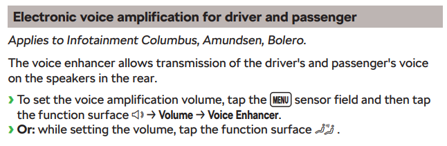

At a guess, it's the voice enhancer...?
From the owners manual:
Thanks for the reply, I'll have a fiddle in a bit and advise on the outcome. Not sure what infotainment system I have but assume fairly generic operation.
Thanks
Hi, and thanks to Langers2k, the information regarding voice amplification was spot on. Still don't know how I managed to turn it up though 'cos it wasn't doing that when I picked it up. Now I can sing and not upset people outside the car!!
