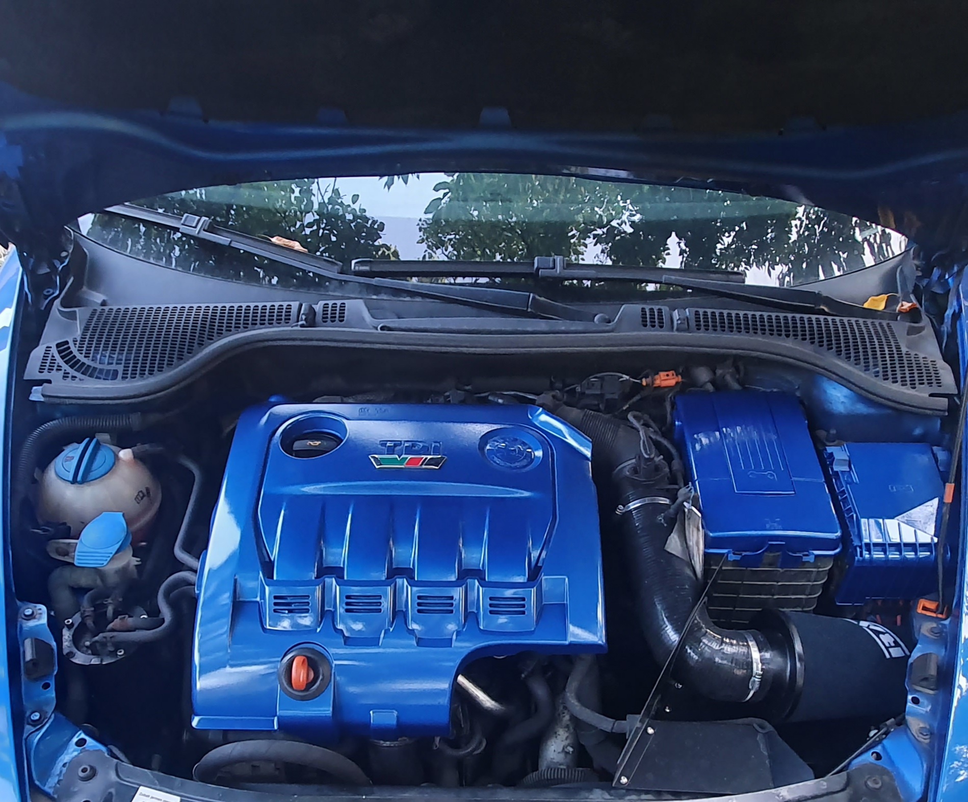

I have on MK2 VRS (2007). with Ramair JSK-120-BK intake air kit. No problems with MAF.
I have only one question. I have made few changes: (no DPF, no EGR, new sport FOX exhaust (middle and last part), inter cooler-S3, plastic with flaps to ALU intake manifold,tuning stage 1-2...) 170->...200HP
Is it better to leave original box with sport air filter or to leave it like now. Sound for me is super. But i have a feeling like a suction hole, when i press the padel.
