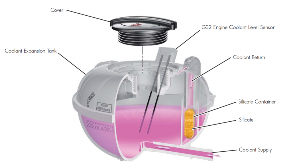

Can you see the bag when you open the header tank?
Look it up in the search function. There’s a pic somewhere on here giving the part number of the expansion bottle you need without the silica bag. I replaced mine not long after getting the car with a genuine VAG non silica bottle.
Its the same as this, inside the coolant return pipe. Can't get into it because of the bend in the pipe. This may be a later model and if it bursts in the pipe it may not get washed into the system.
