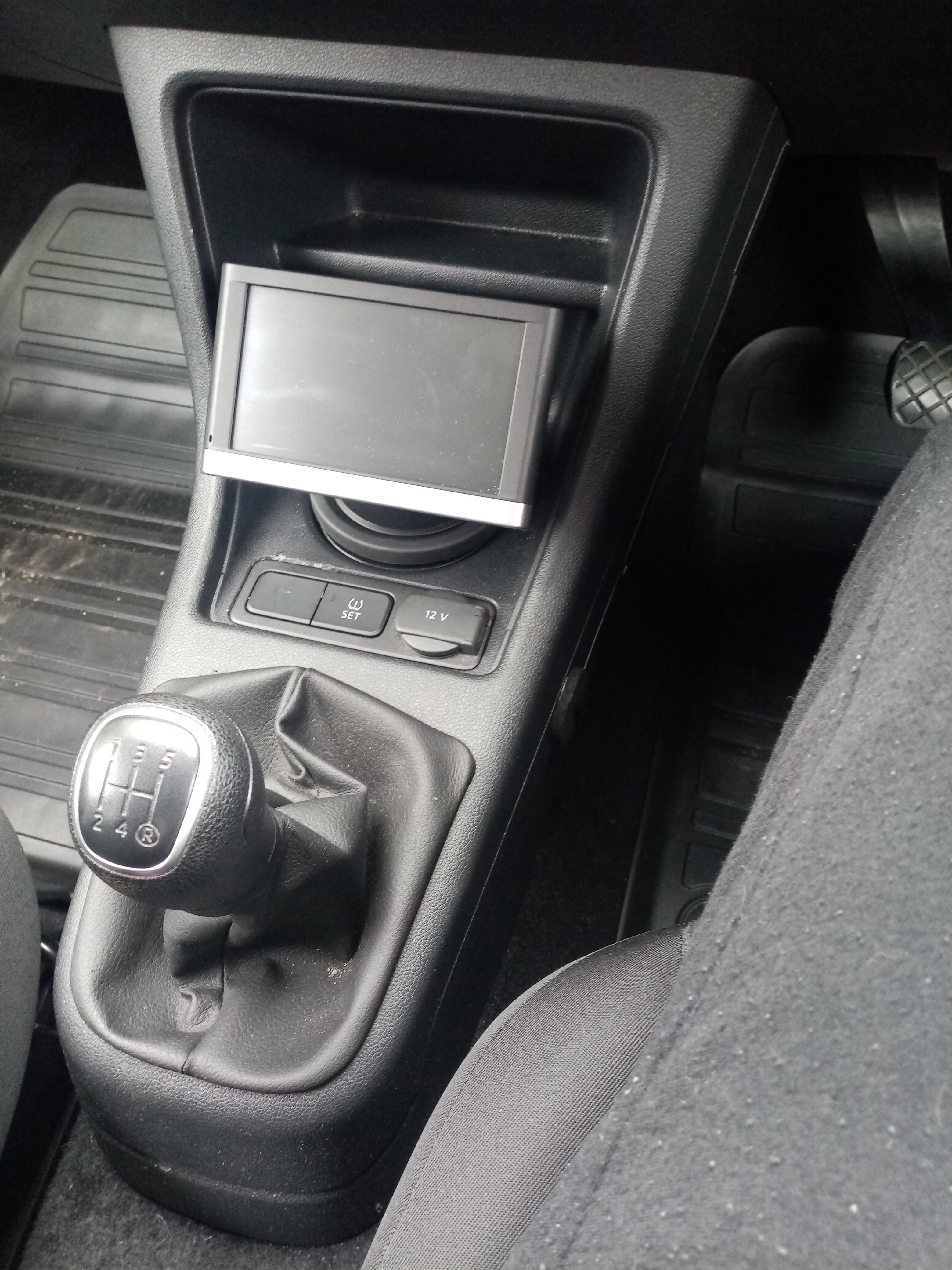

Easy Dash Cam Installation
1 Lever out power socket plate with flat thin knives.
2 Attach camera earth wire to threaded stud at bottom of the console.
3 Attach camera live wire to power socket supply wire (red/yellow) using a 2amp in line fuse and scotchlock connector.

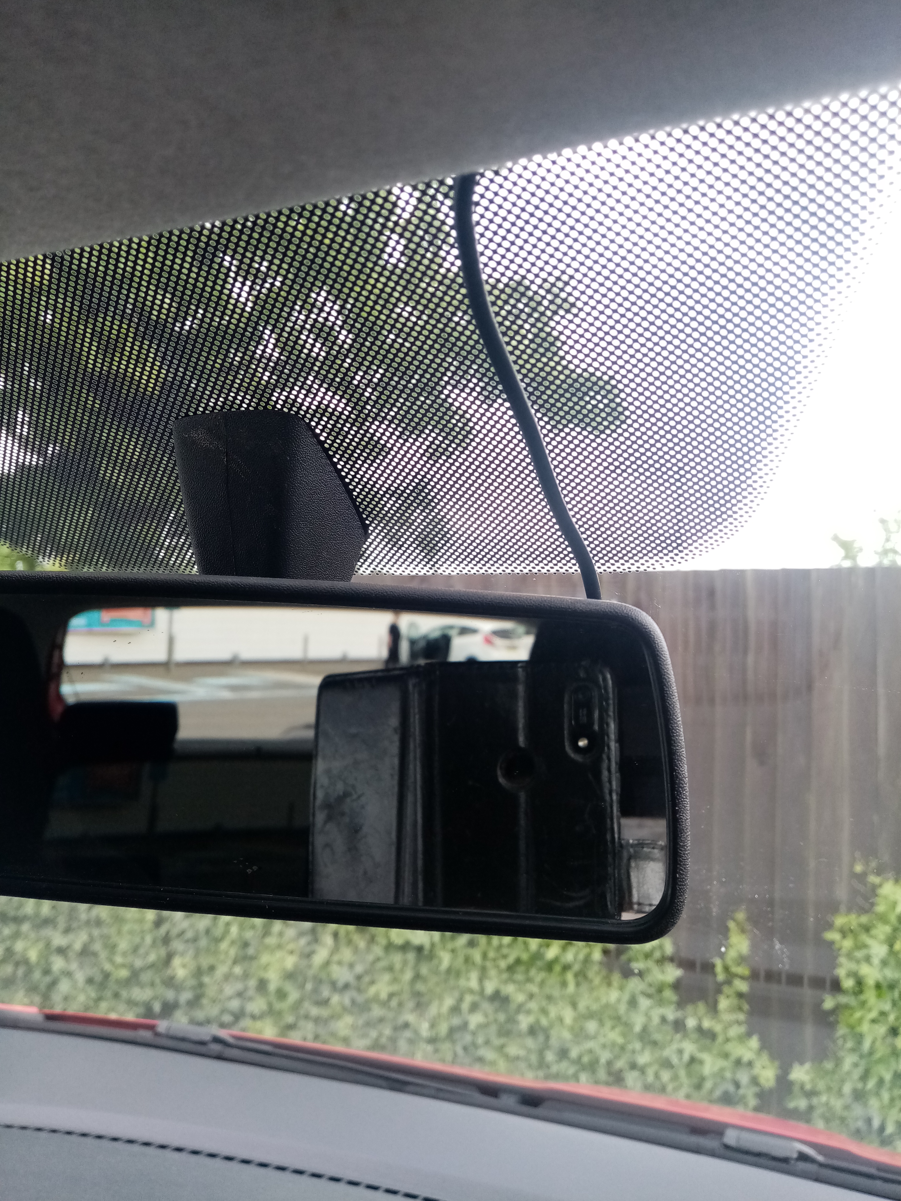

4 Route black camera feed wire through 14mm hole in console on driver's side and up to camera inside door and A pillar trims.
5 Fit rubber grommet to hole in console.
6 Turn on ignition to test system.
7 Refit power socket plate.
8 Drink Tea!
Total fitting time 1 hour.
Edited by Boomlander
Extra information
whats the name of this unit please? Stock?
