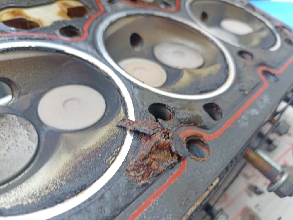

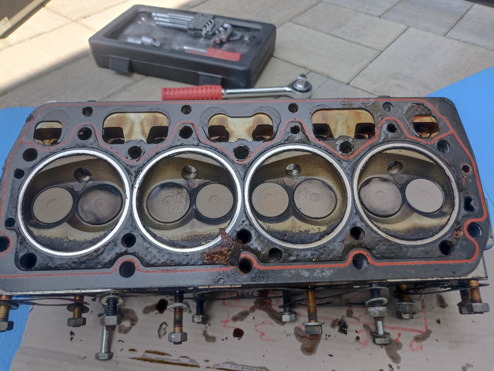

Update 1:
Took down the head. Here are some pics. I think it confirms my/our suspicion of head gasket eaten by coolant.
The bloated parts on the gasket are 3-4mm high. Also after I removed the gasket, there is a hard pinkish/brown residue on the head itself, looks like a 10yr old cooking fat behind a stove. I'm scraping it with a plastic scraper. Also there are spots which are eaten away/recessed into the head itself, with rough surface, they aren't (for the most part) near cooling or oil galleys or the combustion chamber, but I still seek advice from you whether to do something with them.

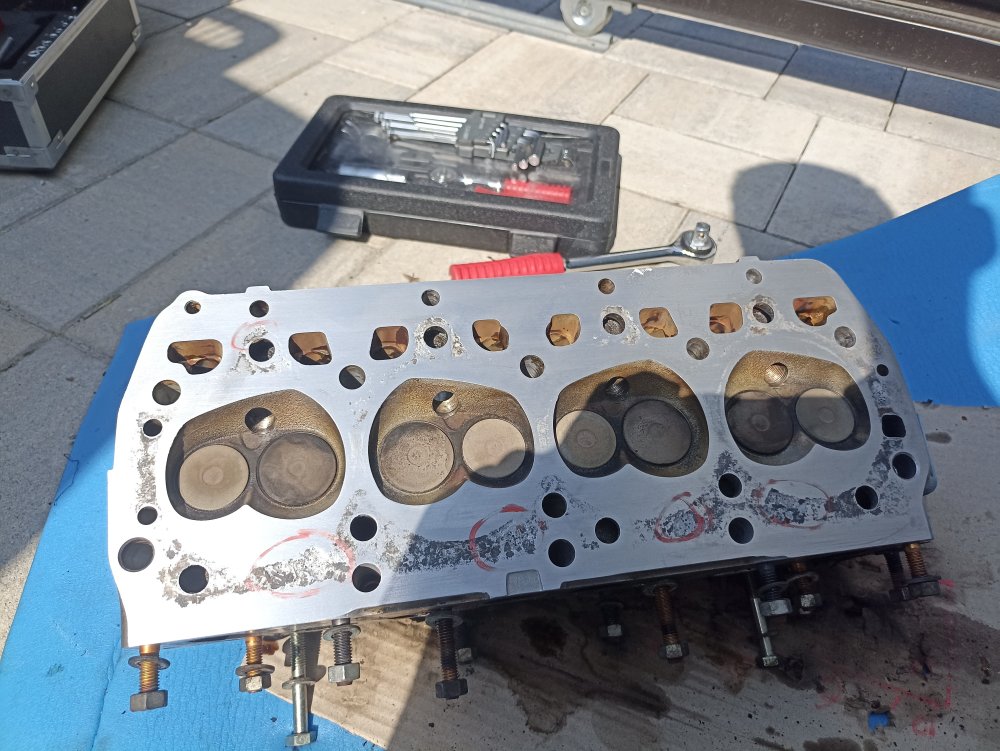

Okay so here is the head after some non-invasive :D cleaning, I did a fast check with straight edge and feeler gauges, it doesn't seem warped. Though there are corroded parts of the surface (circled red-major ones) and also all the spots which aren't shiny are corroded in a way. Now I will do a thorough flatness check. The question is:
•lets say the head is flat within spec, should I give it to a machine shop to get rid of the spots? Most of them are away from holes, though some little ones are near.
