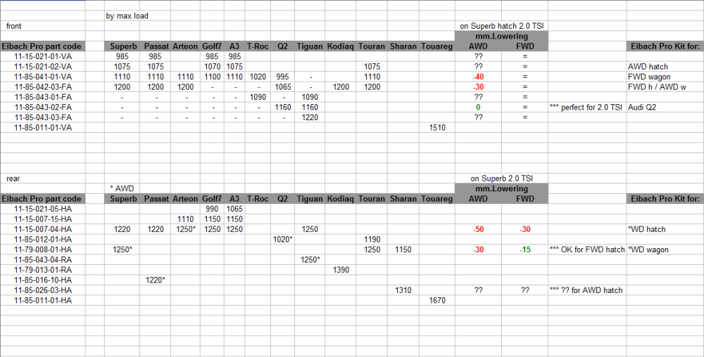

to add stiffness search for some from lowering kits,
but to avoid lowering chose some from some weightier car.
for FWD Superb as acceptable(-15mm) i found Eibach Pro springs from AWD Superb.
which will be good for AWD Superb i haven't found yet
who will try to share his experience?
by max load ->
00_Springs_table_Front-Rear_Eibach_by_Max_Load.thumb.jpg.843ea1434d5d6615c598400856a4fc9a.jpg

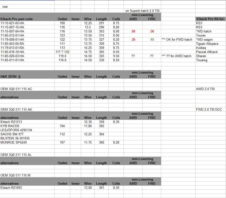

Since I have an offer to buy Arteon Eibach Pro Kit and looking at the catalogue and table above I am curious what you think.
Superb 2.0 TSI AWD and Arteon 2.0 TSI AWD have same front springs in Pro Kit, but rear ones are different:
Superb
11-79-008-01-HA
122 mm outer diameter
13.75 mm thickness
327 mm height
8.2 coils
Arteon
11-15-007-04-HA
116 mm
13.50 mm
303 mm
8.0 coils
Strange that Arteon is lowering just 25mm with these springs, but still original ones are also shorter than the ones on Superb.
Seems like rear end of Superb will be quite low with these springs.
Original ones are
12.80 mm
356 mm
8.5 coils
Compared to Arteon Pro Kit thinner yes, but 53mm longer and with more coils to keep it high.
Superb is higher on rear end which can be solved maybe, but I am afraid Arteon springs will somehow be way off anything predicted for this car or its stability.
Less coils, shorter springs, thinner spirngs than Superb Pro Kit, but maybe this less will drop it maybe 1cm more, or less.
Arteon Springs even if they are thinner, shorter and with less coils, they also have smaller diameter, I guess they also compress less...
Your thoughts?
1 hour ago, Bingodalton said:
Your thoughts?
scroll up to pictures i posted above -
Superb and Arteon use same springs,
for Superb has been offered different springs for FWD and AWD,
while for Arteon same springs for both *WD, what doesn't look ok
They just use same front springs.
For AWD versions rear ones are different.
Load is 1250kg (not 1220 as in your table), but they are shorter, thinner, less coils.
Something is made differently with mounting of shocks and springs, chassis is a little bit different for Arteon/Passat and Superb or some bushings.
They maybe have thicker ones in OEM version, so they add some of height.  (checked this one, upper and lower support are the same)
