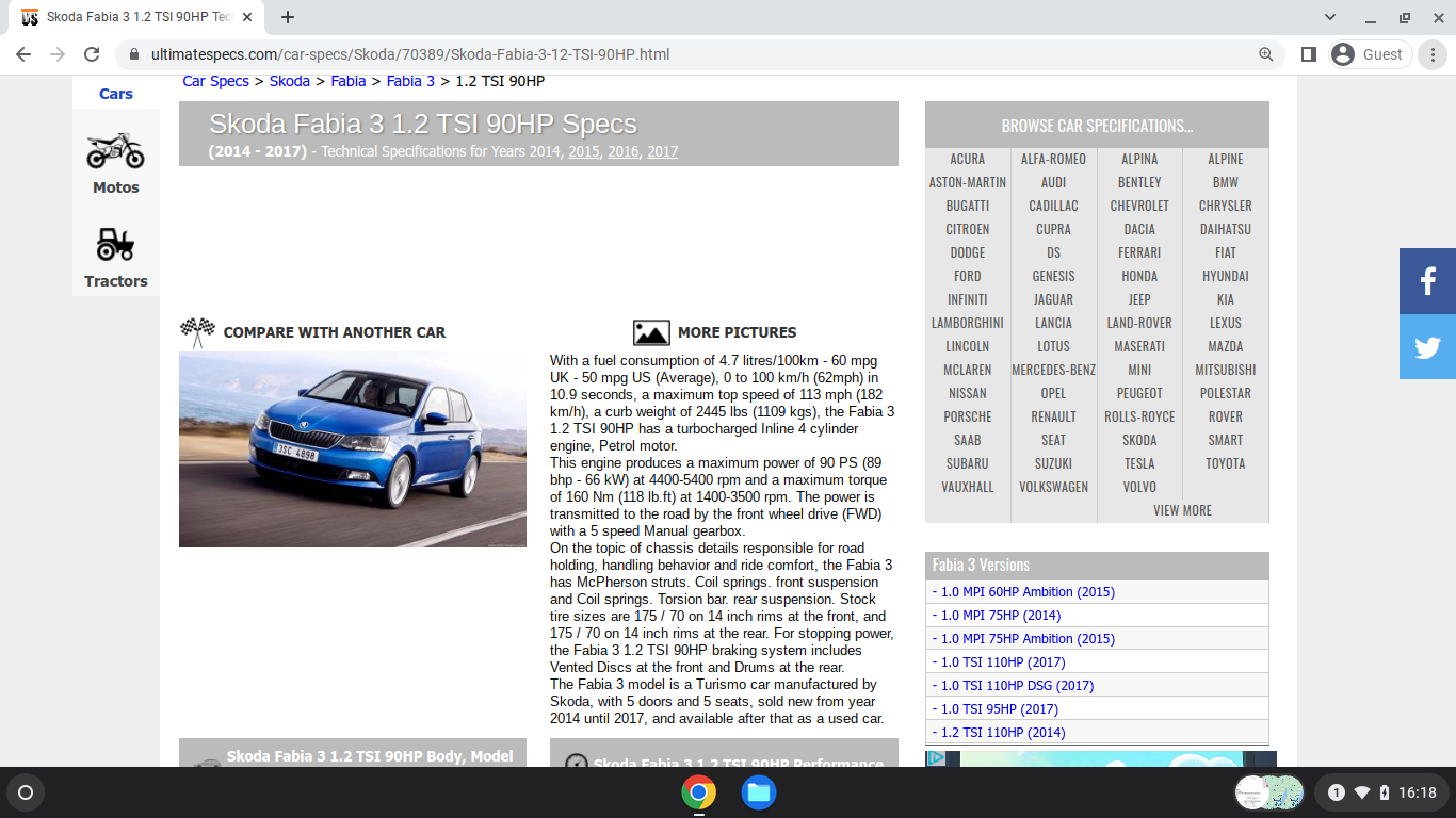

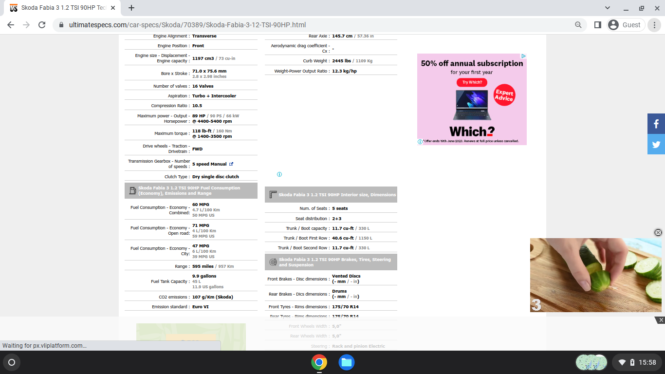

Bottom screenshot shows just what has been posted in the OP.
What country are you in, and servicing & km covered matter.
How many km has the car done.
Is this running 95 ron petrol in where ever you are?
