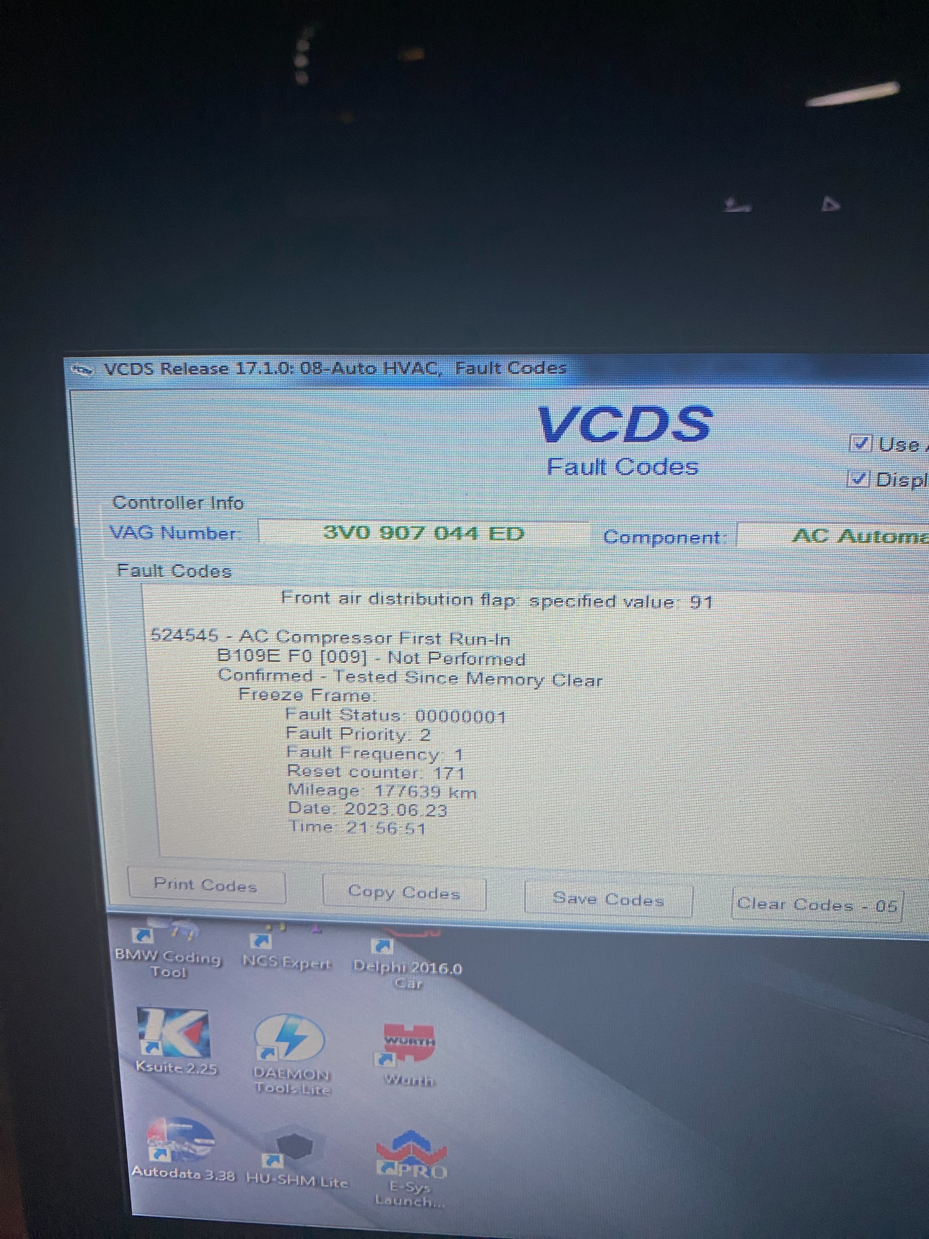

help me please to erase the attached error.
I've deleted all adaptations in HVAC>Basic settings because of an flap motor error, and now i can not make the Compressor first run-in adaptation. on older models i know that "Load management" in Centr. electrics>Coding>Long coding must be deactivated. But in this model there is no "Loading management" in Coding, perhaps in Adaptations but i can't find it, or skoda changed the name.

the ac button works by itself today.
now i want to solve the motor problem that i started:
https://postlmg.cc/y3jFVNZX
where is located this motor?
