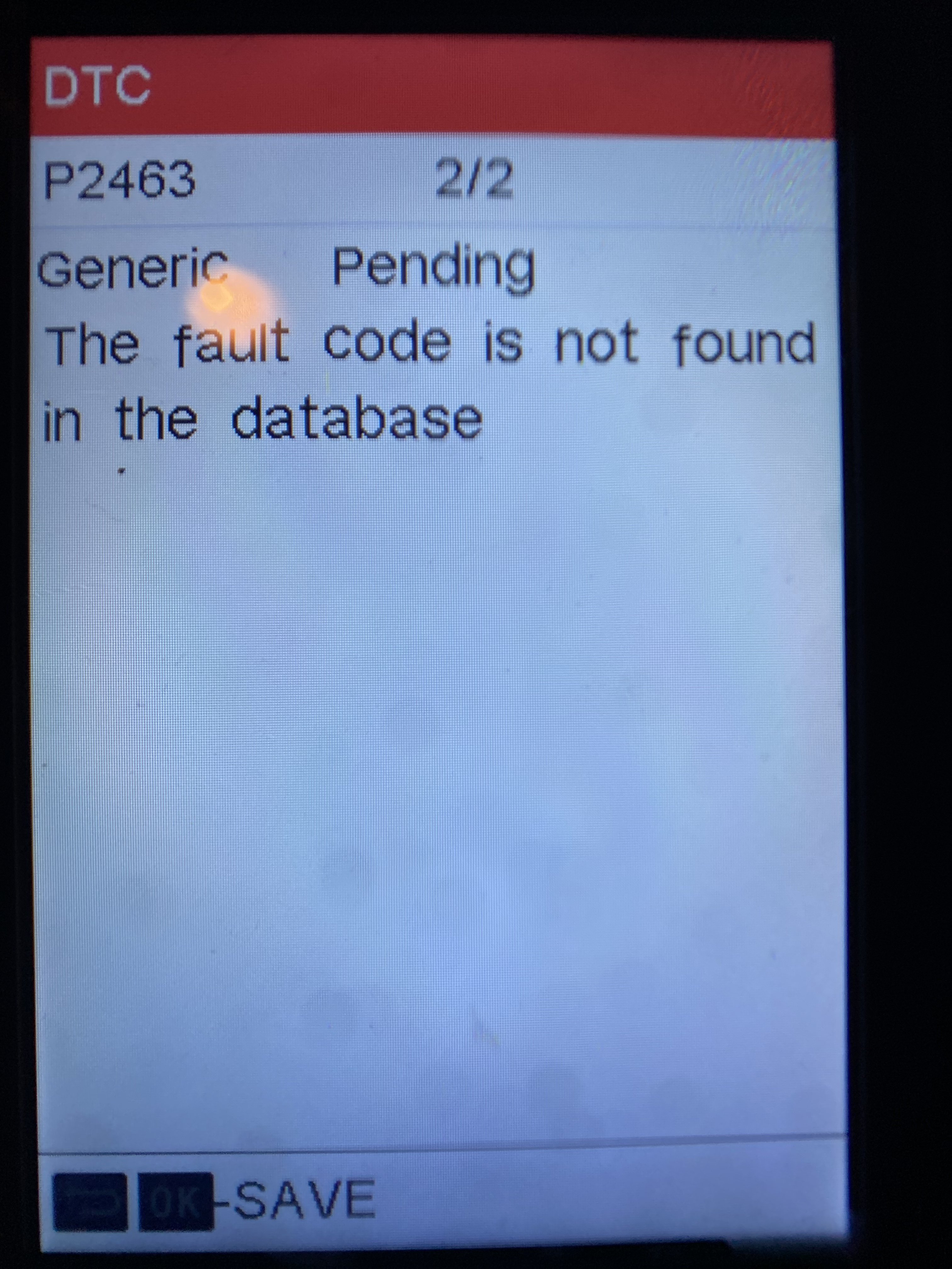

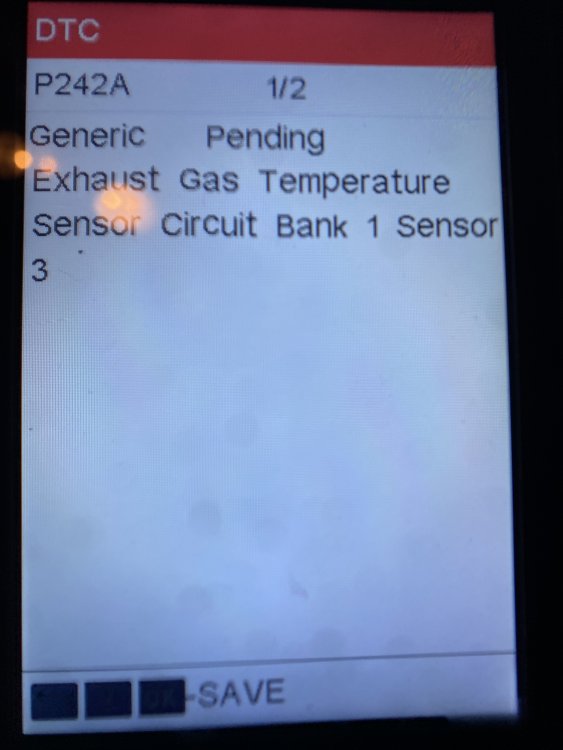

I am after some help please. Skoda Octavia - code P242A exhaust gas sensor 3 on bank 1 seems to be throwing up errors. I have done a DPF clean and regen and nothing works so I suspect the sensor has given up the ghost!
QQ; how do I locate which sensor it is? I can see at least 3 and I can see a fourth and potentially fifth under the car!
I have watch some many youtube videos and even downloaded the cars diagrams but no joy!!! Any help will be greatly appreciated as I need an MOT ASAP as I am off on holiday end of this week! It failed me at the last minute. 🙂

Using a generic scan tool is not gonna be much help here sorry
Fault codes contain a ton of data that can be read by more specialised tools and help diagnose the fault. Things such as short to ground, short to power and such.
As it’s a temperature sensor it can be tested with a multimeter to see if it’s open circuit and replaced if it is

Out of interest how do you know it’s faulty?
and to find it if you really are sure it’s that one, simply unplug a sensor and check what code appears, plug it back in and clear and do this till you find sensor 3. You only have bank 1 as it’s not a V engine so chances are it’s the furthest back sensor after the DPF.
I believe the temperatures sensors are; one in the turbo, one pre dpf, one post dpf. The other sensors you talk of are going to be oxygen sensors and NOx sensors

or it could be complete opposite problem and your scan tool is incorrectly reading a fault code (which happens a lot) and it may not even have a sensor 3 and you’ll need to read it with a more advanced tool.

The MOT centre did a full test on their machine and my diagnostic tool brought up the same code so they both can’t be wrong, no?
You use a generic scan tool, and I'm guessing the MOT centre did too?  A generic tool usually won't give the detail needed to point to a specific sensor, you really need a scan with a VAG specific tool such as OBD11 or VCDS to give the detail.
