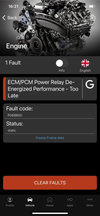

Hi all, I need Your help, opinion what could have happened to my car. I was today to do a mot at Skoda Northampton, the car passed positively. but after returning home I went shopping and the check engine light came on. I checked the engine is in place😅. Seriously, what could have caused this error?

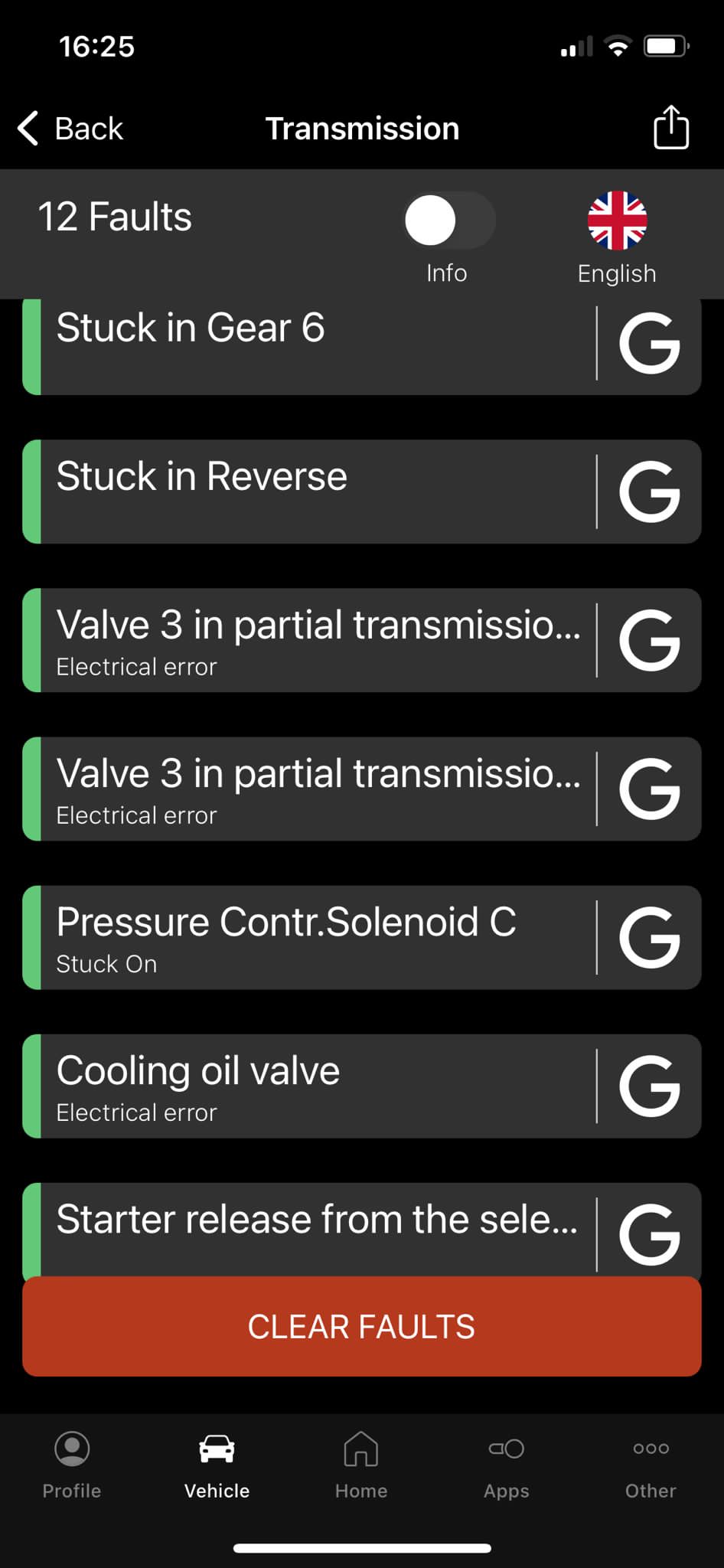

 I also have 12 errors in the dsg box, which is strange, and this box was replaced under warranty with a new one and has only driven 11k miles.
ECM/PCM Power Relay De-Energized Performance - Too
Late
G
Fault code:
P068B00
Status:
static
Freeze Frame data
Thank you all for your help and have a nice evening.
Have you cleared the faults and do they return? Could be signs of battery failure.
Hi, Thanks for Your reklamy.  So the next morning the check engine light was gone. I do not know why. The battery in the  car was replaced a year ago and is 96% health.
I was in an independent garage where the errors were erased.
