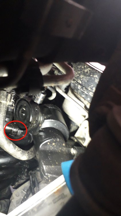

I have an oil on the back of a BXW engine. It looks like a small leak from the upper corrugated hose connection into the crank case breather unit.
I removed the hose and tried to clean it as a fix. The unit is a little tricky to get to, but when the airfilter box is off you can get to it easier from above. There is an o-ring which looks o.k. but I am not sure what else should leak up there
The stupid thing is that I replaced the crank case breather 2.5 years ago. Did I get a bad unit?
Do I have to replace it again?
Has anyone simply changed the o-ring with success?

I guess the original o-ring may have lost it's springiness, and failed to seal well onto the new breather module.
Do you want/need/have the part number of the hose? I would imagine a fresh o-ring of appropriate size will do the trick though?
I have not thought of changing the hose as a whole... but that might be another option.

I thought so, the whole hose is £23.42 + VAT from a dealership; current part number 036 103 493 EC
Pricey for what it is, certainly when compared to the price of an o-ring.
