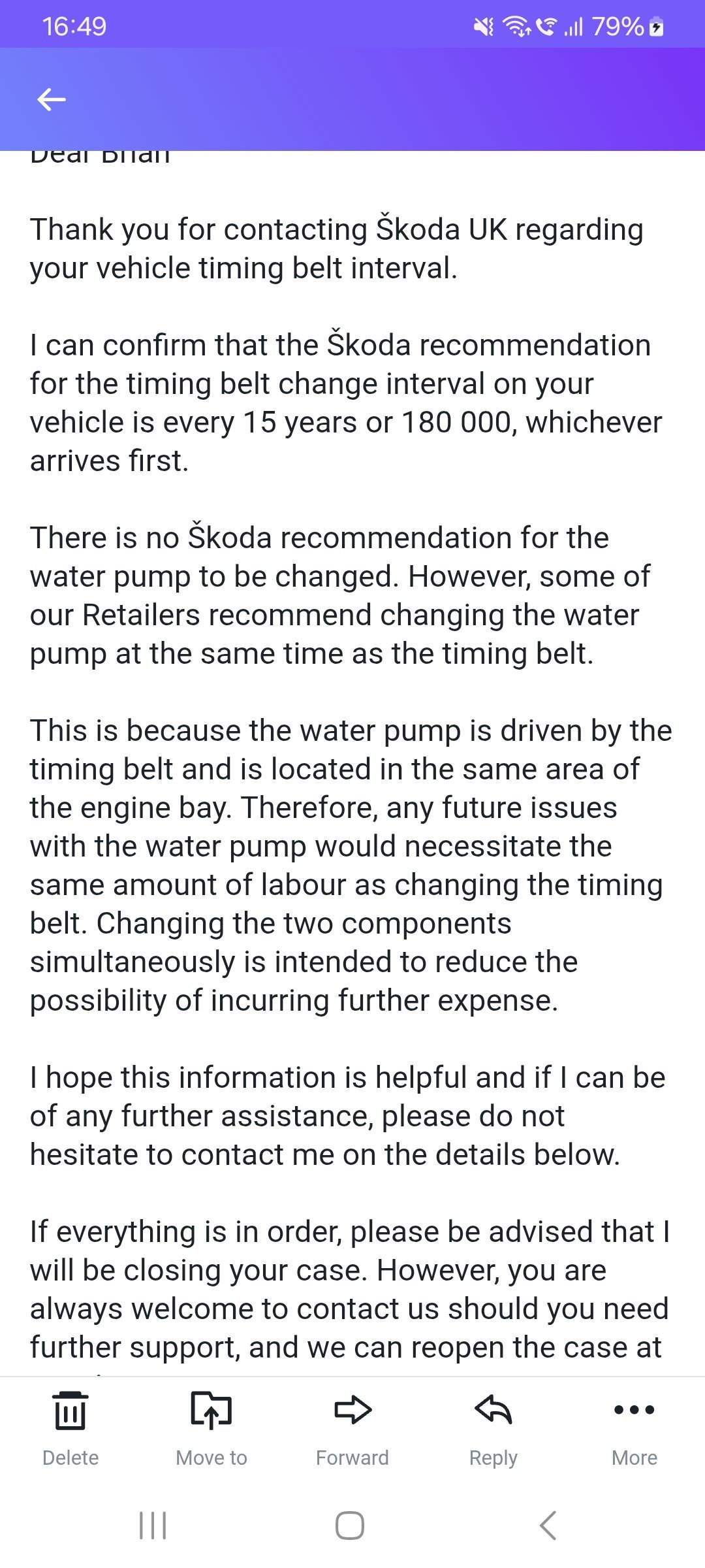

The comment about the water pump being in the same area is only true for some of the engines fitted to the Octavia 3 - it is NOT true for the EA211 1.0, 1.2, 1.4 and 1.5 petrol engines where the water pump is on the other end of the engine!

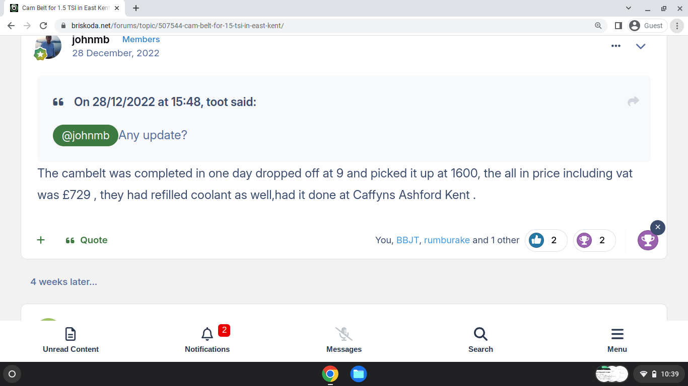

On 27/05/2025 at 10:36, Ootohere said:
Over 2 years ago.

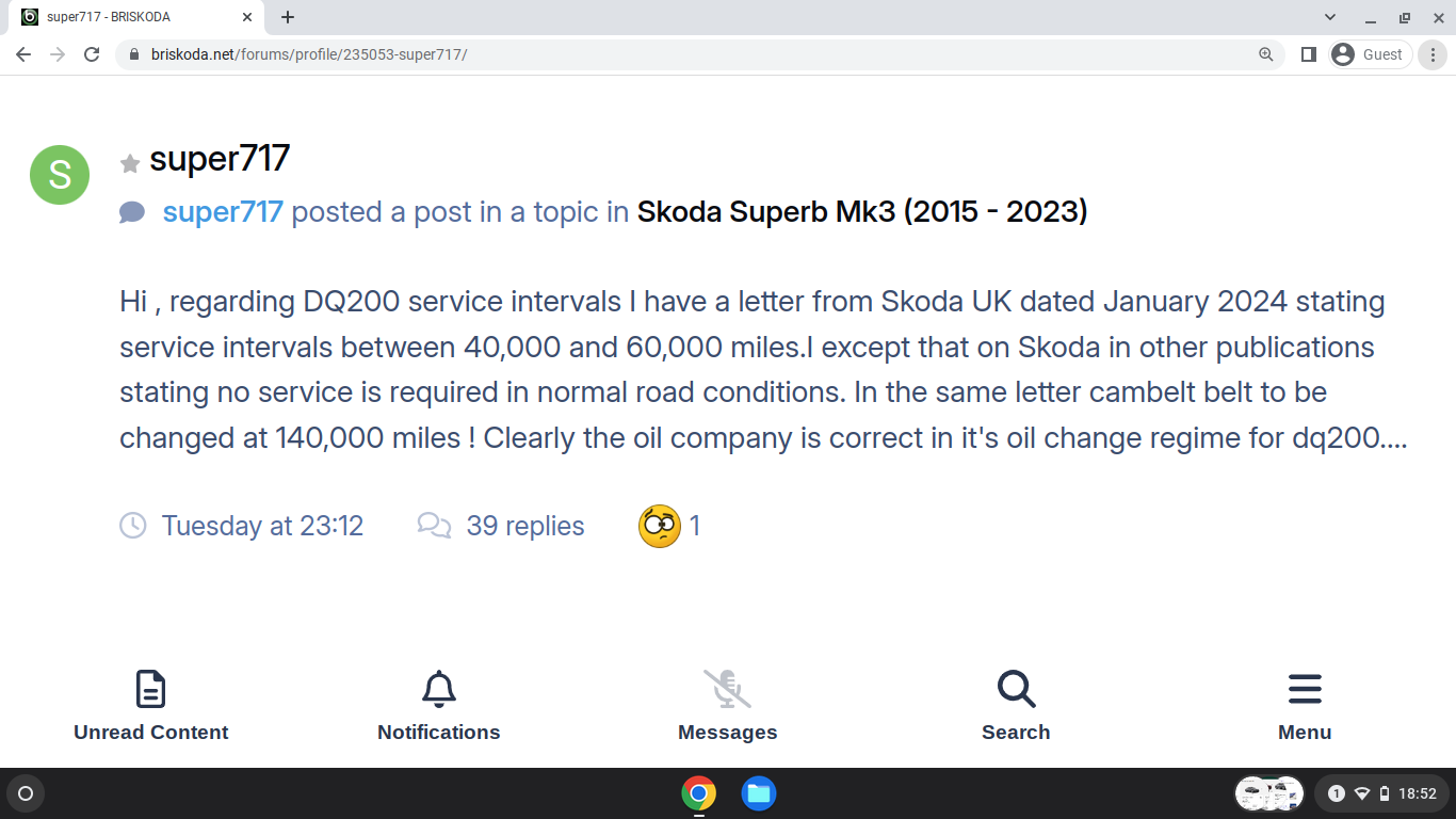

Hi , I gave a general enquiry to my Skoda dealer regarding changing the camshaft belt on my Skoda Tsi 1.5 Evo DADA coded engine.
The reply was not necessary but my but my car is 6 years old and only covered 37000 miles.
If I was in your position I would have the work carried out.
@super717 You posted in the thread about DQ200,s that you got a letter saying @ 140,000. So not necessary because of your mileage.
But that 140,000 miles in the letter is not the Skoda / VW Group advice, so was that Customer Services contractors answer?
EDIT, sorry i see it was the Skoda Dealer you asked.
Letter from Skoda UK though.
Edited by Ootohere
