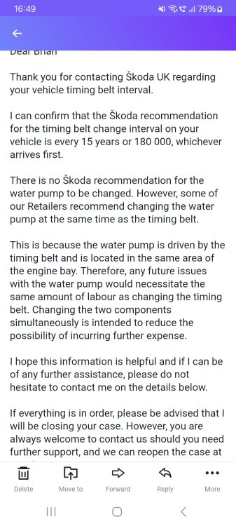

Cambelt
Not sure where the 10 years has come from.
Whilst in typical Skoda UK fashion there is plenty of confusion out there, the 5 year blanket interval has increased to 15 years, no mileage limit.
Wish I’d had those screen grabs a few months ago, they’d have supported my case against Skoda UK via the Motor Ombudsman when my Skoda retailer changed my cambelt at 5 years old in July 2023, only a few weeks after that bulletin was released telling them to cancel bookings!
