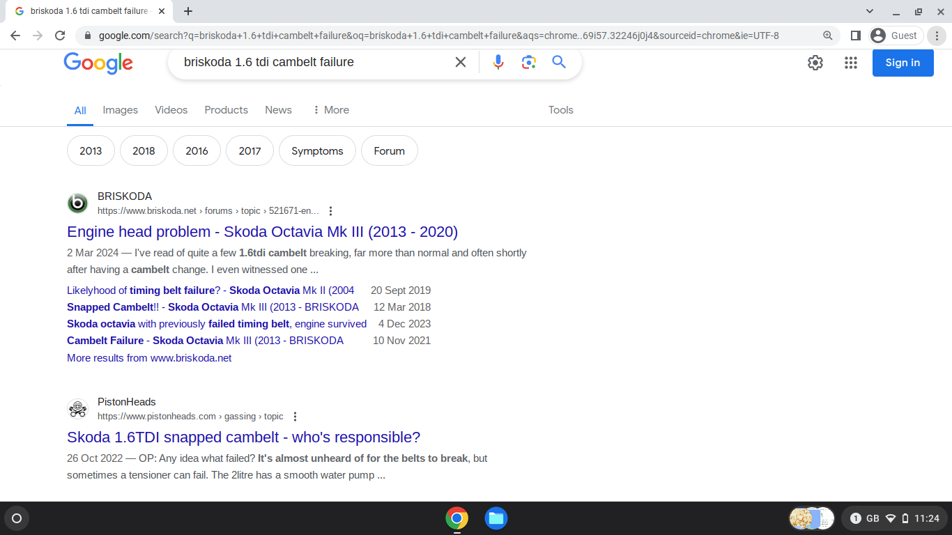

The major difference was / is the 1.6 TDI CR and that belt snapping / chain tensioner failing.
As far as we are with Euro 6 on 1.5 TSI ACT,s there is no common failures.    Some are from people without a clue doing a cam belt change at what seems like a cheap price.
Same with 1.0 TSI,s to a lesser extent.

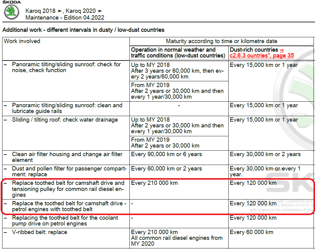

Where does 100,000 km / 62,000 miles come into it from?

i am asking myself too because i found few different options on manuals and dealers..
so now is 15 yrs. logically, on TDI is 210000 km or 10 yrs, a long ago, why should VW will make less quality systems for gasoline engines that needs to replace twice often...

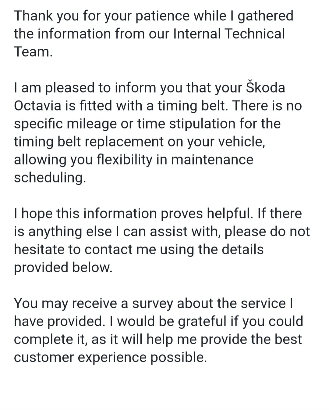

Any updates on this matter ?
I emailed skoda asking for their recommended age/mileage for timing belt change, they've left a message on my voicemail stating there is no stipulation on age or mileage for a timing belt change on my vehicle.
Doesn't really help and not entirely sure how to interpret that
It should be interpreted that they are looking at a table similar to the one that Ootohere posted a little further up this page, and they are looking at replacement interval for toothed belt on a petrol engine in a non-dusty country and seeing a - (like there is in that table for Karoq), which means there is no recommendation for replacement.

It means there is no replacement interval defined by Skoda.
Unless you live in a dust rich environment.
Not too sure why that makes s difference, since the belt is fully enclosed.

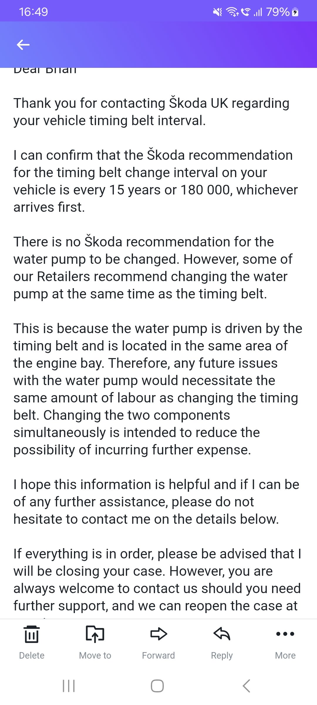

2 hours ago, Brian15 said:
I just find it odd they can't give an answer , surely they've been tested by Skoda and have a rough idea of when they're likely to need replacing,
There isn't a "one size fits all" answer as it depends on driving style, environment, etc. Which is why VAG as a whole advise a time/mileage after which it should be regularly inspected.
Just to add to the confusion I've had the following email today ,I got back in touch with them yesterday as I'd had no reply after a week waiting , so it would appear the same question has been answered twice by different people
