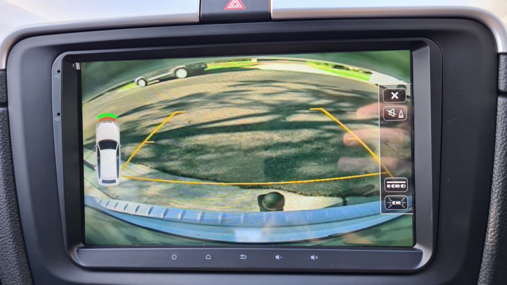

- The reversing camera, I got the A0580 converter and it just works.  The old camera looks low-def on the large screen of this unit when it looked fine on the (comparatively) tiny screen of the RNS-510.  I might install the supplied Analogue High Def camera as that should have a better picture and in theory will be able to show maneuvering lines.

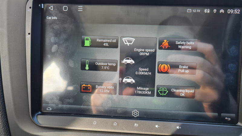

- Ultrasonic sensors work fine and have the car-info on screen, both front and rear

- Fuel remaining is mistranslated as "Remained Oil".  This is technically correct I guess as Diesel is fuel-oil
