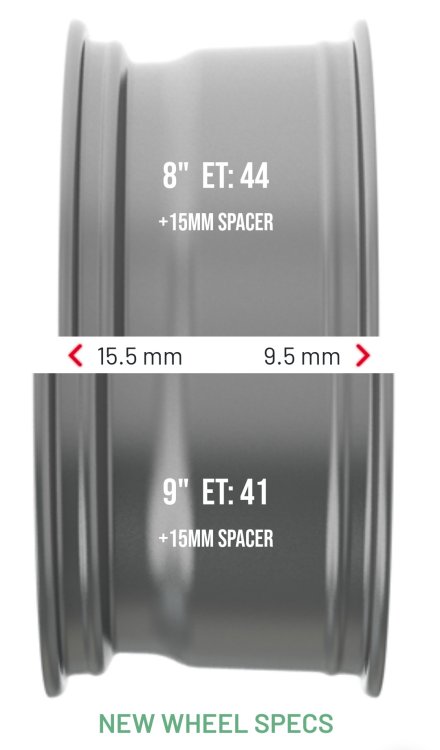

Right, I'm thinking of doing the above things are in play but has anyone done it yet or am I going to encounter problems, pcd, center bore and even offset is almost the same (current 44) bentlys 41
So current setup
235x40x19 8j width with spacers 12mm front and rear15mm with longer bolts to match
Proposed setup
245x40x19 9xwidth
Is it going to be tight etc? 🤔

My 245/40/19 tyres would scrape, on full compression at the rear when I had 15mm spacers.
Specifically on the inside where the rear bumper fixes to the rear qtr panel.
I now have 10mm spacers at the rear.
This is on the factory 19x8 ET44 rims.
Not sure how u'll go with 9" wide rims and 245 wide tyres.
Edited by JR RS
As JR RS had rubbing with 245/40R19 fitted to 8Jx19 ET29 (15mm spacers effectively change an ET44 offset to ET29) but not 245/40R19 fitted to 8Jx19 ET34 (10mm spacers effectively change an ET44 offset to ET34), you should be ok with 245/40R19 fitted to 9Jx19 ET41.
Notice in the below "Actual width of inflated tyres" chart, that the outside width of the 245/40R19 (measured at the widest point) is about 12mm wider (ie. 6mm each side) when fitting it to a 9J rim compared to fitting it to an 8J rim.
On the outside, the 245/40R19 fitted to a 9Jx19 ET41 rim will be in about the same place as a 245/40R19 fitted to an 8Jx19 ET35 rim.
On the inside, the 245/40R19 fitted to a 9Jx19 ET41 rim will be in about the same place as a 245/40R19 fitted to an 8Jx19 ET47 rim. So unless there's less than 6.5mm of clearance with the standard 235/40R19 fitted to a 8Jx19 ET44 rim, the 245/40R19 fitted to a 9Jx19 ET41 won't rub on the inside.
However, Bentley normally fits a much wider 275/40R19 to this 9Jx19 ET41 rim. The sidewalls of a 245/40R19 fitted to this rim will be quite stretched, which not only makes the ride noticeably harder compared to fitting the same size tyre to an 8J rim, but the sidewalls won't bulge out much if at all, resulting in the alloy rim being very vulnerable to kerb damage.
You might find that the Bentley rim is a lot heavier than the normal Superb MK3 rims, because the Bentley is likely to be a much heavier car and therefore need stronger rims. However, standard 19" rims on the Superb MK3 are no lightweight. Perhaps around 14.6kg each for the 8Jx19 ET44 rims, depending on exact model.
