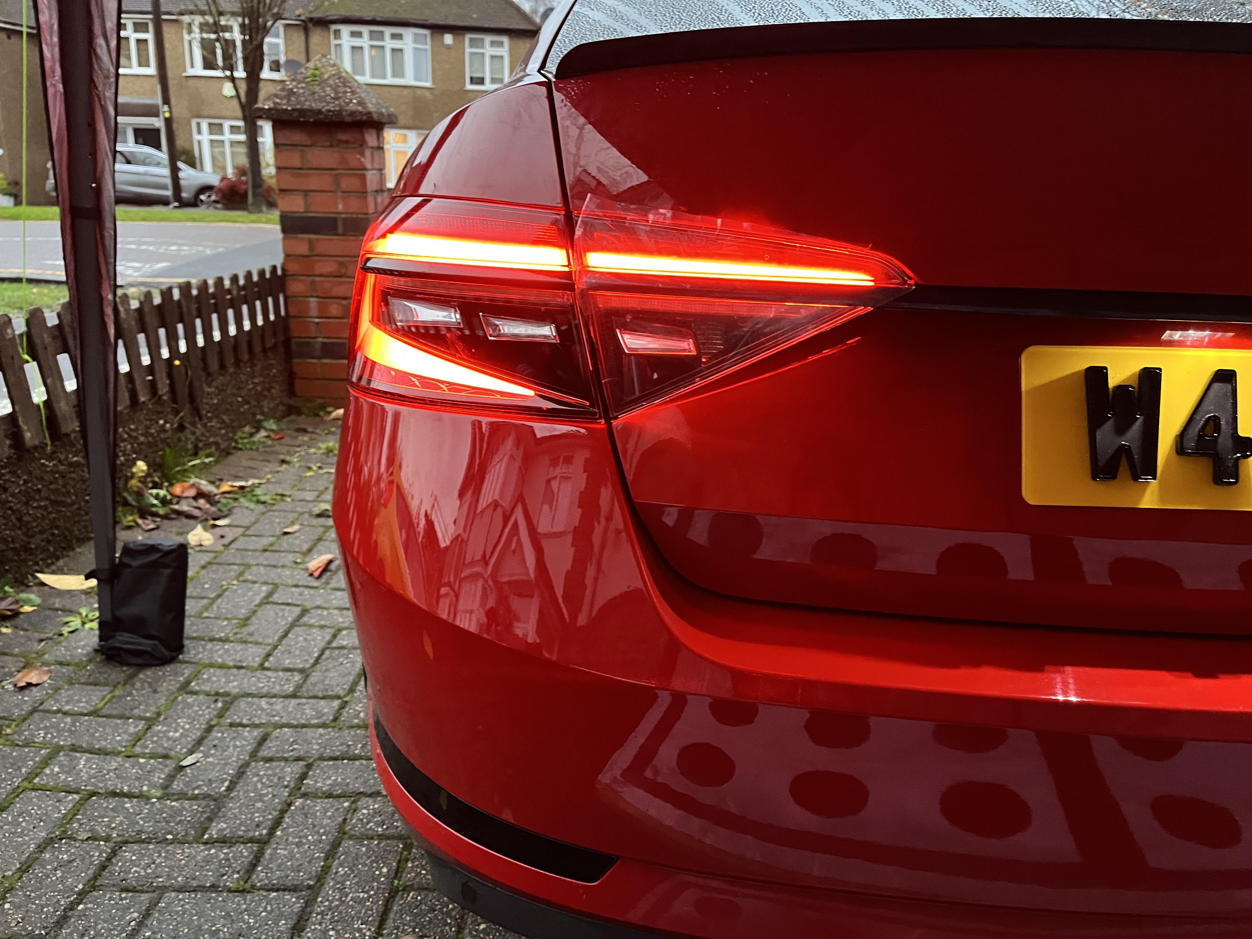

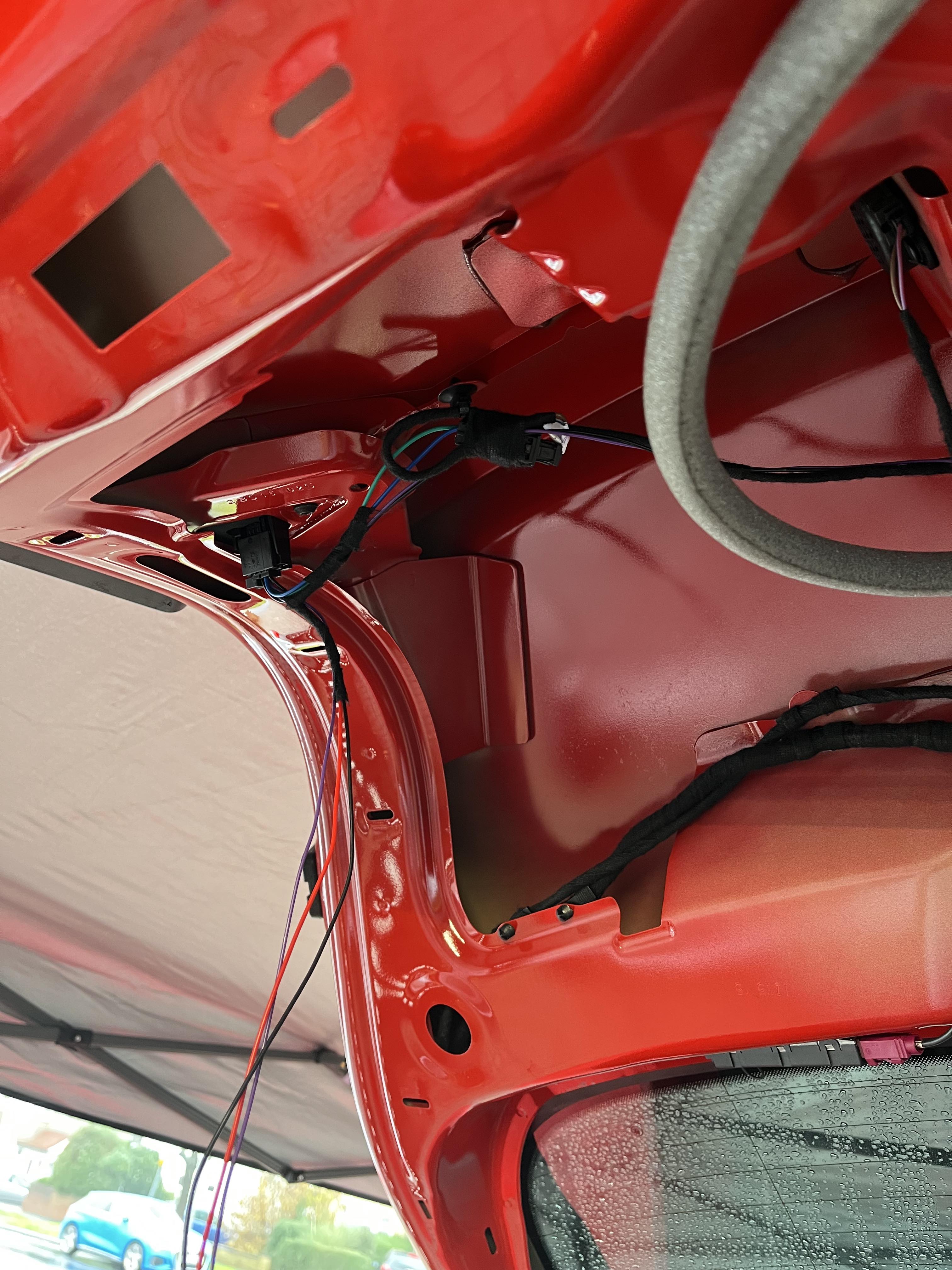

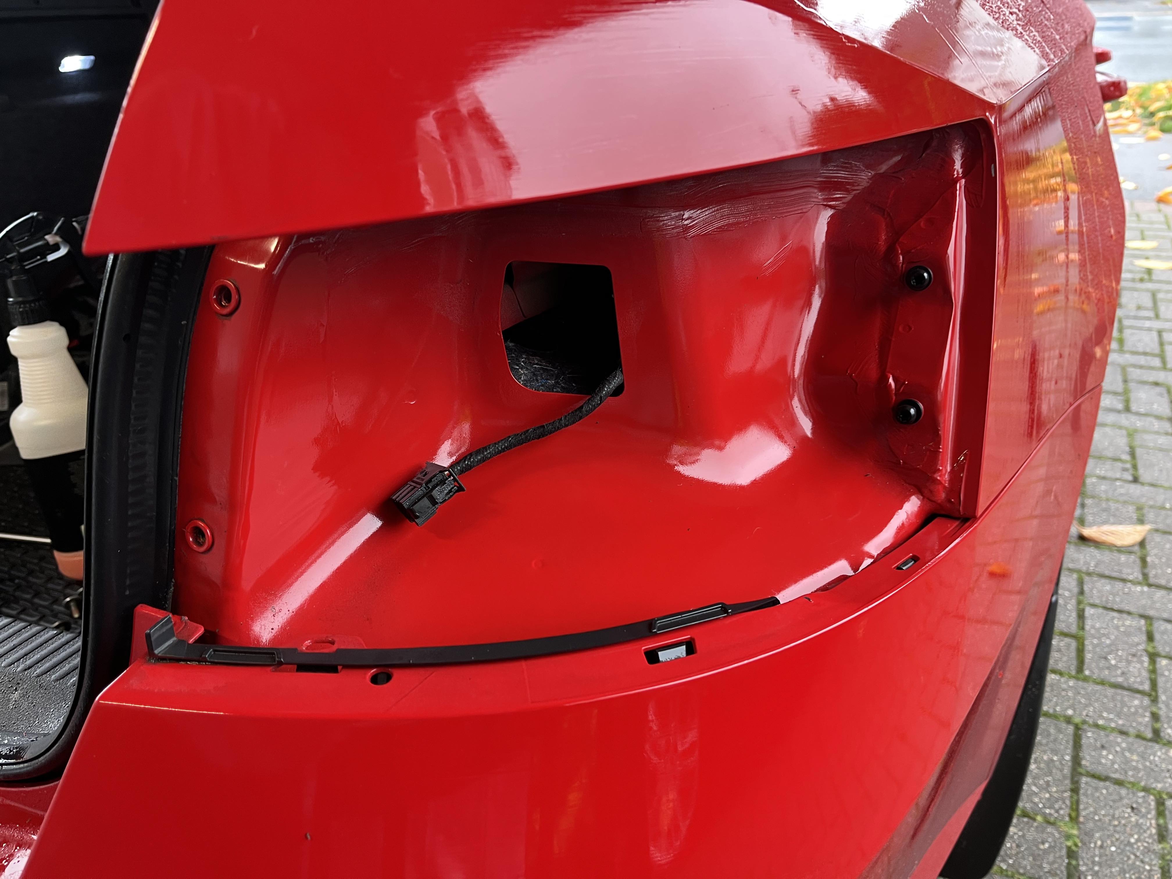

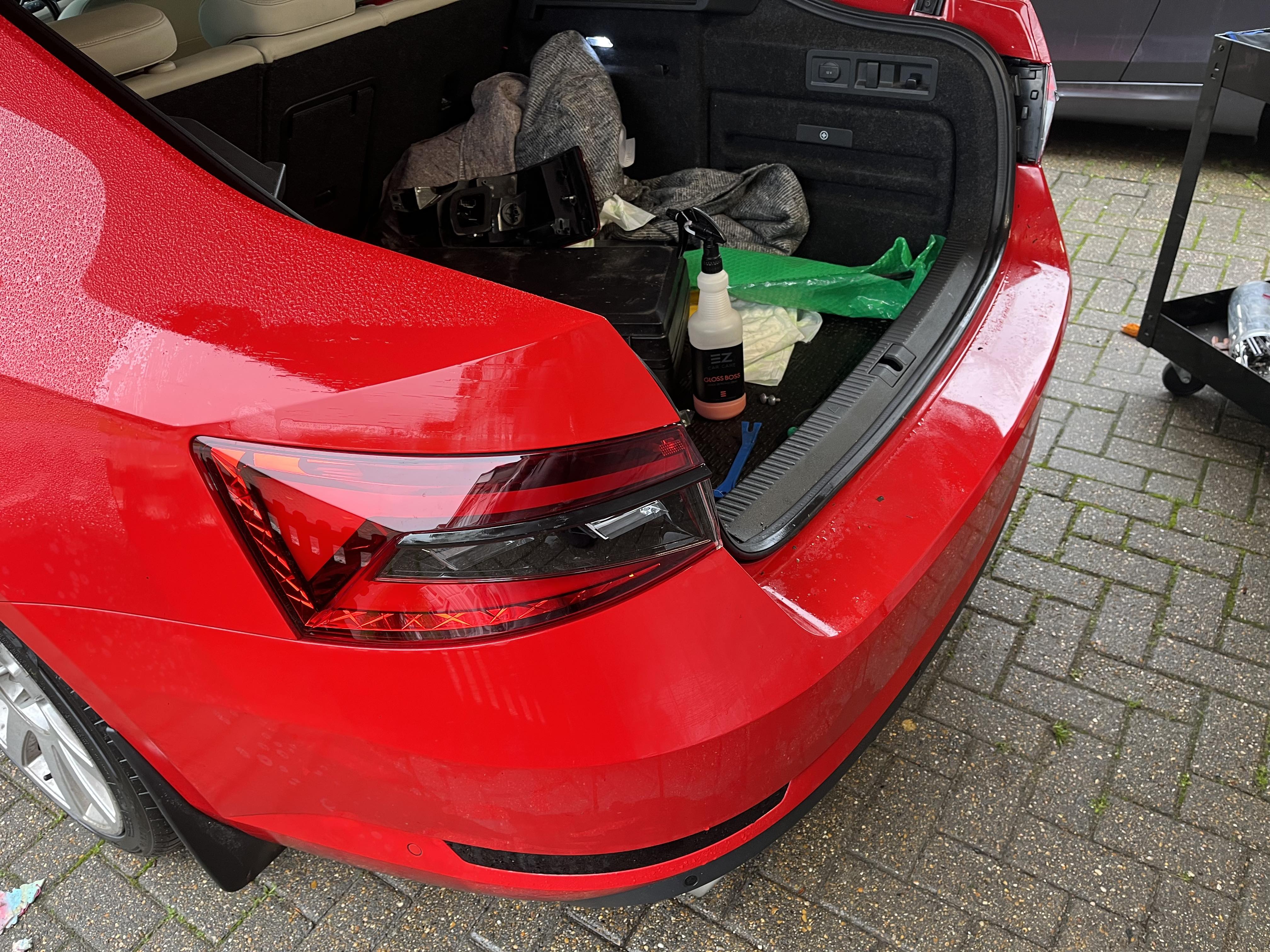

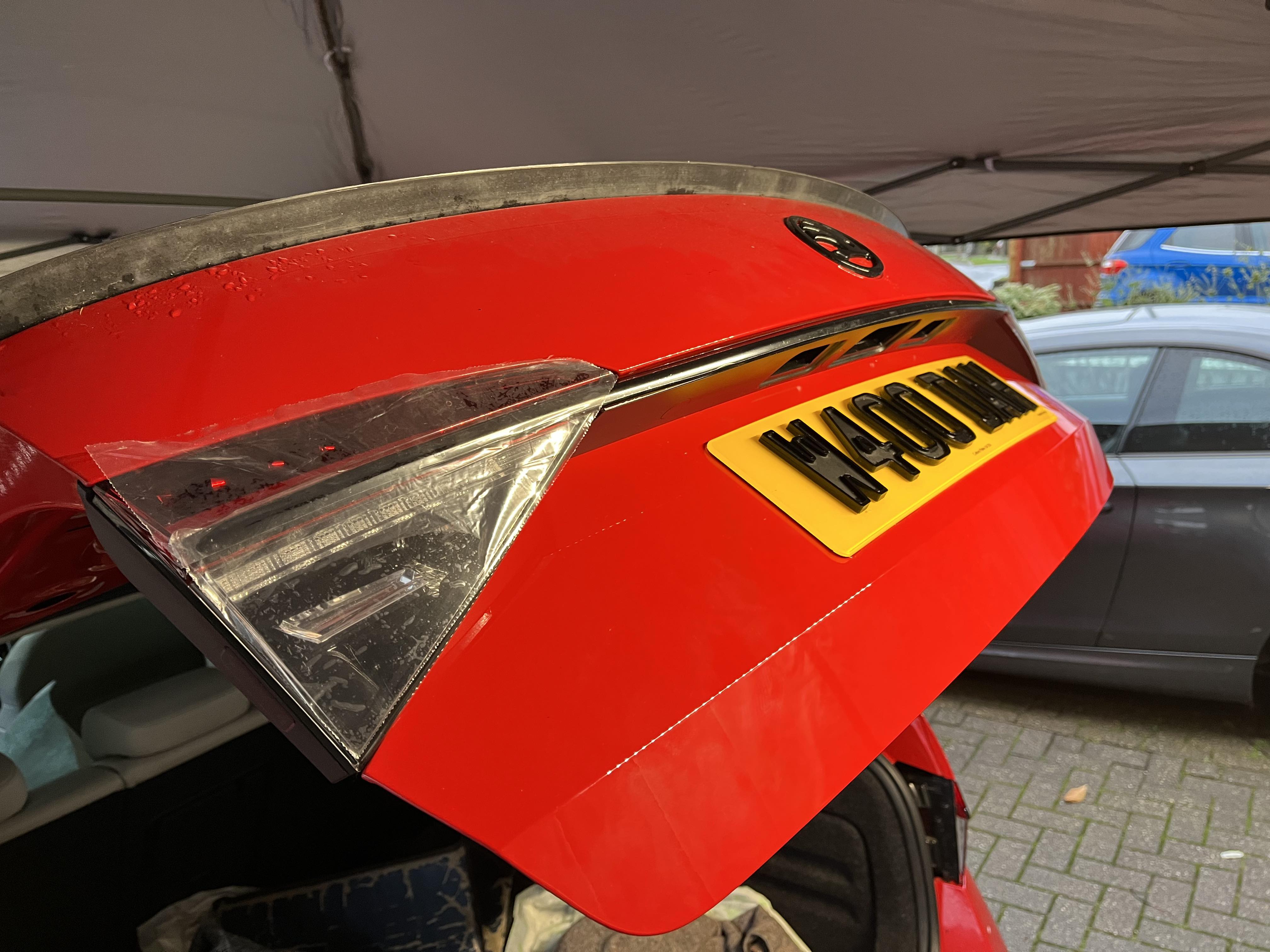

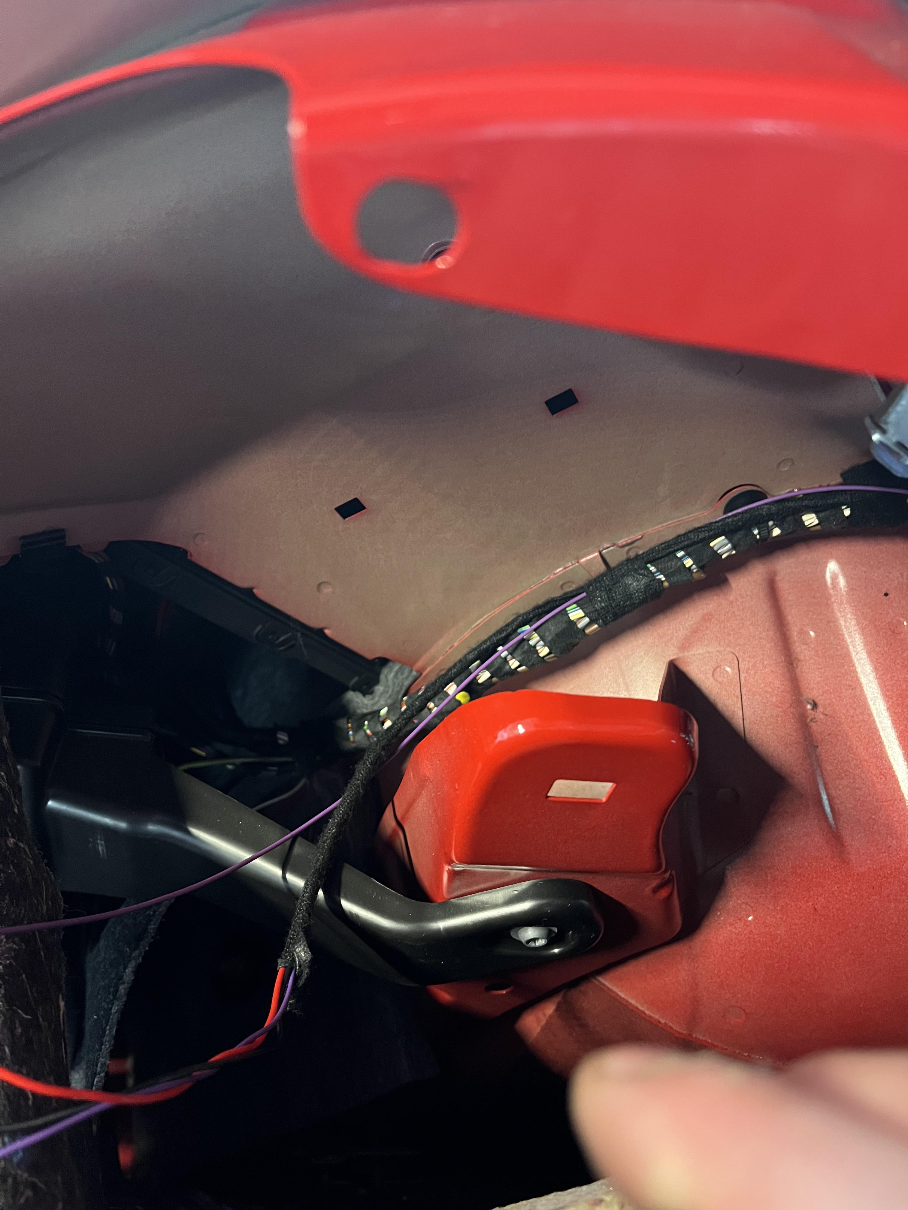

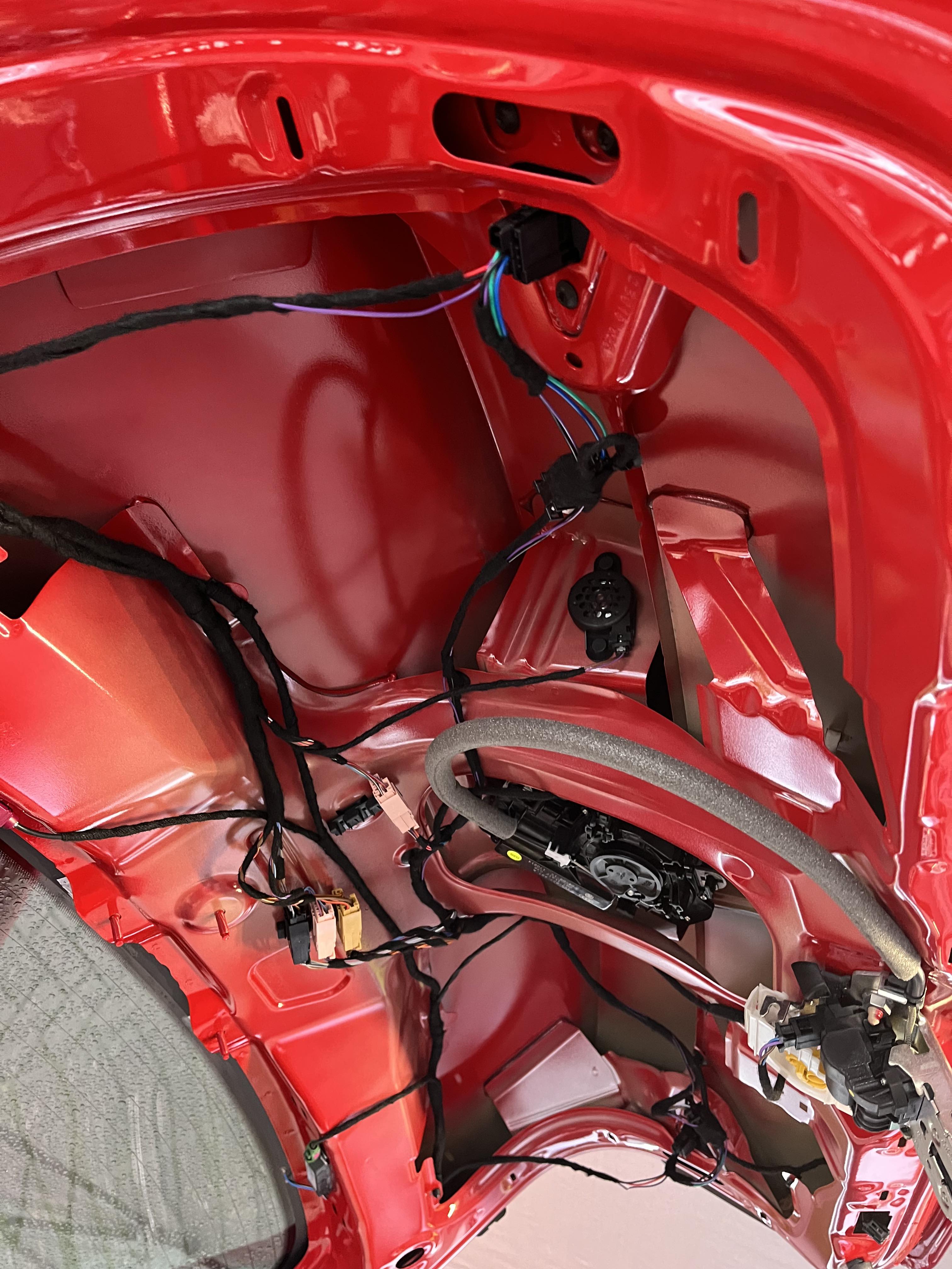

  3. OK.... Bargin for 200 for the outer two lights 110 each for inner two Center trim in black 174 Various bolts and screws and trim covers.. including some trim from Czech 🇨🇿 approx 100 Obviously doesn't include the time, effort and loom making from Elliott
  4. You can ask....sure.. 🤣
  5. Modifications time with@ApertureSwhen fitment off the facelift taillights happened Que loads of photos taken by Elliott received_6843981992383132.mp4 20231118_193020.mp4

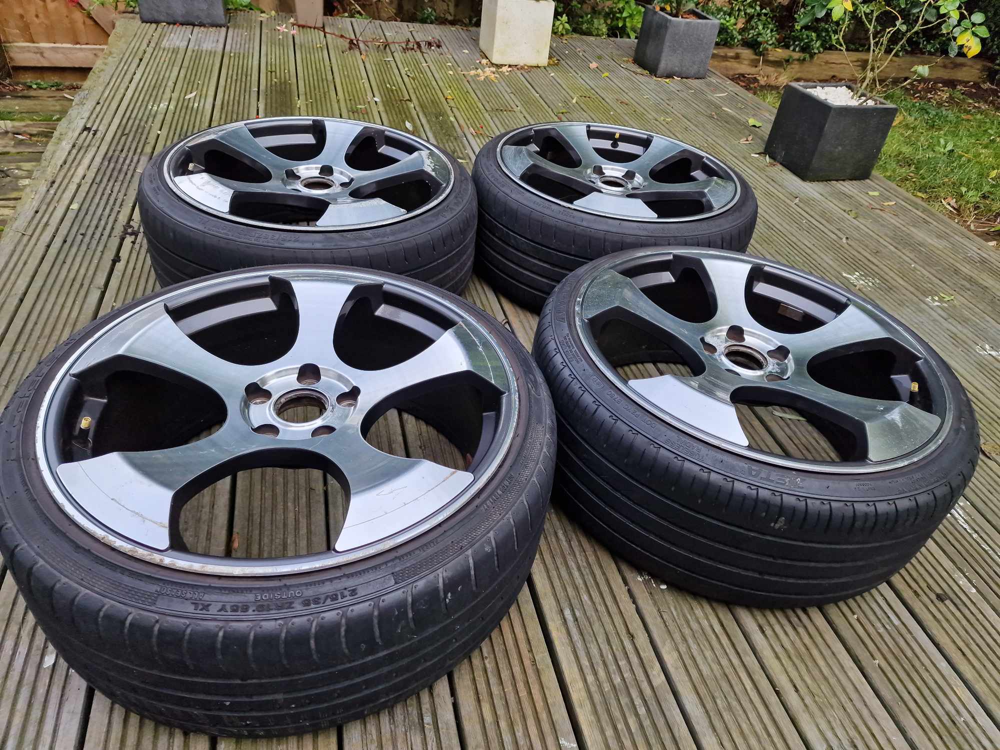

  6. Procured some uber rare rad48 dr1s Currently being refurbished.... Really looking forward to these when done!

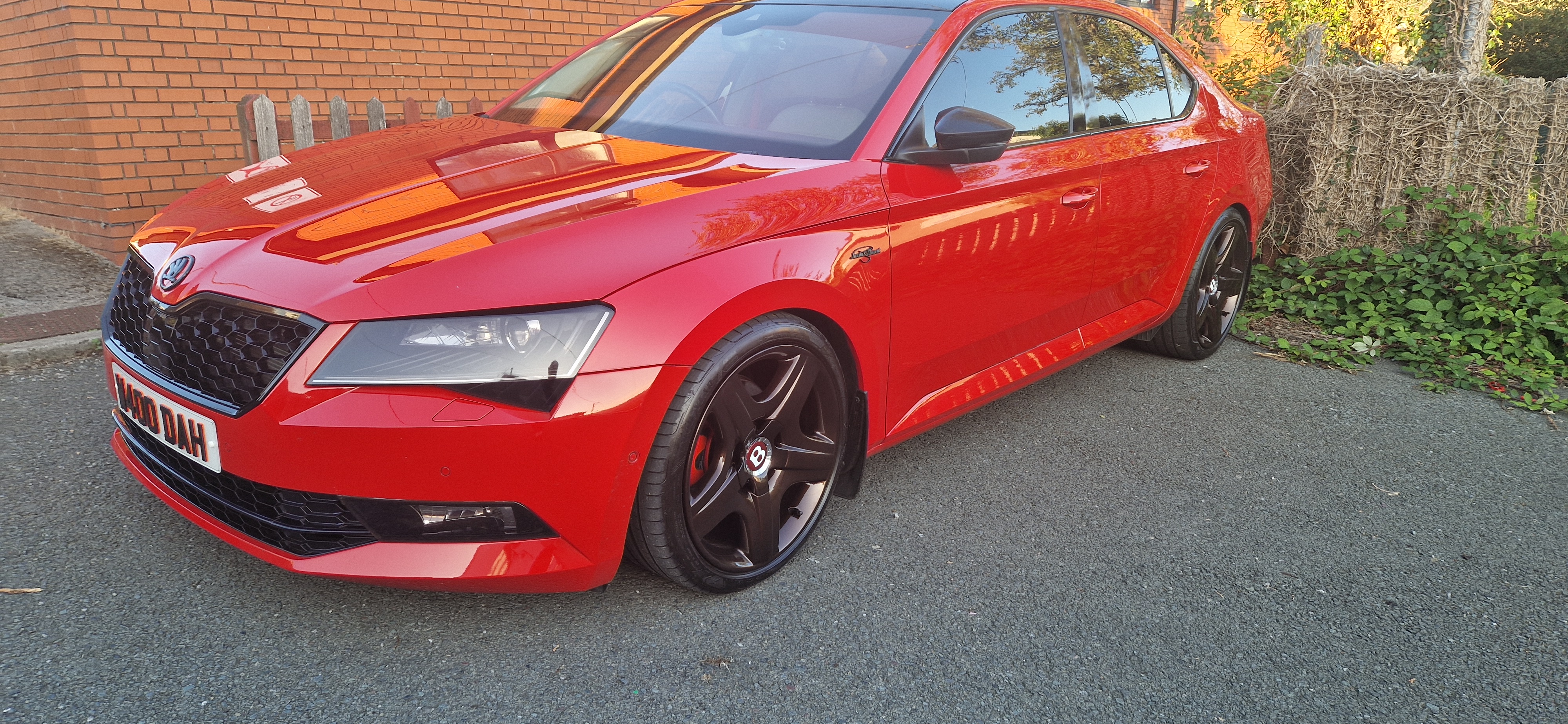

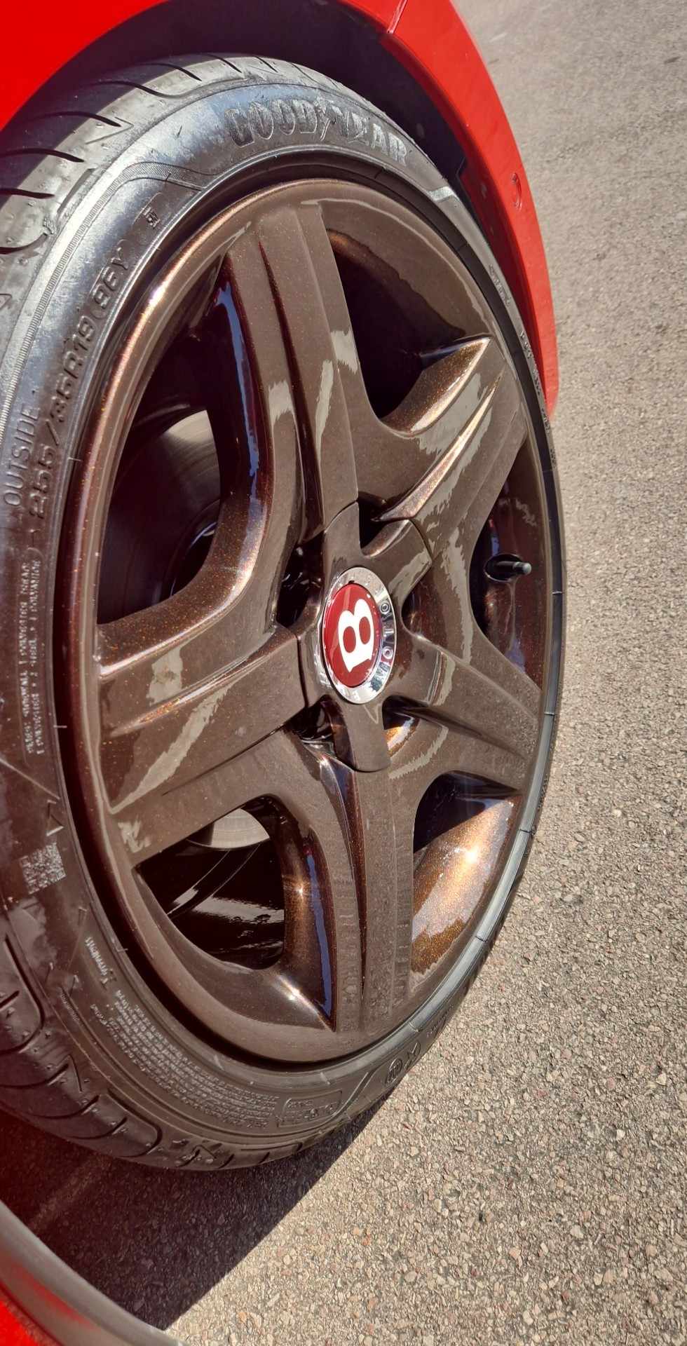

  7. Bentley alloys went on...running 255/35/19, 5mm spacers on front and nothing on the rear..

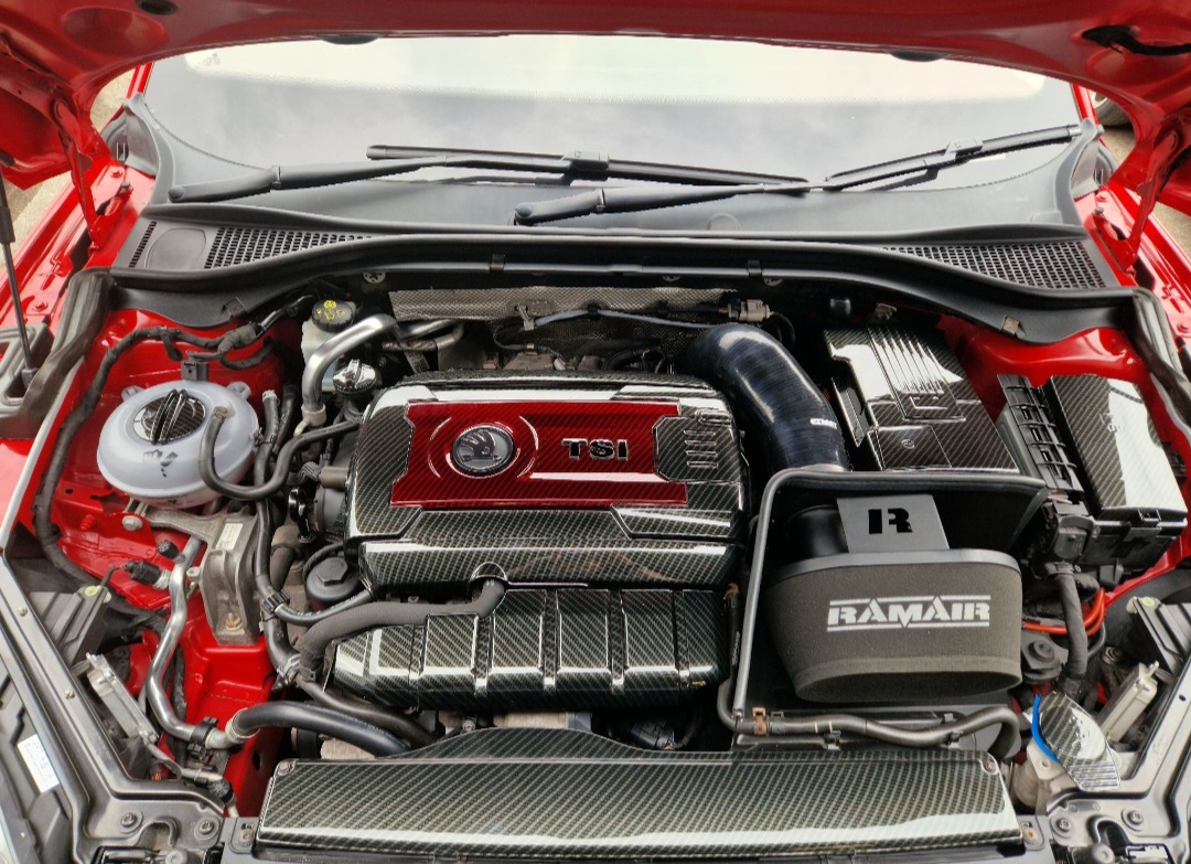

  8. And we go again..... So afew more things to update on.... Engine bay
  9. And your right, no rubbing on Ny parts, the front 5mm spacers were purely for aesthetic. Although it did help.
  10. Bloody hell, really late reply (my bad) No, bilstiens and eibachs with slight drop.

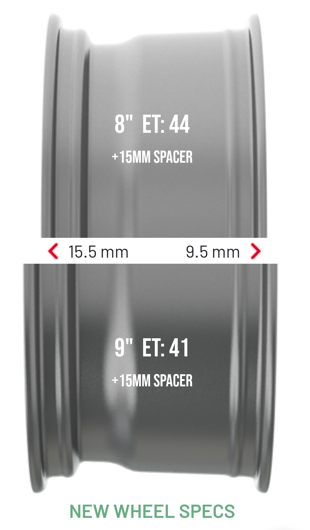

  11. Running 9j width on the alloys, 255 35 19. They're a 41 offset originally but due to the 9j width the rear didn't need the spacers The front I've used 5mm spacers as they were in a little, just a slight adjustment needed
