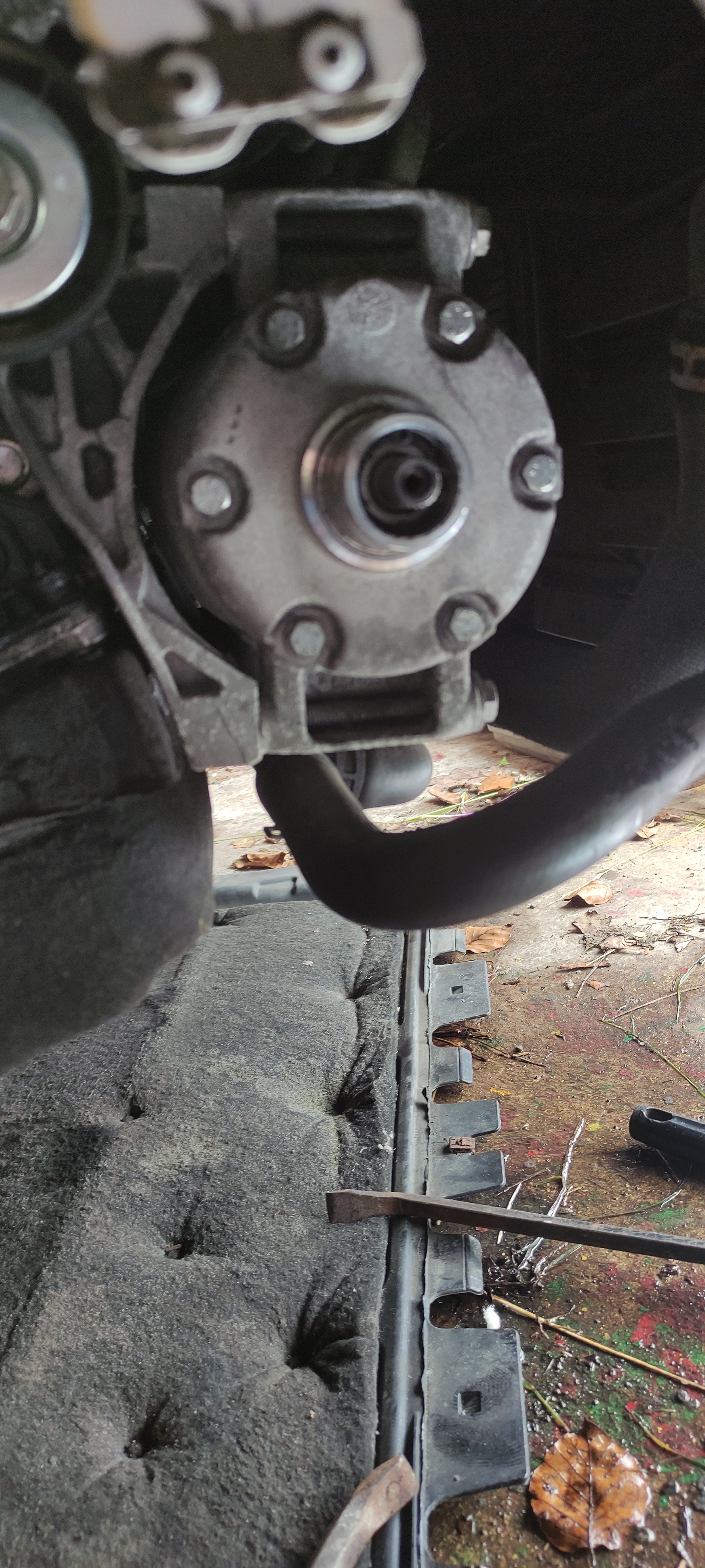

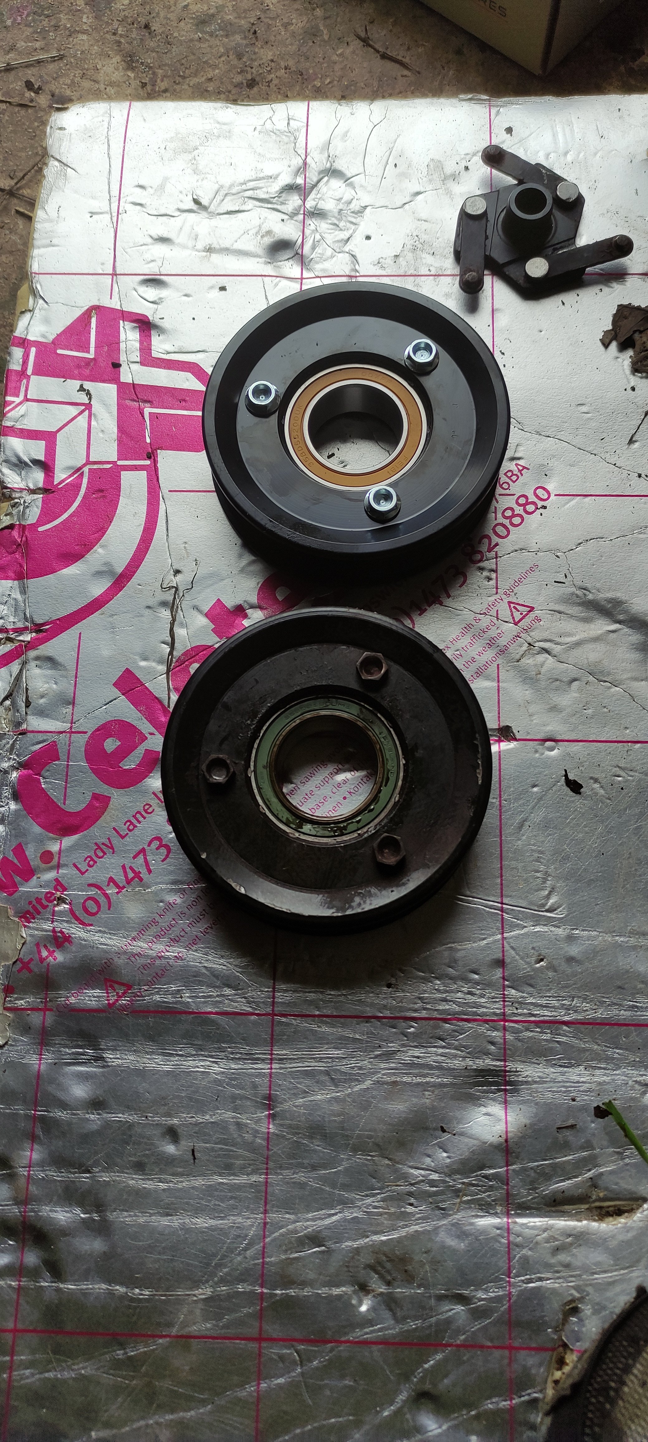

Hi Guys fitted the new pulley to the compressor today a perfect fit,below are a couple of photos,thanks to everybody who replied
Good pics. Was it a straightforward job?
It was pretty straight forward,when removing the old pulley the shear plate was harder to remove than the pulley because its on a splined shaft,we used two large screw drivers and levered against the pulley ,in the centre there where 2 shims which don't come with the new pulley,once off there's a plastic cover that you ease out which covers the circlip,remove the circlip and gently pry off the pulley,when refitting we used a tube the same size as the bearing race and gently taped it on,it was not hard to tap on,fitted the circlip back in then the plastic cover,we then put the 2 shims inside the new shear plate,when putting the shear plate back on you have to get it bang on straight to the splined shaft,put the bolt back in with some loctite,fitted a new ancillary belt,made sure the compressor engaged and disengaged and i had cold air it works perfect.

The link is ACAUTO AC compressor clutch AC-06DL18 | online shop (autopartspro.co.uk) it fitted my 2014 skoda octavia vrs 2 ltr diesel,take the shear plate of first to expose the cover then clip that holds the pulley on,use 2 screw drives opposite each other when removing the shear plate,mine was tight its on a splined shaft,just pry evenly and it should come off,once the clip holding the pully on is out the pully was easy to get off just watch out for the shims,if you don't see the shims check inside of the shear plate hole where the splines are
