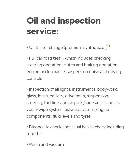

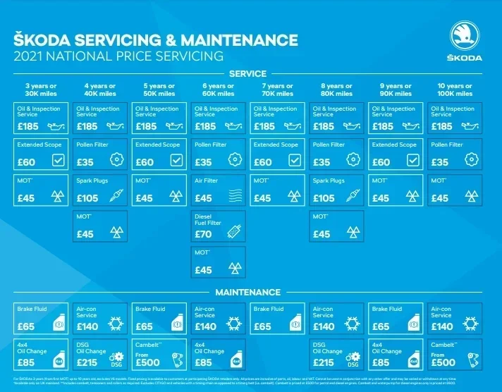

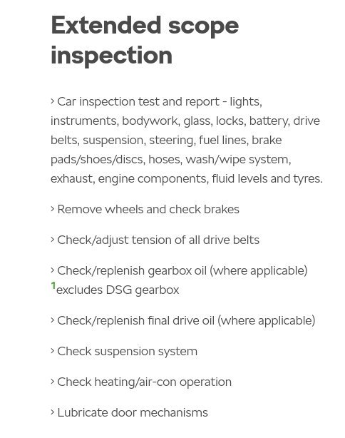

You need a print out if on the Skoda System, or invoices.
A Full Service History needs to show to the Manufacturers Guidelines, Recommendations, Specification or Schedule, not just anyone saying Fully Serviced.
The Haldex Service is at 3 years / 30,000 miles or sooner, and should not just be the oil changed, but actually serviced.
If it is a DQ500 DSG that is serviced @ 40,000 mile intervals, & if a DQ381 @ 80,000 miles or sooner.
2021 prices & just as a general guide. Fixed Service regime, not flexible / variable.
